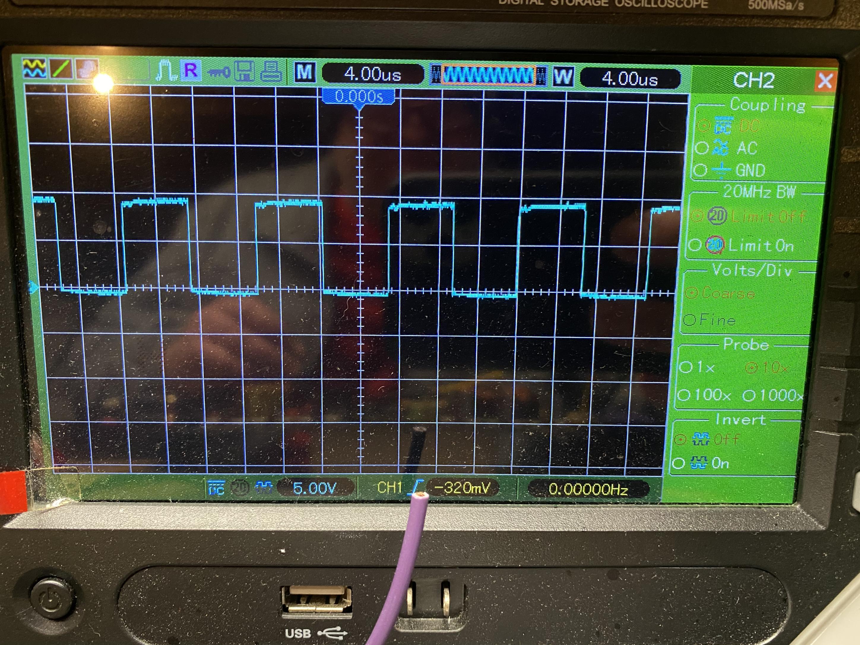

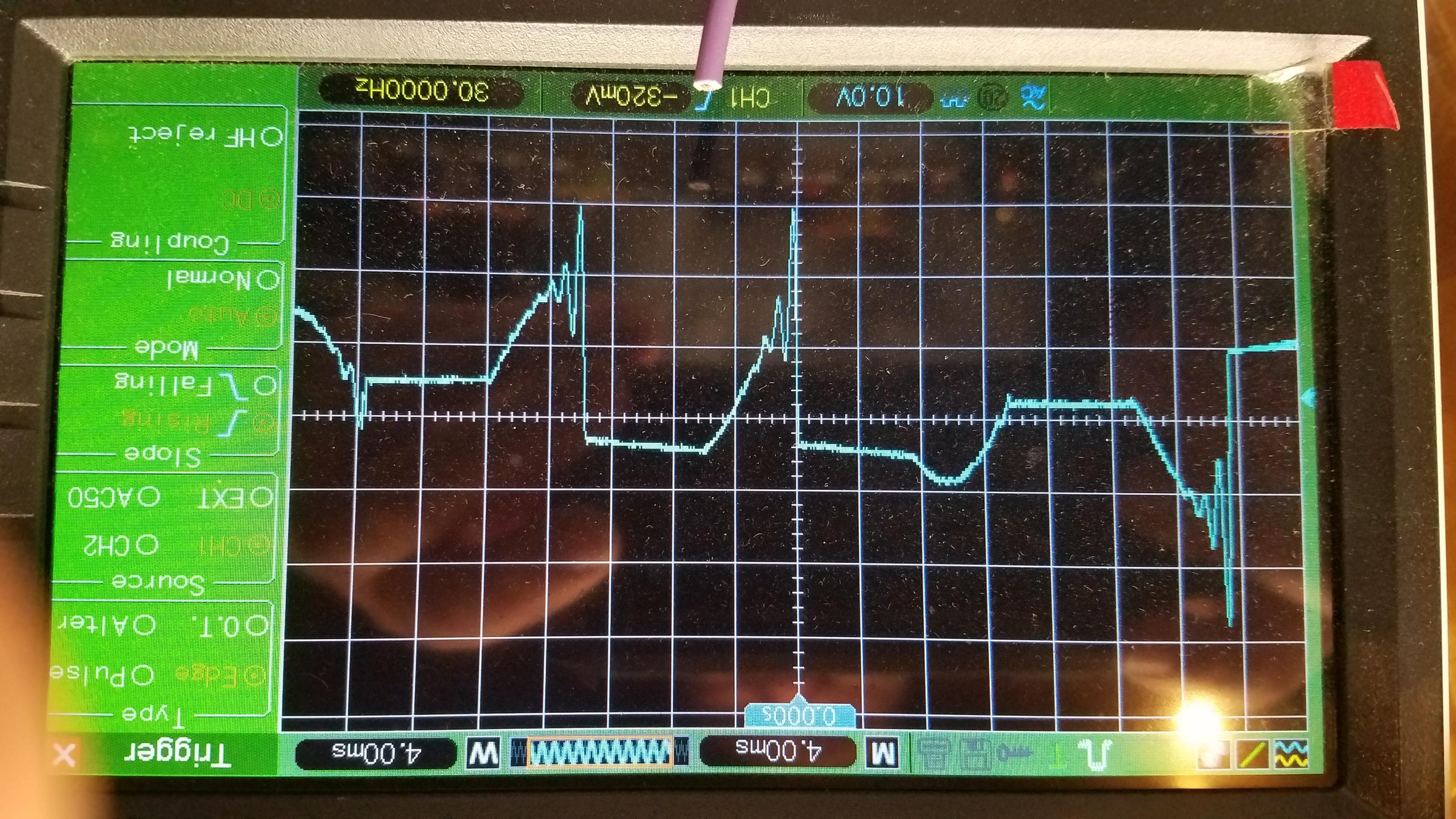

this what a 60hz wave form looks like on the speaker terminals.

no I was actually working on the amp while standing on my head. ha
I was able to get a square wave on pin 5 before my scope ground cam loose and touched pin 11,12,13,14 area. no the amp is blinking protection. I guessing I damaged the 4080 ic. I will order a few more today along with njm2901 ic's that i suspect is culprit.
