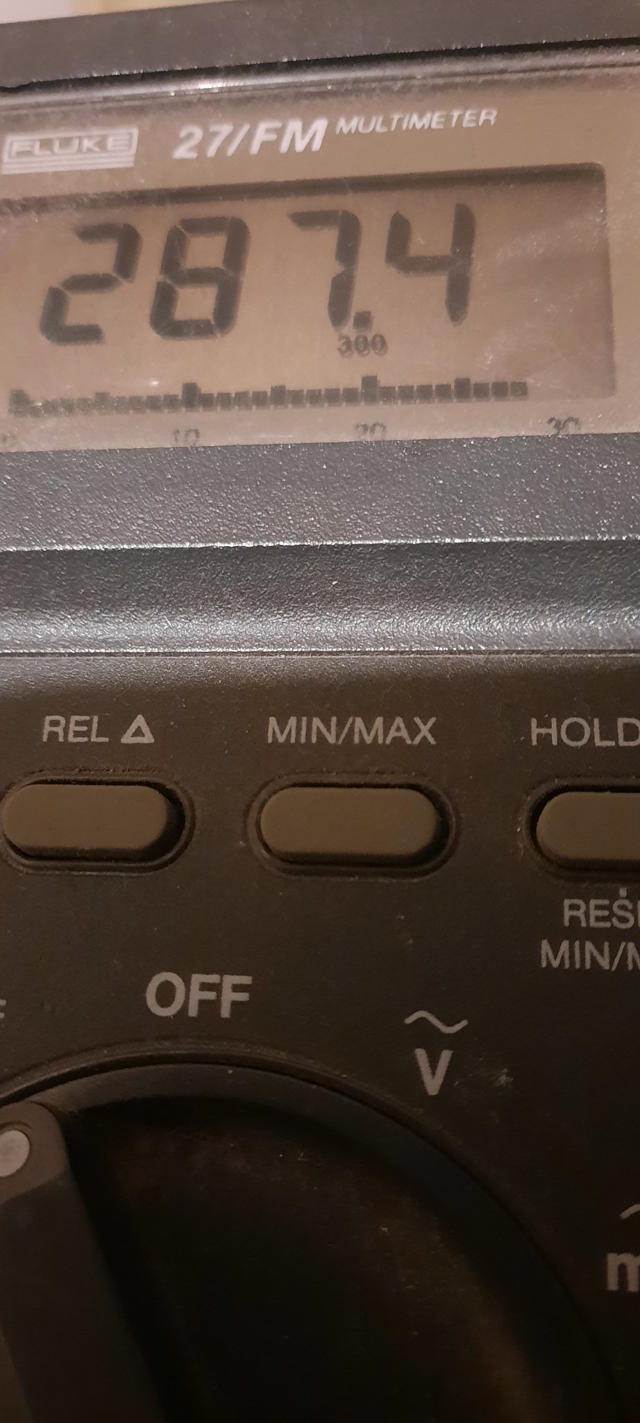

My voltages are higher than what I have seen on others, my B+ input voltage is 300vdc

Tomorrow, I will measure all the Zener Diodes to make sure none are too high. I can always just add a smaller Zener to adjust the set voltage of the regulator. I will report back tomorrow what I find.
Today I went and checked the Zeners diodes in that ladder and all were on the high end right at the limits and one was over it's limit. The total extra volts was 13Vdc and that is putting the output voltage from the regulator @ 299 Vdc. The one Zener 1N5374B was measuring 80 Vdc and it's max is 78.75Vdc per the Datasheet. So I was already prepared and had ordered the new Zener diodes last night and should be here on Friday so I can finish with the power supply and put the EAR 834P clone back into the system and let it break in.
The good thing nothing blew up or smoked! 🙂 So this was the only issue and really wasn't that bad just slightly out of tolerance on the Zeners.

Yes, your measurements are almost exact as mine. It's the Zener diodes set the voltage for the B+ lines. after the input and 2k resistors its the resistors that carry the rest to the plates and are not exact and vary some.
You have to measure the Zener Diode while they are on to see what each is at their Breakdown Voltage. I can already see that the Zeners are the cause in your power supply output voltage that it's at 300Vdc. Start from the bottom diode connected to ground and measure across it, then move up to the next diode. You will see the values, you can measure across each diode to find which one is out of spec. Others have had the same issue/s with the input voltage being too high as well. If it turns out to be a 1N5374 that is at the limit, you can put another 1N5373 which has a 68V breakdown to get it closer to the optimum target value of 285Vdc. If its a little higher it wont hurt.

I have checked the voltages across the Zeners and they range from 70v to 80v. It sounds like I should just replace them all.

Yeah, that 80Vdc across the 1N5374 is out of tolerance and should be changed. I find it weird that all these diodes measure I the high side right at or either over their limits. That's why I order On Semi for my replacements.

Today I replaced all the Zener Diodes and still it was measuring 298Vdc under load. I removed one of the 1N5374B and put in a 1N5370B which is 56V breakdown., it measured 278.7vdc. So I removed a 1N5374 and put in another 1N5373 and now I have 288Vdc. So now I'm done messing with the B+ voltage.
Now to let it burn in for an hour and put it into the system and see what I get.

My Power supply has been rock solid at 288Vdc @115VAC input after I took the pic and over an hour on. Even if I raised it to 120Vac it bare moved up 0.5Vdc. I also replace the 2K, 20K, and 200K resistors with Wirewound from Vishay and Ohmite. The 200K was replaced with KOA Metal Oxide, I may have to do that with the 330K resistors. I will go to a local Electronics Surplus and see if they may have some higher resistance Wirewound resistors. These will only be for the B+ supply lines to the tubes.
