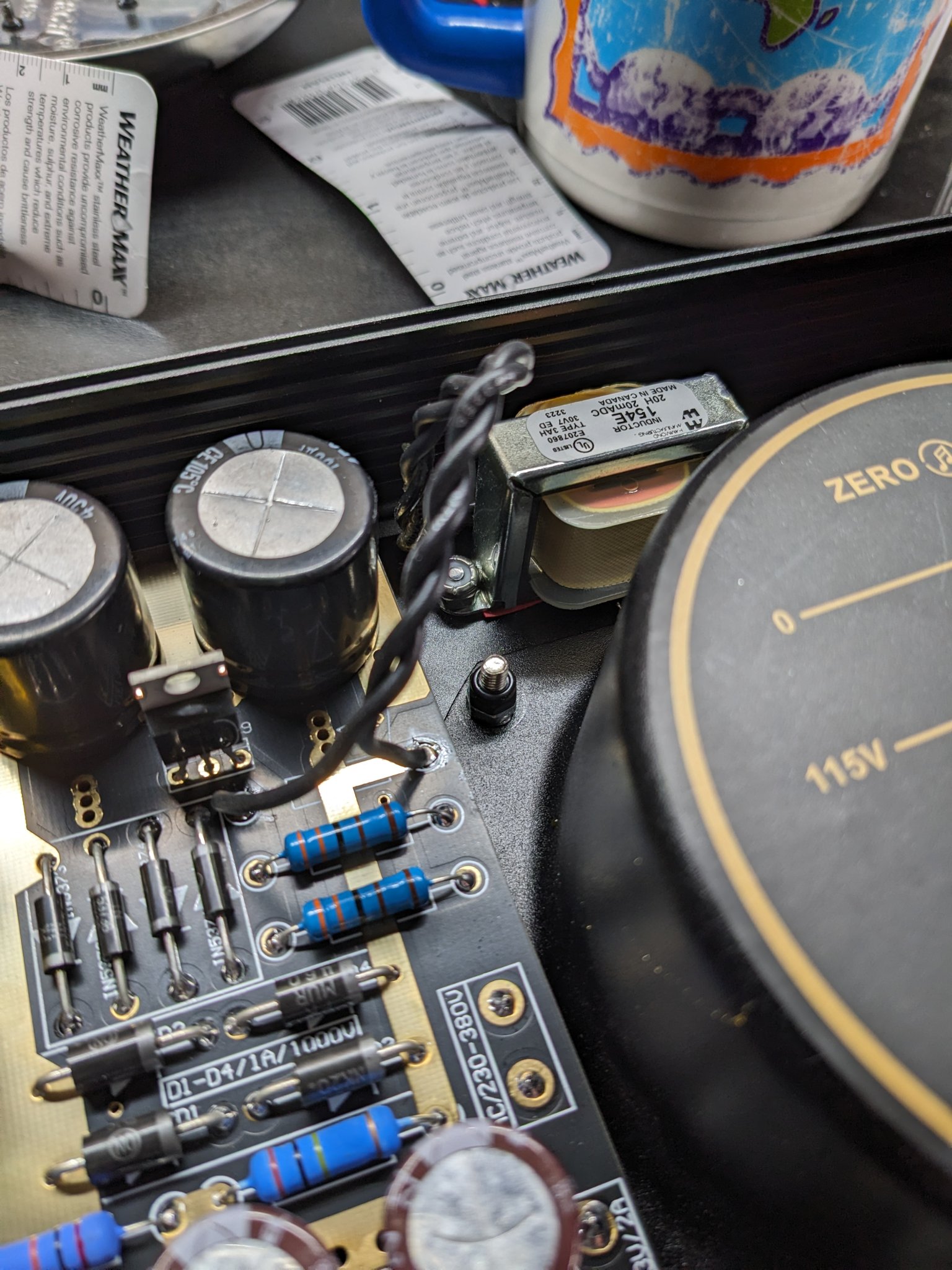

I received and installed the replacement stock value RIAA components. When I powered it up, the left channel hummed badly.
After several go-rounds of disassembly, inspection (I found a suspicious solder joint) and reassembly I still could not find the trouble so I decided to remove all of the bypass caps.
The issue is now resolved. The stock RIAA network sounds much better than the "optimized" values that I tried. The better parts sound a bit cleaner and clearer but the better coupling caps were a much bigger change. In fact, I doubt that I would be able to hear any improvement from the RIAA parts with the stock coupling caps.
I also build a bucking transformer into a power cord. I used a Hammond 166N6 6.3 volt transformer which drops my 122 wall voltage to 115. The higher voltage wasn't really an issue but it is right on spec now.

My next move will be the 33uF power supply caps on the PCB. I will upgrade them to 100uF Nichicon KX caps. I also have plans for the Power supply caps in the enclosure with the transformer, but I want to listen first after the 100uF cap upgrade. I don't want to loose the basic EAR 834 sound that we are love so much and why we bought this Phono preamp.
I will be making a Bucking Transformer for this unit but after I power up my system with the Tube preamp and power amp my line voltage is around 117-118V so that fine. I have one of those inline Voltage monitors so I can always see what the wall AC voltage is.

Those are the guys that I bypassed with 0.33uF film caps on the bottom of the board. I had hoped to avoid replacing them. This area seems like it could be easily improved.My next move will be the 33uF power supply caps on the PCB. I will upgrade them to 100uF Nichicon KX caps. I also have plans for the Power supply caps in the enclosure with the transformer
What are your plans for the power supply board? I wonder if it would make sense to split the supply and increase the number of connecting lines, either by changing the umbilical cord or doubling up with a second 4-wire.

I wanted to use some better Diodes along with better Caps. Sounds like you want to do a Dual Mono design now huh? 🙂 I also want to change out the RCA connectors cause I have some interconnects that slip off and those RCA connectors are not the best.

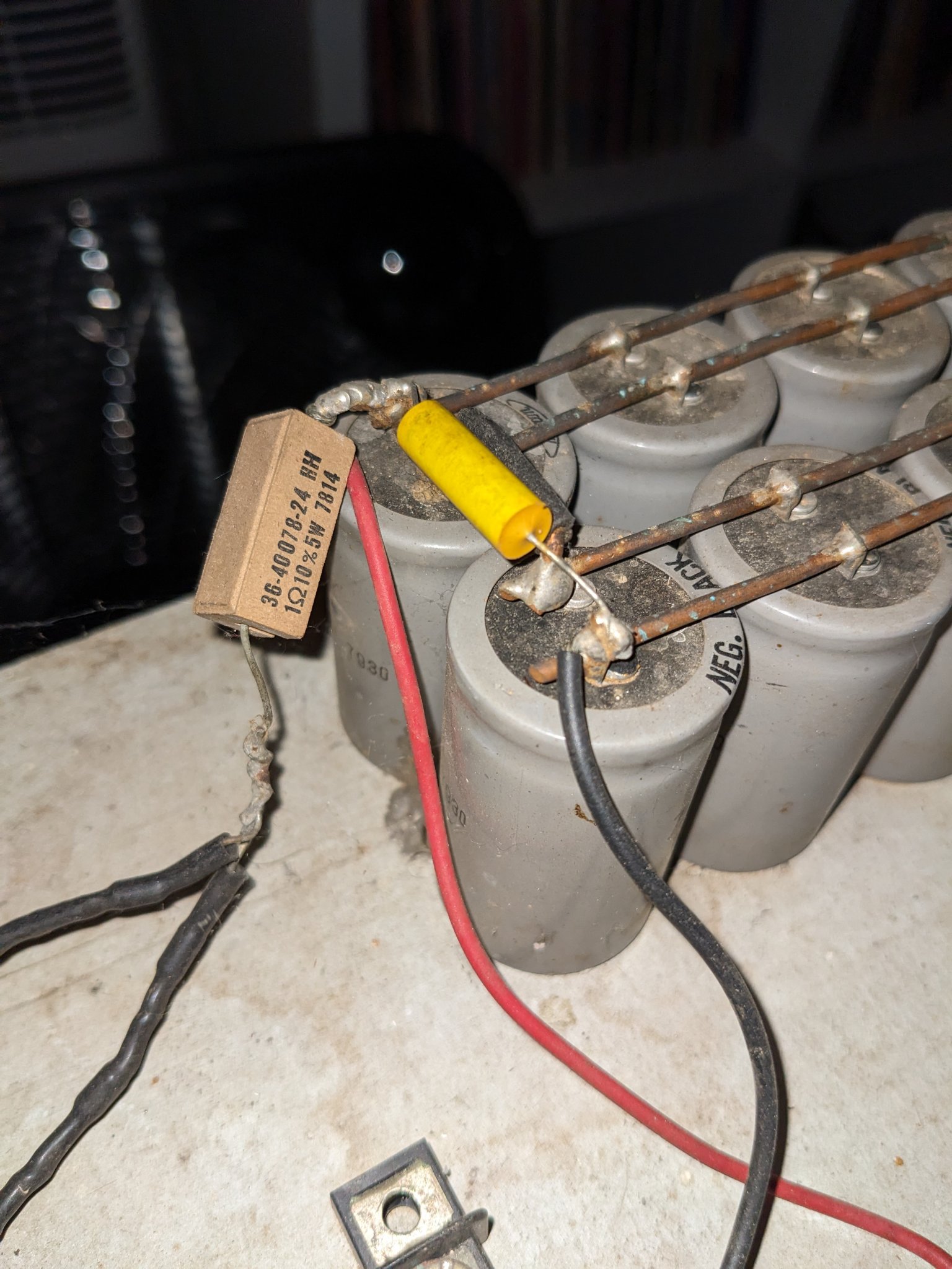

My first tube experience was with a Dynaco Stereo 70, probably 40 years ago. I got a working stock one and soon installed the GSI input board. I moved the power transformer to an external board and used a bunch of photoflash electrolytic capacitors in series/parallel banks to get the voltage rating.Also, re: bypassing the elecrolytic caps. I have never really understood that.
It sounded ok, but I then bypassed the photoflash caps with a polypropylene (I think) film cap. The improvement was startling! The top end opened up dramatically and all of a sudden my system had a top octave.

I've never used photoflash caps. Wouldn't that be like using motor start caps vs the recommended motor run caps for a PS?used a bunch of photoflash electrolytic capacitors
They were cheap and available, lol.I've never used photoflash caps.
