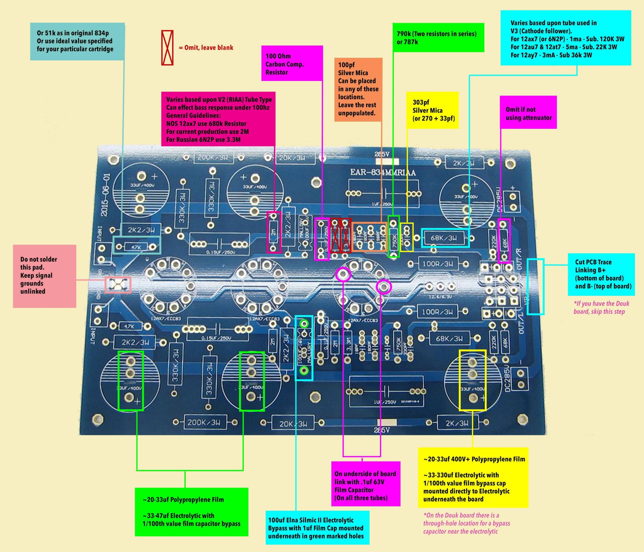

I do have questions about this circuit.
I have not done Thorsten's mods that delete the subsonic filter between V2 and V3. My understanding is that the change to the 68k cathode resistor on V3 is part of the same modification and so I have left it as is.
My questions are:
Is this correct? Is 68k the correct value for a 12AX7?
What value would be needed to try a 12AU7 here?

I tried a 12AU7 in that spot without subbing that resistor. It sounded shrill.
My understanding is that these values are appropriate with the rumble filter stuff removed. In the schematic that you posted that section just has a 100 ohm resistor.I tried a 12AU7 in that spot without subbing that resistor. It sounded shrill.
Elsewhere in that discussion there is a suggestion of removing the subsonic filter and running a 12AU7 with the stock 68k in place. I think that the point is to optimize the operating point of the tubes but I don't know enough about it to figure it out for myself. I have some 12AU7s on hand and don't need all of the gain that a 12AX7 provides.
Pete
Tube #3 is a cathode follower. Swapping in a 12AU7 there wont change gain. It will potentially be a good option for driving more current at the output. I may need to try it again as well, I recall I tried that swap before I replaced the big caps.

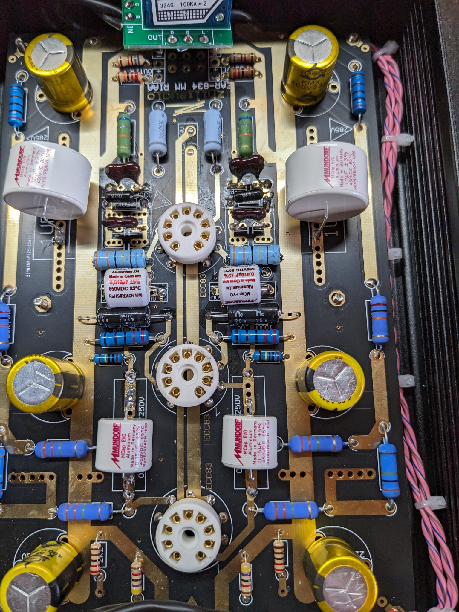

I have replaced the RIAA networks with precision parts. While I was at it I reoriented the coupling cap that I had backwards.
I was hooking it up when I remembered that I forgot.
I had to take it back out to the shop to remove the cover again and install the tubes. It's now warming up a bit before I spin the record again. I'm going to add the bypass caps later so I can get an idea of how much they help separately.
Stay tuned!

Well, that was not an unqualified success. The better parts sound cleaner and clearer but the tonal balance is now screwy. I couldn't hear the bass over the cymbels!
I thought that the tweaked RIAA values didn't depend on the changes that I didn't make. I don't think that this is the "improvement" intended!
I think that I have 750k resistors on hand but I don't have caps. I'm not going to reinstall the cheap parts that I removed! I don't know how to calculate these values, if afraid. I think that the best plan is to go back to the values that were previously installed, just higher quality.

I played as well. That middle stage 0.01u cap might be too much cutoff with your change. Without unsoldering it, try to add a bigger cap in parallel to create a larger value there.

I did some upgrades on my HIFI Split EAR 834P Clone, but before I started I made sure the Phono preamp didn't have any hum issues by itself, it does have a slight hum only when the turntable is connected. Has to do wit possible way the ET-2 arm is grounded. With a SUT connected shorting plugs and connected with the EAR Clone its still quiet.
Anyways, I did change the 0.15uF caps and the 1.0uf caps to Mundorf EVO Oil for the 0.15uF caps and AudioCap Theta for the 1.0uF. Sounds way better and can hear the bass fine, all instruments blend way better now and sound more balanced.

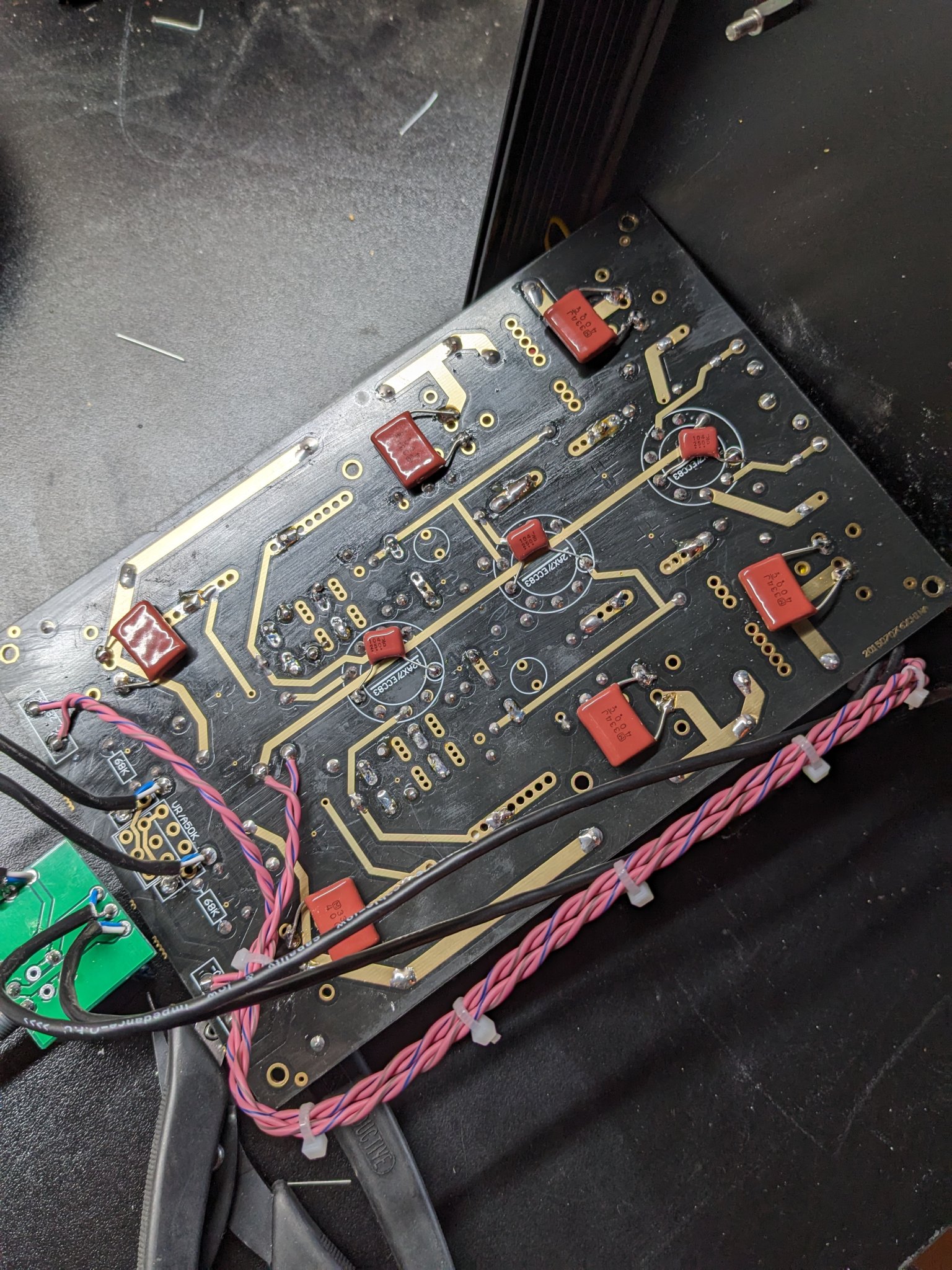

Bypass caps installed.
The replacement RIAA components should be here on Monday so I think that I wait until then to reassemble and audition.
