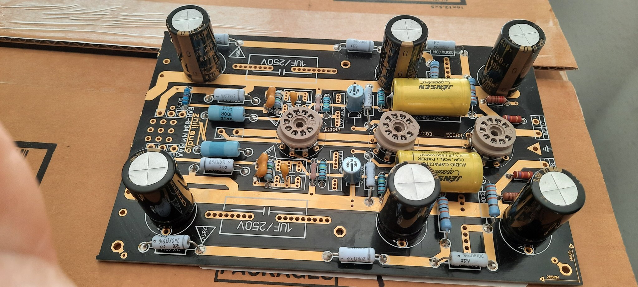

Today when I was going through my parts bin for the EAR clone that I ordered back when I first started the Bare PCB built and guess what I found? I guess I had ordered the Same Hammond 154E Choke. So I think I will put this in., does it need to be isolated from the PS chassis? Just making sure I don't cause any issues.

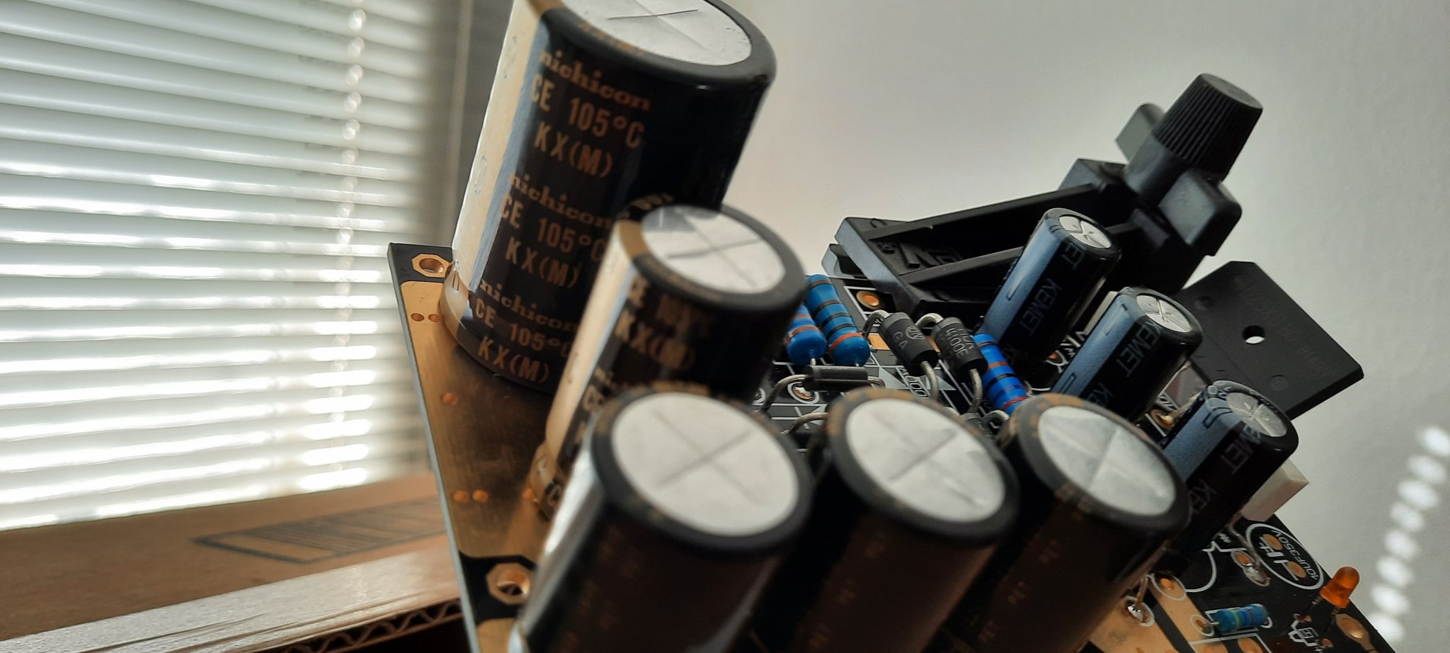

Also I have mentioned that I have 100uF/400vdc Nichicon KX caps for the main PCB but I also found I had order some 68uF/400Vdc Nichicon KX caps too. I want to use the 68uF/400vdc caps since they are double the 33uf caps that are in there now, hopefully this will not put too much of a strain on the Power Transformer.
I also found a KX 330uF cap for the upgrade to replace one of the 100uF one of the caps in the power supply. Along with these finds I also found the Diodes I was going to put ON Semi MUR4100EG 1000V/4A in for the B+ side but don't know if this will cause an issue.
Any thoughts?

Today I'm going to solder the components I bought in my original purchase into the PS board. once all in I will swap the PS in the 834P now for the one I just build so I don't have to unsolder parts and compare. Hopefully this will improve the sound of the 834P clone, then I will go after the preamp PCB and do the same with PCB I bought back in 2020. That one will have all the Jensen Copper foil PIO caps though out.

I finished the spare PS board with all the upgrades. I soon found out I misplaced the 10uF 450V cap so I have to order another. I will order the resistors for the power lines and others at the same time to finish this up once and for all on the spare preamp and PS pcb's.
I did find the CD silver Mica caps so I will remove the ones that are in there now and replace them with the CD caps. I need to drill holes for the mounting screws for the choke.

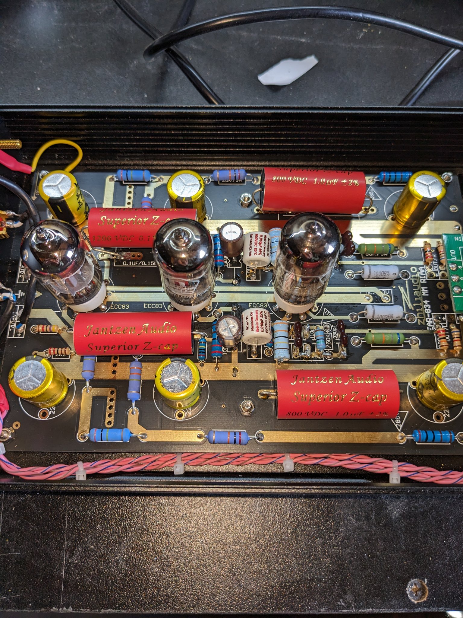

I exchanged the Mundorf EVO coupling capacitors with Jantzen Superior Z-Caps and I'm surprised by the improvement. They only have an hour or so on them but the improvements are already substantial.
It is as if the players all moved their seats farther apart and especially further back. The soundstage is quite a bit wider and much deeper but the virtual images on the stage are a bit more tightly focused. There is now more empty space in between the players.
The modifications and upgrades that I have made:
I replaced the RIAA network parts with higher quality components but kept the stock values.
I replaced the coupling caps with higher quality components. I currently have a Mundorf EVO Oil capacitor between V2 and V3 and Jantzen Superior Z-Caps on the inputs and outputs.
I replaced the caps on the cathode of V2 with Elna Silmic 2 100uf 16V capacitors bypassed with 0.1uf film caps on the bottom of the board.
I removed the resistor and installed a choke in the power supply.
I added a heat sink to the 6.3V Bridge Rectifier in the power supply.
So far, so good!

What prompted you to swap out the Mundorf coupling caps?
I too use a Jentzen as the first coupling cap, but I have an Audyn in the output spot.
Only one pair of them were the oil filled ones. They made such a dramatic improvement that I wanted to try even better ones. It turns out that it was money and time well spent!What prompted you to swap out the Mundorf coupling caps?
How did you decide to use an Audyn for the output cap? I have been poking around on the Humble Hifi capacitor test:

I used These same Jantzen Superior Z caps in my Transcendent Sound Masterpiece 300b preamp build. Very nice caps, different from my Jensen Copper Foil PIO caps.
Just wait, you aint heard nothing yet. once you get around to 150 hours they are really something! I just the AudioCap Thetas in for Coupling caps and the Mundorf EVO oil because Audiocap didn't make that value.
You need to replace all them 33uF Gold/ Yellow caps, once you do that then this will be even better sounding. I older more parts for the power supply and main preamp. Once I finish putting all the parts I will then do the Pot, RCA connectors and maybe the AC input to a better one.
Enjoy!
Now that's funny!You need to replace all them 33uF Gold/ Yellow caps, once you do that then this will be even better sounding.
I've been listening to this thing for several hours now and it sounds very nice when it isn't being asked to do much. As soon as the music builds it gets congested, which makes me think that the power supply doesn't have enough reserve capacity.
Those 33uf electrolytics are acting as a local reserve for each stage, not filtering per se? That makes sense.
I have been hesitant to replace those guys because they won't be easy to remove. I used to have access to an actual solder sucker but these days I only have the stupid plunger type. In any event, that seems to be the next step.

What you are hearing is the Jantzen caps, they need break in before you start run them through their paces and start comparing. Mine did this as well and didn't start to open up until around 50-60 hours on them. So be patient. 🙂
If you have an adjustable soldering iron with and good size tip it is easy to remove those cap but you will have to be careful not to damage the PCB. You do care about the part so that is no biggy. You will apply the tip/heat to the lead of the cap and slowly wiggle while slightly lifting the that side of the cap that you are desoldering. Then work the other side until going back and forth between the cap leads until you can get the part out safely.

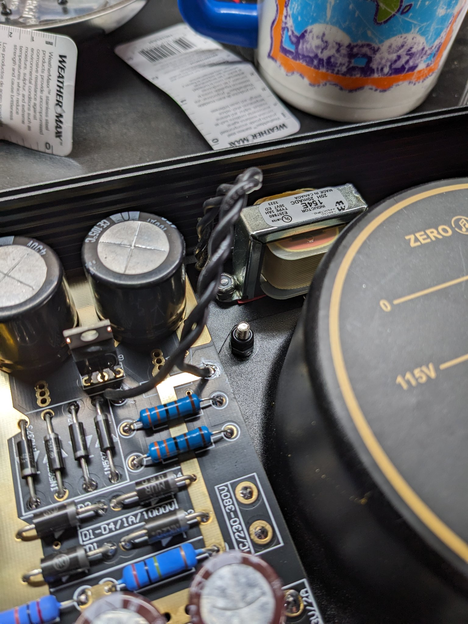

Ok, today I finished the spare power power supply with the choke in the schematics and 330uf cap before and 220uF cap the choke. I'm getting 300VDC on the B+ input to the preamp pcb. For both left and right channels Power voltages are:
I haven't touched any of the resistors on the preamp PCB. I'm wondering if some are really out of tolerance.
With the Variac set at 115vdc these are the voltages I get.
After the 2k = 298vdc
After the 20k = 278vdc
After the 200k =212vdc
Plates Voltages are:
V1 95Vdc
V2 125vdc
V3 297vdc
I did use some 68uF caps instead of the 47uF caps that in that circuit for the Transistor and Zeners for the regulation.
Does anyone one know what the voltage tolerances are for these Clones?

My voltages are higher than what I have seen on others, my B+ input voltage is 300vdc. Should I just increase the value the first resistor (2K) to get it closer to the proper voltages since I'm using the choke in the power supply?Try this first. I have a lundhahl 15H choke the I want to try is in the same spot. Just need to monitor the voltage supply change.
