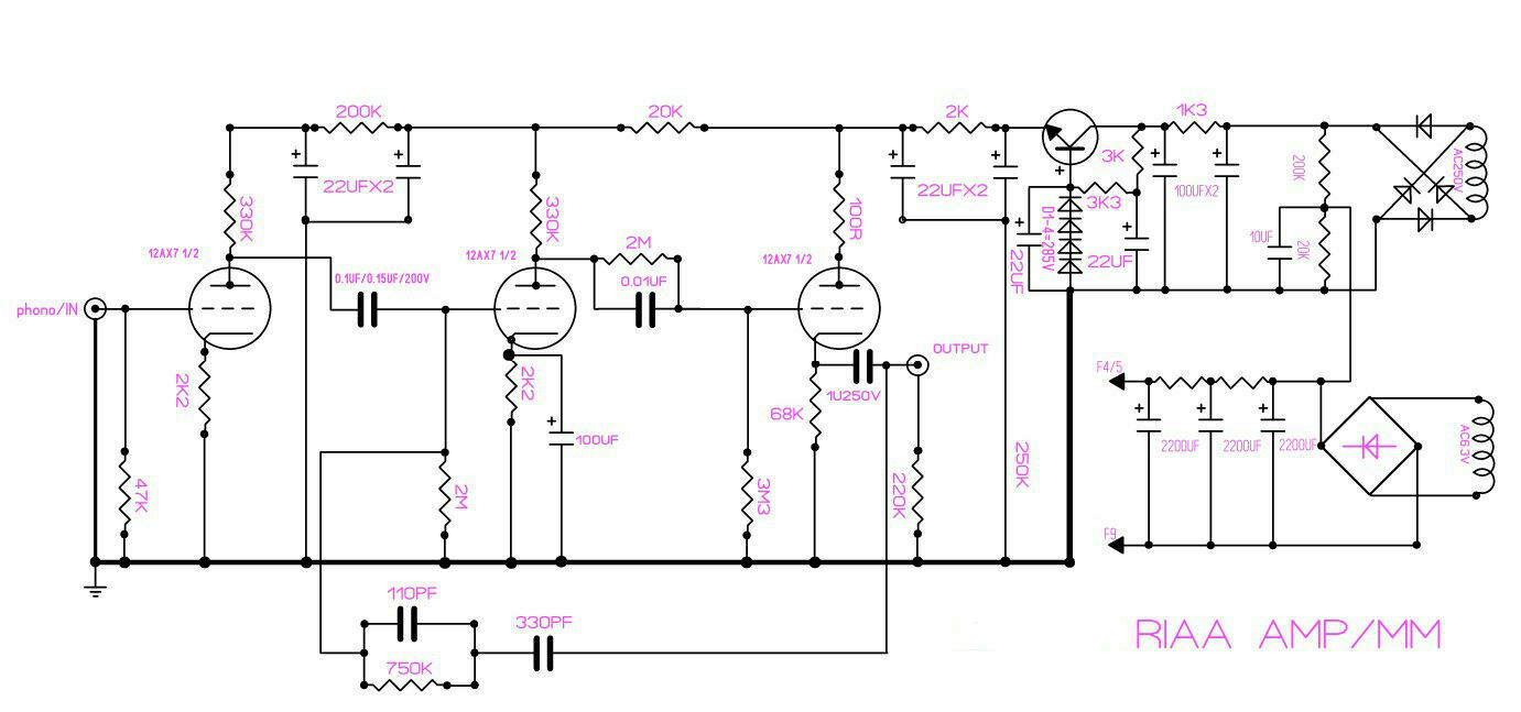

I don't know if this is a way to measure ripple but I set my multimeter to AC and measured on the DC out from the PS. Both on 280 and 6.3 and the numbers where going up and down. This video is from the 280 output.
Can you arrange an external B+ and a lead battery for the filament ? This would pinpoint or clear the power supply.
That is the correct way to measure ripple. But it looks like something is oscillating there.
If what is showing the multimeter is real then the power supply is not good at all , maybe the transistor is damaged , wrongly connected , so on ...
All parts should be checked . What is the DC voltage before the regulator ? On AC is showing the same crap ?
Ok, what are potential reasons for that?
Unstable feedback loop, bad layout, not enough power supply bypass, modifications from the original circuit. No real direct answer without more troubleshooting.
Just read further back a bit. 100hz is ripple from inadequate filtering. No amount of shielding or placement will fix that.
Is there a schematic for this clone? I’m wondering if the heater supply is floating or referenced to ground?
Should be elevated above ground , The schematic is on internet
Anyway the power supply is not good , even if the preamp is oscillating itself , the B+ on the output cap filter after the regulator should be clean . Can't draw so much current ... 🙂
I don't know why but when I read AC on auto I get what you saw in the video, but if I read the AC from the manual ranging instead as Depanatoru suggested I get 0V AC on B+ and 0.2V AC on heaters. So maybe not so bad after all.
I changed all the diodes and the transistor (had extra). No changes regarding hum. Old diodes measured fine too. I measured all resistors still mounted on the board. All measured fine expect the two small ones R22 but that probably because they are still soldered to the board. I don't know how to test the shoke or caps.
I'm using the same PSU as everyone else and all is mounted as it should as far as I can see. Mods on the main board are well known and tested by others. Same goes for the grounding scheme.
This is all above my paygrade. I just thought that following Skunkies videos and Leocoheavens instructions would make everything world fine. Do not have the knowledge to fix this issue. It's not to bad so I can live with it but I am prepared to try out different suggestions.
I don't like how grounds are connected there in back with that screw . The star center should be at the filter caps on the board .
If you have mains ground connected there try without it .
Remember that for no audible hum everything must be perfect , every detail is important , RIAA is very sensitive 🙂
The mains ground is mounted on it's own bolt next to where the star ground is connected to the chassis. I did have the star ground where you suggested at first (that was also the recommended place in the Lencoheaven guide) but I moved it since it was so crowded by the PSU and also inconvenient while moving around stuff searching for the cause of the hum. I also had hum then too. But of course, that was before I fixed the shielding problem.
I will move it back to that place. 🙂 May I ask why this is recommended? It is good to learn the proper ways.
Because a wire or trace on PCB is not a perfect short , there is a little minuscule voltage drop , If diffrent parts of the circuit share a single wire , like you have now from that screw to capacitors ground , can easily influence each other . The most sensitive part can amplify that voltage drop from other currents Or that voltage drop is like a positive feedback and would oscillate .
So wires must go like a star or tree branchesr from filter capacitors positive and negative , that are like shorts for AC , to diffrent separate parts of the circuit that perform diffrent functions and can influence each other
Ah ok. Thanks for the detailed explaination. I will change that. Just need to figure out how to attach all wires and buy some more wire. Im out of wire.
There are some common practices against hum:
- Grid resistors, series 1k resistor directly on the socket, to prevent RF oscillation. Applied at each tube.
- Ground loop breaker. This is a high current antiparallel diode between signal GND and metal chassis. 10R resistor parallel with the bridge. The earth symbol on the leftmost should be removed.
- Input ground loop breaker. This is a 10R resistor between the signal GND of the 1st stage (included the RCA common) and the rest of other stages' signal GND.
- The first 2200uF filter capacitor in the heating supply is too high, resulting in high peak charge current. I'd replace it with a 100uF.
- Snubber across the output of the rectifier bridges.
- 2M2 and 3M3 grid resistors seem extreme. I know the 2M2 is part of the RIAA ckt. I would divide the resistors by 10 and multiply the capacitors by 10.
