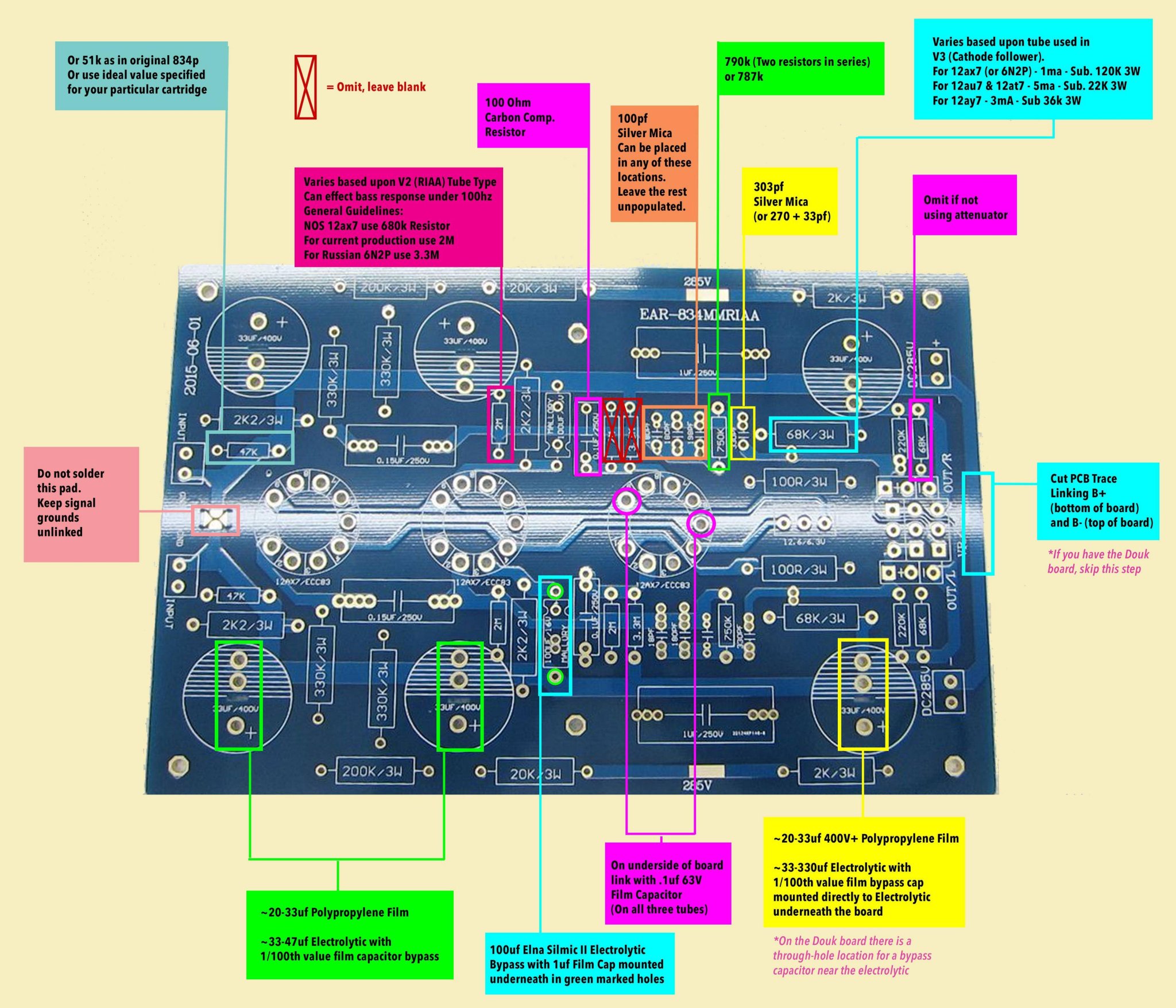

I am wondering if this could be because of the mods? But they are made by skilled people and tested by many others. Anyway, these are the mods I made:
