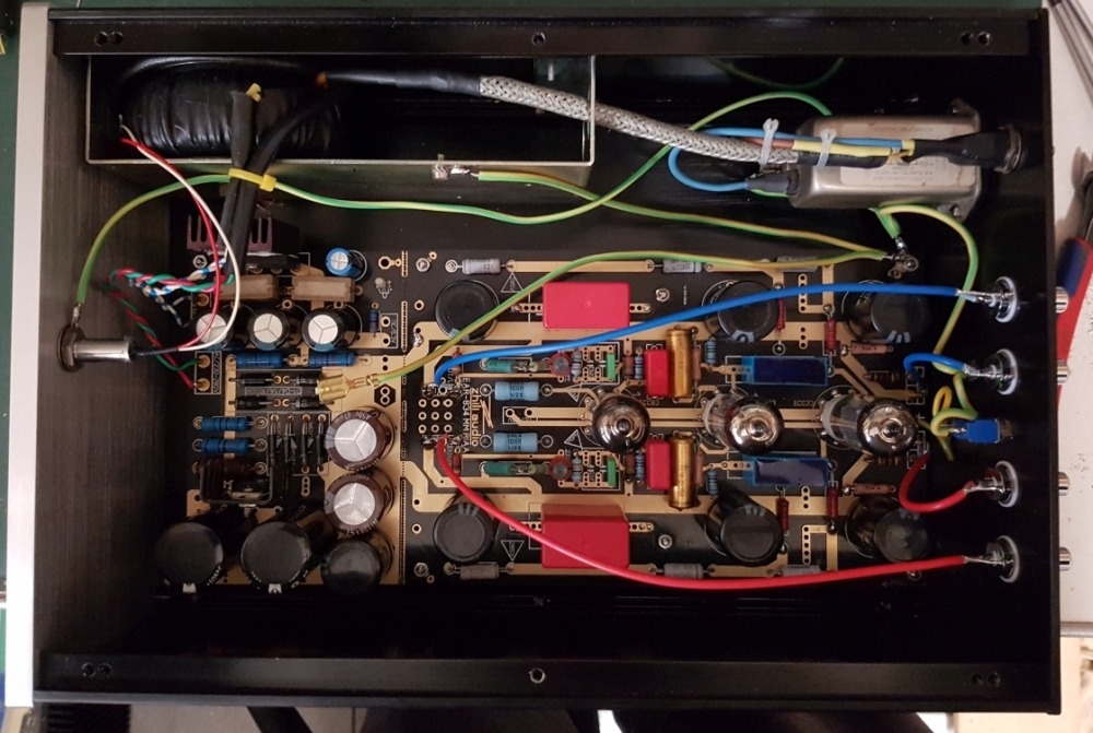

I propose a simple additional test, you have all necessary things to do it:
Give the filament power from the 6V battery, but in this case do not lift the filament supply from the attenuated B+. Connect one end of the battery to the signal ground instead. Let us know about the outcome.
If the transformer was tried outside maybe the AC wires are to close to that shield . And that shield is very good for coupling magnetic field like mumetal is

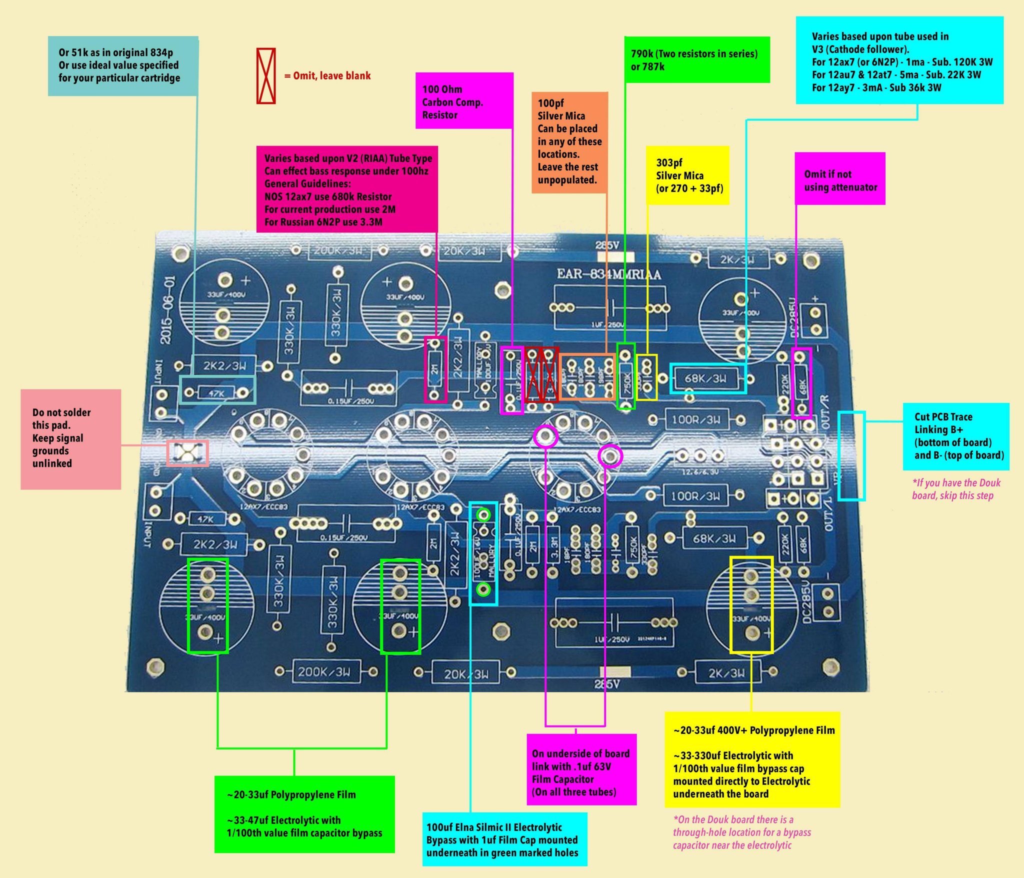

The component mods on the board are for improving the sound quality , nothing to do with hum . Cutting the plus and minus traces is for using separate wires , plus and ground , from each channel to filter cap , as we discused before about star ground
Since I am a novice, unfortunately, and are a little afraid to do something wrong and fry parts, could you be specific on where on the board I safely can connect to signal ground (or if it's on the inputs or something else)? I know it sounds like I shouldn't mess with this stuff and that's probably correct.I propose a simple additional test, you have all necessary things to do it:
Just to be clear, do I bypass this resistor with a wire? Do I need to do it on both channels at the same time?A shorted input is from grid to ground , across the 2M resistor

You can disconnect the wire/track going from the filament Graetz to the common pont of the divider (200k + 20k), and connect F9 to the signal GND. This is just for a test.Since I am a novice, unfortunately, and are a little afraid to do something wrong and fry parts, could you be specific on where on the board I safely can connect to signal ground (or if it's on the inputs or something else)? I know it sounds like I shouldn't mess with this stuff and that's probably correct.
Second option: connect the divider to the F4/5 instead of the Graetz.
Sorry Icsaszar, but you lost me at Graetz haha. Is that the rectifier? I am way to much of a novice to follow your instructions.

In my experience with the version of the board I use, the black ones made by Zhili audio and I think the zerozone ones are the same (which may be the douk board?), they sound great built as designed with no mods. At this point, I have no way of knowing if all these mods are the problem or what it would sound like. I've even built them with the super cheapo China electrolytic caps and they sound good.I am wondering if this could be because of the mods? But they are made by skilled people and tested by many others. Anyway, these are the mods I made:
The only thing I can agree with here is you don't need the 68K resistor if you aren't using an attenuator.
I have not heard this board without the mods but it's sounds really good with these mods too. The mods are basically just bypass caps for the electrolytics and minor adjudtments for the riaa curve.

Bypassing the 2M resistor by the second valve did make the hum go away. Dead silent! So what does this mean?Yes , a wire across the resistor , one channel is enough
When I short 47k input resistor there is still hum.
I might add that my SUT is permanently installed in this build. I did remove it earlier to see if it was the cause of the hum but it made no difference so I put it back in. However, that was before I made all of the shielding. I should probably remove it again. It might bee the cause of this hum.
I guess you should improvise a shield for that tube
Edit - The metal shield you put in back and sides is not enough , should be under the RIAA board also . And on top as well when you close the lid . If you don't want to throw away that box and use a proper metal one
