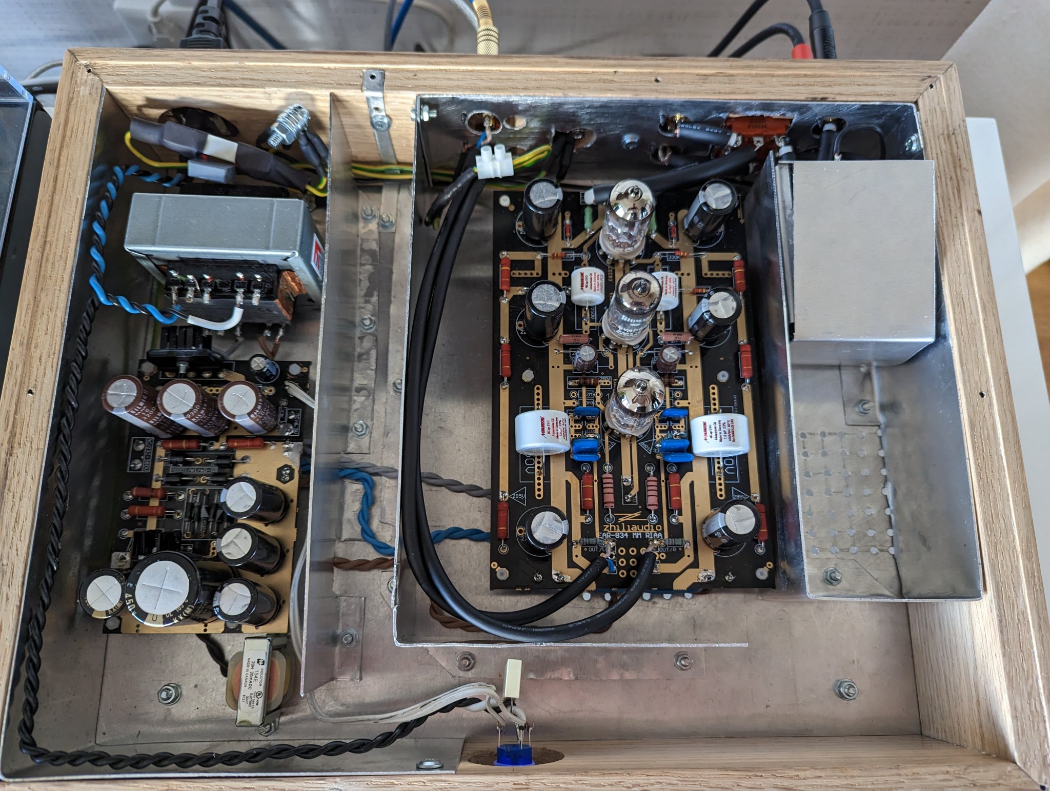

EAR834p clone with hum. Would appreciate some help

I have measured it earlier. It mainly 50hz trough the SUTs, but there is also a 100hz peak. I did some tube swapping earlier and with one set of tubes the 100hz became just as loud as 50hz, especially if I cracked up the volume.
I did not unhook the SUT but since I run both + and - trough the switch they should not come trough when switched to MM.
If I ground the switch and use the JJ ECC83S tubes, amp is pretty much silent with nothing at all connected to the inputs. . Hiss and white noise if I crank up the volume. If I use my Brimar CV4004 the first tube pics up hum, more so if I touch it. With the JJ ECC83S this is not a problem. But with shorting plugs into the MM inputs I get a some 100 hz hum.

Sorry to tell you this, but switches on phono input are always a bad idea (imho). Your switch is not shielded, and it will be hard to shield. It works like an antenna as it is right now too. Do you get any RF signals? Hope no cell phone towers are nearby. 🙂
The step-ups are right beside your input tubes as well. And your tubes are not shielded. Place shields on the tubes and ground the shields if you can do this. Then you might not find the need to swap different tubes, etc.
Try this for now: Wire the MM inputs directly to the input of the board. Then use an MM pickup. Make sure there are no ground loops with the turntable ground and tonearm ground. The tonearm ground wire should go to your ground post on your Phono amp.
Ian
I would put the step-up transformers in a separate fully shielded metal box. This allows you to place them somewhere else, where they will not induce hum. Yes, you will need extra cables for this. Sorry.
Also, the metal box for the step-ups will need to be grounded too. Best is to put all grounds to the ground post of your phono amp.

In the picture of your phono ( 1st post ) output signal wiring goes right over the high voltage and heater cables. High voltage cables can couple hum if close to output signal wiring - change the routing to the right side of the pcb if you can.

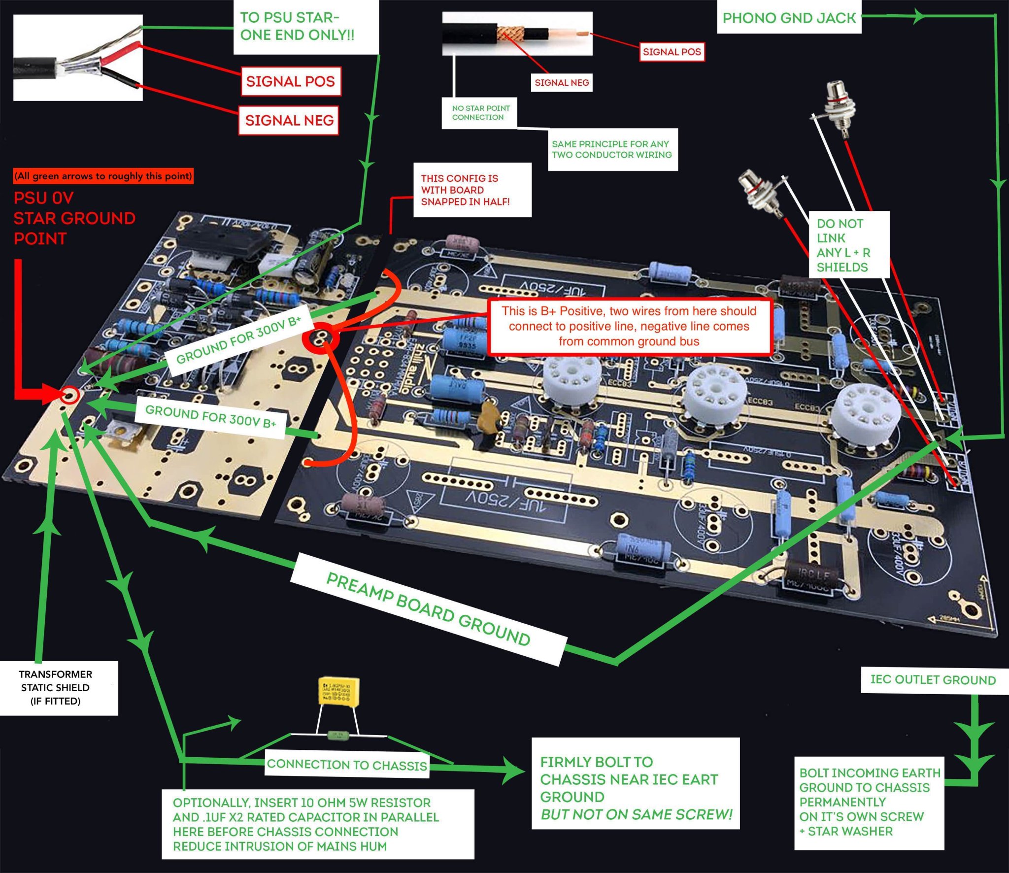

I have already implemented the circuit that you see in this grounding scheme below. X2 cap and 10 Ohm resistor (bottom of picture). Would that be the same thing as what you are suggesting? It made no difference though.

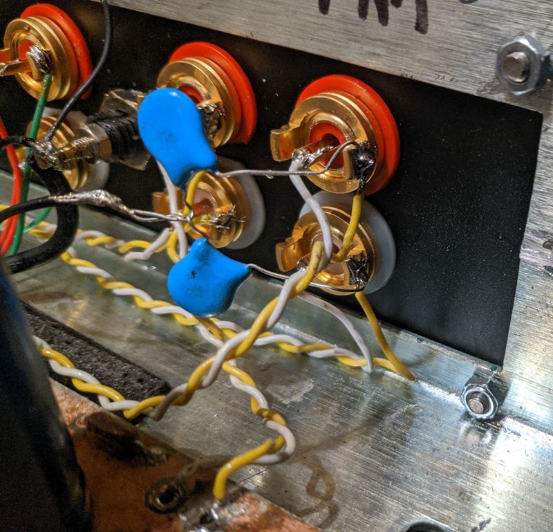

No, not the same thing.... what you have there is a ground loop breaker (which is a good thing and you should keep it).
One end of each ~10nF cap goes to the ground of the input RCA socket. The other ends join together and go to chassis/mains earth.
So if you look at the photo, you'll see one with 2 ceramic 10nF caps, one end of each at the RCA ground, and the other ends go to chassis ground (out of shot).
If you can, make the leads shorter than in this photo.....
Ok, thanks! I do not have those caps at home so in that case need to place an order. I'll start with bypassing SUT and switch and see if that might be enough: After that I'll order the caps and some copper tape for extra shielding and see if that is enough. 🙂
I have now finally been able to remove some of the hum thanks to the help from you fine guys. I had to take some time off from this project since it drained my energy and then started with changing the cable on my turntable so that it was functioning properly again. I then ordered some Mogami 2497 cable that I am going to use as interconnects but I ordered some extra to use as internal cables as well since the ones I previously used where not shielded, because this was a shielding issue as some of you suspected.
I then inserted an extra aluminum wall between the PSU and main board. Honestly it is probably not needed but why not?. I then inserted an aluminum piece on the back wall, since this was left unshielded and this made a significant difference.
I then bypassed the SUT and the switch and worked from there with shorting plugs. I tried to ground the metal casings of my RCA jacks to chassis, as one you mentioned, and surely, hum was reduced even further. They acted as antennas when only touching wood. At this point the hum is acceptable but if I turn up the volume to loud listening levels it is still to loud for me to be content. I do think I need to build a new enclosure to get it perfect so I will leave it as it is for now.
Then I reinserted the switch. A tiny bit more hum, but acceptable in regards to the convenience it gives. It too is now grounded to chassis.
Next I reinserted the SUT but now with an extra aluminum case around it. Did not add any hum. Phew! And with SUT wired to 1:16 gain I can reduce volume on my preamp and hence lower the noise floor from the phono stage some more. It's not dead silent but way better than is was.
