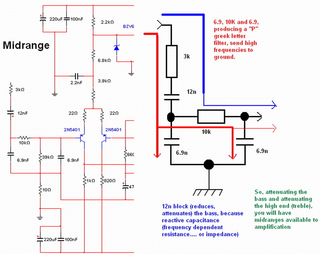

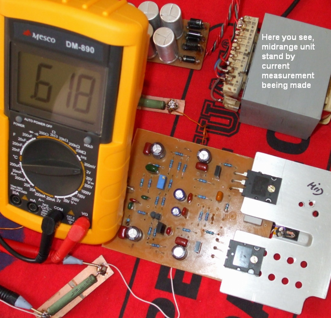

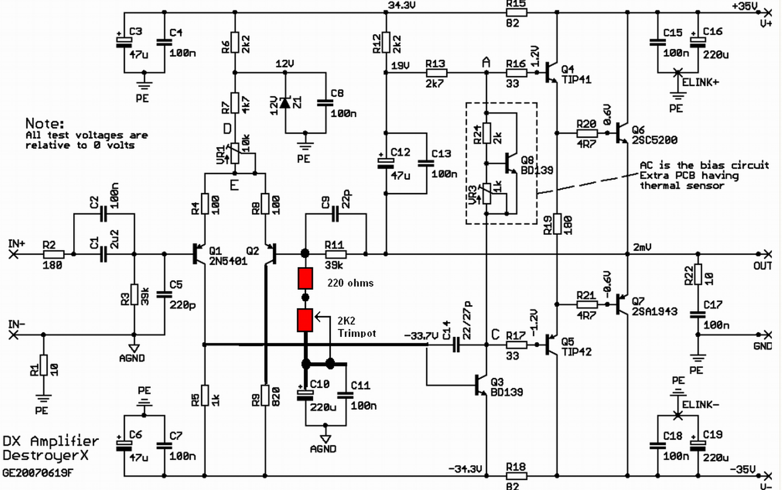

Dx TriAmp midrange amplifier was built, adjusted and tested
And worked fine..stable...and wonderfull voices.

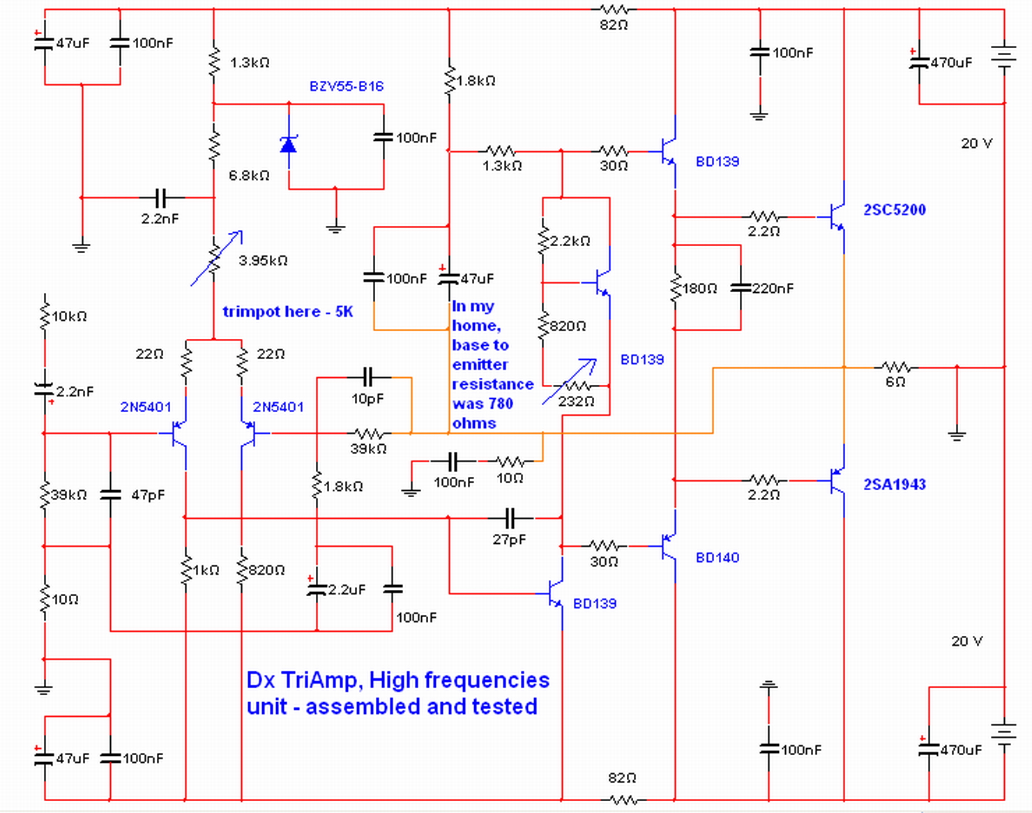

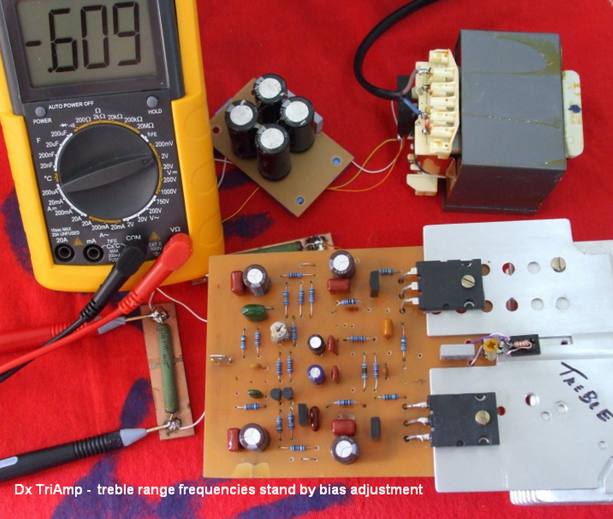

Dx TriAmp, High frequency amplifier was built, adjusted and tested
Worked fine!
Dx amplifiers are not simulator sheet of papper...they are real things, built and tested..also pictures are posted to prove you that really exists.

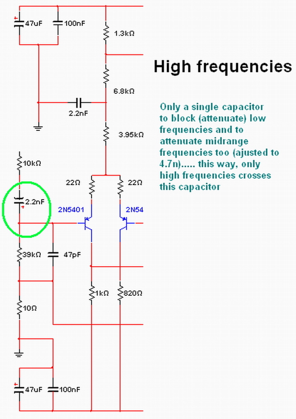

The idea...splitting audio band in parts and sending audio to customized
amplifiers resulted UNBEATABLE!....the idea by itself is spectacular...nothing can do better...i am using passive...but i really think active may be even better.... the idea is old alike the time.... in the seventies people were already doing that...but to take that once again was a nice idea i had and even in advance my idea, MJL21193 did something alike.
Also i am thinking into 4 audio bands...the subwoofer, the normal low frequencies called woofer.... some midranges starting a little bit higher in frequency to take some voices high pitch and the super tweeter.
4 amplifiers may be perfect...each one to it's exclusive speaker driver...8 amplifiers into a stereo.... 8 volume controls.... calibrates scale to allow you to know how you are going out from "flat" position..numbers around the 8 volume knobs.
I think the amplifier quality is important...but more than that the power ratio is important and to match sensitivity into all amplifiers....a good amplifier will result worse than an excelent amplifier..but even a good amplifier will beat all others because the idea... the audio band split idea...reducing distortions and sending tones to customized amplifiers to work with them..no passive crossover at the output.
I am listening the TriAmp...and really...unbeatable!...not because Dx Amplifiers...but because the idea..... MJL21193 with his Patchwork is doing even better using passive input.

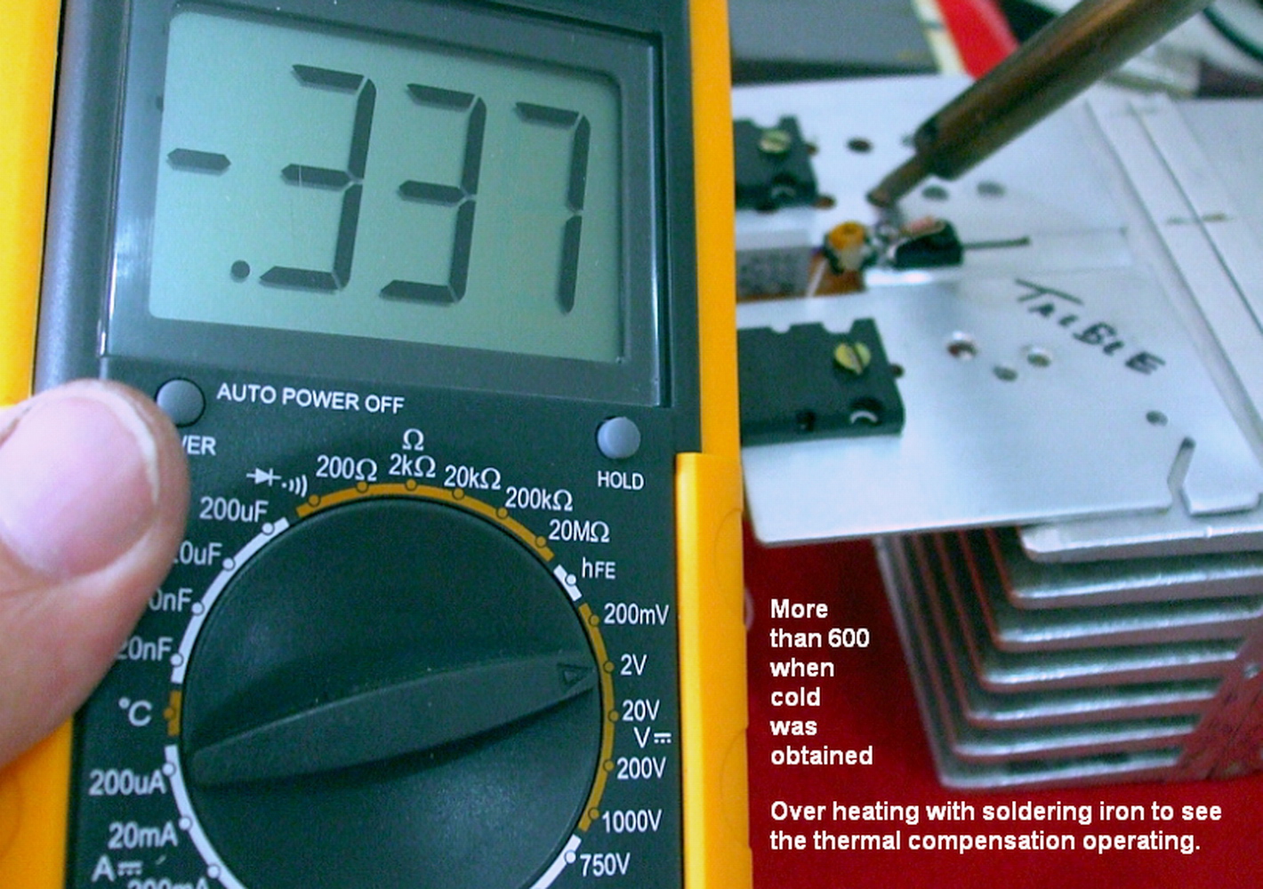

Dark video removed... i have made a new one..and will not be the last one
The amplifier is beeing adjusted.

all adjustments are tricky and very hard to make...not easy.

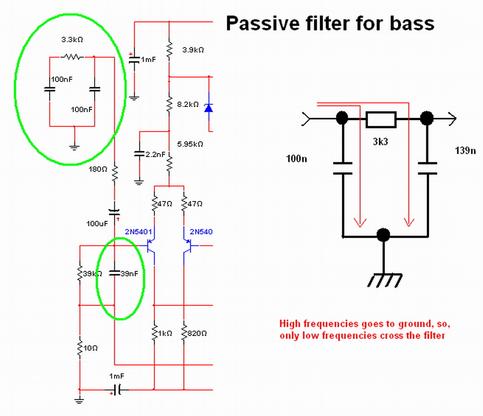

Yes. You should at least use a microphone and some measuring software like ARTA, Speaker Workshop or so.
You seem to have chosen the cross-over frequencies arbitrarily and use only 6dB/oct filters. That might make integration even more difficult.
Those horn drivers you use for mids and highs according to this video will probably need steeper filters and higher crossing frequencies. As a wild guess I would recommend 6-8 kHz between mid-range and tweeter with 12 or 18 dB/oct. The mid-range does not look as if it could do much below 1,5 kHz or so, where it also needs 12 or 18 dB/oct. Although with a bit of equalizing it could make the tweeter obsolete.
I have not appreciate your word arbitrarly, because seems negative
I would like to remember you, dear Paciific Blue, that we all have brain inside the skull...no one is different..we all can take decisions..and this is to behave abritrarly choosen options..we do that all time long..but seems a little negative in my point of view.
I have used the tweeter and midrange technical specifications to choose the frequencies.
Already did this morning the equalization and it is perfect now...with 6 dB or other range of attenuation you have mentioned.... sound is unbeatable!
I had not intended arbitrary as negative. It was just an impression I got, because you usually explain a lot about the how and why, which you did not do with regards to the crossover. And I remember one post of you, where you wrote that your attempts at speaker design in the past did not leave you satisfied. Your psychology studies will help you understand, how my brain made a connection and created the illusion that I could help you there.
Judging by the video the crossing frequencies seem unfitting to the drivers. Specifications that lead to those frequencies, may be a bit optimistic and driven by the marketing department. While 4 kHz is possible for the tweeter, if stretching it a bit, 300 Hz for that mid-range is physically impossible. The lowest frequency for that size of horn is somewhere in the region of 700-800 Hz and you only get useful sound pressure about 1 octave above that region.
That's what counts, even if it only holds true until the next project.

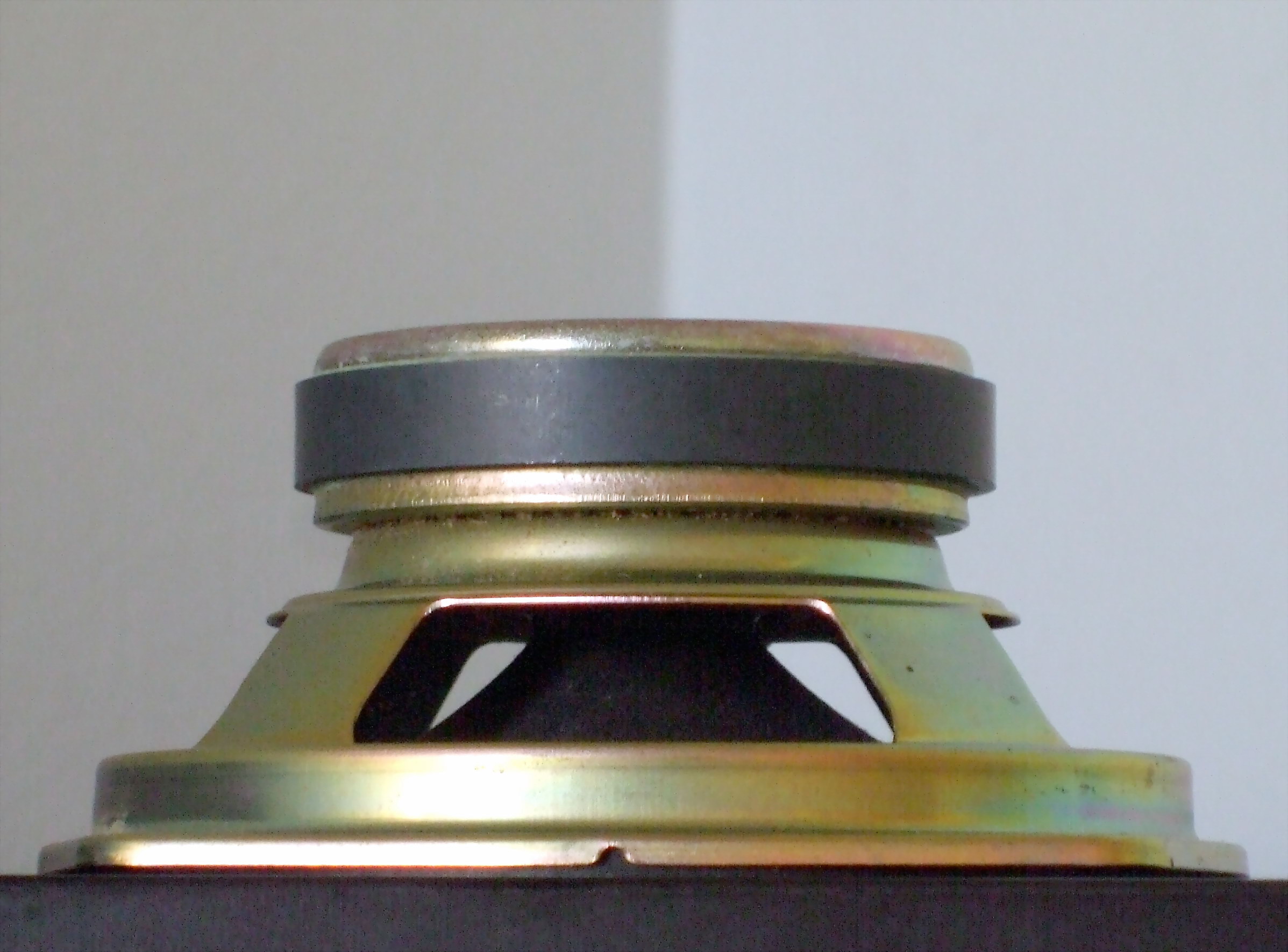

I am use low midrange also, sorry if i had not said that... it is a 5 inches LG
driver stollen from an old Philco audio system.
I am having a capacitor (for a while as i have not made the tetra amp) to the horn..it cannot do nothing lower than 3K with reasonable efficiency (real life test listening)...so.... the LG speaker is doing the job reproducing that rich part of the spectrum...capacitor block bellow 3K (attenuate) and this way things goes fine.
This was explained into the Dx BiAmp thread....into TriAmp i have forgot to say..i am using a small box while i prepare a good Midrange enclosure...they use to be good when rounded..something alike old helmets.

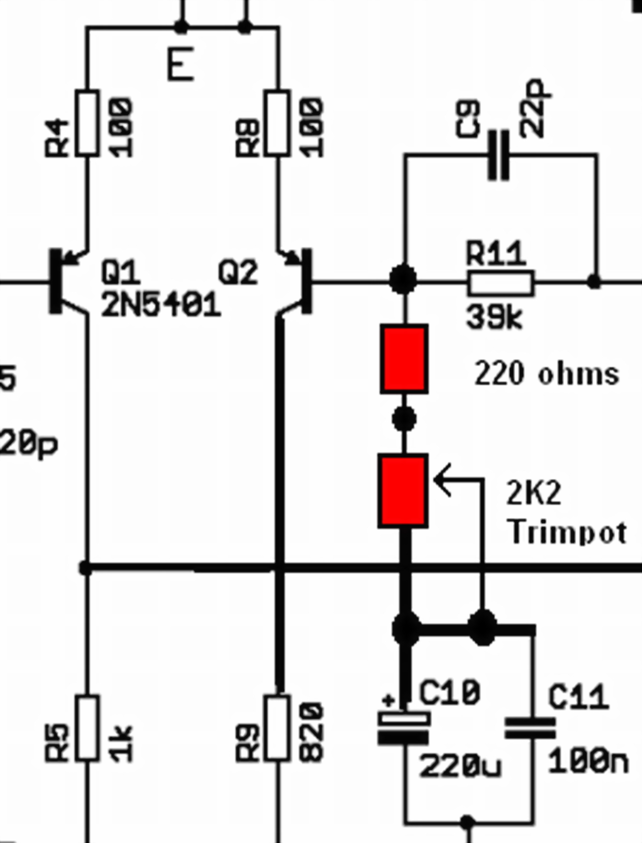

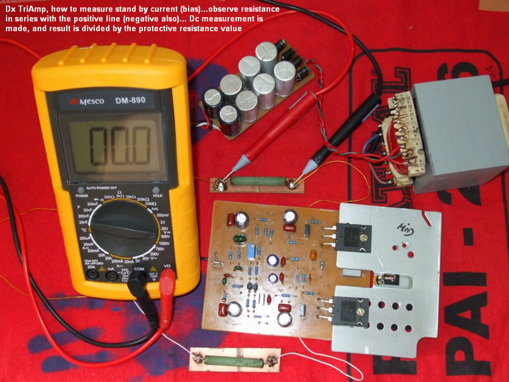

To adjust, or equalize your TriAmp, use the resource you have
Mainly your ears, the best wide world instrument for human perception...them some meters, microphones, spectrum analiser, anechoic chamber, decibel meter and so on.
Place your bass potentiometer mid range (12 hours), the same for bass and treble.
Adjust your musical source (CD player, DVD player.... the source you have) to send flat music (attention, flat!..if Ipod, then be sure it is flat!), them tweak each amplifier gain potentiometer to ballance the music to your home/speakers/musical style and sonic taste.... also your ears (mine are old)
Made?.... ready to go!
Images shows the Dx Standard, of course you will adjust your version, the Dx TriAmp bass unit, Dx TriAmp midrange unit and Dx TriAmp treble unit.

I think making filters at the input stage will reduce the cost compared to passive crossovers. correct me if im wrong.. So finally we will have a cheep, high quality, reliable and power saving solution thanks to uncle Carlos.. 😀
keep it up !
I had the same feeling that why we waste energy and gold for mid and high frequencies but I could never asked the question because I dont understand some technical terms like saturation, clipping etc... but your text are good enough to understand the benefit of making triamp.
keep it up !
Thank you lycanlk....but i am afraid the cost will be lower
Those passive filters uses low voltage capacitors, and they use to be very cheap....also a single resistance or two will not be expensive.
What i do not know, for a while, is the sonic advantage for passive or active...i have to assemble both and compare.
Active can have higher level of attenuation, i do not know if i need that or not..i suppose not.
Passive distorts...but integrated circuit also distorts.
Passive does not need supply, when active will need a 12 volts symetrical supply.
I am not sure...but i think passive is natural.... seems more simple... and simple use to be better...we gonna see in the future.
Also, all of you can try and post your thougths about.
Also, into amplifiers there are some minor modifications..and this cost a little...for the bass amplifiers you will have bigger condensers, but this will be needed for active and passive..so, the cost increase does not counts to passive or to active.
To the midrange amplifier you have reduction of values to capacitors..this reduces cost when we reduce electrolitic condenser capacitive value
Also to the tweeter the cost is reduced.
The complexity into the circuit is very reduced too...easier to build.... operational amplifiers, in special if "golden" or "fashion" models may cost a small fortune!

Carlos,
are you still using 16 Volt Zener for the "CCS" on your diff.amp?
Why not using a transistor and do a decent CCS, or maybe you are fine tuning the distortion signature of your amp?
Cheers Michael
Cheers Michael
There's a say in my country... deeply used to football
- "Never change the team is winning....keep it the way it is!"
It is working Ultima!.... why to put an indecent CCS?
Wanna modify?... put a 12V zener or a 15V zener...but do not put wattermelow into big trees (because watermellow is big) .... when falling down, because mature and ready to be consumed, it can fell down and smash someone's head.
In my country, in the audiophile groups... CCS is understood as
"começou cagand o som"..... this i cannot translate..some words had no translation possible!... maybe "he started shipping sonics"
That thing sounds stérile, lifeless...aaaagh!... this is subjective, personal, my opinion...not a rule or a law..this is what i think...you should think different...no problems.... not all people surrounding us are perfect (hehehehe)
ahahahahahah!
Carlos

The use of CCS or resistance,or zener, or current sink options
into the differential…well… all those things are very easy and
fast to check…the replacement of a CCS by a single resistance
is fast and easy, and people will be able, doing this way,
to “see”, to listen the real thing, to realise what is really better.

ok Carlos we can stay with the "indecent" Brasilian CCS! 🙂
I don't know what rails voltages you are going for but I really wondered over the choice of 16 V zener when you had it in your initial design with very high rails voltage.
I can understand you if you want to use a resistor, but like in the first example burning away 74 volts and use 16 volts as the stable voltage for your resistor "CCS" is not very sensible, its like switching place on collector and emitter on a BJT so it is like "up-side-down", in fact it will still work but quite lousy performance and not so reliable, I hope you understand what I mean.
If you want to stay with the resistor design its enough with 2 resistors and 1 capacitor and 1 zener.
Cheers Michael
Cheers Michael
