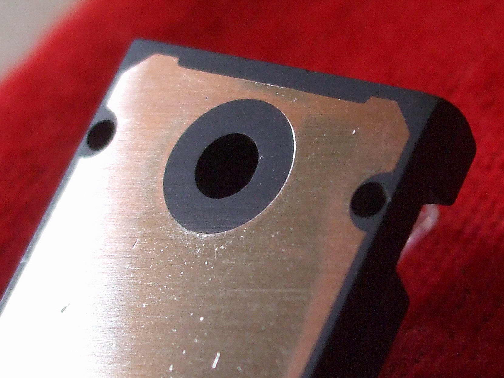

The back side, the transistor's back metal plate used not to be flat
this results the parts you see as copper colour are the parts are alike mountains and they would touch the heatsink..the lower parts, the valleys, the deep parts are the ones not touched by the waterproof, grain 500, sandpaper
The sandpaper was placed over a flat surface, a glass plate..and then i move the transistor to erode till turn it flat..you see material was removed into the parts you see copper...now it is flat.
If you do not do that, then the parts are higher, the projections, to the metal bubbles, the peaks, the hills, the mountains into the metal surface, will be the ones will touch the heatsink..this will reduce (a lot) the heat transference.
Check your transistors..you gonna be very surprised.
regards,
Carlos
regards,
Carlos

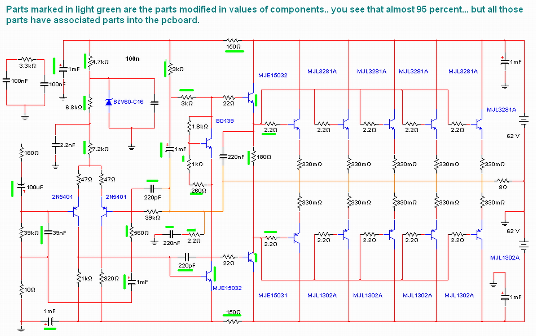

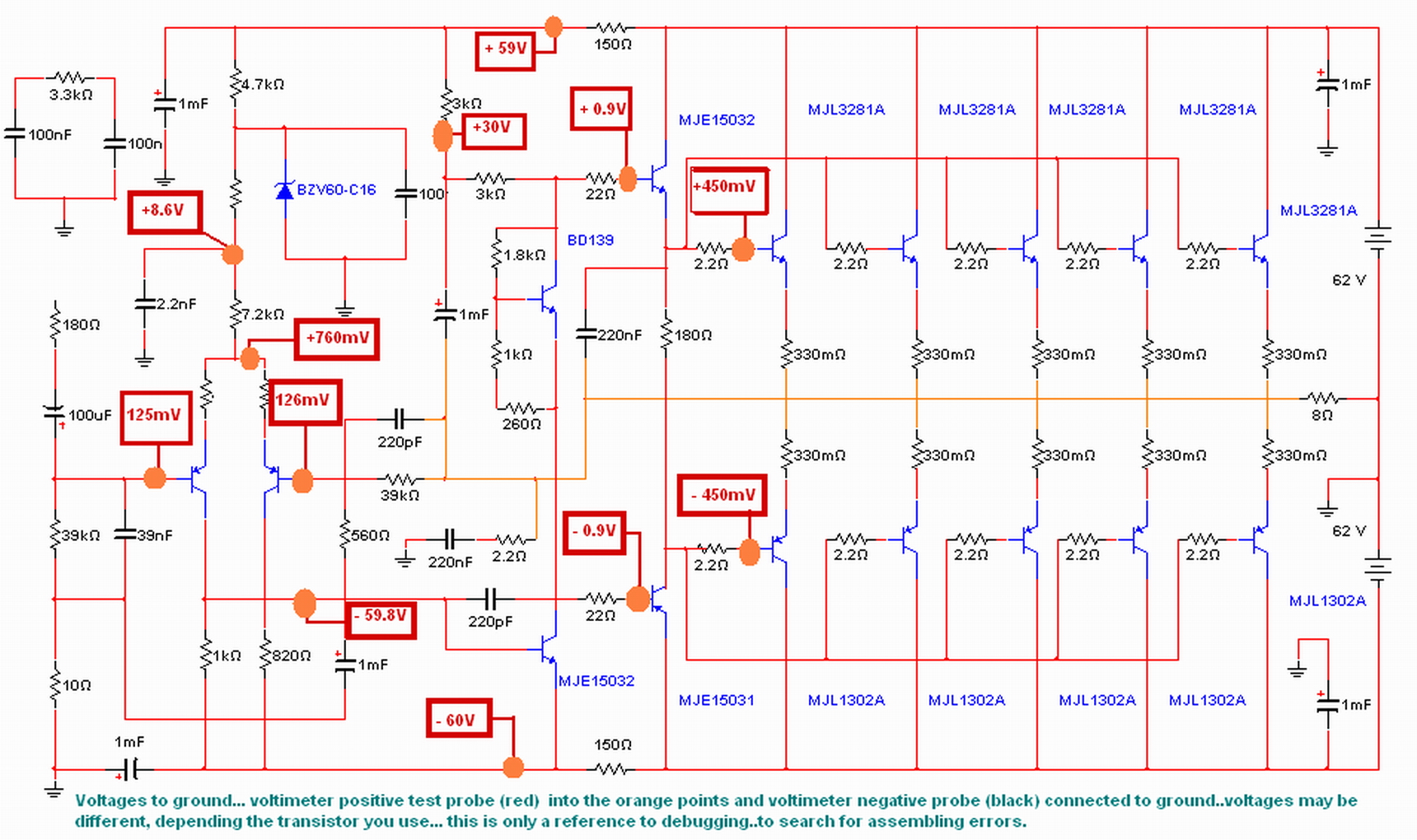

Now, some circuit details
Dx Amplifier – bass unit – to work with 62 plus and 62 volts minus
Was made (adjusted, tuned, tweaked) to work from 1 hertz to 300 hertz (-3dB)
Sensitivity – 1 volts rms to full rated unclipped output. (39.75 Volts rms)
Input impedance – 39K
Output impedance – 8, 6, 4, 2 and 1 ohm.. depending the quantity of power
transistors used into the output
Power amplifier details with sinusoidal input signal, and delivering 39.75 volts to
the load:
197 watts rms at 8 ohms, 200 Hz input with 1 volts rms of level, rail current
2.26A, and supply voltage at 62 volts to each one of the rails.
263 watts rms at 6 ohms, 200 Hz input with 1 volt rms of level, rail current
2.98A, and supply voltage at 62 volts to each one of the rails.
395 watts rms at 4 ohms, 200 Hz input with 1 volts rms of level, rail current
4.48A, and supply voltage at 62 volts to each one of the rails.
790 watts rms at 2 ohms, 200 Hz input with 1 volts rms of level, rail current
8.90A, and supply voltage at 62 volts to each one of the rails.
1135 watts rms, 1 ohm, 200 Hz input with 1 volts rms of level, rail current
14.9A, and supply voltage at 62 volts to each one of the rails.
regards,
Carlos

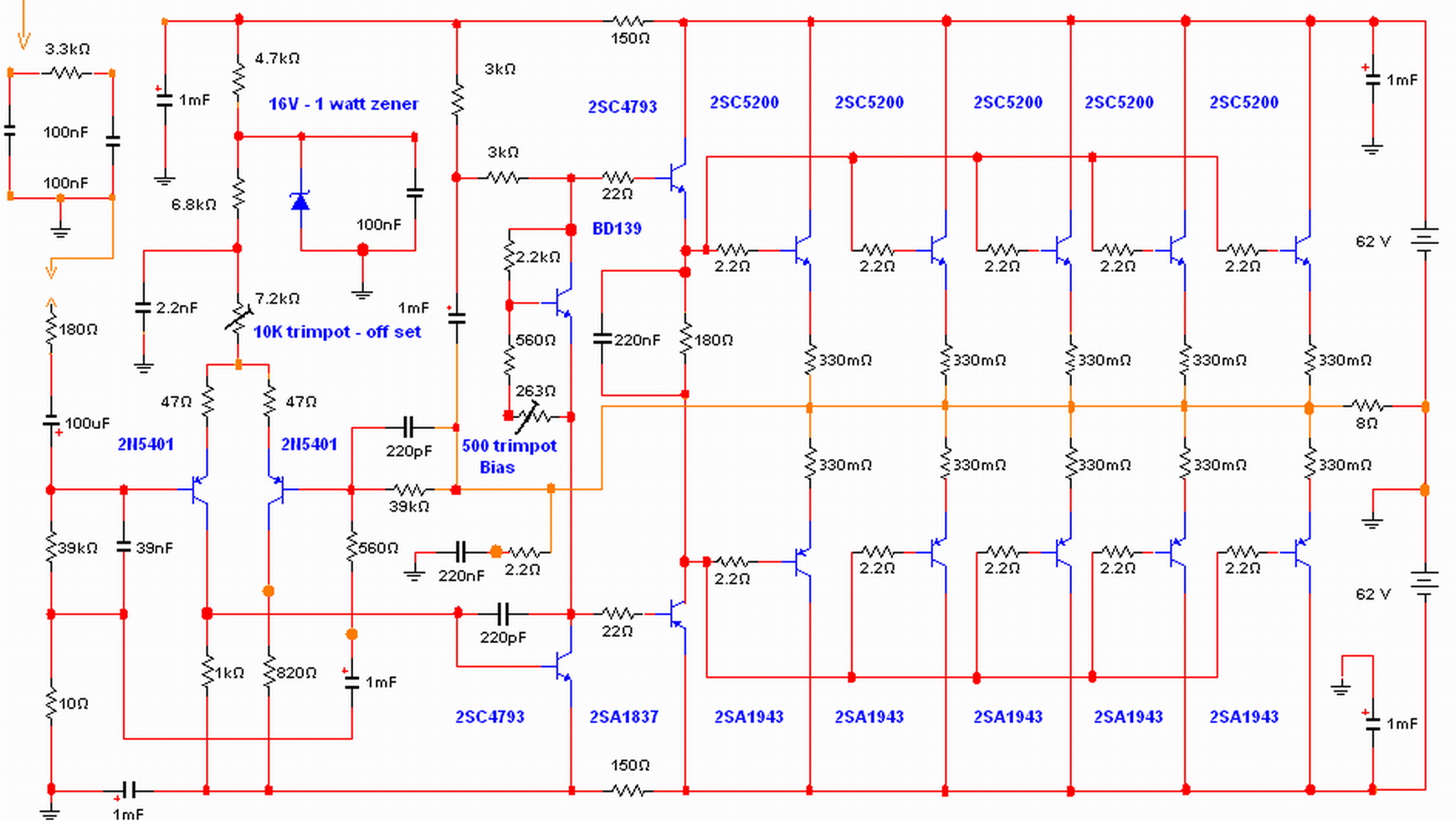

Continuing describing the power amplifier
Continuing with the specifications and details
The off set (Dc milivolts present into the output terminals due to
unmatching of transistor devices) is adjustable tweaking the 4k7
trimpot, pré adjusted to 3900 ohms (R23)..of set will be around
1.2 milivolts
Current crossing each power transistor is measured monitoring
voltage Dc, milivolts range, directly picking the voltage into the
emitter resistances extreme leads (0.33 ohm)… the voltage
to be measure may be 656 microvolts..and this results into 1.98
miliampere of current crossing each one of the power transistors
colector to emitter junction into stand by mode, with the input
shorted, so, no signal entering the amplifier circuit…. maximum
tollerable current to each transistor is 5 miliamperes each one.
Positive rail stand by current..having base shorted to ground, so,
no signal driving the amplifier…iddle mode, will be 37mA..and
this is measured using supply series protective resistance, that
resistance value is 10 ohms (10 watts minimum) and the voltage
measured directly into the extreme terminals will be 370 milivolts…
and this happens, only, when the power transistor emitter currents
are fine..or … measuring less than 2 miliampere to each power
transistors..and when they are 5 units…having more transistors, then
the current into stand by mode will increase depending the number of
transistors used.
Negative rail stand by current, having base shorted to ground, so, no
signal driving the amplifier… iddle mode, will be 29.4 mA…and this
must obbey all conditions written above….. this means 294 milivolts
measured over 10 ohms protective resistance.
regards,
Carlos

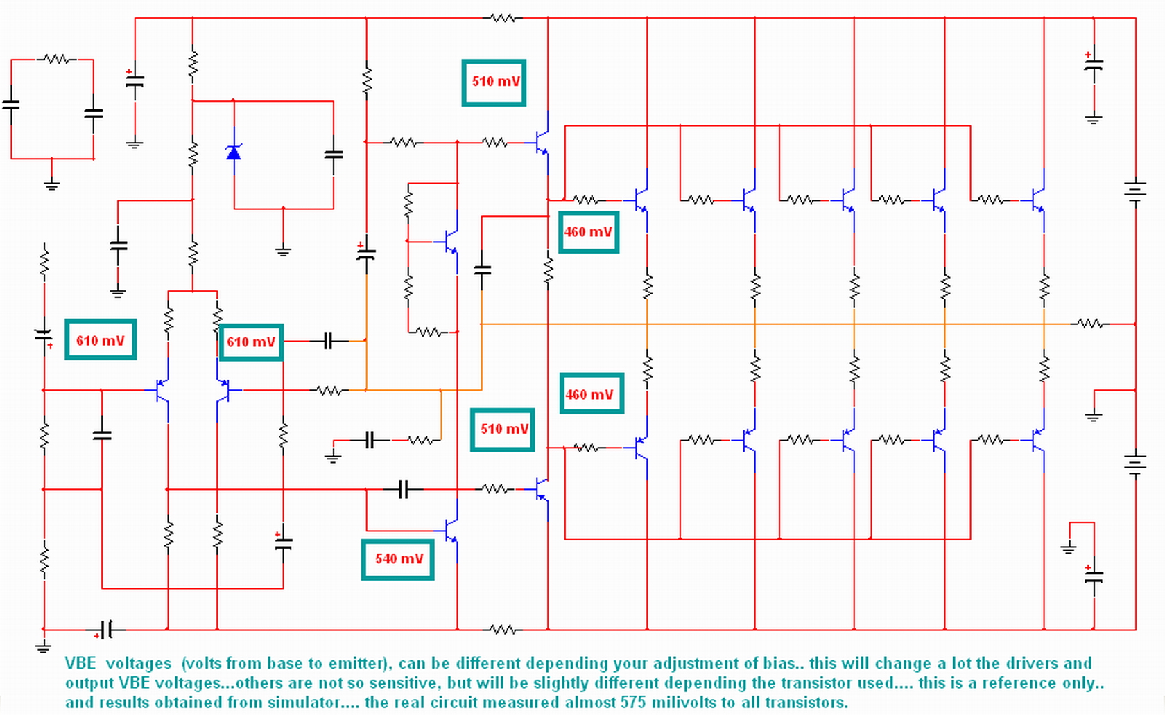

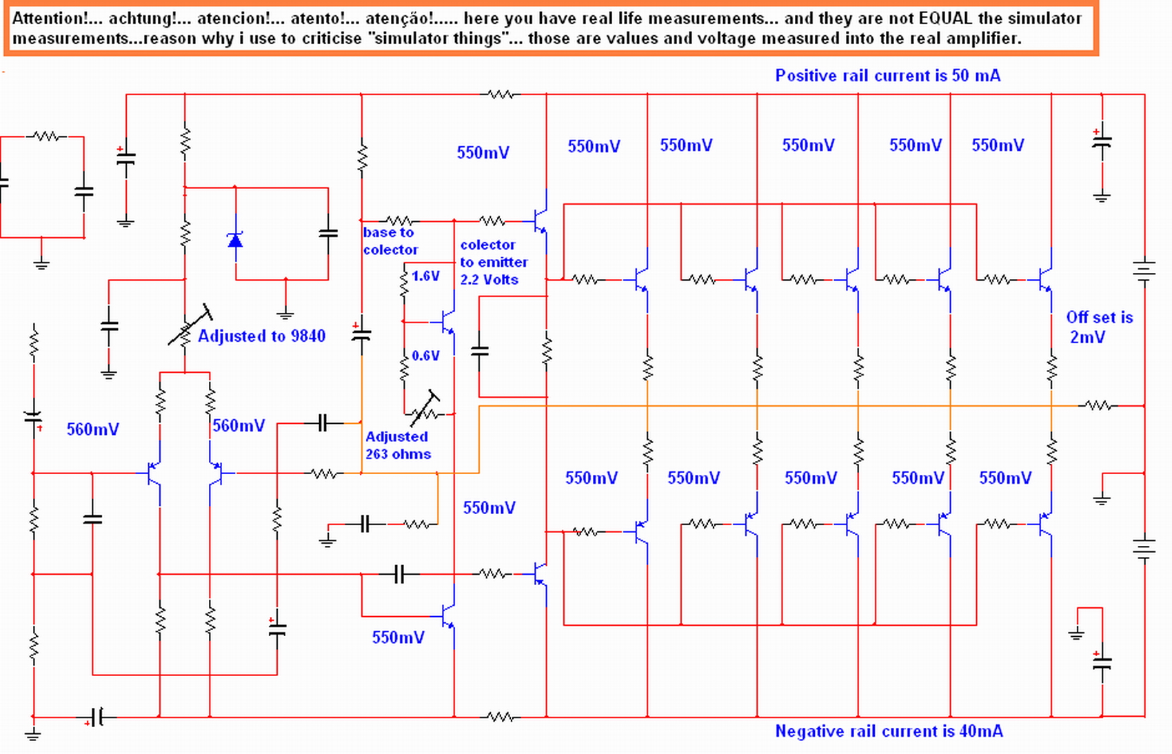

Some currents and more details
Long tail current is 1.42 mA, so, half of that to each transistor into the differential pair
Bootstrapp/VAS current is 9.68mA
Driver current is 4.86mA
External VBE multiplier has 1800 ohms resistance from base to colector and a series of resistances from base to emitter....the first resistance is a fixed resistance of 750 ohms (or other you choice) and the variable one (trimpot) is adjusted into 150 ohms (can be a 220 ohms trimpot)...so..total resistance from base to emitter is 900 ohms... set this way during start up.
regards,
Carlos

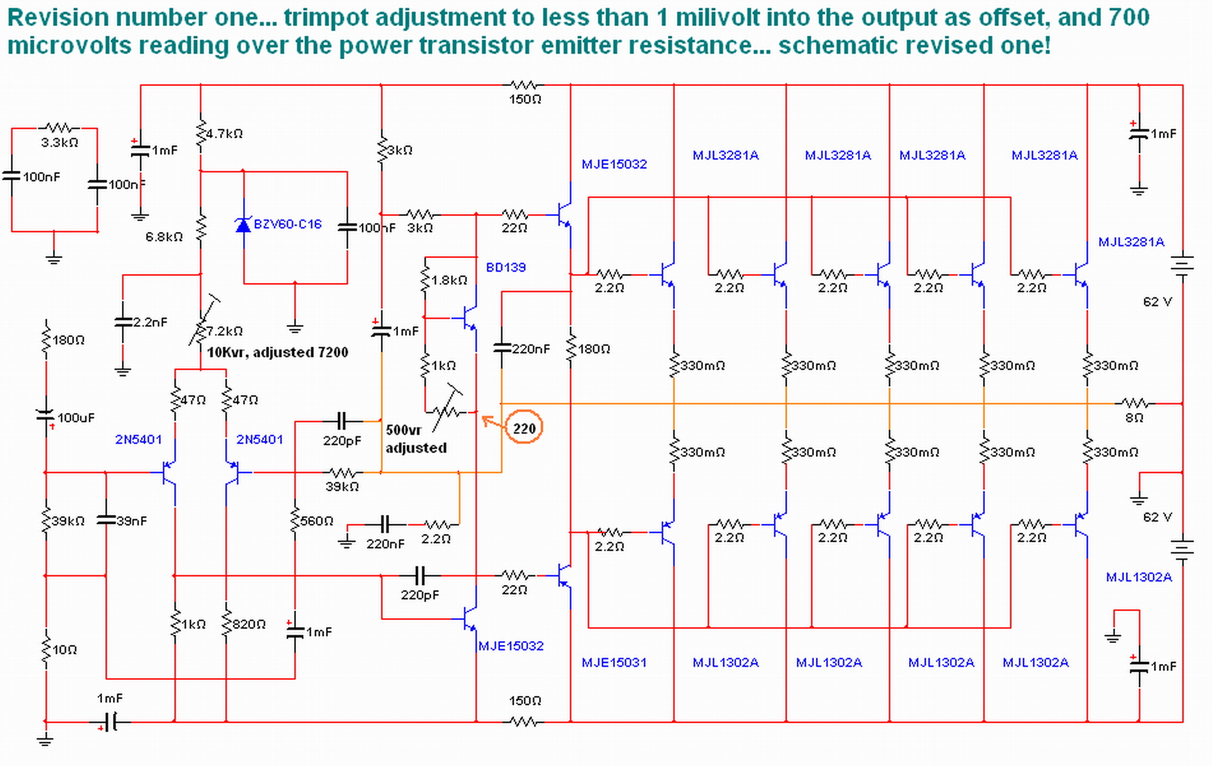

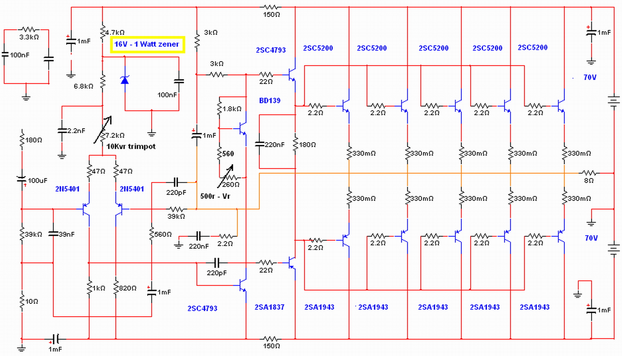

Post 44 had errors, reason why i am posting once again with corrections
unmatching of transistor devices) is adjustable tweaking the 10k
trimpot, pré adjusted to 7200 ohms (R23)..of set will be around
1.0 milivolts
to be measure may be 750 microvolts..and this results into 2.2
1.0 milivolts

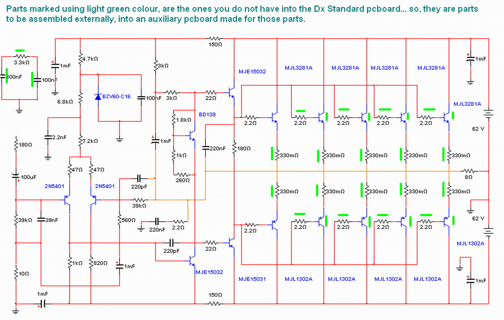

Parts that does not exist into the Dx Amplifier standard pcboard
The one you can find at Greg Erskine home pages:
http://users.tpg.com.au/users/gerskine/dxamp/
image attached.
regards,
Carlos

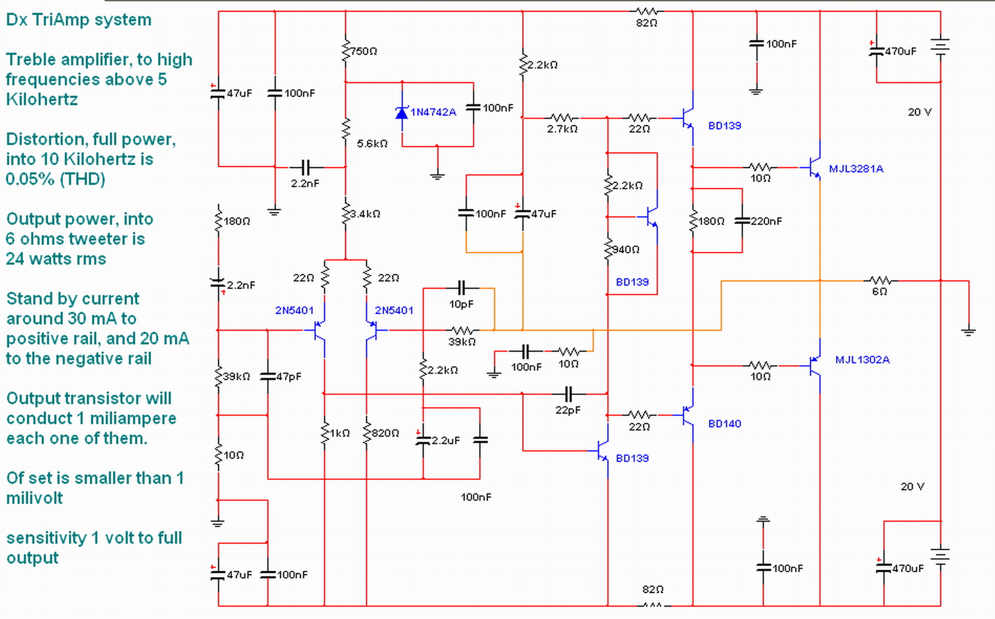

Revision made after a second check up into the real amplifier VBE voltages
Image one - a revosed(II) circuit for 62 volts supply
Image two - a 70 volt supply version asked by Orkut friend
Image three - Real life measurements made... some VBEs, off set trimpot and bias trimpot settings
regards,
Carlos
regards,
Carlos

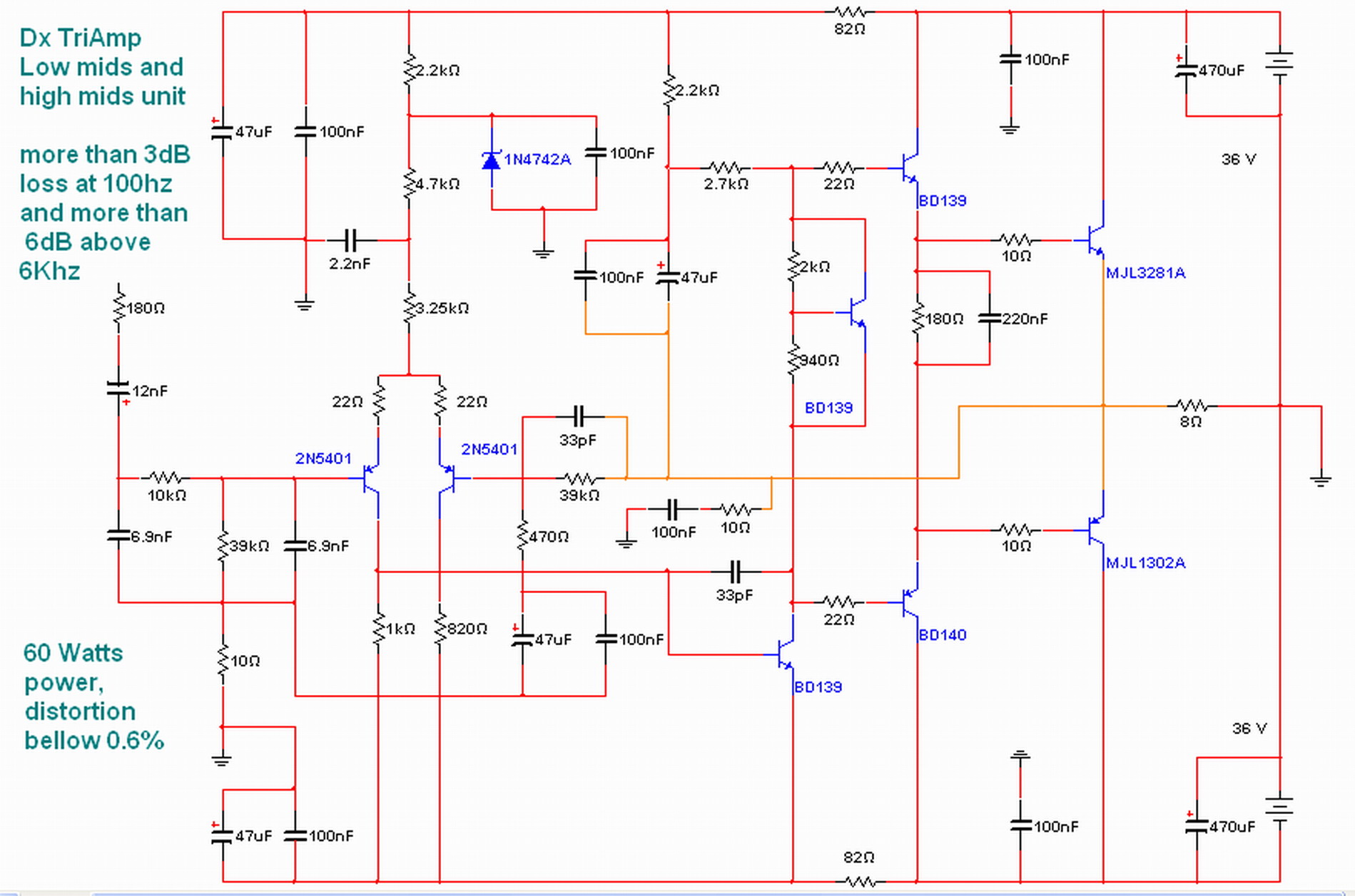

You may be asking yourself why those different supplies and output power?
The bass unit uses 62 volts and produces 200 watts into 8 ohms.
Bass is 60 percent of the total musical power... midrange is 30 percent and treble is 10 percent (normal balance of musical tones).
So, having 200 wiskies into the bass, i will need 60 to the mids and 20 to the treble.
So, my amplifier will have this same power output... or a little bit more into the treble (i am turning deaf because old)
Also because i will use three supplies, and i have, exaclty, those voltages at my home..i have all three transfomers.... i was lucky.
This idea (not mine..very old)...distorts less..you are sending less frequencies, less crowdy waveform to the power amplifier...you gonna have less frequencies to "beat" one each other... lower harmonic distortions will result.
Also..you do not need passive output filter..you can run wire direct to the driver.
Also you gonna be rid from issues related tune your speaker or to tune acoustically your home..having three controls each channel you will adjust to almost all acoustic environment.
Another advantage, separated supplies... 6 supplies will be assembled to a stereo..this will turn those amplifiers free from supply interactions.
The idea is great..the Dx BiAmp is working great and i am sure the TriAmp will be excelent too.
Of course, adjustments may be needed...will keep you informed..
380 clean undistorted, unclipped and continuous sinusoidal power will be sent to each channel speakers set... the amplifier will produce total of 760 watts rms... a very respectable power, if undistorted.
Be happy!
Carlos
