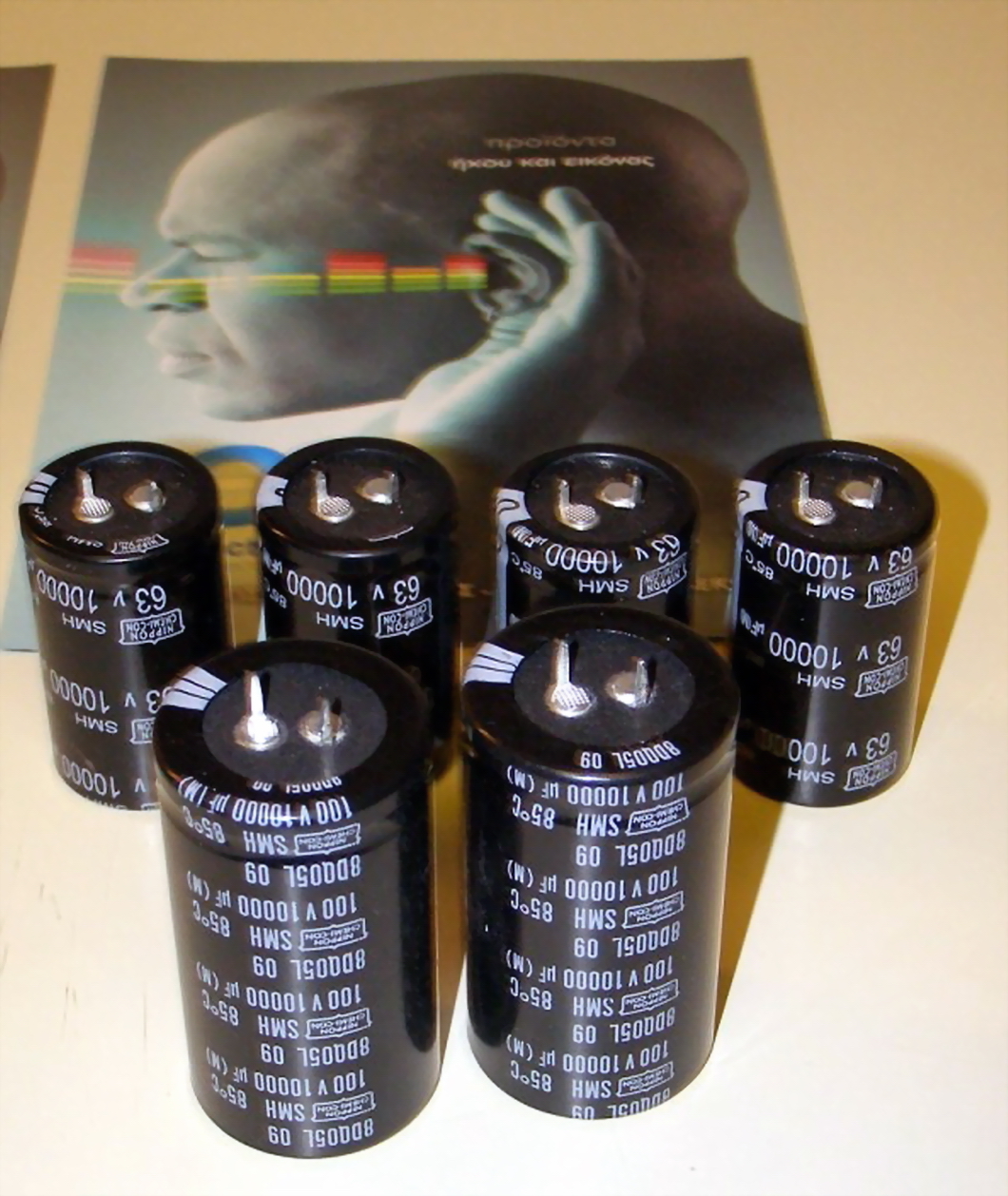

I see you have surprises to me...as Sakis Petropoulos electrolitic condensers (6) and your gift, the signal generator constitutes and a couple of pounds only.
hehehehe....nice that!..... i will have some surprises.....good!
You know... the key ring, or Key chain...those "chaveiros" from Sakis..with the Eastelectronics brand printed are very needed here..also the generator and the condensers.... i will be waiting alike a children.
Thank you, in advance, by the kindness to transport those things to me.. including your gifts to uncle Charlie.

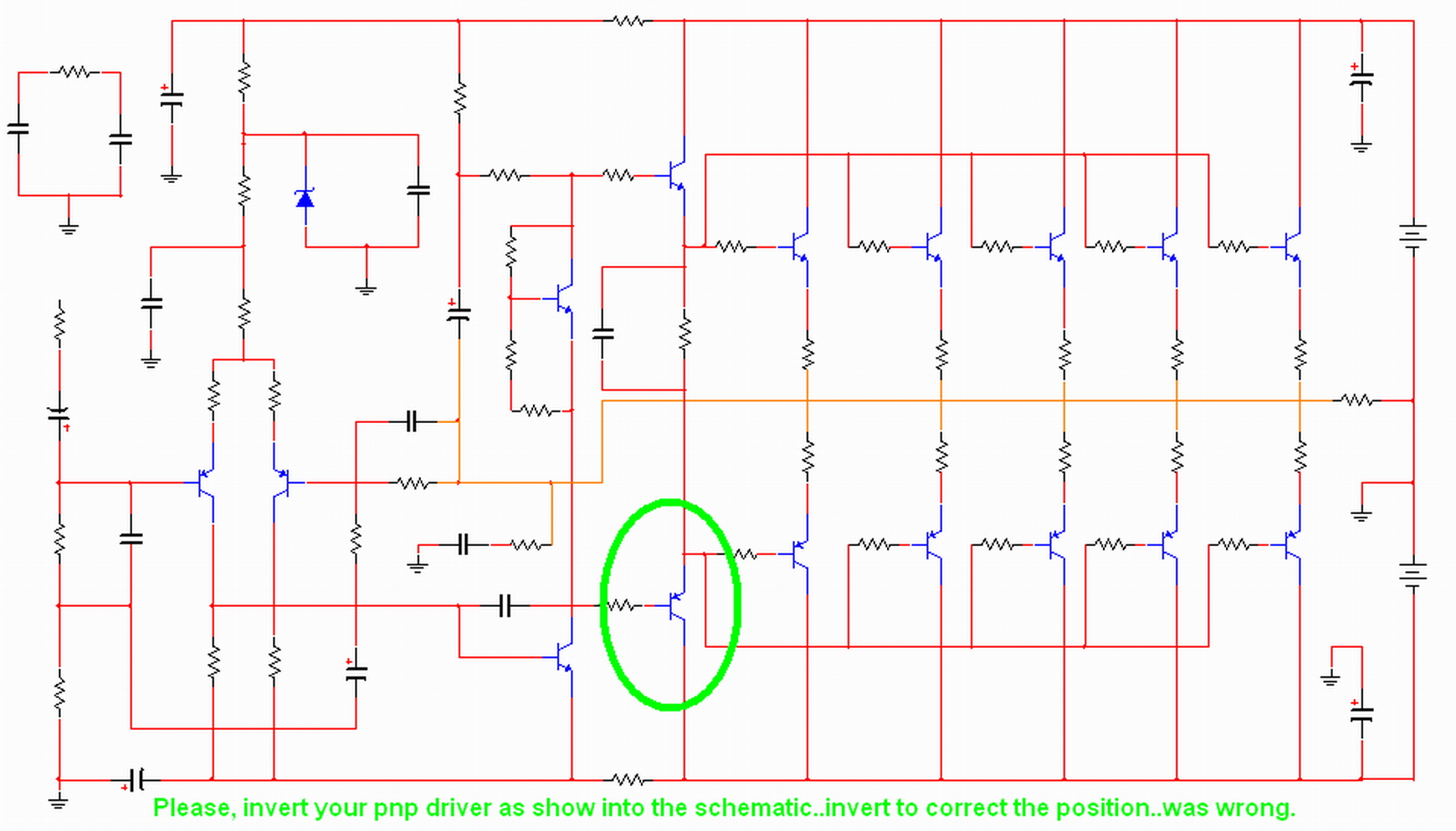

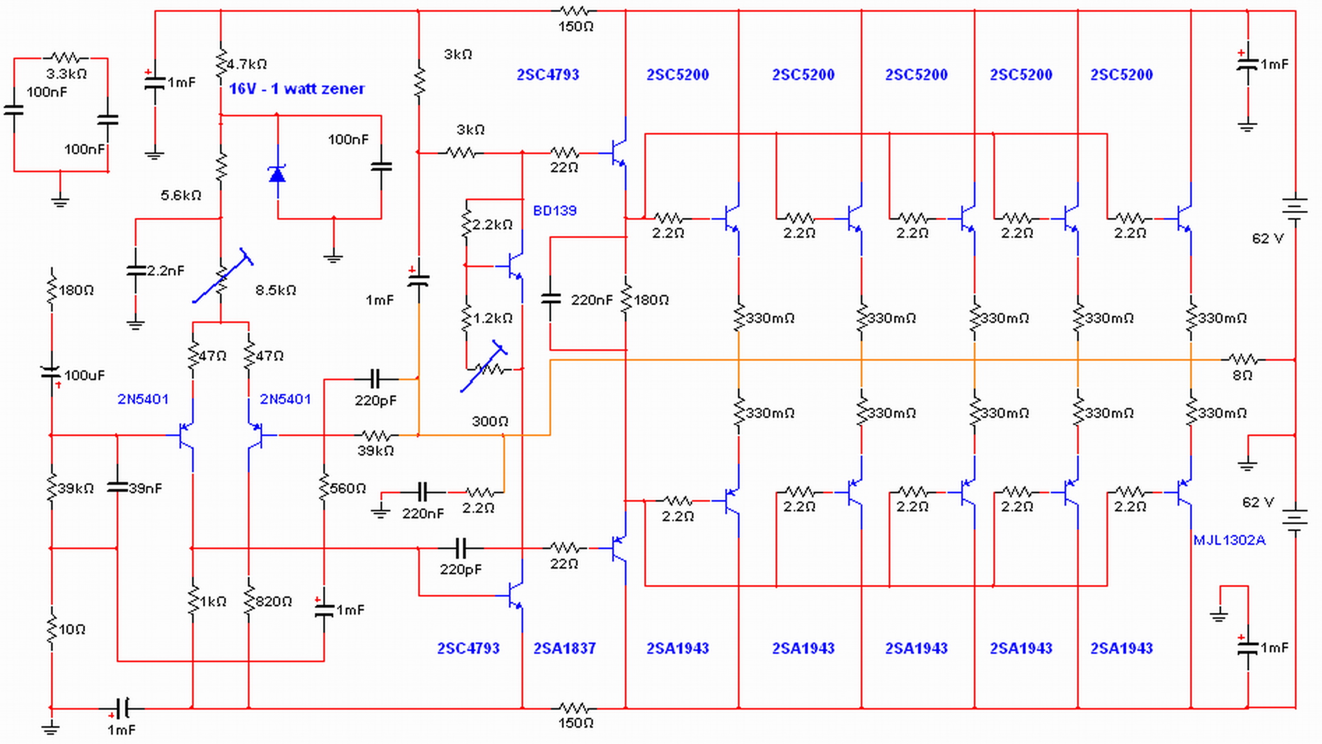

Dx TriAmp, bass unit, 62V, REVISION III schematic
The PNP driver was fixed...not inverted anymore.
Observe new adjustments to the off set and bias....new values.
Current into each power emitter resistances continue around 1 miliampere
Off set continue to be smaller than 1 milivolt (700uV)

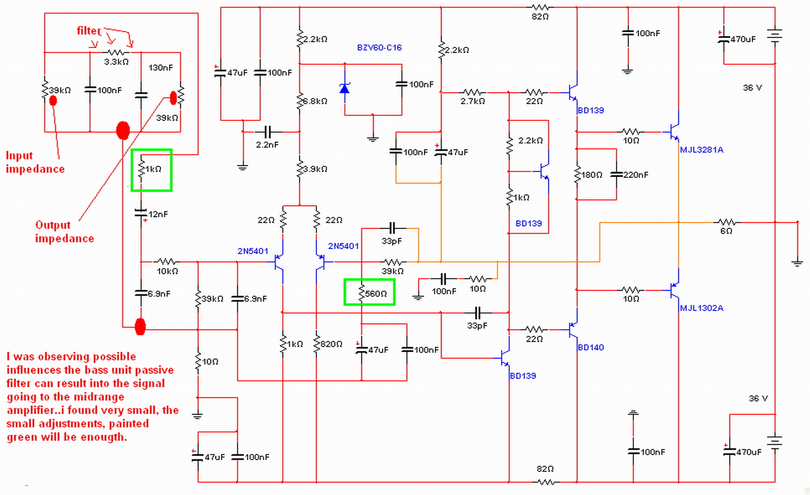

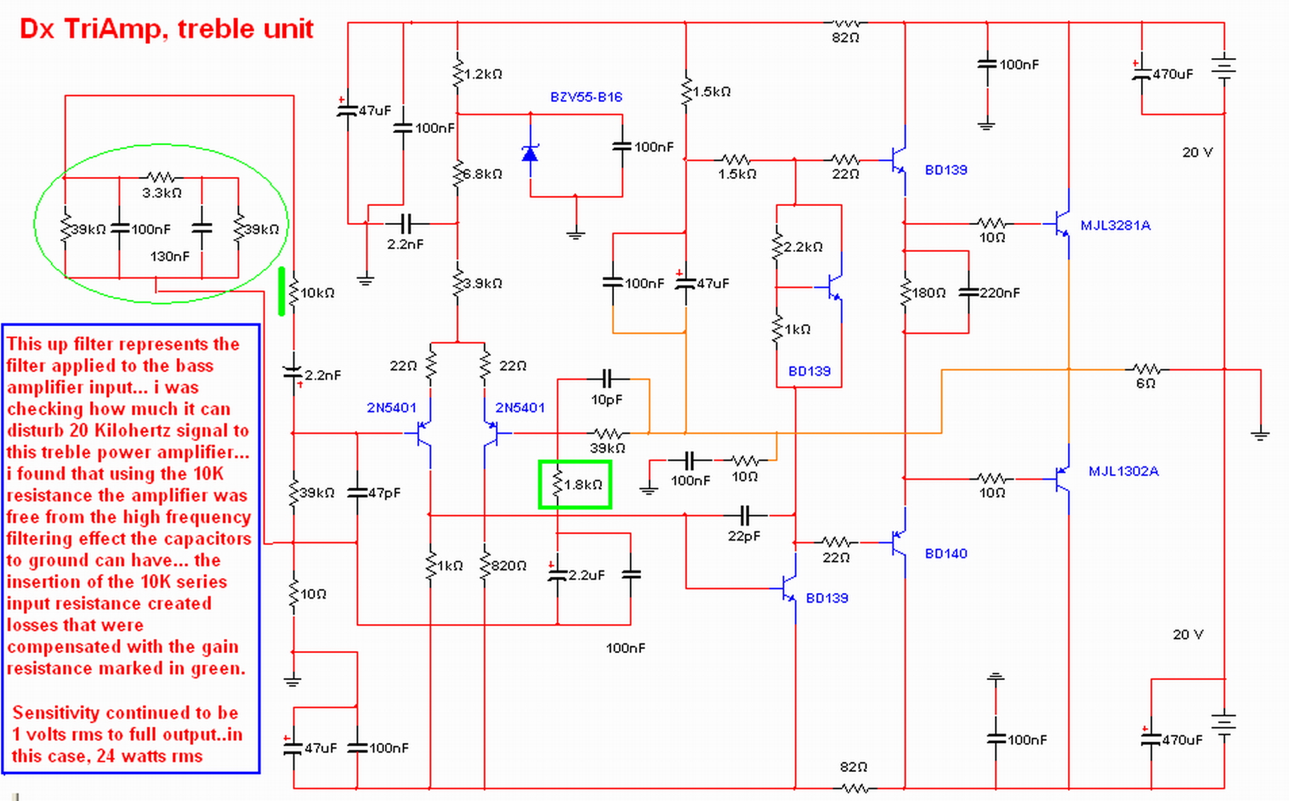

Check up... bass filter possible interference into the midrange amplifier.
Now we have no more worries about.
Real world amplifier is under construction..do not build for a while..maybe some adjustment may be needed... wait.

Carlos - I sure hope you're going to have some air flow in that chassis. You won't get any natural convection through the heat sink fins the way they are oriented. Especially upside down. It will get hot, even if you don't crank it way up.
Please folks, look forward by the schematic i will publish soon
I have test all amplifiers, and have adjusted each one of them...so...there's the final (real thing) schematic i will post latter..the bass unit, the mid unit and the treble unit...and you will see the final values copied from the amplifiers i have adjusted...they will have the input filter coupled to them into these final schematics.

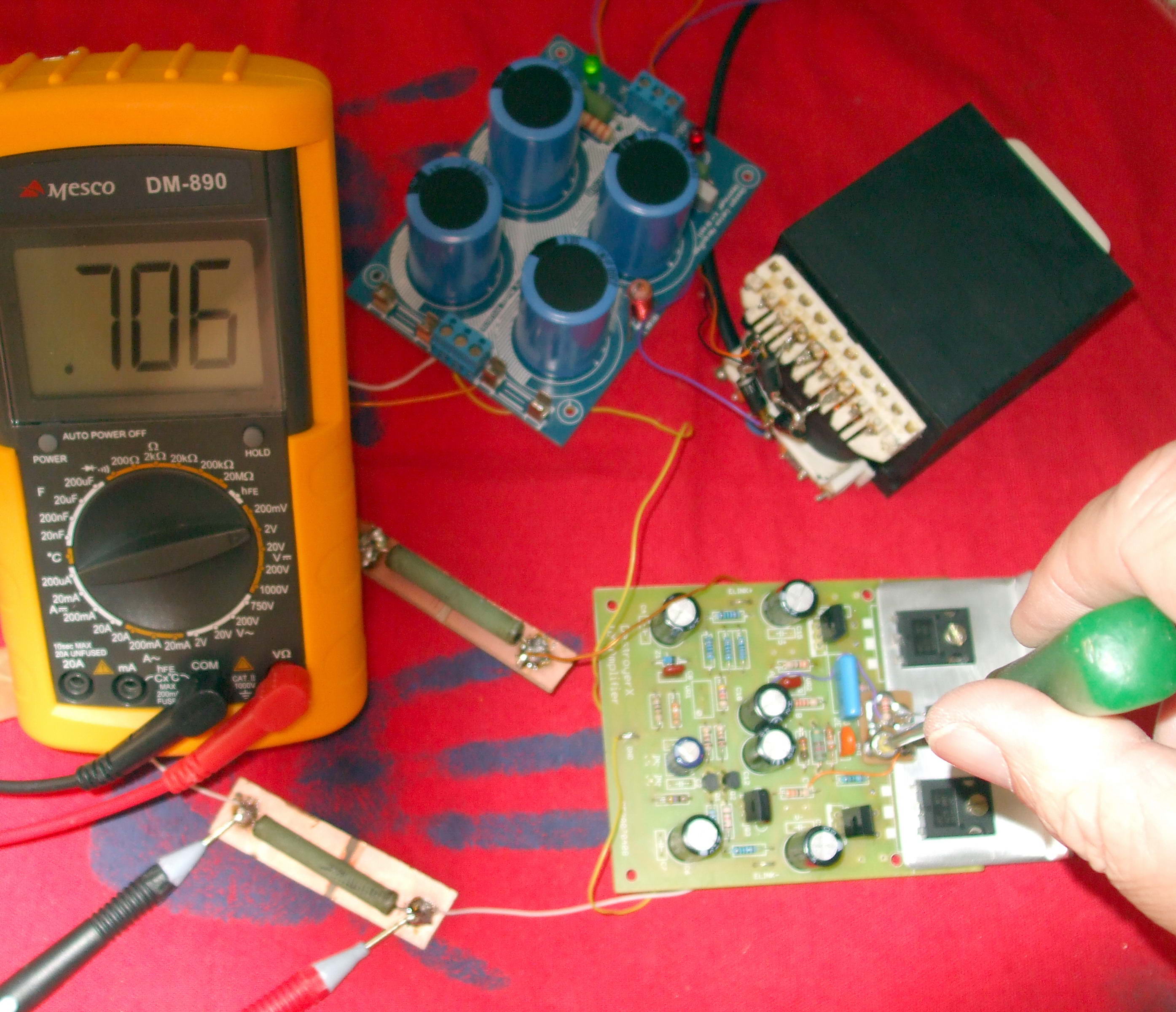

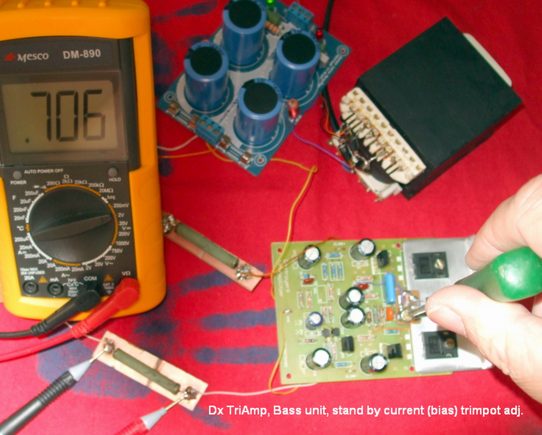

Also i will post some pictures i have made during the bias adjustment (Rudy asked).
Bias resulted adjusted to 54 miliamperes into the positive rail..off set was adjusted to 1 milivolt... each amplifier, including the input filter that produces insertion losses, will neeed 1 volt RMS of audio in the input to full power... and full power is 25 watts rms (6 ohm) to the tweeter, 65 watts rms (6 ohms) to midrange and 197 watts rms (8 ohms) to the woofer.
Total channel power is 327 watts... to stereo the total power is 650 watts rms.
The image shows the bias adjustment trimpot to the bass amplifier....707 milivolts reading over a 12 ohms resistance resulted in 58 miliamperes

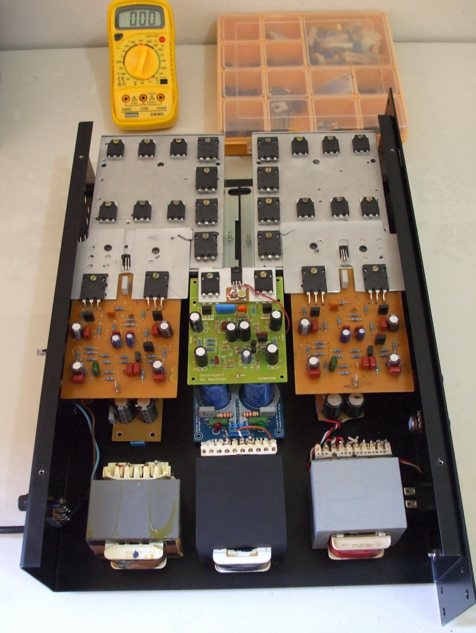

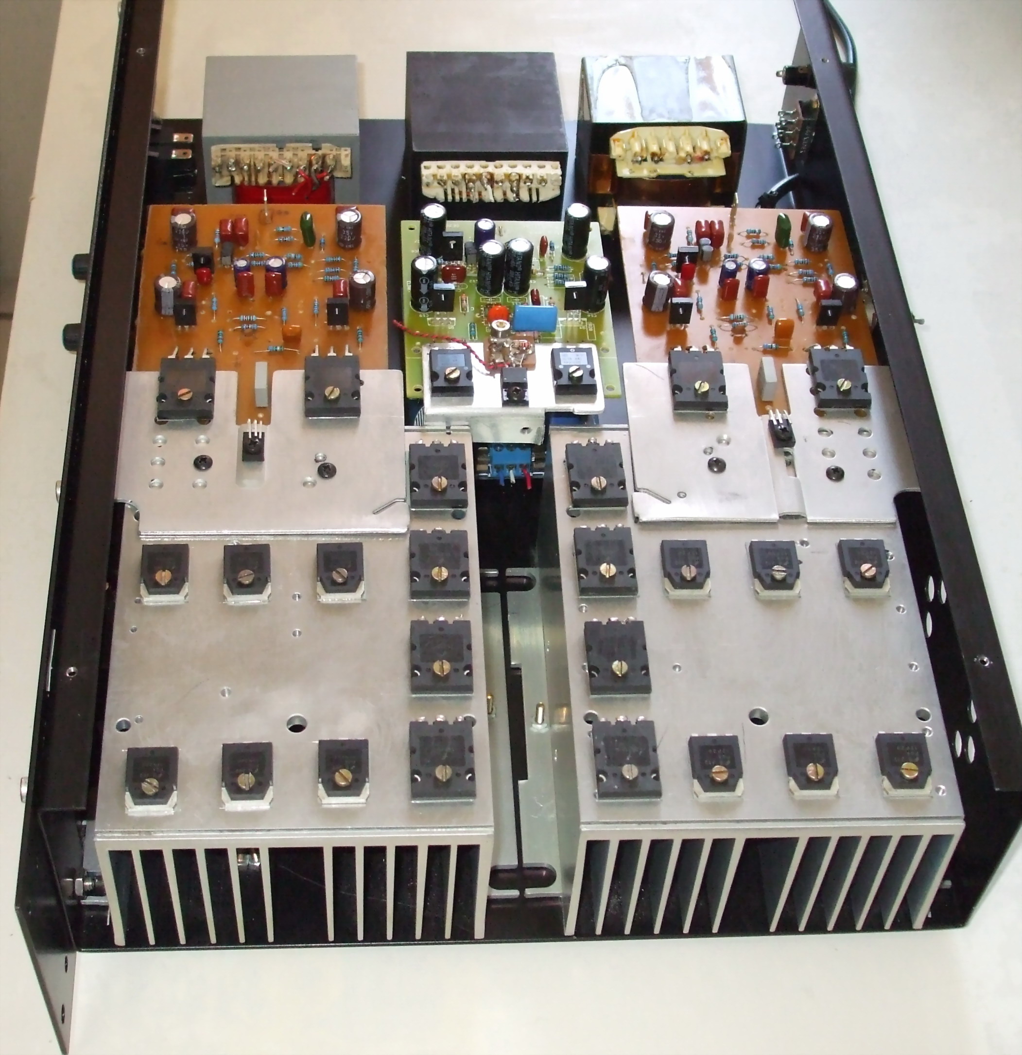

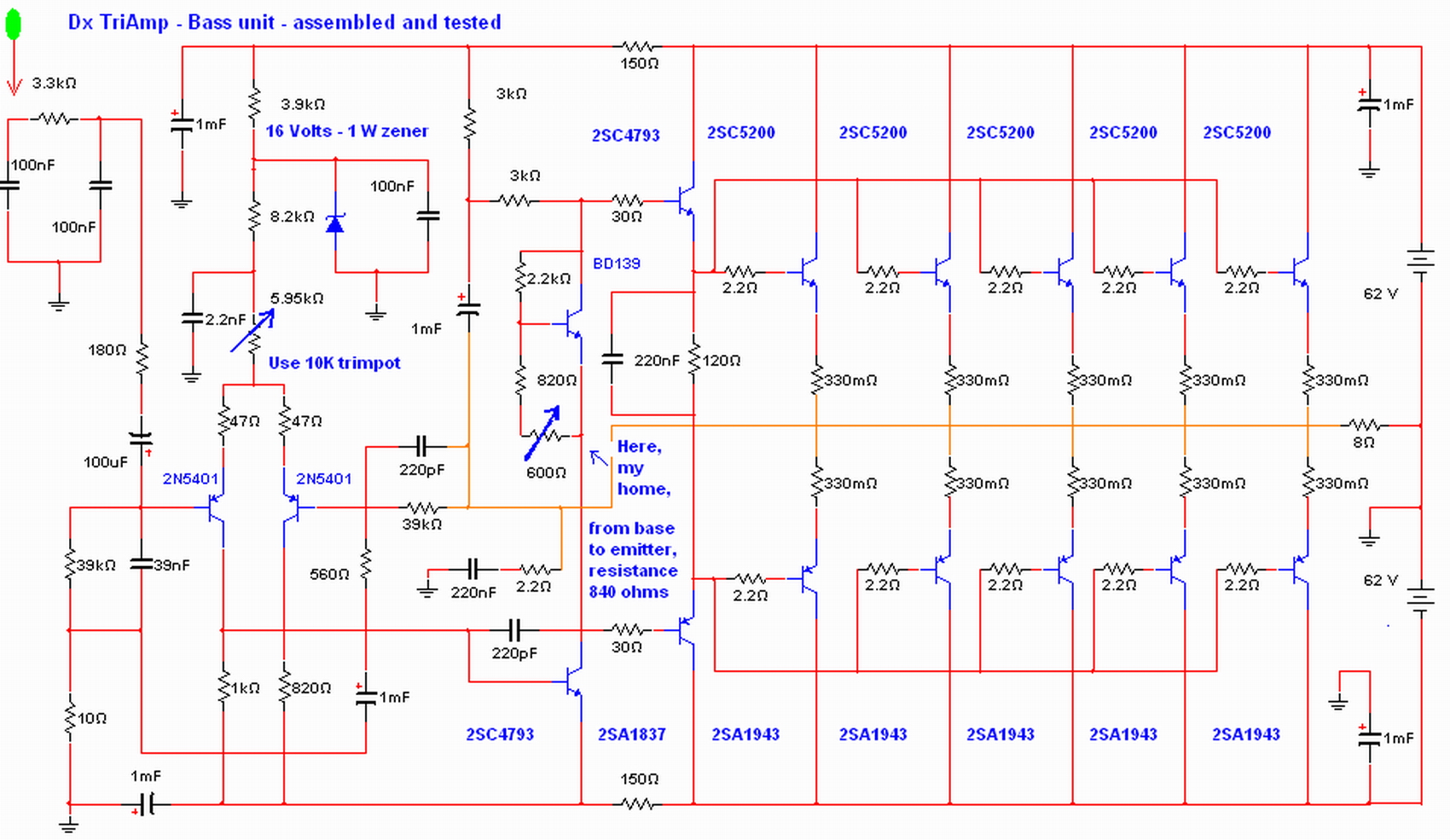

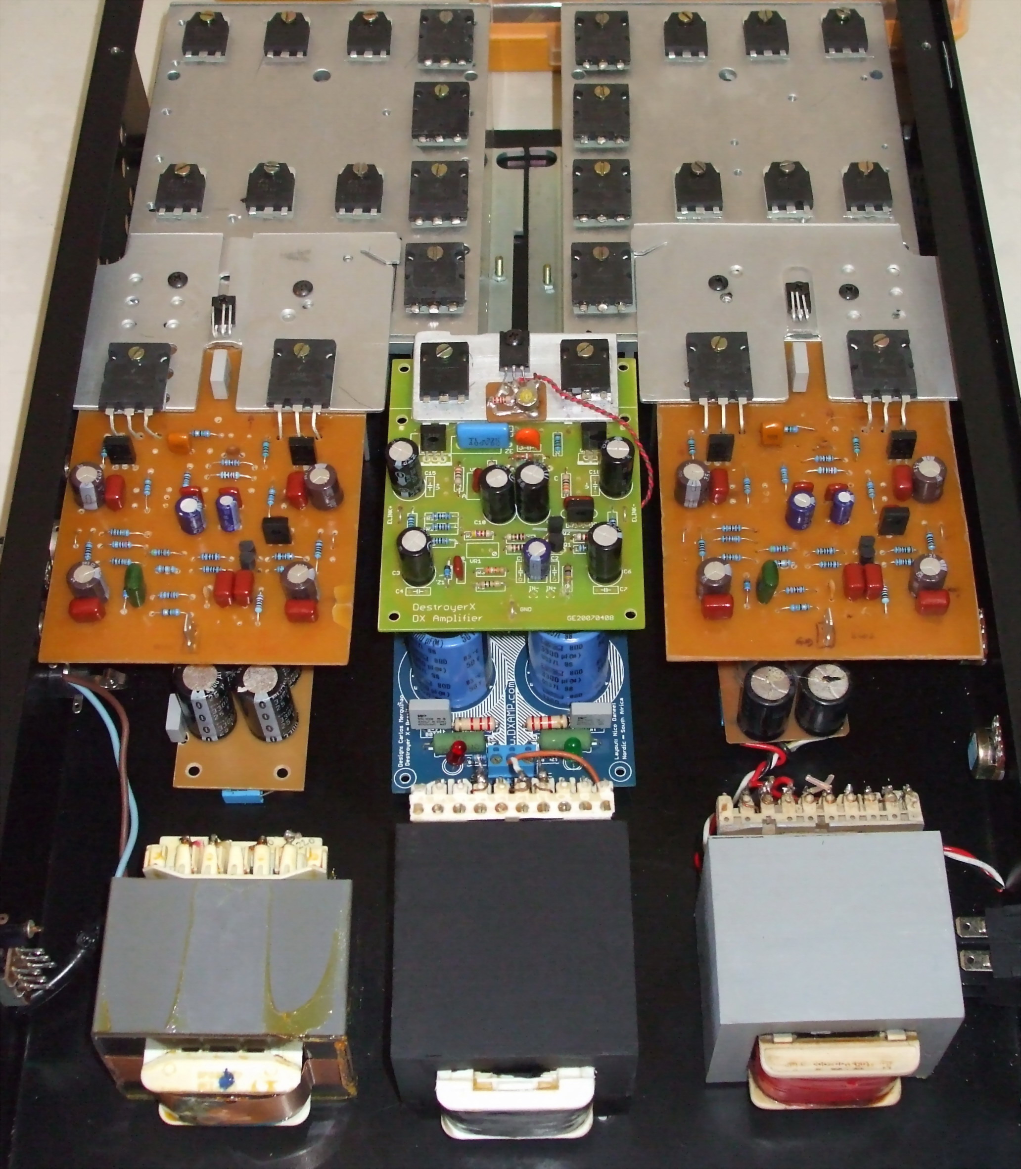

The bass unit was built, adjusted and tested.... worked fine!
Here you have schematic and a pictures.
Production started early morning at the Dx Corporation Headquarters.
I have not listened, all three amplifiers playing with their respective drivers...was listened separated, each amplifier and a driver... i felt fine...but, off course, future small modifications into capacitor values (one or two) may be needed to "adapt/match", your amplifier with your speaker.
