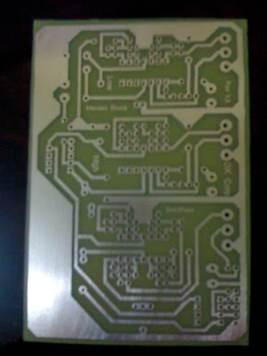

and the same voltage (+/- 62 DC)... i just wanted to design the PCB for folks who are willing to construct that.. I too want to construct and feel the super sounds of Dx triamp. but before that i have to complete Dx standard and DHR turbo housings and speaker enclosures for them.
Since I dont have any technical knowledge to design amps, I decided to draw PCBs. At least I can contribute to Dx corporation in that way.🙄

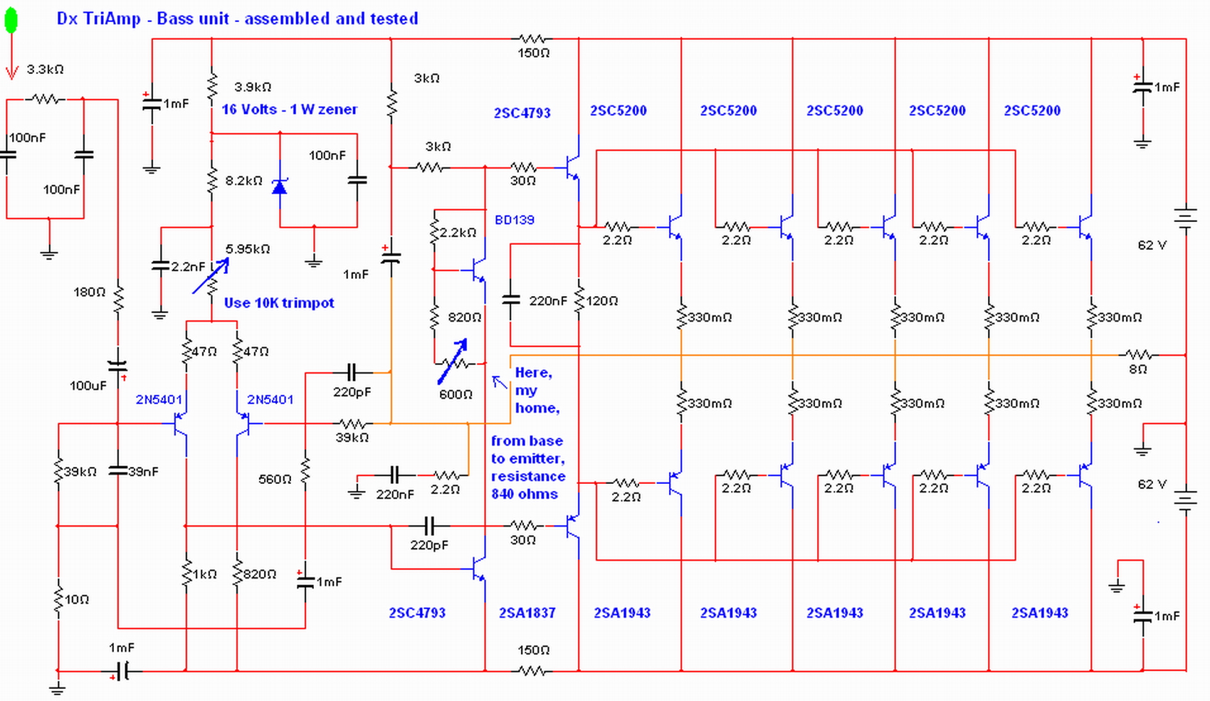

Here you have the resistances bigger than 1/4 watt
Others you can use 1/4 watt (250 miliwatts) or bigger if you want.
Into the schematic the special ones..the ones to install higher wattage compared to the standard 1/4 watt normally used in audio amplifiers.... so...other than 1/4 watt resistances are marked.

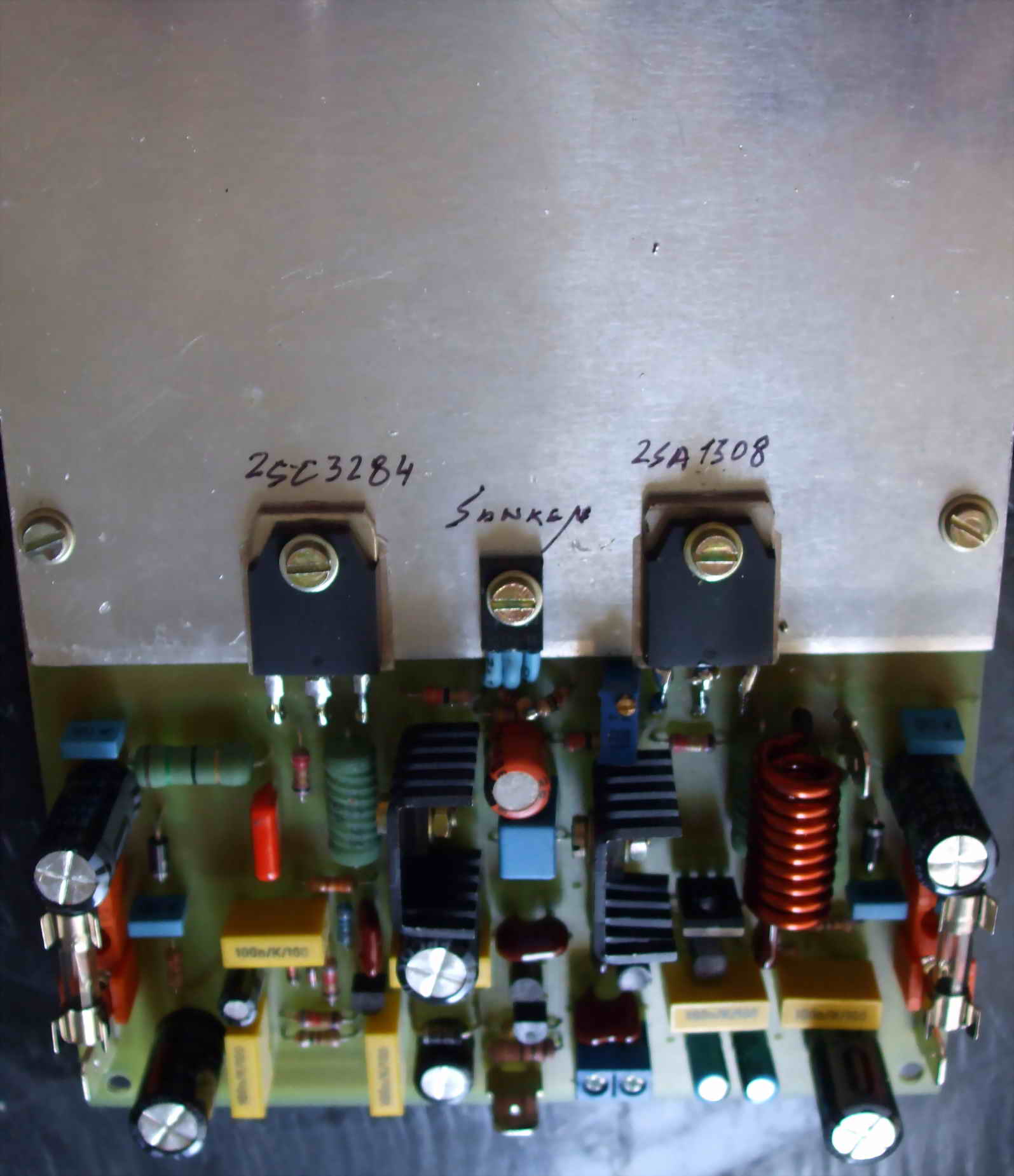

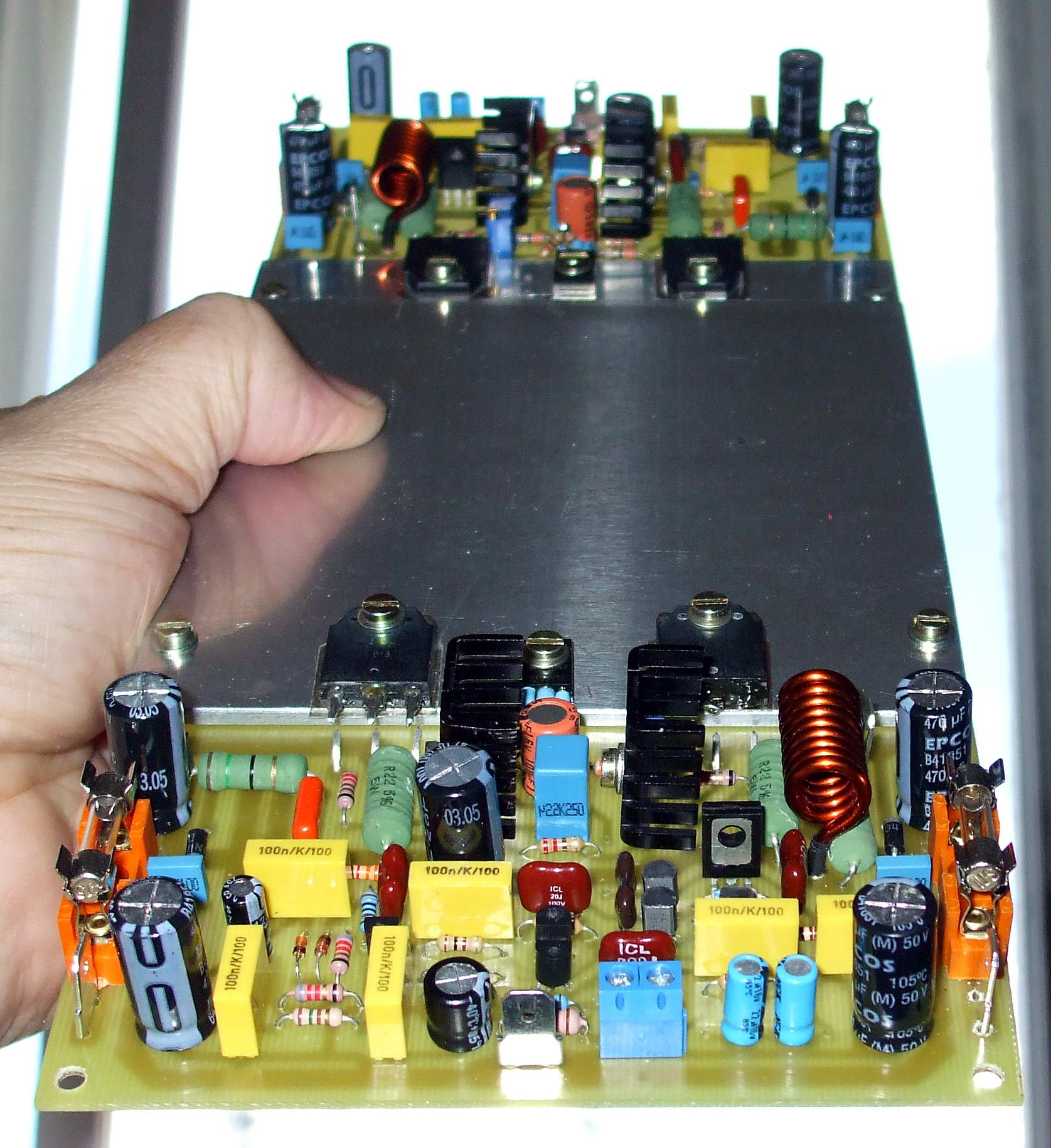

Picture shows the bass unit prototype.

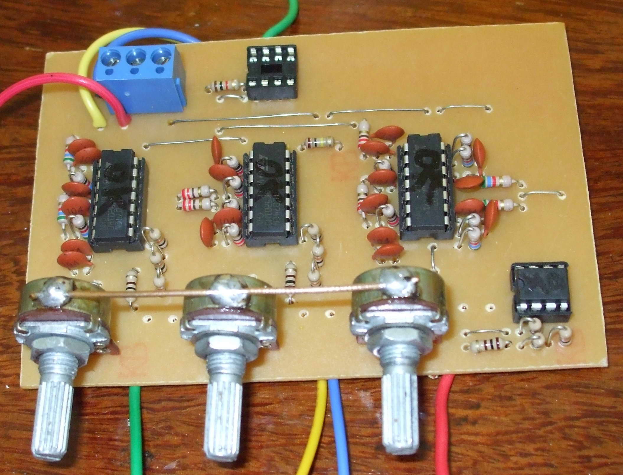

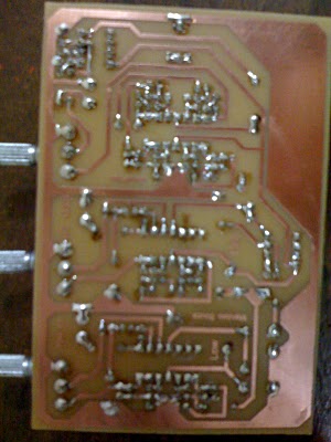

Here you have the schematic tested by Marcisium Laboratories
Soon he will send me, by mail, boards to be assembled and tested.
This way, amplifiers will not have input filters and modifications will be posted latter..the special modifications for the bass Amp, the midrange Amp and the treble Amp to match the active input filter.
The circuit has buffers to match impedance and to increase level a little bit.
regards,
Carlos

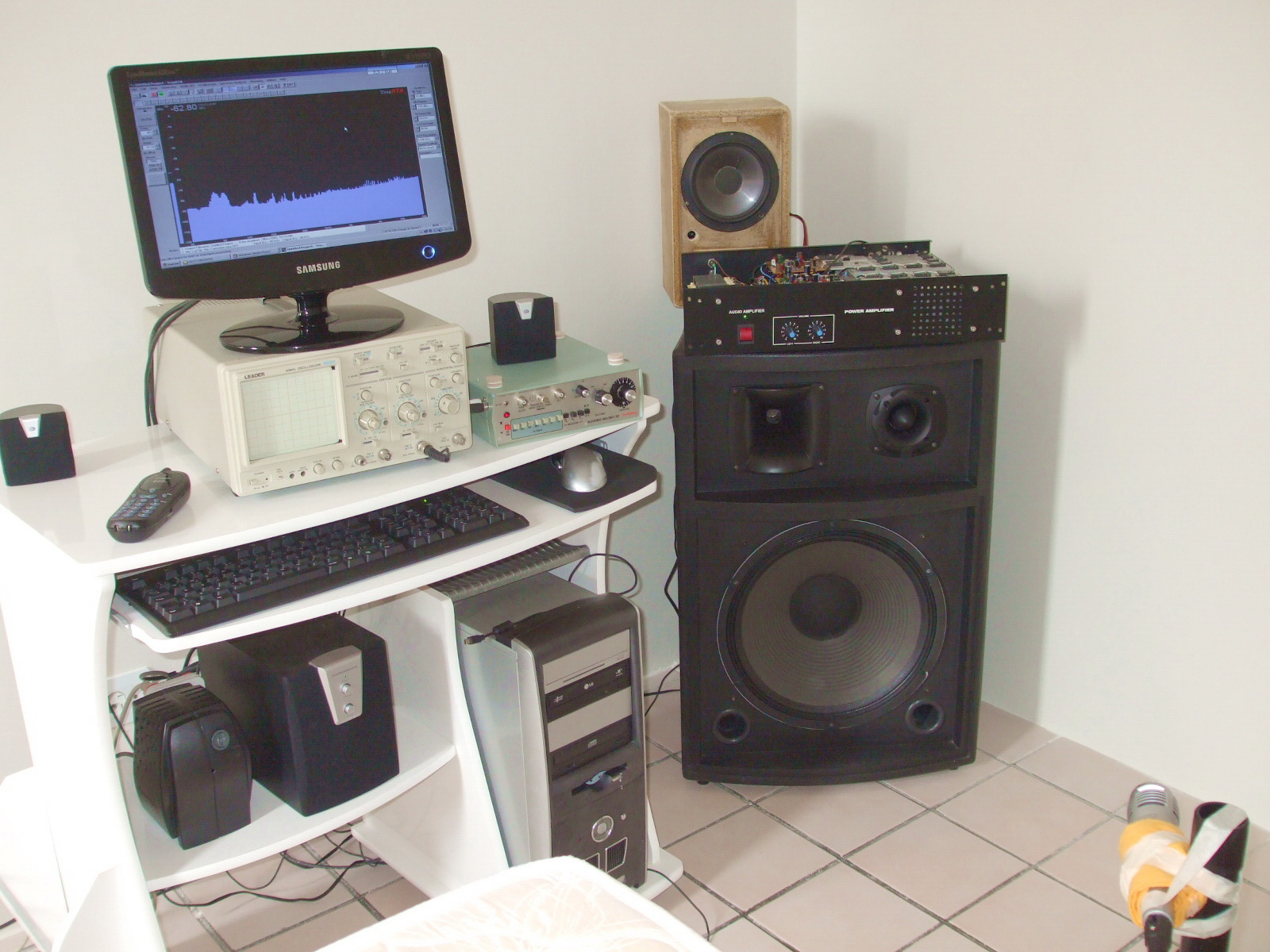

Listen the TriAmp playing... recording made using electret condenser microphone from
Panasonic, model WM61.
There are noises, vibrations and some saturations.... not a very good recording, but show you the "idea" about Triple amplification.
All amplifiers are Dx amplifier, the standard one, wich schematic and needed instructions are into Greg Erskine pages.

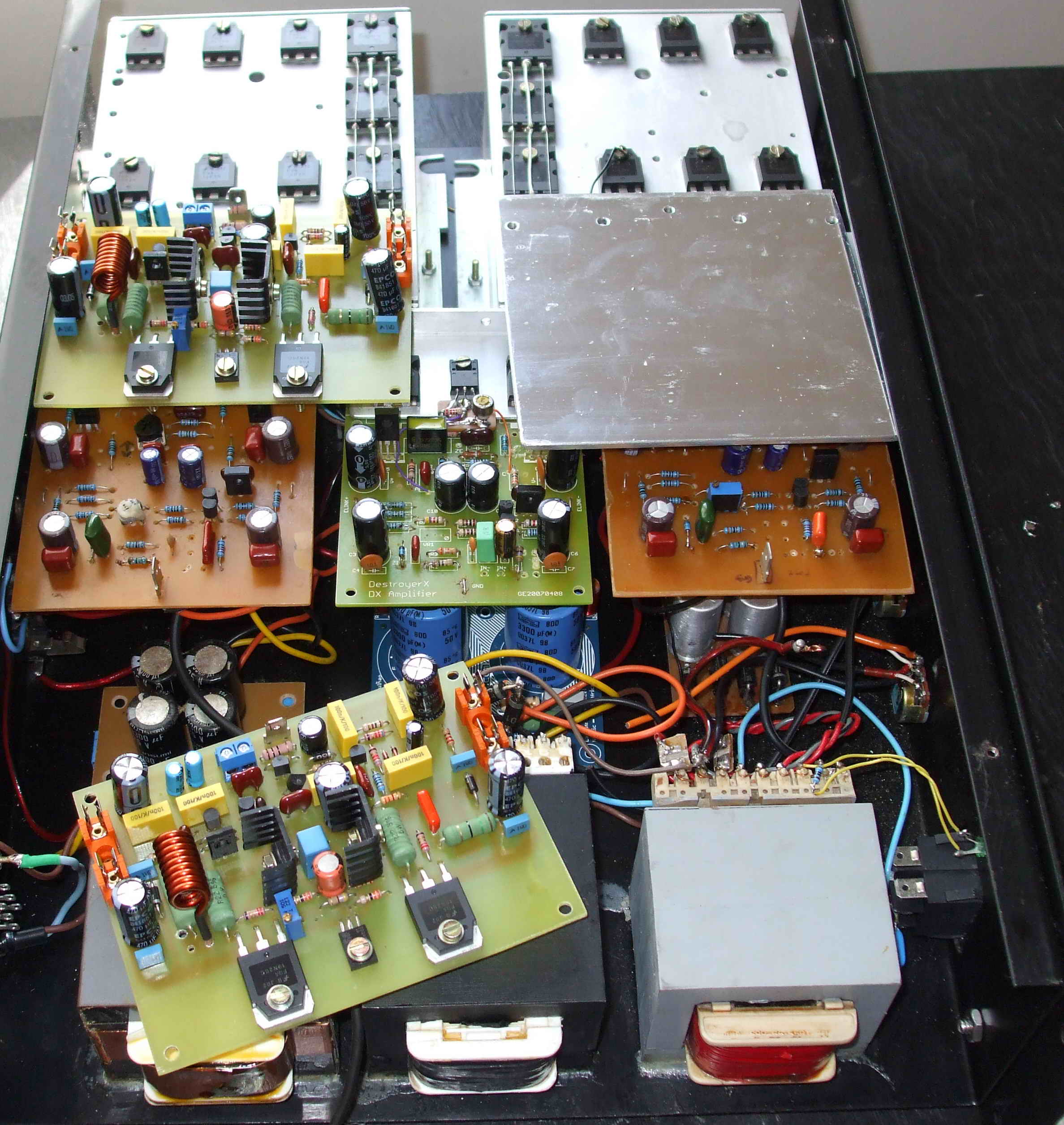

I am working with the Dx TriAmp, preparing it to connect the active filter circuit
so, i am removing the passive filter and re tuning the boards, as they were adjusted to filter the spectrum not used...to filter frequencies outside the band choosen.

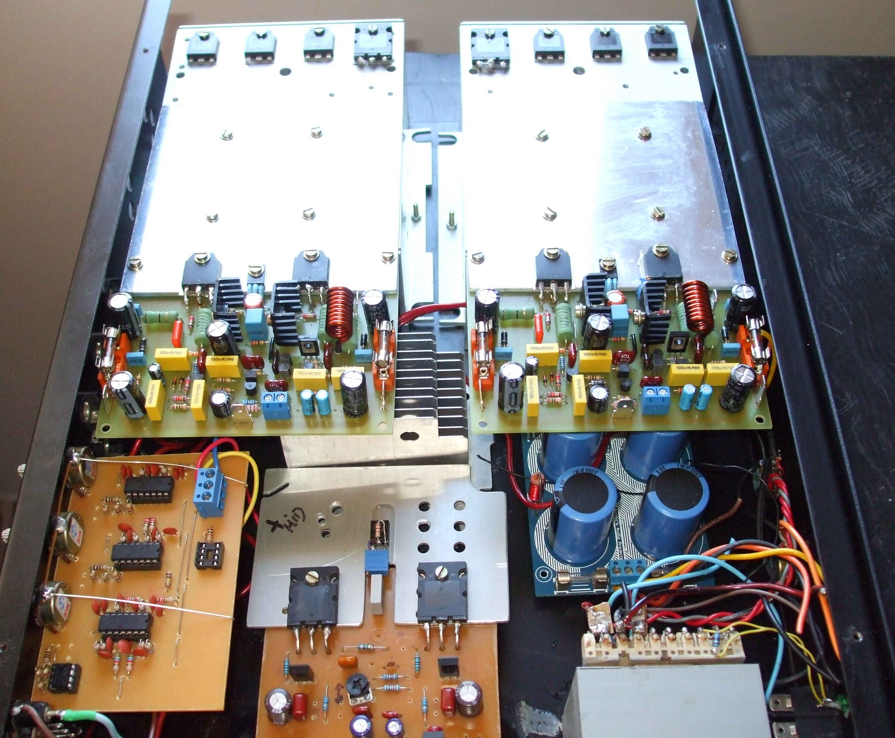

3-way active line level crossover, made by Marcisium Laboratories
for the Dx TriAmp.
24dB active crossover.
Dx TriAmp unit was dismounted to substitute some boards by the Dx Blame ES amplifier, the crossover you see down and left side....it is under re-construction.
regards,
Carlos
for the Dx TriAmp.
