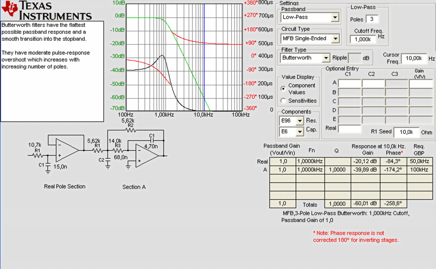

A forum friend, made the kindness to send me the software to build
active filters.
Let me know if you want it Gaetan.... around 3 Megabytes.
with the filter i can produce, easier, the active to test if they will sound better...i doubt a lot...but childrens (listening tests) will decide that stuff.
It is Filter Pro from Texas Instruments.
regards,
Carlos

Hello Carlos
Thank, I did go at ti.com and there I did found Filter Pro.
I did have an old version of op-amp filter calculation but Filter Pro are better.
Bye
Gaetan

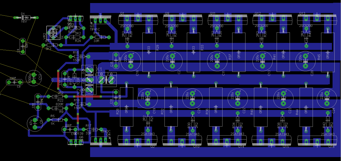

Dx triamp bass unit pcb construction has been started..
by Dx corporation.
im giving a try to design the bass unit pcb. Its a big project to me :D there will be many corrections to be done.. never mind at least im trying.. ill be happy in the end :cheerful:
regards,
Ranga
It is normal, and natural, to have errors...to avoid them we have to work too much
slow..... if we give to ourselves 6 monthes of dead line, them no failure will happens because we will be checking so many times that before the first power on, all mistakes would be detected and corrected...so...failures happens same way, but the long therm dead line will be enougth to find them all.
I use to build.... including the fast board production, in less than 5 hours.... because of that, usually i made mistakes...that result in more 2 hours to find them...even this way is better than 6 monthes of dead line...in six monthes i can assemble from 180 to 210 amplifiers (single channels).
Doing fast become ugly...there are losses to be fast...beeing fast we use to be a pig too.
TIP42 and TIP41, also BD139 has voltage limits....so...maximum voltage is 42 plus 42 volts to use them...to use 62 volts or something higher you must substitute them to 2SA1837 (when PNP) and 2SC4793 (when NPN) , or other that can face the peak to peak voltage (rail to rail voltage.... rail plus rail voltage).
Several can be used.... 5 watts dissipation to the VAS and 10 watts dissipation to the drivers...and this, almost all transistors (to220) can face.
regards,
Carlos

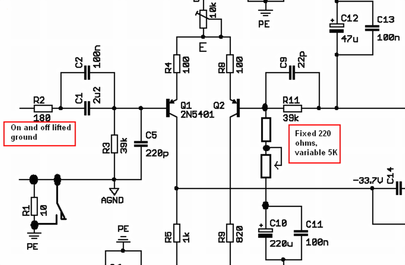

I was tweaking the gain trimpot today..and i found the following values
360 ohms to the bass amplifier
220 ohms to the midrange amplifier
995 ohms to the treble amplifier (1K is good too)
The best idea is to install good quality trimpots there...to have easier adjustment.
To the bass amplifier use 100 ohms fixed resistance in series with a 500 ohms trimpot adjusted to 260 ohms...so..near half way.
To the midrange amplifier use 120 ohms fixed resistance in series with a 200 ohms trimpot adjusted to 100 ohms...so...near half way gone.
To the treble amplifier use 560 ohms resistance in series with a 1K trimpot, adjusted to 440 ohms...so, almost half way into the adjustment..the midway point.
regards,
Carlos

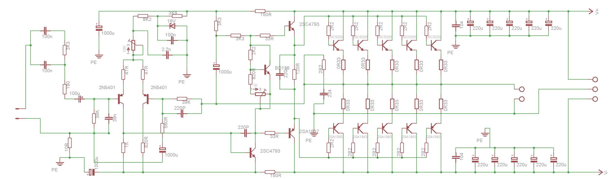

thank you for saving my time...
I substituted the transistors to 2SA1837 and 2SC4793. I appreciate if someone can mark wattage of each resistor other than 0.25W on the schematic and the voltage of each capacitor which are higher than Dx standard. That will help me to select the right component sizes. I have attached my schematic with this. feel free to make corrections on it ;)
thanks and best regards,
Ranga
Also inform the schematic you gonna use..there are some modifications
There are differences, the bass amplifier to TriAmp system is different compared to other Dx Amplifier made to 55V or 62V.... there are modifications into currents, and as a consequence, there are differences in resistance wattage.
Measure your supply voltage under load... the voltage under load is the voltage you will measure while sucking energy from both rails at the same time..something alike to install 2 resistances of 15 ohms and 20 watts (do the test fast or resistances will smoke) installed one from positive to ground and other from negative to ground and measuring (do it fast and fast switch your supply off) the voltage under load..almost 4 amperes each rail...we gonna see evaluating by the voltage drop how your supply will behave.... and them we can decide, with more precision, the power transistor needs (quantity), the heatsink size, and also resistance watts under real hard use conditions.
Of course you can find a 300 watts resistance..but this will be very expensive..so, use the smaller ones (15 watts, 20 watts, 50 watts) and do the test fast, as you gonna have 250 watts or more into each rail.
You can decide resistance wattage into stand by condition and also you can evaluate under hard use... a more real voltage reference is under hard use... this way we gonna see how big will be the resistances related power dissipation, or if you can keep 1/4 watt.
Under use, different than the stand by current, you have the AC current, that is the modulated DC current you had before you have injected audio into your amplifier... there are variations of current and voltage that you measure as root means square (rms) voltage.
