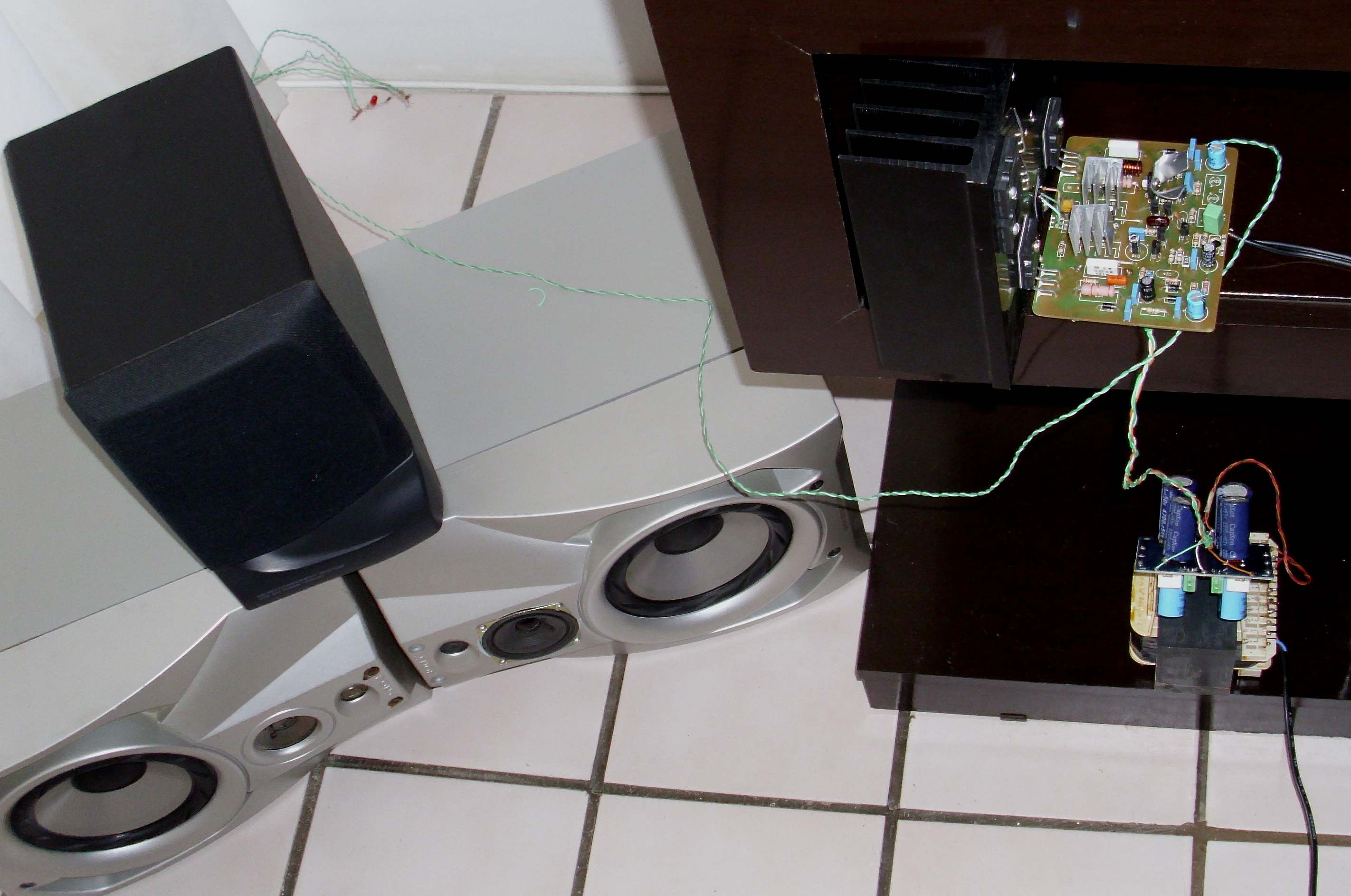

24 hours playing at 1 watt RMS ... was adjusted at 300mA
Now, after 24 hours playing... current is 270mA
It was dissipating a little bit more than 20 watts.
You see down the wall's corner a circuit...this is a zener (2V7), a resistor (22 ohms) and a red Led...it starts to light at 1.2 Watts...... these parts are in series and they are connected in parallel with the speaker wires..... i have adjusted to avoid it to light.
