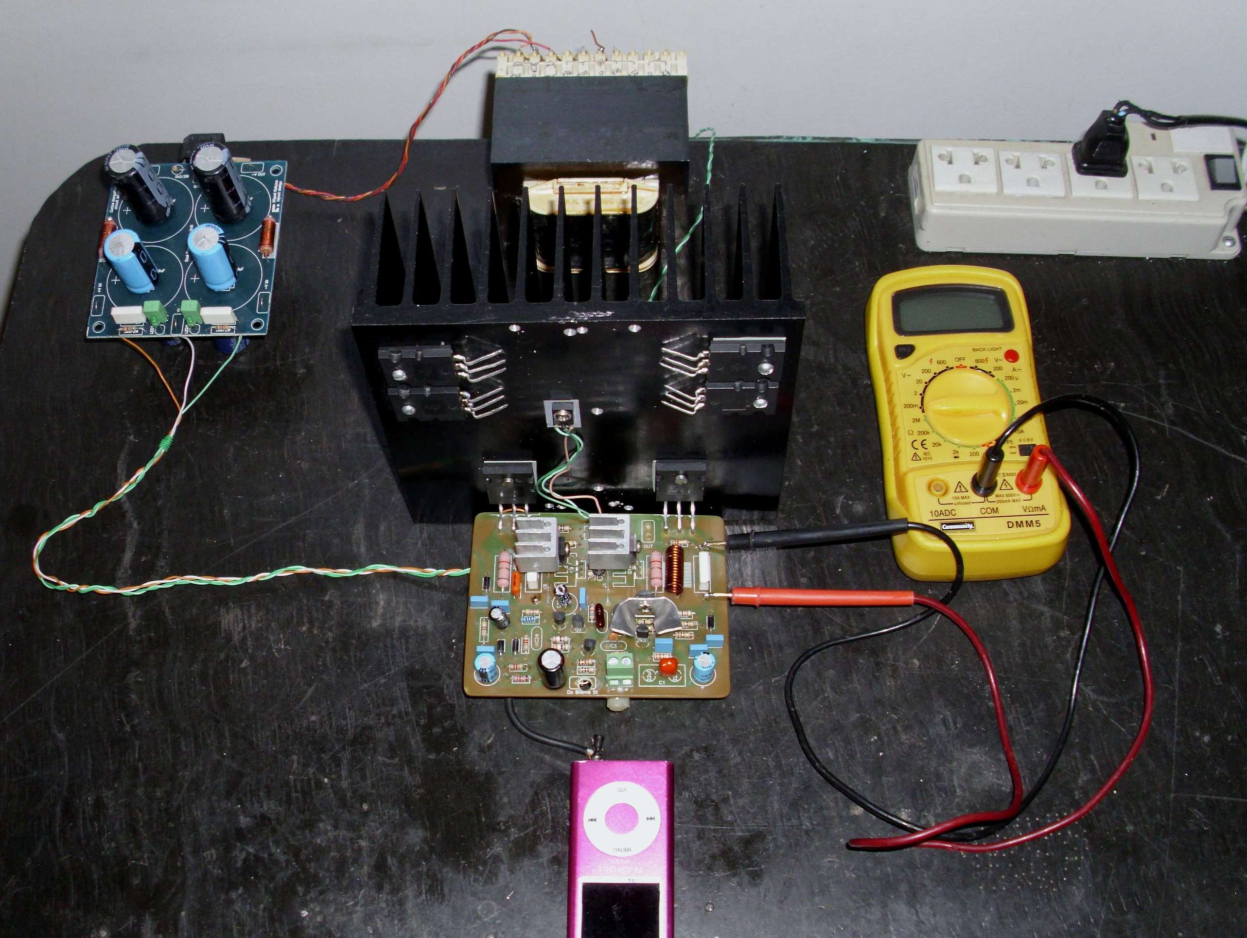

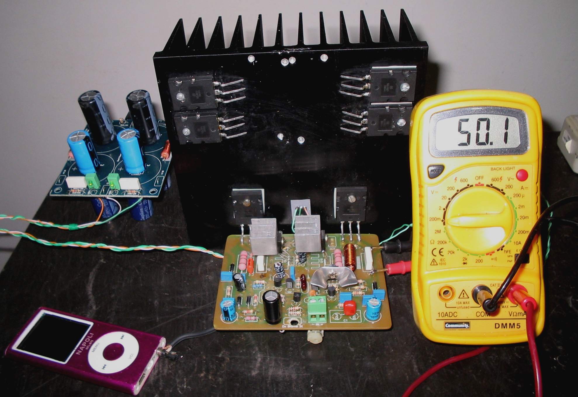

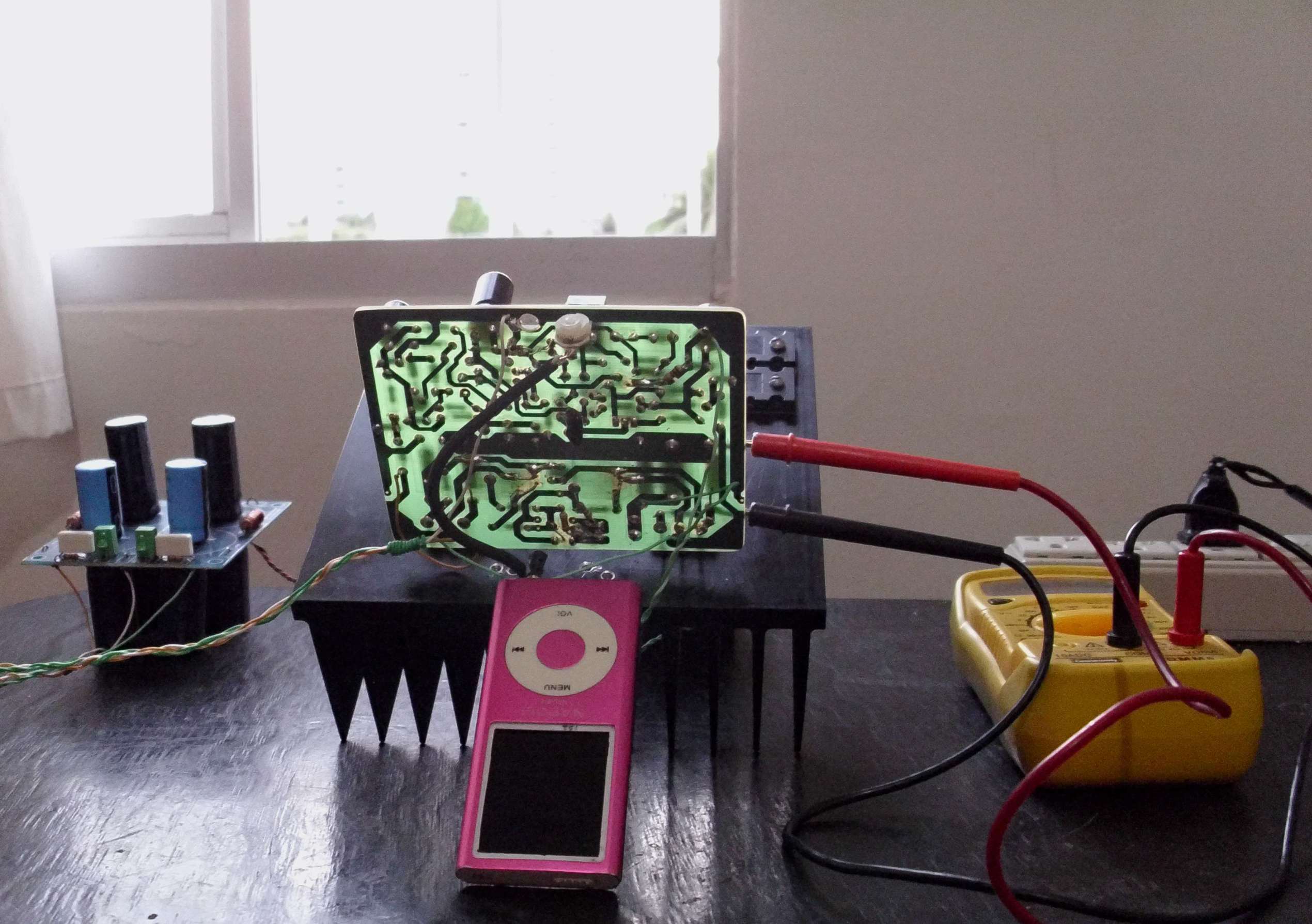

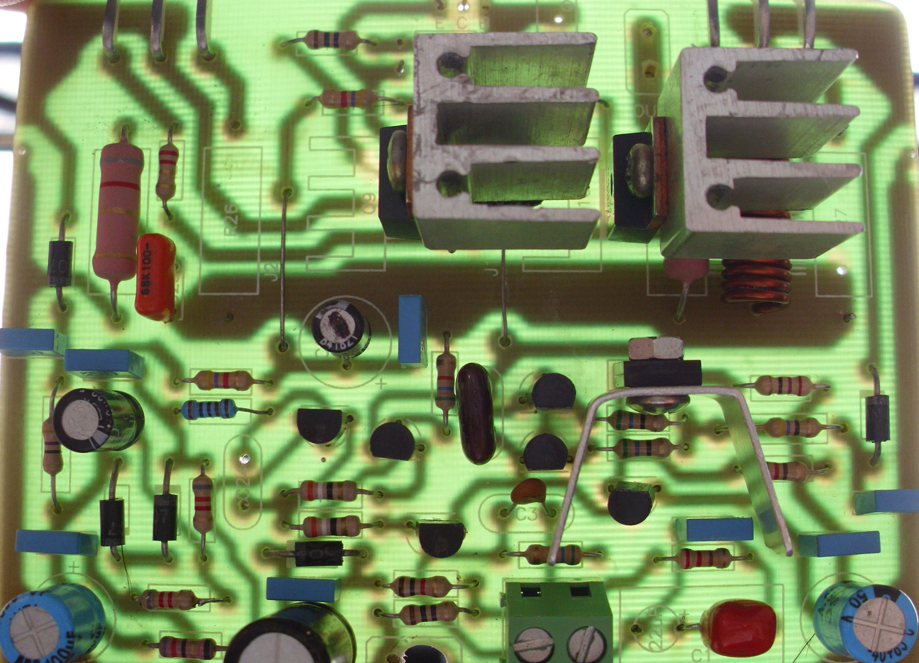

Here you can see the mess is under control.

I love those pictures, But I noticed you are using very "weak" power supply. how much capacitance are you using?
Yes....my capacitor stock finished....i am using some old units
from audio systems i have dismantled..... aproximatelly 10 thousand plus 10 thousands...it is just reasonable....tolerable to operate 8 ohms..but i know some powerfull bass tones are "dirty" because of mains noise...for sure this is happening..as i do not use to listen loud, then it is not bothering me.
regards,
Carlos
regards,
Carlos
20000uf it is not so bad, I though those were like 1000uf caps. When I build some power supplies I do not use more than 40000uf per rail (under 100 watts RMS per channel). I try many values from 1000uf to 40000uf per rail in many amps from 50/80 watts RMS per channel at 8 ohms and I like it around 20000uf per rail better. Right now my 70 watts RMS at 8ohms diy amp, I am using 6800uf X 4 total for my power supply and I love it. I was going for 20000uf per rail but since I shoot for a "small" integrated amp I did not have enough space to use four 10000uf caps. Take a look.

Very nice carlos! What are the transistors on top for? are you running it at 50vdc?
The top ones are not used in this amplifier prototype
they are just there because this heatsink is used in several other projects, so, transistors almost "belong" to the heatsink..... i am running it at 42 volts, 8 and 4 ohms only and one pair in the output.
Supply is using 10.000 plus 10.000uf and transformer is 330 watts.
This amplifier will have two output pairs.... Juan is preparing the pcboard layout, when ready i will publish in this thread.

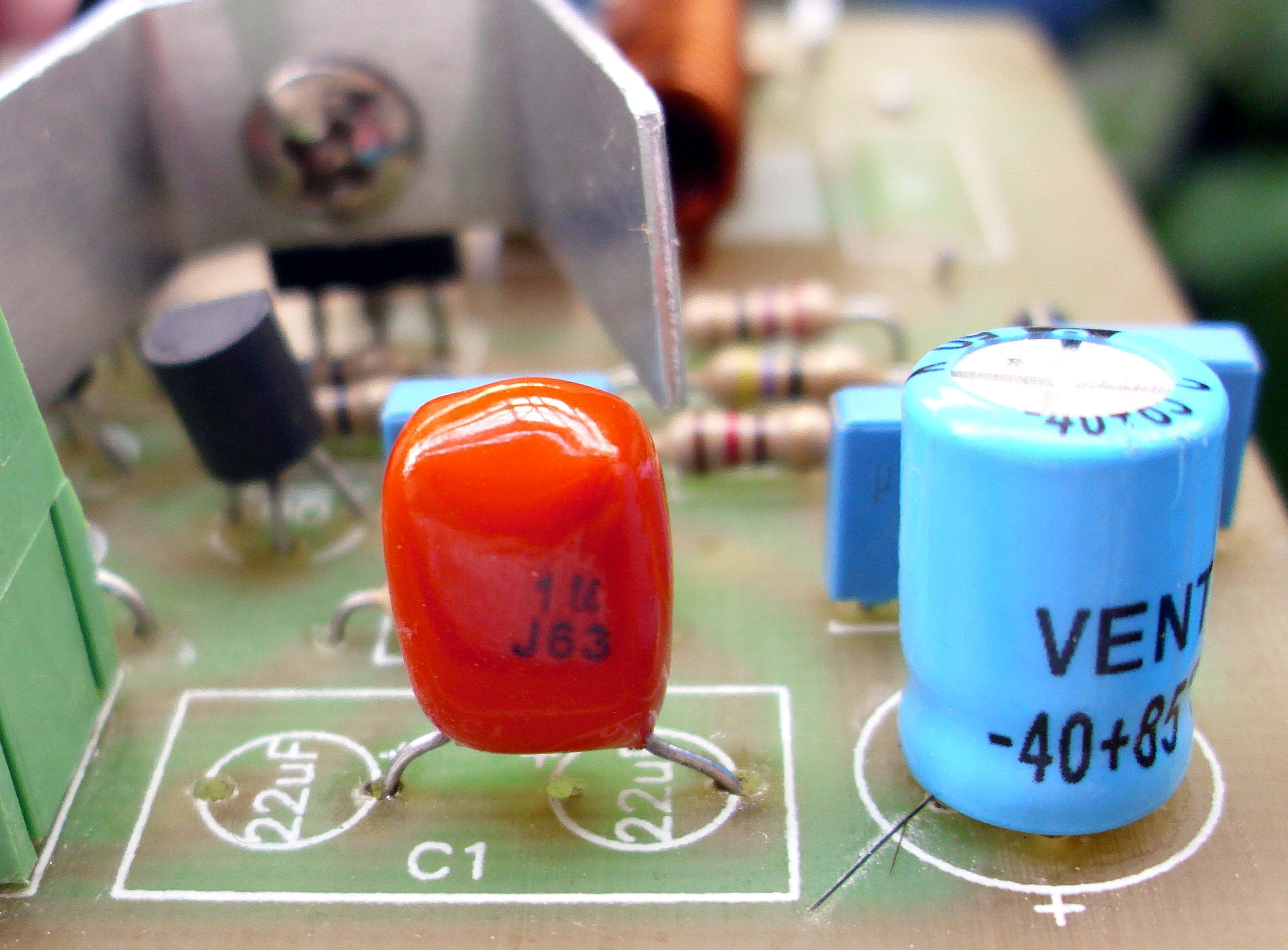

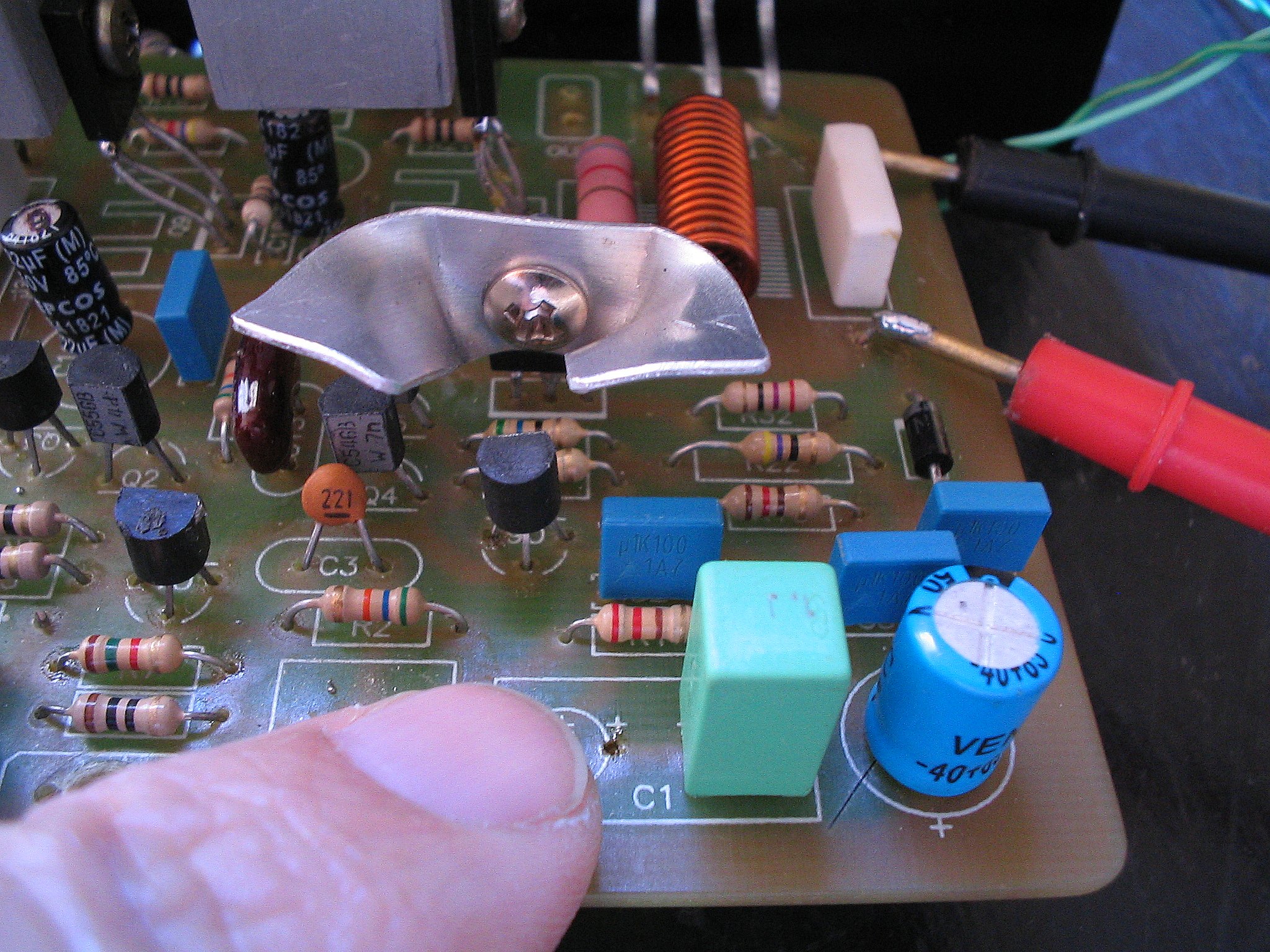

Use 1uf with 10 percent tolerance maximum in the input
Please, do not change this one..it is a hell critical.
