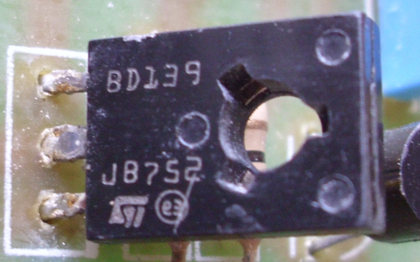

THen, as an answer to your call i was trying to remember, as yesterday i got out to see doctors and have not inspected the transistor brand name for you.... it seems it is a fairchild, but not sure.
I promisse, more 8 hours i will make a picture to show you the transistor.

I have seen the Philips fT quoted as far apart as 50MHz to 190MHz.
Is this down to the difference between NPN & PNP, or is it that fT spreads are enormous?
Andrew, I dont know what the other brands but the philips parts were BC6 series parts put into TO126 package, this from the mouth from an insider at philips. Also if you look at the spice models youll notice that the same model is used for the bc and bd parts. Now if you have a look at the bc6 series youll notice that their ft can reach 160 Mhz at 50 mA and this at Vce of 5V were as most usually quote this figure at 10 V (at 10V the Ft will be even higher so no surprise at the figure of 190Mhz which is possible). More important is that a very high speed is reached at the currents drivers usually are biased at, onsemi drivers mje15034,s barely reach 20mhz at these currents and have 4 or 5 times as much parracitic capacitances. BDs used at their max Vce perform excellently.
I accept that ONsemi's MJE1503x series are a quite different type from the Philips 139/140.
No argument there. I would never swap these parts. They are for different parts of the circuit.
But it's the 139/140 that concerns me. Many say the Philips are best. There are many clones out there and few if any seem to quote parameters for Cob, fT etc.
How do we identify the good from the average?

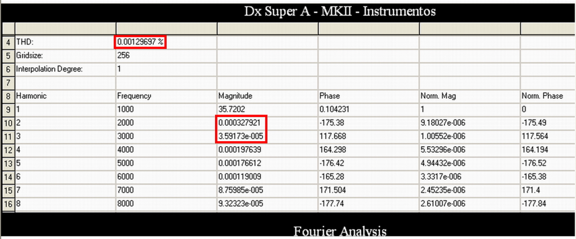

I am extracting all the "juice" from this amplifier
I do think i have reached 9 to 1 ratio if you compare second to third harmonic.
Simulator data at 80 Watts RMS into 8 ohms.... 750 milivolts peak entering the amplifier.
I have tried second VAS with one more BD139 in parallel, this have reduced THD in a very small number (1/1000) ... but the 9 to 1 ratio (second to third harmonic) was changed to 4.5 to 1.
I will listen anyway.... i want to listen real life.
regards,
Carlos
5th and 7th are way higher !
These are the ones that get most flack from our knowledgeable Members.
Any idea how big the 9th is?

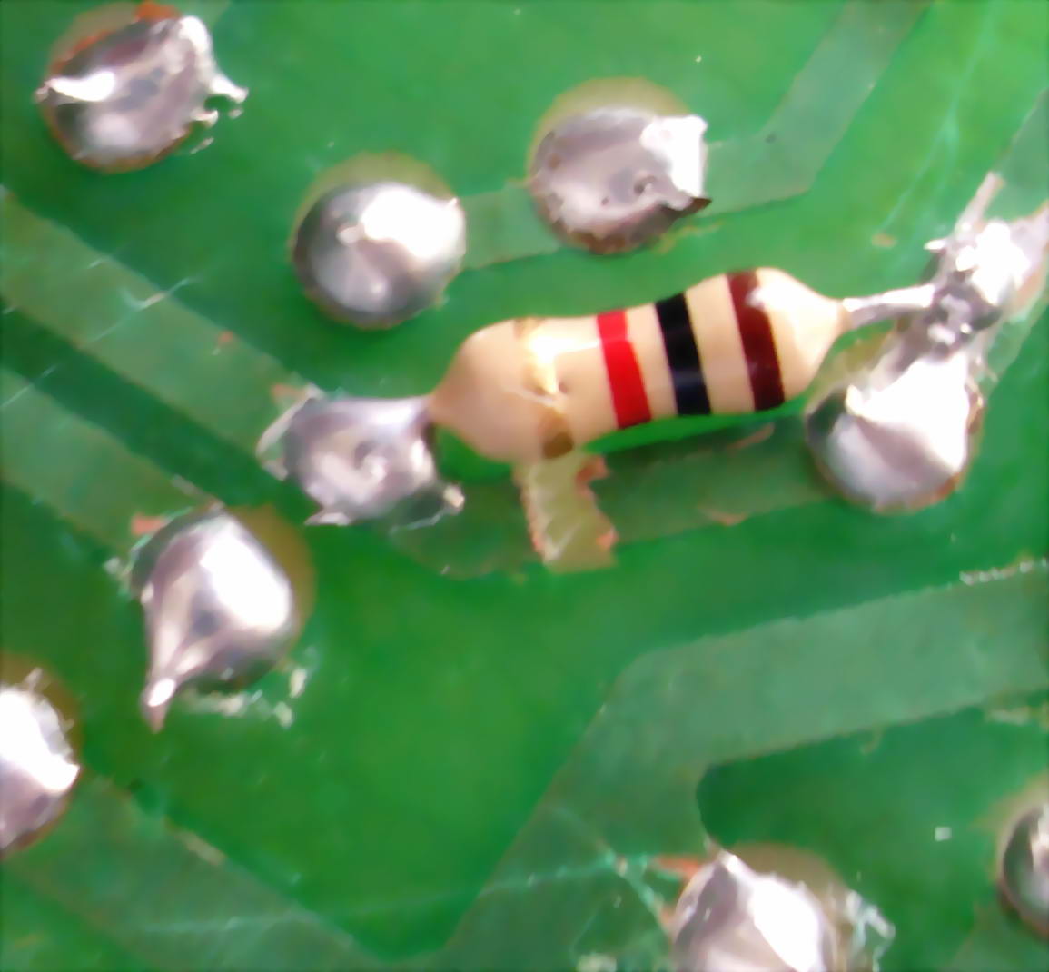

I found a wrong resistor value...this was the reason i had
strange current in the VAS... i also have tried some more modifications but these ones not approved for a while... i feel reduction in sensitivitand lifeless reproduction....so, tomorrow will return to the previous schematic...this new i have made (not published) was good in numbers..but related performance....not that good.

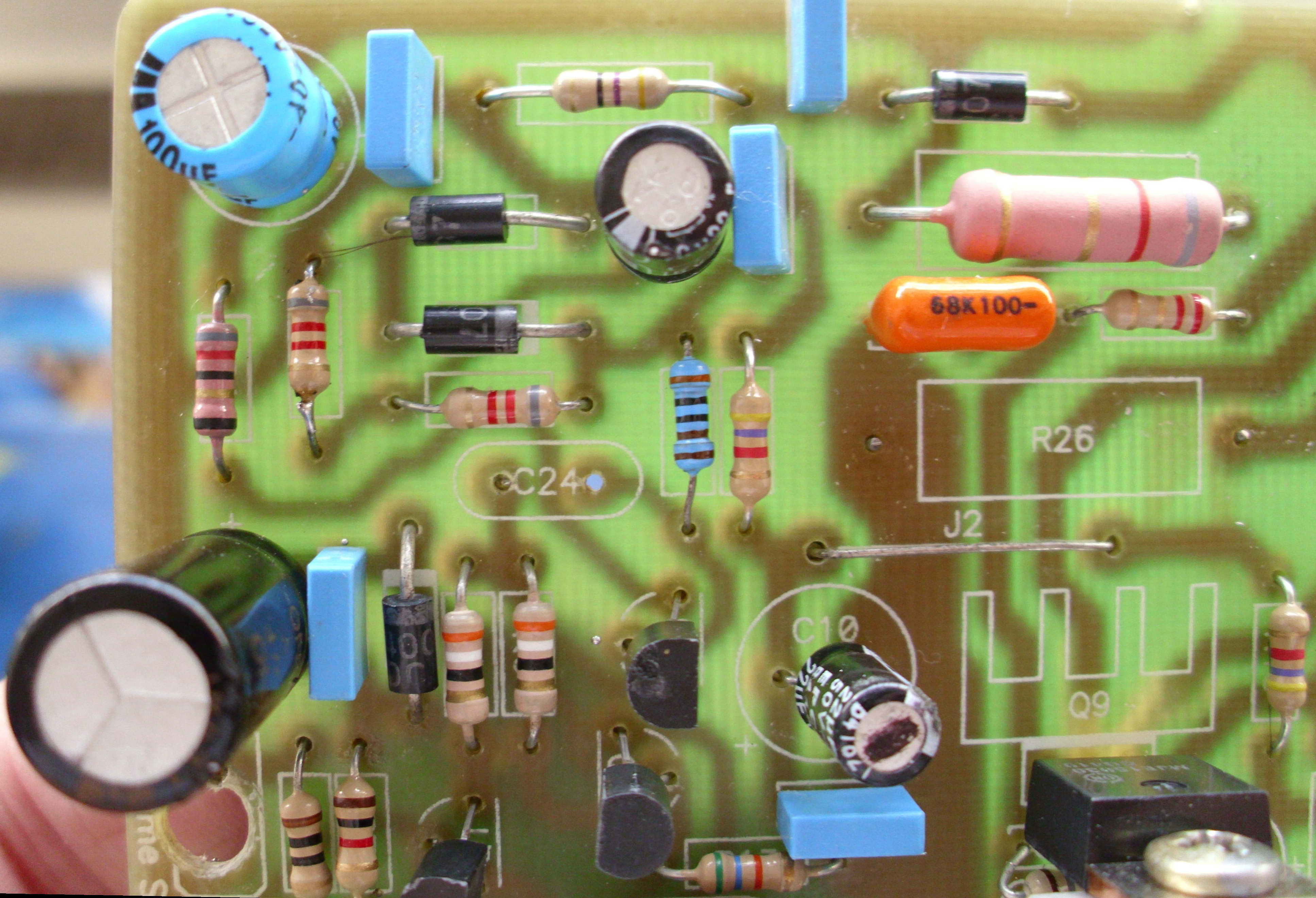

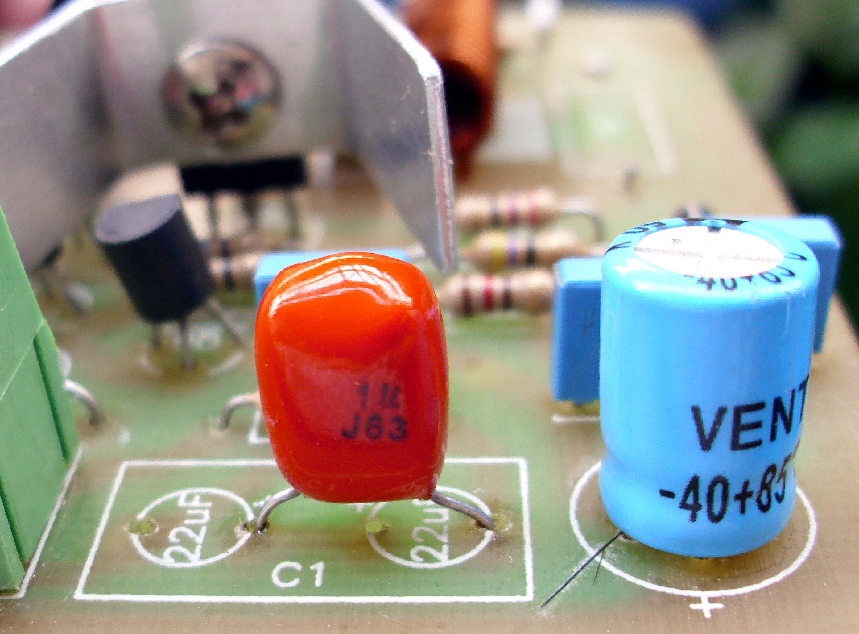

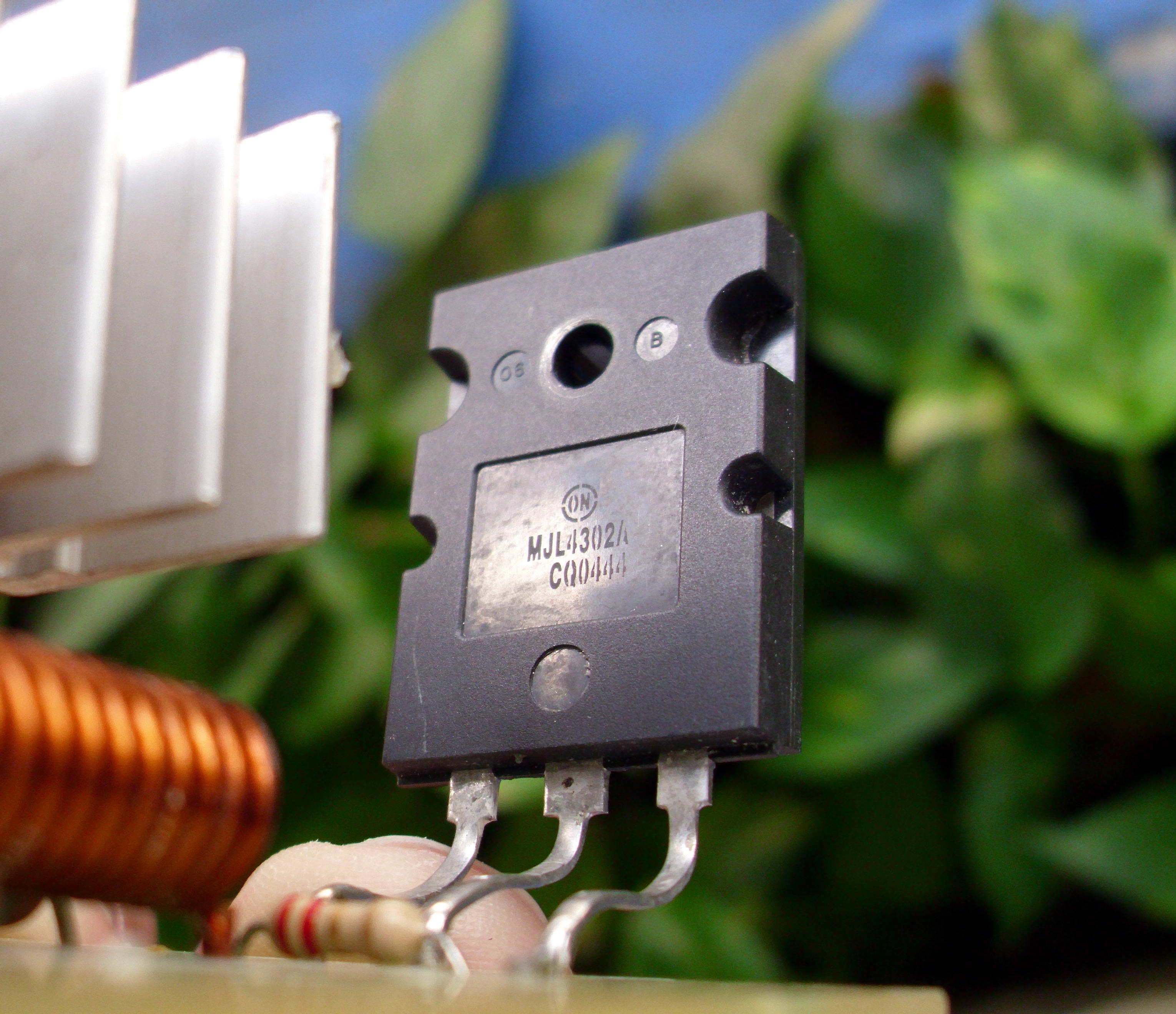

Some pictures made, from the Dx Blame ST board modified, used as base to the prototype tweakings, i will post them all late as i am in my job using my 15 minutes of morning rest.

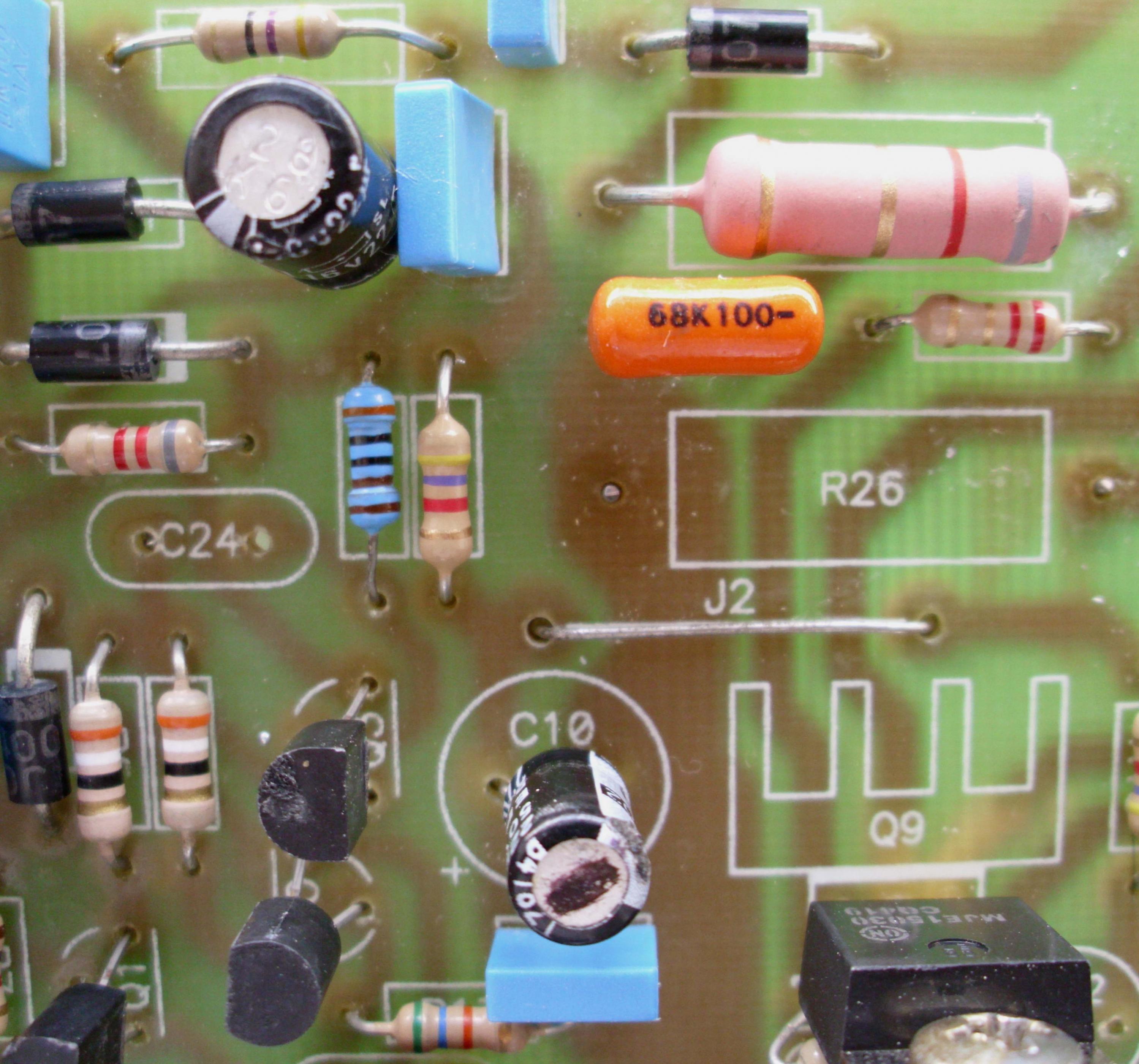

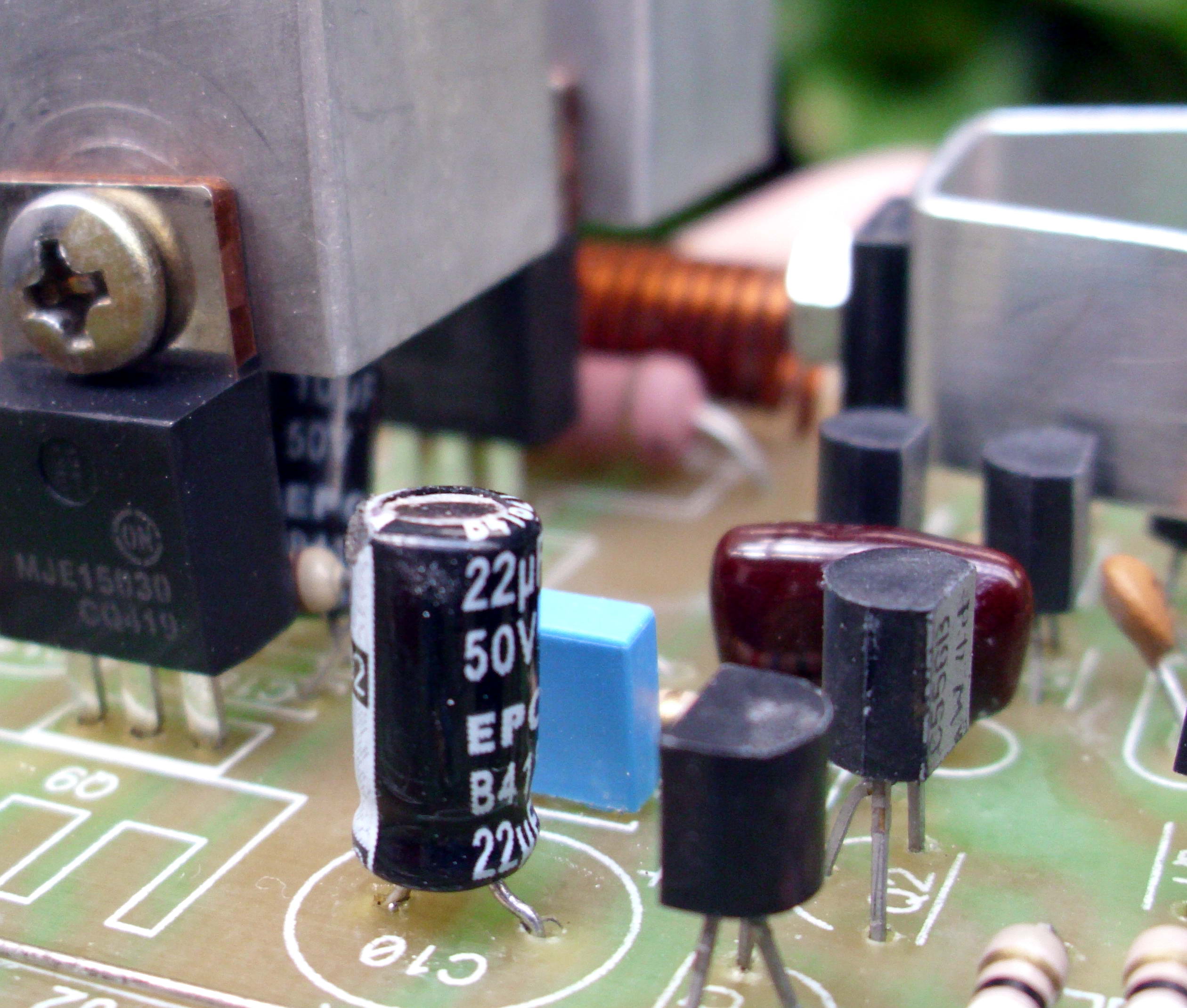

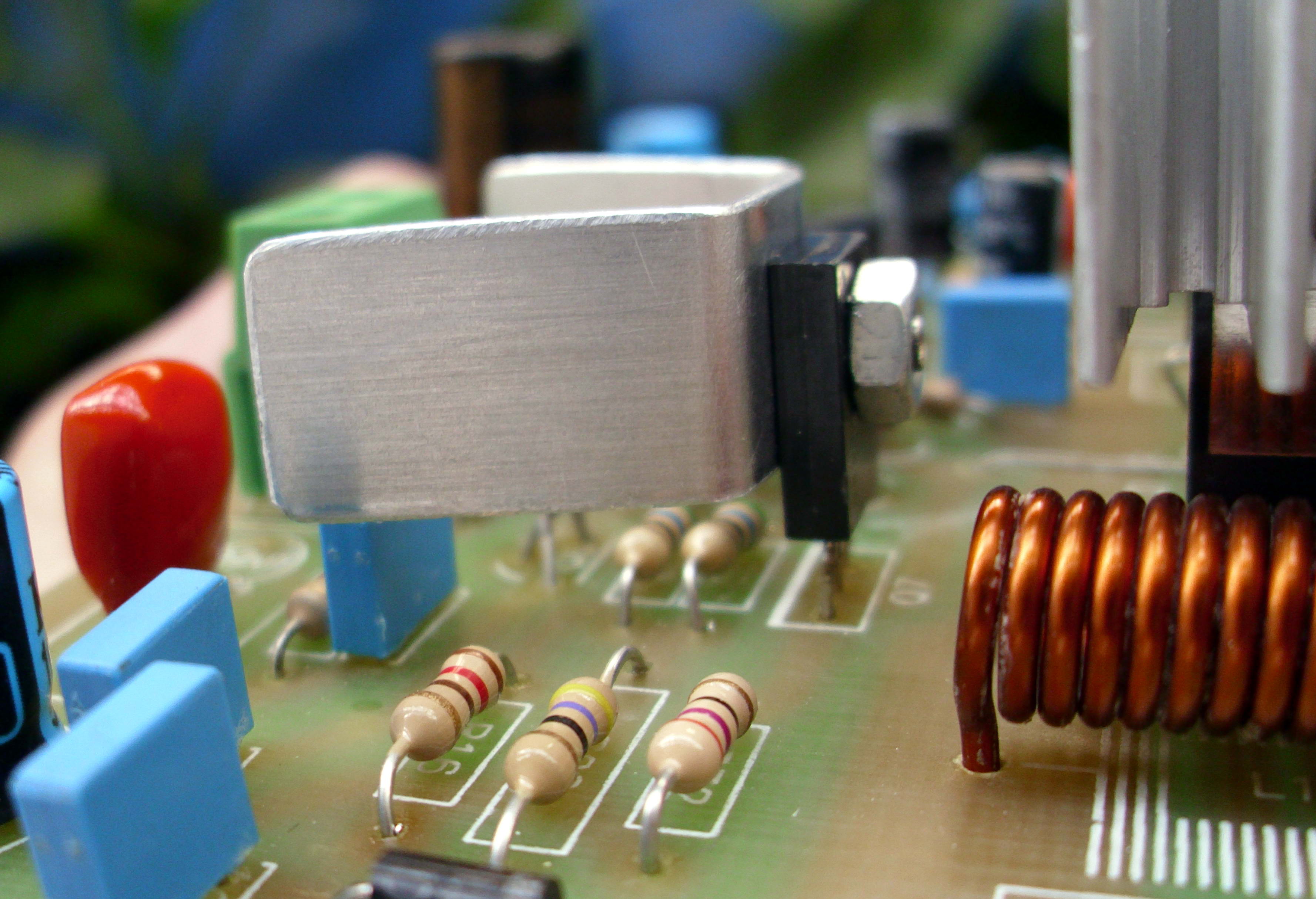

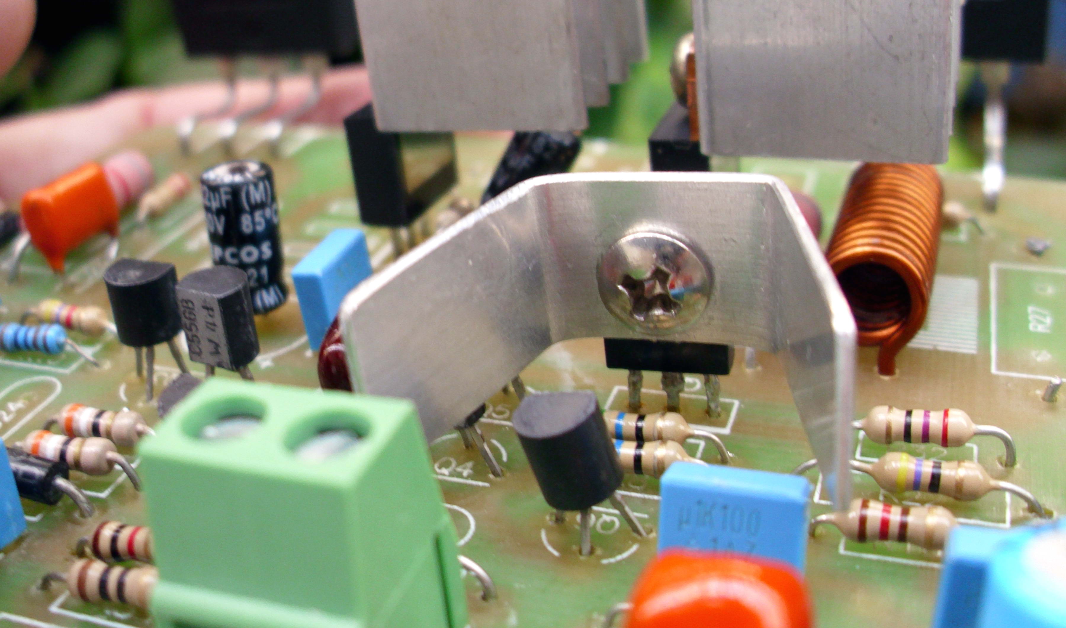

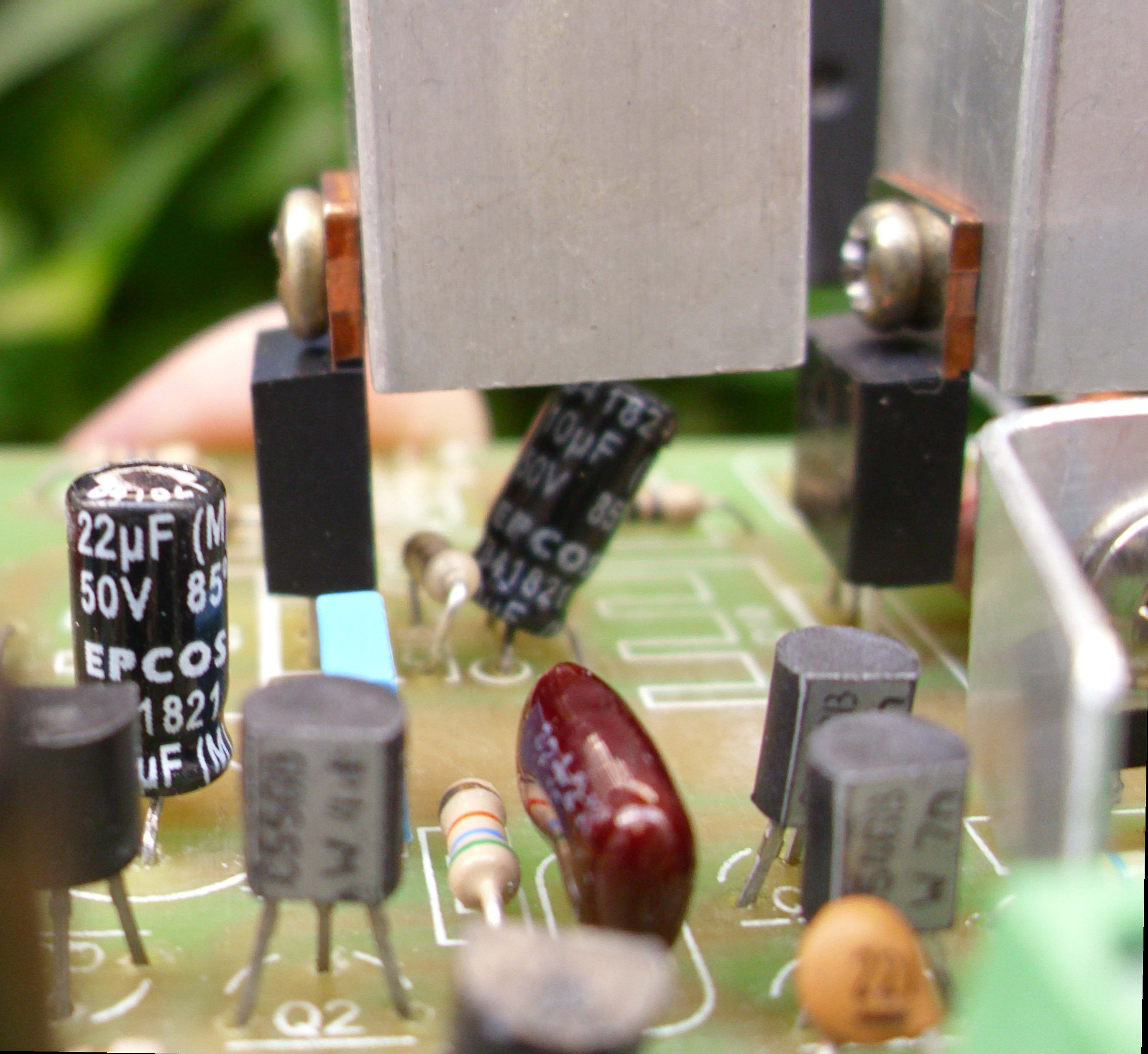

I will show you some pictures, despite the amplifier does not look this way anymore
I have used the Dx Blame ST pcboards because Brazilians have complained..they said:
You told the Dx Blame ST was the best wide world ever made audio amplifier and now you say it is junk when compared to the Dx Super A because the Dx Super A is the ultimate wide world best ever made power audio amplifier.
Hehehehe...they are right to complain and i decided to study the way to assemble the Dx Super A into the Dx Blame ST pcboards to be forgiven.
This way i am buiding and tweaking the prototype in the Blame ST board.
I have tried the MJE15030 and MJE15031 and no good result... now i am using BD139/140 back again into their driver position.
I am trying 2N5551 as first VAS...but i could not decide yet.
Well... several changes being made...will show you pictures, despite it is not this way anymore.

Yes, there's a hole into the board....as i told you, this is alike a scratch
a prototype, not made to be pretty, made to replace parts and to destroy the copper tracks soldering and dessoldering.
