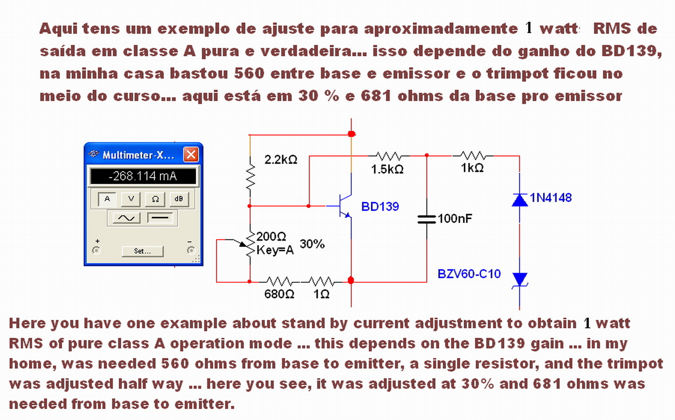

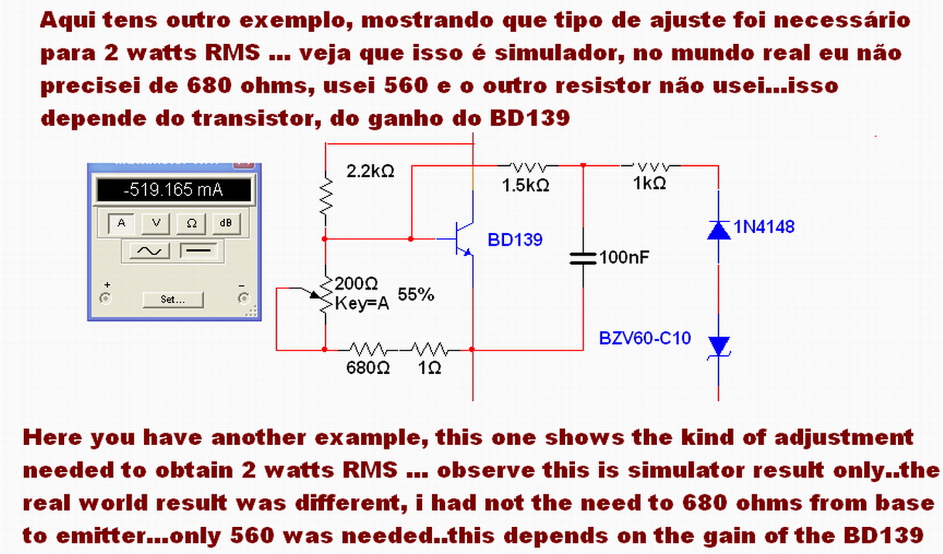

power is only 1 watt.... in pure class A, but this is not a tragedy, as we can increa
how ?
If the bias is set such that there is 1W of ClassA output power available then doubling the bias current increases the available ClassA power to 4 (four) times.
250mA bias ~= 500mApk of ClassA current & that = 1W of ClassA into 8r0.
500mA bias ~= 1Apk of ClassA current & that = 4W of ClassA into 8r0.

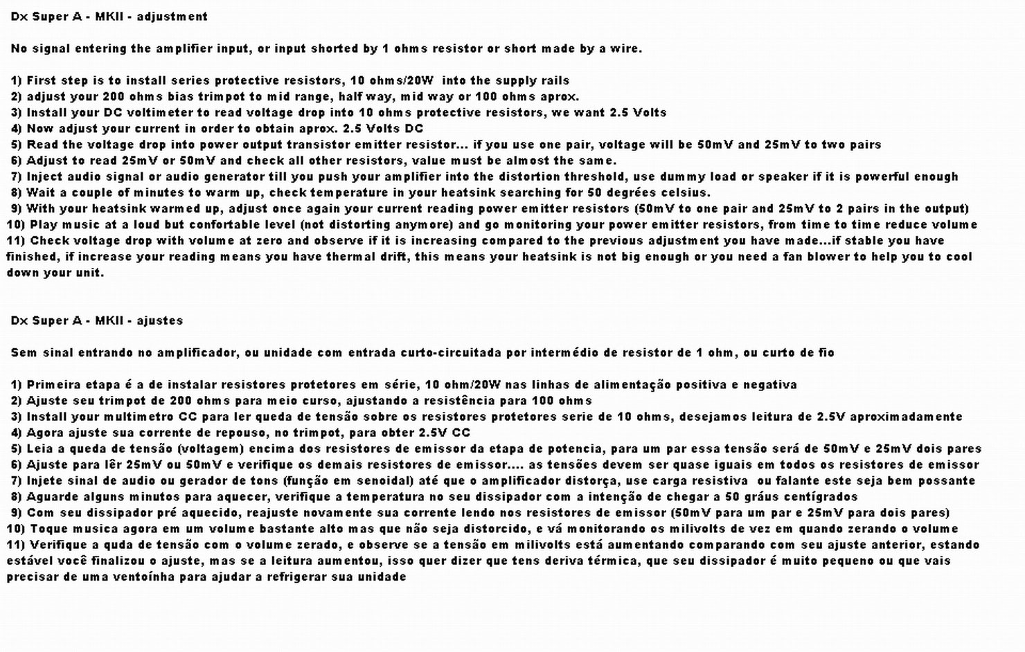

Adjustment...i have made a mistake
We must measure 25 milivolts DC in each of the 4 power emitter resistors as voltage drop in stand by mode, no signal entering the power amplifier.
If we have only one pair in the output, then we should adjust 50 mV and check the other power emitter resistor.

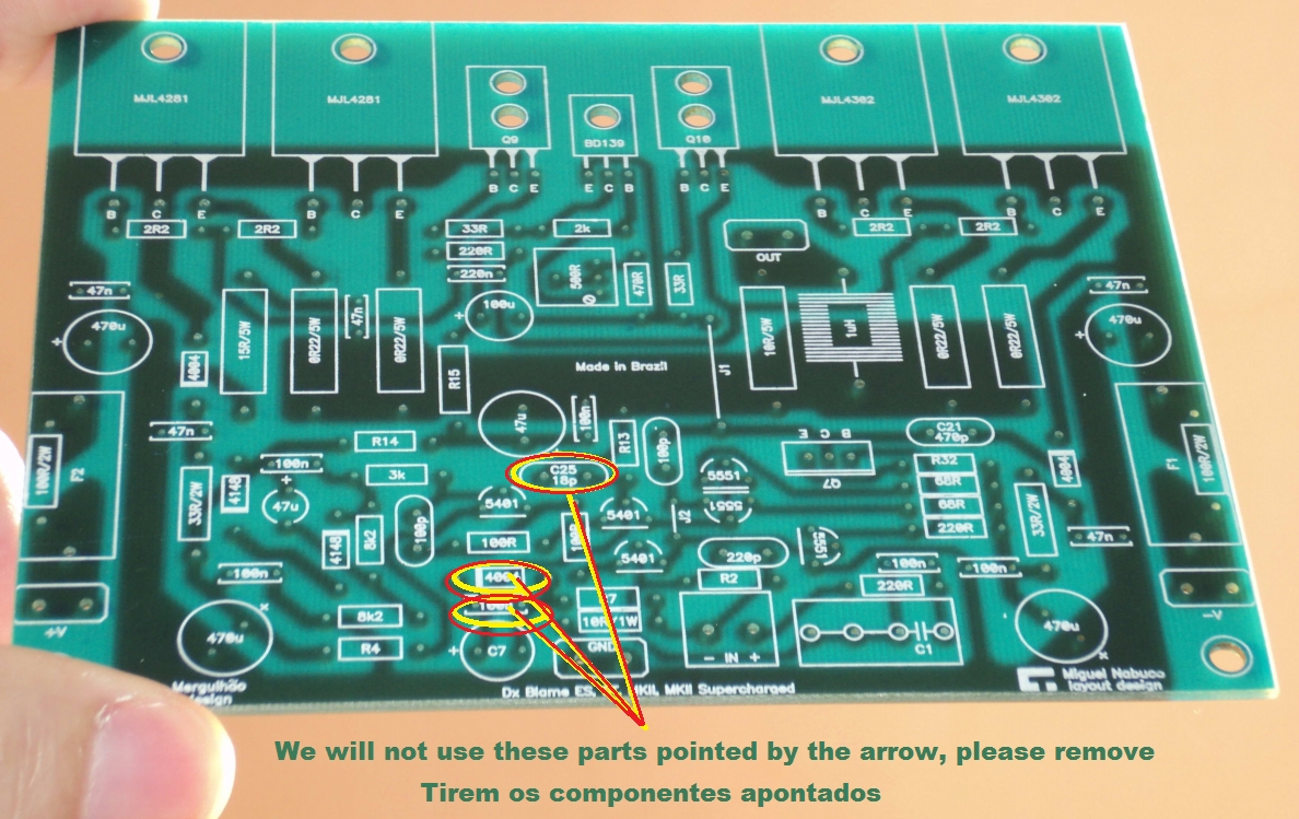

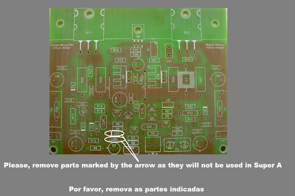

I would like to ask people, please, to remove parts indicated... i found they are not more needed to the Dx Super A.

Here you have two examples of adjustment
Dear friends
Simulator is a sophisticated calculator machine, a very good tool for us..but it is based into standard parameters from transistors... the BD139 data the simulator use is not the same as my transistor in real life.
In my home, i have used 560 ohms resistor from Base to Emitter and the trimpot adjusted was exactly and precisely in mid way... mid range... or 100 ohms to our 200 ohms trimpot...this have adjusted the current to 250mA.
You see, that simulators make their own calculations based in their transistor.
As a result of that, before you switch your power on, start with your trimpot in the mid range and read DC milivolts voltage drop directly above and atop of one of the power emitter resistors...then adjust the voltage readed (without signal entering the amplifier) to 25mV if you will be using 2 pairs in the output, and 50mV to a single pair or power transistors in the output.
Check this voltage drop to other emitter resistor and let the amplifier warm up...put some audio and increase the volume till you have distortion in your speaker (be aware this may be more than 90 watts RMS in 8 ohms speakers)... may be interesting to use a dummy load to do that...then, with your heatsink hot (more than 50 degrees celsius) adjust once again and go monitoring your voltage drop to see if it will be increasing.
If this happens, say, the increasing in voltage drop, means your heatsink is not good or not enough...or your ventilation is not fine...or that you may need a fan blower to help you to cool down the whole thing.
Enjoy your amplifier... people that has built said sound is impressive...the same i said to you.... have eated the Dx Blame ST in the breakfast.
We have 100 kits from the blue boards (Supercharged) and 100 kits from the green boards sold (inside group buys, inside brazilian forum, cost price) operating in Brasil....some more units have also being built with folks making home etching of their pcboards.... some of them are upgrading and updating their pcboards to the Dx Super A.
regards,
Carlos

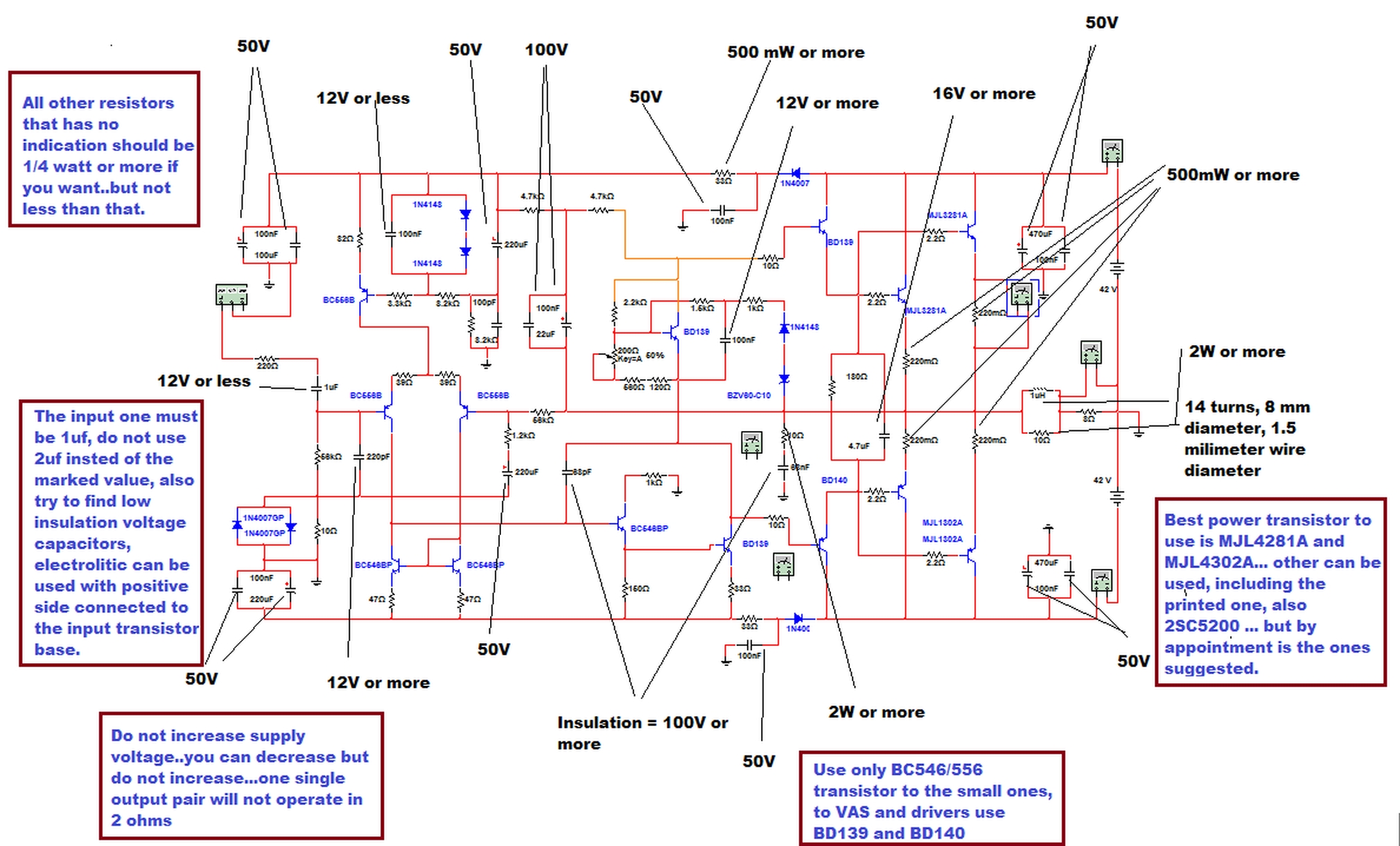

From which manufacturer do you get your BDs, with the rails you use youre pushing them to the limit. They make for excellent driver transistors though better than all if you keep in mind max Vce.
Yes, they are into their limit, despite i have used them with 55V supplies
I have one amplifier, built last year that is still working, a gift i made to a young student i had... i was teaching him audio electronics...he push the unit hard and daily, he loves to play loud..it is working.
In the reality, i have some voltage drop because supply is not that good..but even this way, full power, even distorted power, it is higher than 45 volts DC.
I will try to know the manufacturer to inform you as soon as possible, i am at work and i have no transistor to watch the brand name at this moment...in a couple of hours i will inform you Homemodder.
You see that they, probably publish specifications considering worst case...real world these components can face more voltage.... but thermal dissipation i do think they publish the best case, exactly the opposite.
I have no doubts it works..reason why i am using it... several units at my home are operating in this same supply...no troubles.... they are doing the job without complains... maybe because supply voltage drop.
If i am not mistaken, you have made this question before...and i have made the same answer to you... yes.... i have this transistor datasheed, from Philips, Onsemi and other manufacturers too.
regards,
Carlos

I already have a lot of guys that wants to make pcboard layout
The first interested is Juan Vargas... and we are working together in perfect harmony.... then i had the offer from Zimmer, yesterday was Naldo, also Herman and today i have perceived that Mitchel is also interested.😉
Alex mm is another one that use to produce layout too...this time he looks not that interested...but of course he is welcome if he want to move.... to get in action..well..he can made this kind of thing in 10 minutes because highly skilled doing pcboard layout.
This is good, i will open to all of them to produce, this way people will have the choice here in Brazil.
Mitchel is the one use to make layouts... he made the green board after TAJ had give up because too much busy in his work...then he made the Supercharged blue boards.... he said would stop, because studying to a competition to enter Petrobrás...he suceeded and waiting the call to start working draining Oil from presalt oil reserves... i do think he may be in the lawyer departament as he has graduated in laws... he said yes and no...but now he is saying "maybe" because the amplifier is growing up very fast and people here, down in Brasil, is interested.
I do welcome anyone that wants to help... i hate pcboard layout software, i do not want even to learn the stuff...so.... it is opened to people to contribute.
I do not make any secret that i love the work from Mitchel, because he is tuned with my ideas about pcboards..he already made and he knows i want things aligned, i want clearance in between parts, i do not like empty spaces, i do not like big boards and i do like square boards,... not a rectangle... i do think that is not a good idea parts touching one each other as this is not needed..we have room to share clearance in between them, i do love symmetry and the smallest pcboard size possible because of cost...i do love red pcboards, white pcboards, Coffee colour pcboards and blue pcboards and dislike green pcboards...i do prefer jumper instead of long tracks..but better is not to have jumper and to have small lenght to tracks, i do love clearance in between nearby copper tracks to avoid capacitances in between these tracks ... and all that Mitchel already knows and does that automatically without make me spend more than a couple of minutes inspecting... we work together like a well lubricated machine..things goes smoothly... i just go helping him to check if there's a mistake or not in the pcboard..he also knows i hate identification numbers printed (R2, C3, Q5) and he produces images showing these ID numbers but in the pcboard all you can see is values (200 ohms, 1K, 2N5401, 100n)...so... we are deeply tuned while in between Juan and me, we are turning the tune knob to adjust ourselves one to the other.
If Mitchel decide to enter..will be very welcome and will be one more cooperating...for sure he will be accepted in Brasil as he is famous here.🙂
Juan will be producing layout too and all guys that wants to produce will be welcome.
These are the most fresh news about.
On time!... i have just received a message from Mitchel (Miguel Nabuco) he said he will make several layouts... one the new pcboard including the Super A, another will be an adaptor pcboard to use together the Dx Blame ST green board and the Supercharged blue board, another option may be the output filter in an external small pcboard to install nearby the speaker output connector in the amplifier's back panel.
regards,
Carlos
