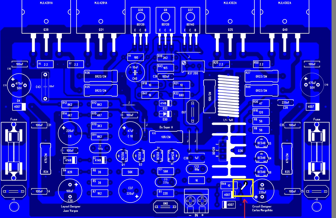

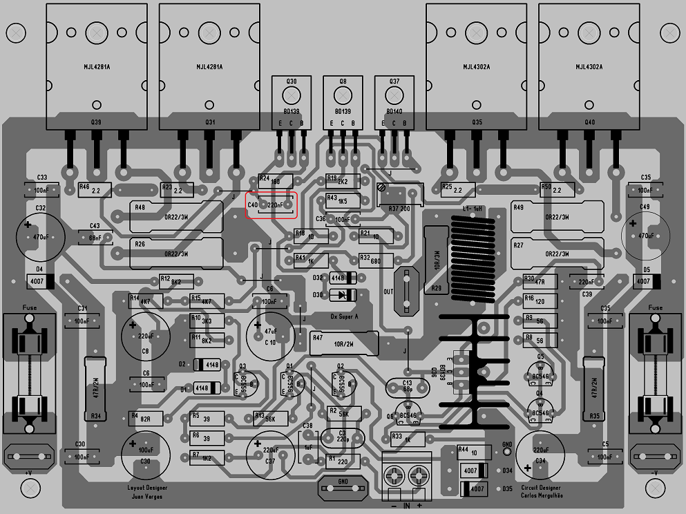

Juan is making a layout for it Meanman.... tell me i you need something, some information and i gonna send you.
Are you following my videos?... you are welcome at my channel...please, subscribe there if you are not already subscribed.
Type "Carlos Mergulhão" in the Youtube's address bar.
Image is the layout..not ready yet..... he is doing....video talks about the layout..some instructions to Juan in two languages:

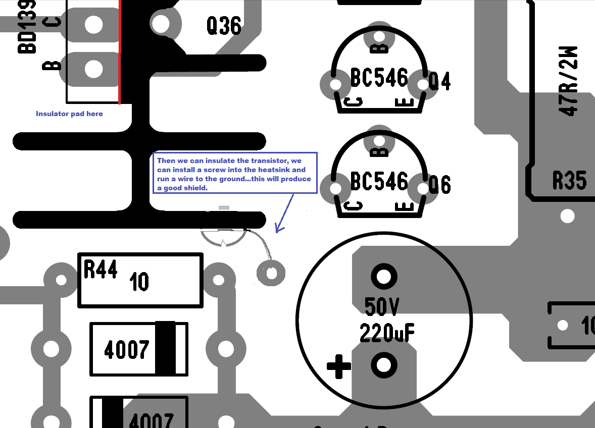

We gonna use a shield against magnetic field interference
because output coil is too much close from some sensitive circuits (second stage)
Then second VAS will use insulator and heatsink will be grounded..this will produce a "wall" a barrier against magnetic field.

Juan is making a very pretty board layout
He is improving.

Juan have finished the pcboard layout
I am sorry, the english audio is missed... software have "eated"...but watch the image..it shows the pcboard layout.

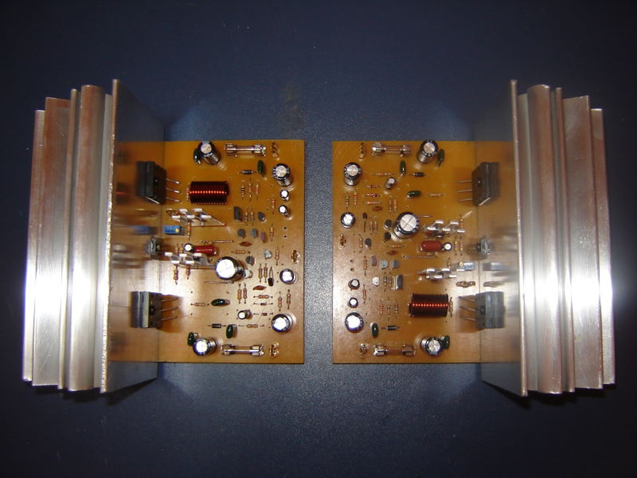

I have just finished to assemble my home unit...the one i have tried to match
using simulator and i have finished to adjust listening....it is playing and i do think anything can be better.... to make it better i have to replace the band that is playing, the audio source.
How can something be better than the perfection?

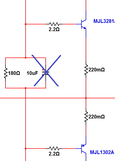

Please, remove this electrolitic condenser
This bothers a lot when we go adjusting as capacitors opposes to voltage variations, it charges and discharges and disturb a lot.
Remove it or install a 100n in place as low values will not bother and will procceed the suck out action too.

That capacitor is usually there to minimise the AC impedance between the bases.
That minimised impedance then maintains a very low AC voltage between the bases and that allows the output transistors to perform their function.
yes the cap can be varied over a wide range of values.
Some optimisation will probably benefit the amplifier.

is nonsense. The capacitor holds a charge set by the dc current through the 180r. The AC signal adds, or subtracts, to that charge when the capacitor is too small to pass the AC signal. When the capacitor has low AC impedance for the frequency being processed the variation in charge across the capacitor is the AC current times the AC impedance. That AC voltage must be low, otherwise the capacitor is too small for the signal being processed.capacitors opposes to voltage variations, it charges and discharges and disturb a lot.
cannot be the correct solution.Remove it

One purpose of that capacitor is provide an ac low impedance path from say the top output transistor base (npn) to the bottom driver transistors emitter (pnp). The necessity from needing to quickly turn on the upper transistor (sucking out excess base charge) following a large signal positive excursion, by using the active bottom driver.
This action will result in changing the voltage across this capacitor which will then change the effective bias and idle current across the output transistors.
The delta voltage and time required to return to the nominal bias is dependant on the capacitor value, so you end up balancing cross-over distortion (not enough capacitance to turn-off the upper transistor fast enough) and resulting idle current change (to small a capacitor) and the recover to nominal idle current (too large a capcitor).
Same effect on capacitors which shunt any vbe multiplier except for the difference in how these are charged or discharged during large signals.
These two effects made it really hard for me to measure the heating effects of the output transistors following a short large signal response (I was trying to measure the idle current as an indicator of output transistor temperature change).
-Antonio

It was disturbing a lot Magnoman.
I use to check things into the workbench, with soldering iron in my hands..and there these effects comes true.
Simulator said it was lovely there...that reduced THD..but real life it was driving me crazy... i am returning to my traditional, standard, 100n suck out capacitor.

Doubt on the connection 680 ohm resistor (R32) in your design PCB layout, which reported 156.
One end of the resistor 680 ohm is connected to collector (C Q8), but on the scheme necessary to the base (B Q8).
Regards PETR NICONOV
