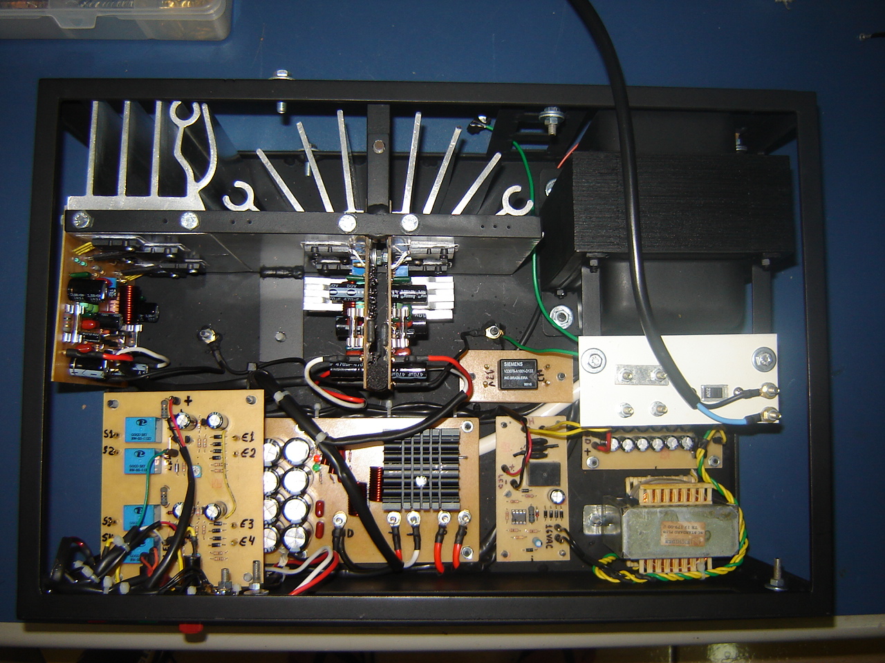

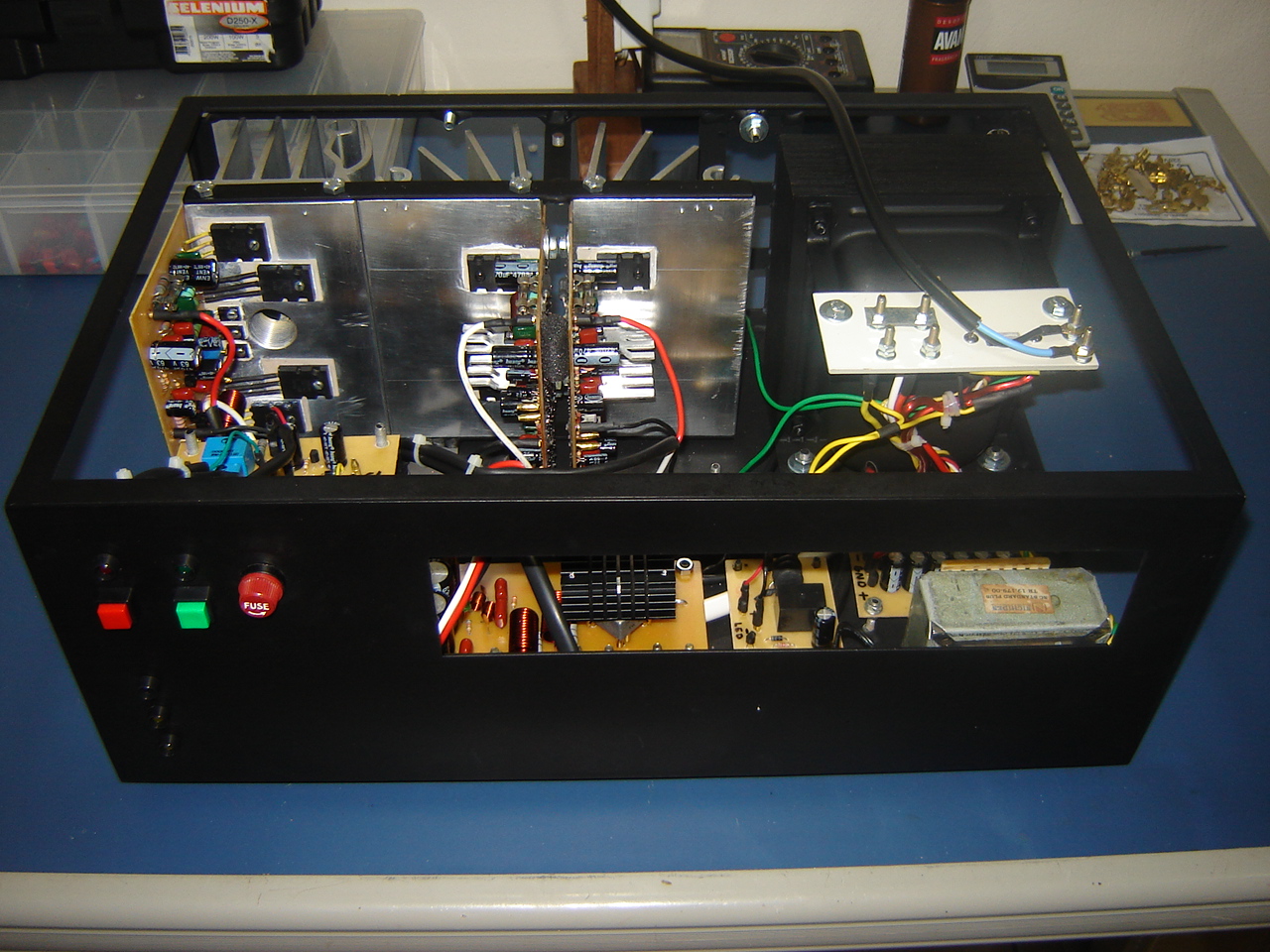

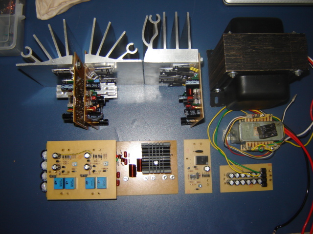

I am making a Dx Supply to the Dx Super A
Here you have prototype:
Dx Super A - Dx Voltage regulator - YouTube
regards,
Carlos
regards,
Carlos
Playing with the Dx Super A power supply
It was not adjusted, not tuned, or optimized, not calculated...i have made it by memory only....it will become better.🙂

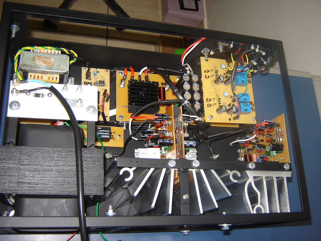

We need huge heatsinks to use Super A, the transformers also is bigger
rectifiers must be bigger, filters must be bigger (15.000 plus 15.000uf) to a single channel.... it is almost a new amplifier...so, people that has made the Dx Blame ST and want to use the Super A features, will be forced to replace some parts and to use forced air cooling.
Temperatura ST 80mA Bias / 100% Vol - 52Cº - YouTube
Carlos
Carlos

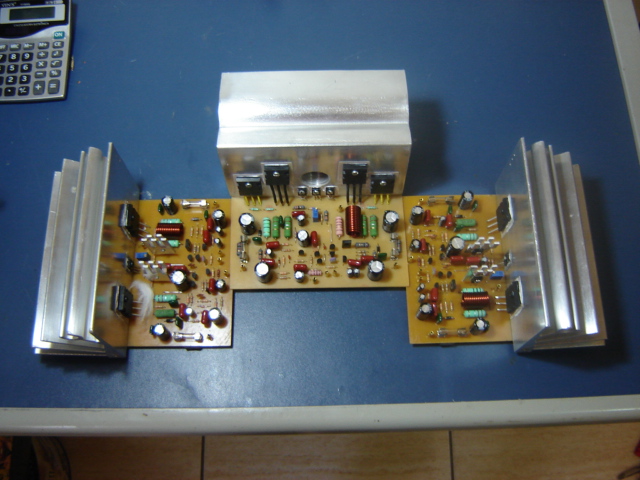

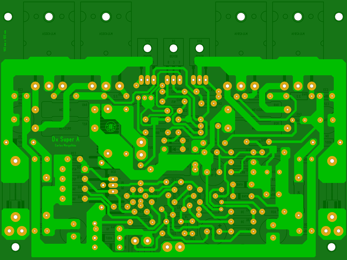

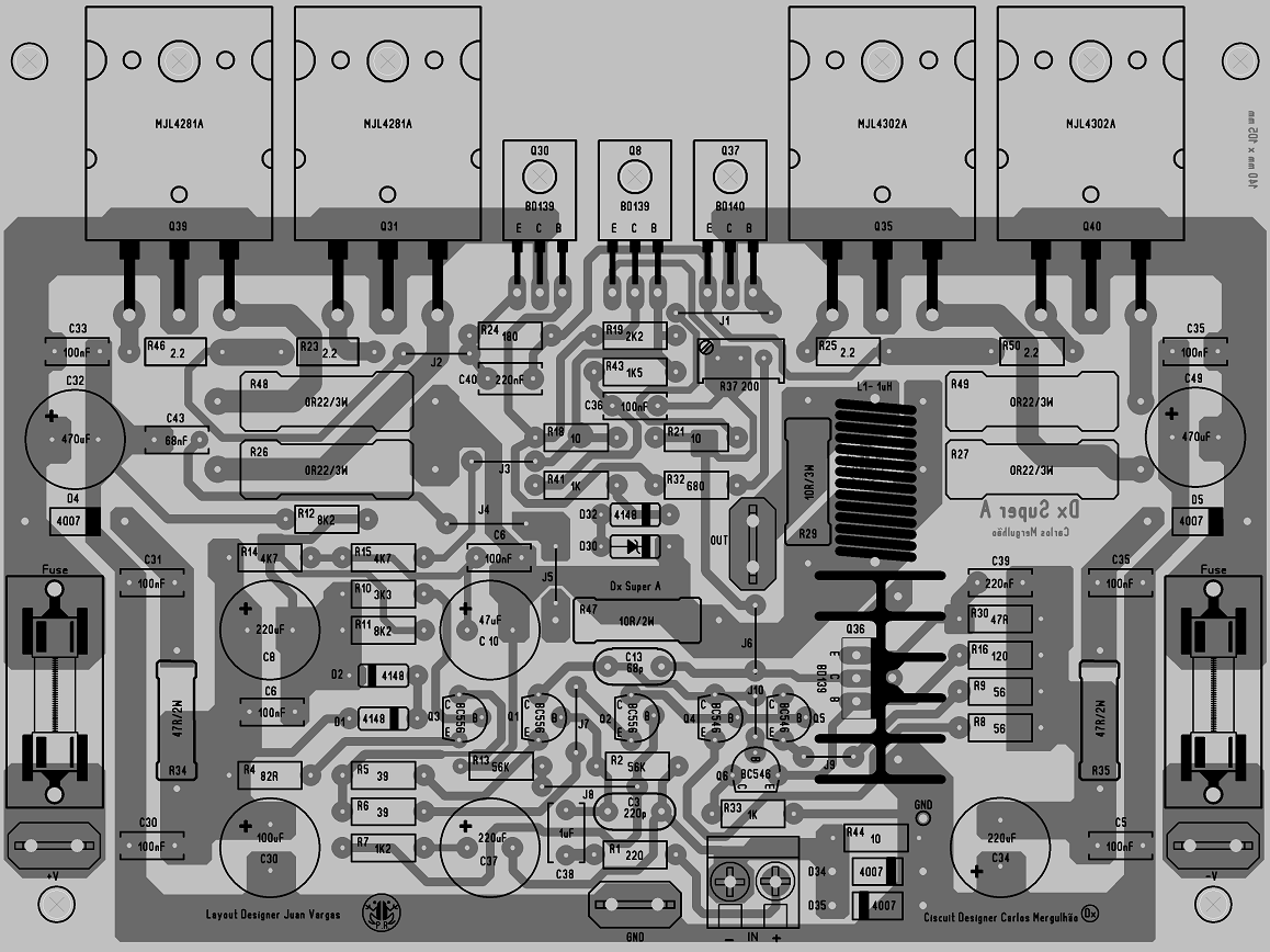

Mister Carlos does not feel well today so I just want to announce that the Dx Super A layout is finally completed and it will be check it by Carlos as soon he is better I don't want to bother him, this is just a quick view of how it looks for now it might have changes later, so this is not a final yet, until mister Carlos check it and approved.
Regards
Juan
Regards
Juan
It is almost perfect Juan...it is time to finish to release it
put something to separate Layout Designer - Juan Vargas and reduce your "frog" or increase my "Dx" in order to make them same size...and anything more to comment.
But we have (you and me) to give a tripple check in all connections to see if anything was missed or shorted, or having tracks almost touching each other (avoiding this way, solder shorts and capacitance trouble)
Not layout designer Juan Vargas, put Layout designer: Juan Vargas .... or Layout designer - Juan Vargas
Congratulations Juan...you have learned from the begining...made it from the scratch, and even this way you have made it so good as a professional.
But we took two or three weeks..... Alex mm do that in 50 minutes or less.... the guy is a layout machine!

Hi to allMister Carlos does not feel well today so I just want to announce that the Dx Super A layout is finally completed and it will be check it by Carlos as soon he is better I don't want to bother him, this is just a quick view of how it looks for now it might have changes later, so this is not a final yet, until mister Carlos check it and approved.
Regards
Juan

It can go to 300 watts at 2 ohms...but none of these transistors will fit
With these transistors you show me, for instance 2SC5200 and it's complementary you can go to 150 watts at 4 ohms only and better not to install a 2 ohms speakers or load on it
Supply voltage is 42 volts DC positive and 42 volts DC negative (from a 30 plus 30 volts AC transformer)... you will need huge electrolitic condensers, 15.000 plus 15000uf/50V to operate 8 ohms and twice of that to operate 4 ohms..... do not use 2 ohms with these transistors you have available..they will not survive.... your supply power will be 300 watts or 300 VA (or more) to face 8 and 4 ohms loads (75 and 150 watts RMS, distortion THD 0.0014%)
If you want to operate 2 ohms, then you should find MJL4281A and MJL4302A, your supply power must go to 700 watts or 700VA to one single channel, condensers must go to 40 thousand plus 40 thousand microfarads, insulating voltage should be 50V or more, you must use, at least, two output pairs, your heatsink must be giant and your supply voltage cannot drop from 42 plus 42 volts.....you cannot use higher voltage than that....cannot use 43 plus 43 volts and if your heatsinks choice was no good you gonna loose all your power transistors.
To a single channel your heatsink must be equivalent to 70 aluminium blades measuring 10 by 10 centimeters assembled together as a heatsink having 70 fins... this is to one channel only and full power that is more than 300 watts RMS at 2 ohms.
Cannot increase voltage .... do not even try, your BD139 and BD140 may explode if you do that...maximum is 42 plus 42 volts...and to obtain full power cannot have voltage drop...... having voltage drop your power achieved will never reach the maximum.
Carlos

Pcboard layout is almost ready to go to the manufacturer
I have made my final revision, i have found some mistakes that gonna be fixed today and then the pcboard will be ready to go.
Juan will prepare black and white layout to home etching, will publish them here, and today, and you will be able to make by yourself.
A video, about my final inspection is being uploaded and soon you gonna have the link for it.
Juan has the intention to produce 4 pcboards, a stereo for me and another stereo for himself....just that...but you can try to ask him to order for you too... go to his email and give a try...i do think you will receive a no as answer..but you can try... we must always try... we never know the result without try.... this adress below is Juan Vargas adress.
