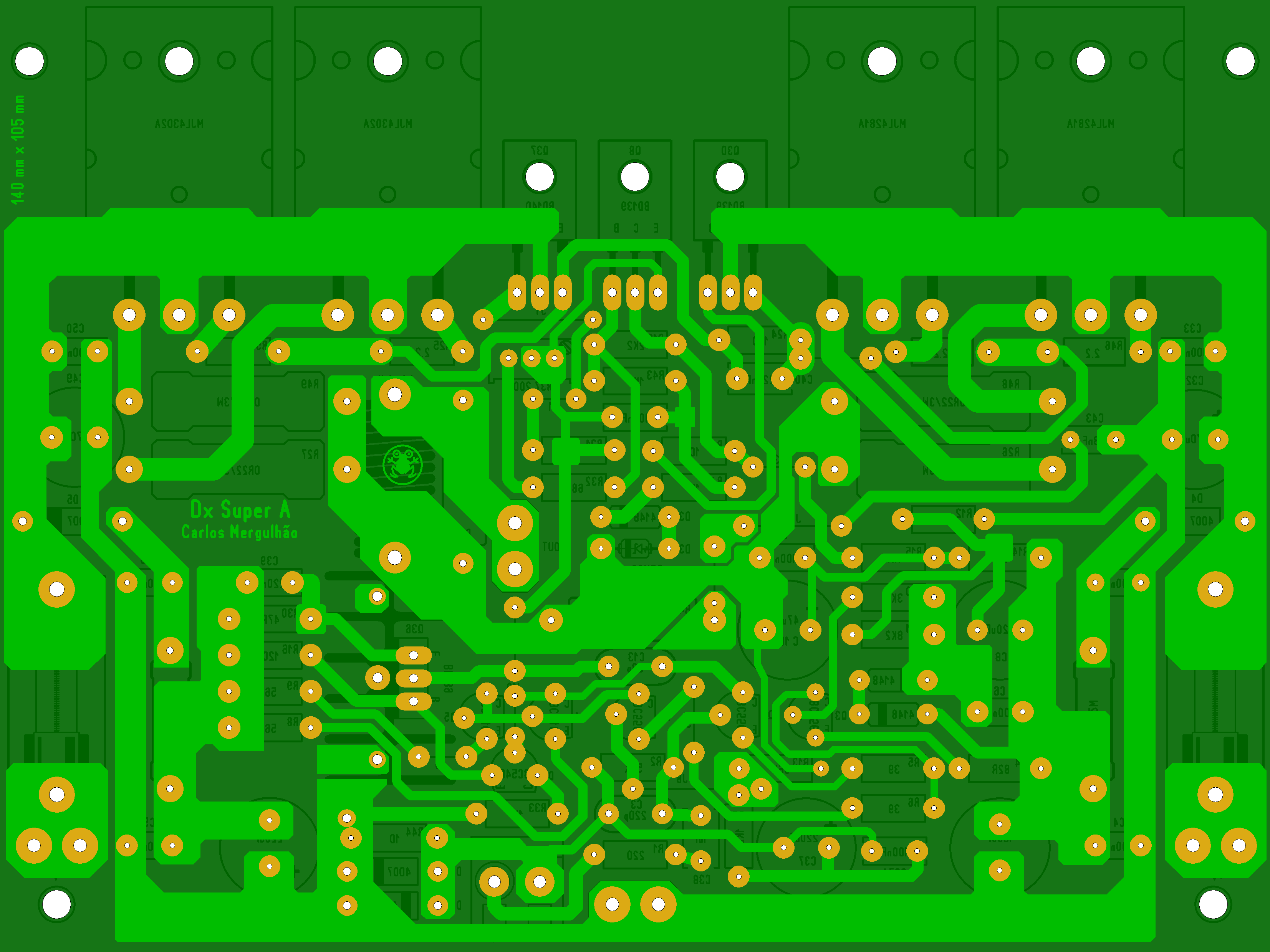

Juan will produce pcboard to the Dx Supply
What you can see that may look strange?
First you gonna see a 3300uf in parallel with 220uf.... this looks crazy, but it is not...the big one is to use together Class A amplifiers or Super A amplifiers, the other is to Class AB amplifiers...into the board you will solder one or other, or will short jumpers to switch from one condenser to the other.
You can see diodes...the left ones are connected to the supply, a non regulated supply, so, having voltage drop you gonna see variations into the LED light intensity.
Also you can see green LEDs in the output... this is the regulated, or stabilized side... there you should have small voltage variation and the green LED should light in a steady way without too much flicking.
regards,
Carlos
regards,
Carlos

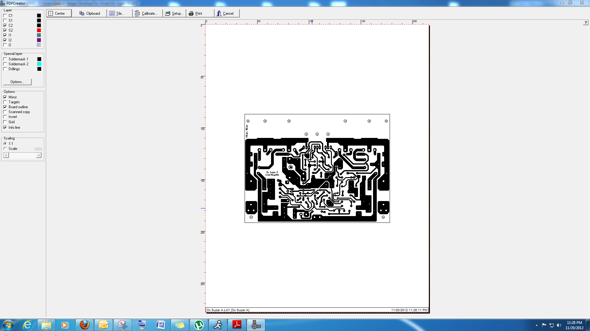

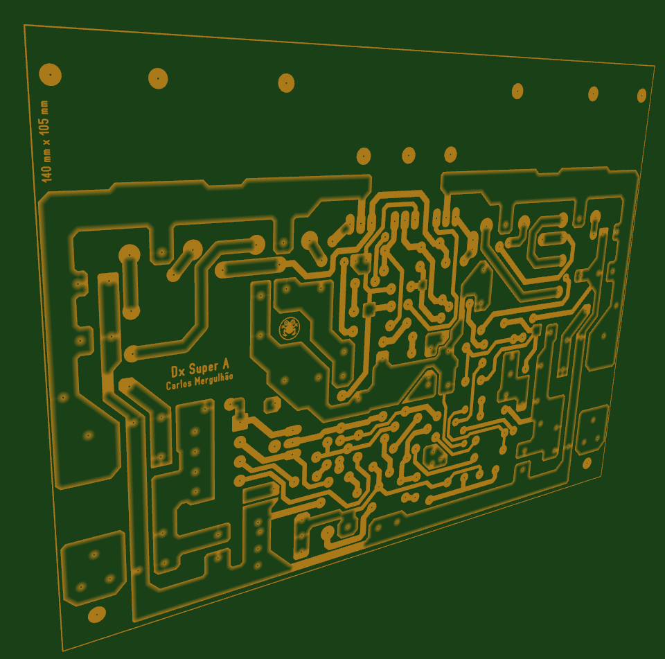

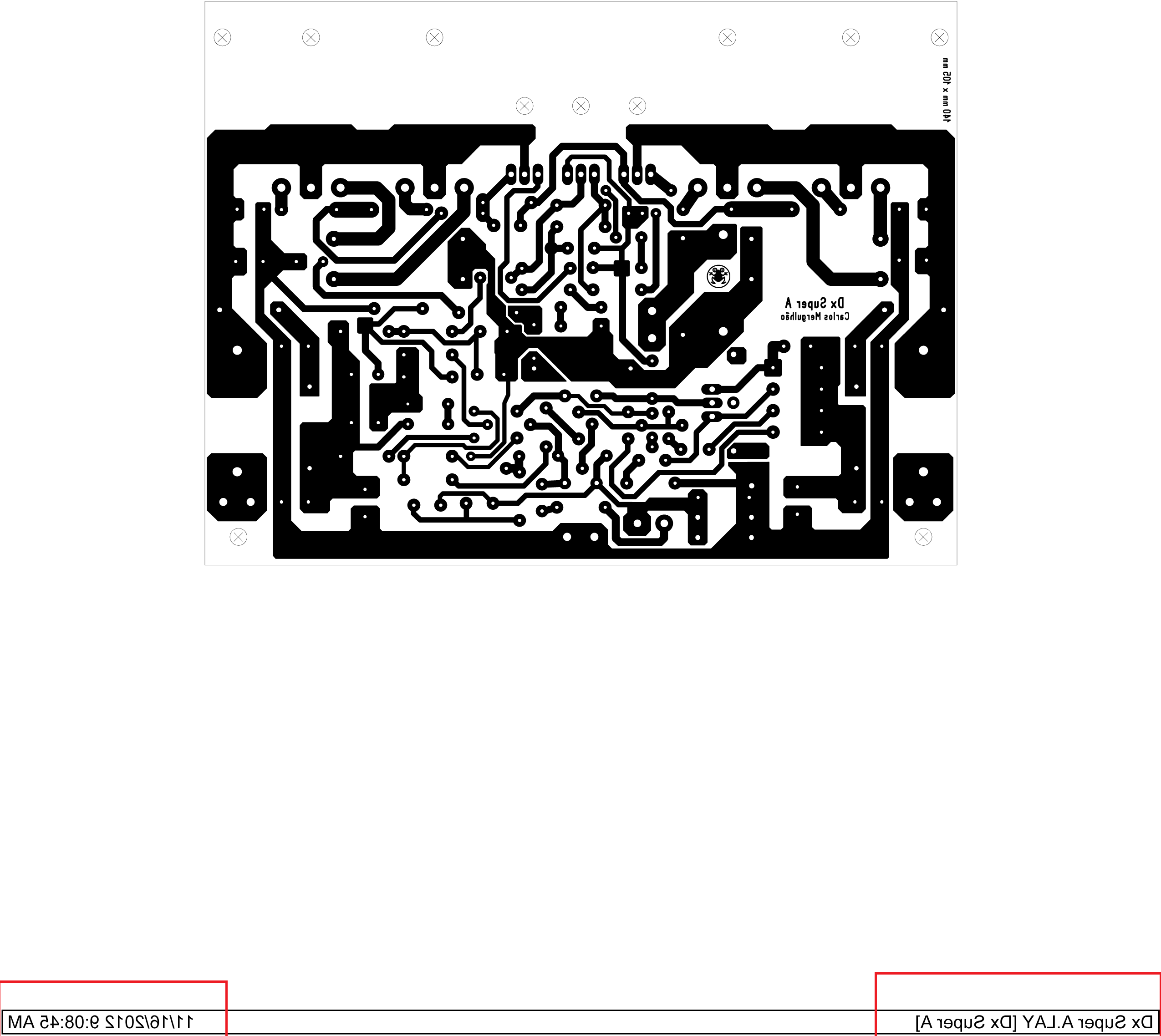

...just noticed in post #189 (pdf files)...
My dear Juan, the pdf for toner transfer hot iron method should look like the attached image...😉 The image in your pdf was the bottom copper view, for toner transfer it should be the top copper image.
but dear abeti why you flip the image? check this out bro both images be happy! 😀
Regards
Juan
Regards
Juan

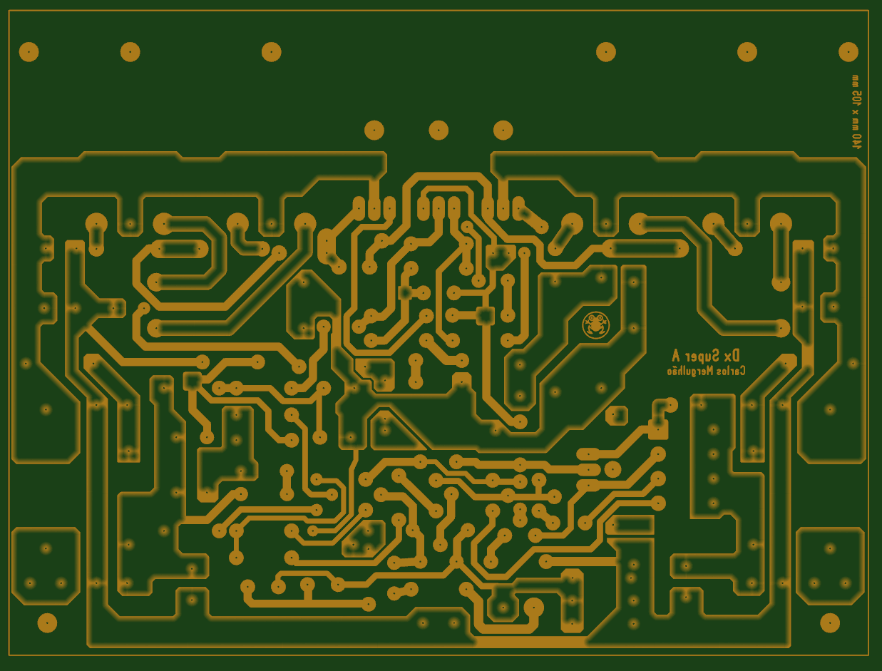

Ok, how do I explain this, both of your posted images are the bottom views, the printed copper tracks will become reversed because after printing, you will be flipping it over again so that the copper printed image will come face to face with the copper surface of the pcb (for ironing). That'll do if you are going to put parts directly on top of the copper, but that is not going to be the case.
Pay particular attention to Q36, after printing Q36 goes to the left side, flipping it over so that it will become in contact on the copper surface of the PCB Q36 goes to the right side.(this is supposed to be the correct orientation but it is the pcb bottom copper that goes on top), you will be flipping it over again so that the parts sits on top of the board and Q36 goes to the left again, it has now become wrong.
I'm not so sure if you are getting what I' m trying to explain, that is a lot of flipping, it can become confusing but take a printed material and follow my directions and you'll find out why. It'll help if I can include images but I'm at work in the office.
I see what you mean.... we gonna fix that
As soon as possible.
Many thanks by your kindness...i really had not time to check this...was not assembled.. we will order pcboards to test, and your help was precious.
Thank you very much.

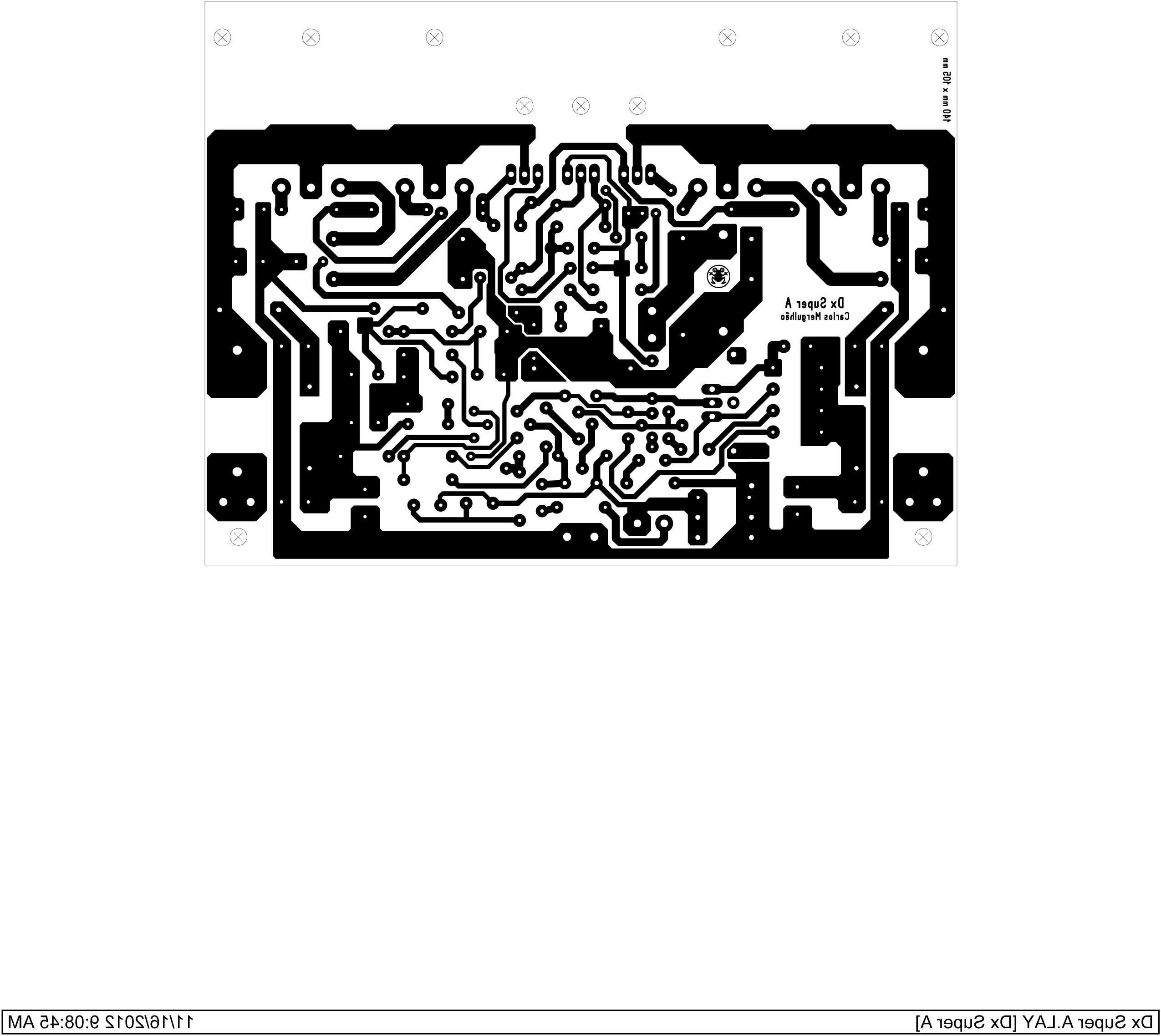

abetir I'm going to place the files again check your printer I do not know way you printer print flipped images or you did it in purpose? any way here are the files top view and bottom view. here also some images virtual board 🙂. by the way is my fault not Carlos he is too occupied and he didn't notice.
Regards
Juan

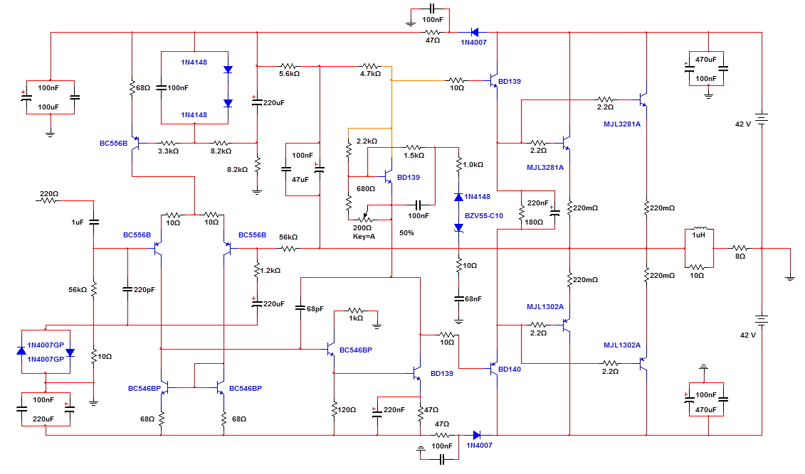

700mA each rail, then we increase the volume..when the zener diodes senses 6 watts RMS it starts to conduct and goes reducing the current...at 70 watts the DC current is 33mA per rail.
Very simple, and because of that it is very good.
regards,
Carlos
When the output is positive the 1N4148 will prevent any conduction
since the VBE multiplier voltages are more positive than the output.
When the output is negative the said diode will conduct but the zener
has a value high enough such that conduction do not occur as the output
voltage is never 10V more negative than the VBE multiplier voltages
unless high threshold mosfets are used as power stage.

I'm sick today, but as soon I feel better I will to make the power supply board layout . i got to go back to bed sorry guys more info later.i d8 not feel good 🙁.
Regards
Juan
Regards
Juan
Take your time to have a rest dear Juan...flu is not good
Go to sleep...we can wait this correction..no problems.
Carcass.... we are doing it, we have Zimmer in Brasil producing layout and he may offer the pcboards.....but will take some time..... he is too much busy, he use to wake up 04:00 AM and return home to sleep 09:00 PM.
Juan is doing too, but i am not sure if he will open this to produce pcboards to the whole world, this is something to talk directly with him...he is authorized to produce and sell.
Zimmer said that can send the pcboard everywhere since the guy pay...he said (kidding) that can send to the hell if devil pay and inform the home adress.

You gonna like it Bruno
Tenho certeza que você vai adorar... i am sure you will love it.
I am working together Zimmer....pcboards are almost ready...also we will test a SMPS supply to make it standard to Dx amplifiers (If approved)...we gonna use higher frequency not to be picked by the amplifier circuit...will not be easy because the Dx amplifiers goes easy to 150 Kilohertz.
We will prepare, not only Zimmer but also Juan Vargas, a Dx Supply pcboard.
Also a Dx low pass filter (not Dx design, this one is in all electronic books) but tested by the "Corporation".
