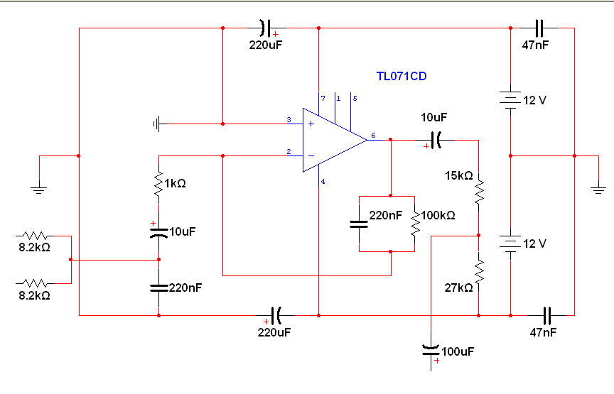

Uncle Charlie,
Is it possible to post DX Low Pass Filter Shematic?
Thanks..
Uncle Charlie,
Thanks..
Schematic is not mine...this is standard low pass filter
You can find in the internet, also in any electronic book.
But it is not ready, i am still adjusting... the schematic is in the video, i have found it in a video from a South American guy (Video Rockola).
This is Universal kind of circuit that can use any operational amplifier..there are billions of different operational amplifiers around.
These input resistors are there to collect left and rigth channel, the idea is not to mix left with right channels, but they do that causing interference in your power amplifier separation...they should be increase.... nearby these resistors you have 220N..this one filters the source high frequencies and should be removed too....other capacitors may be increased in order to change the audio bandwidth.
Many other things will need tweaking... do not build for a while...it works but not that good....it can put out 250 hertz, i do not know about you but i hate 250 hertz.... to subwoofers i do thnk maximum is 180 hertz.
http://www.youtube.com/watch?v=fHLnb8hOJhA

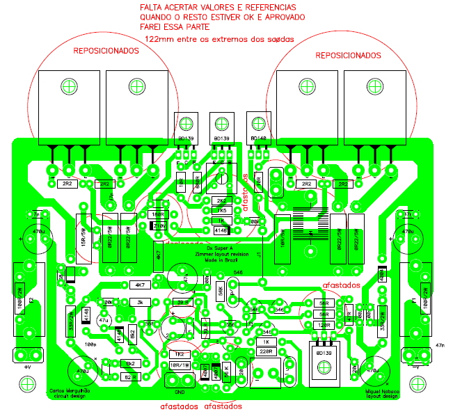

Some friends are sending me email asking for pcboards
I am sorry, i do not have any to sell, also i do not sell pcboards...but some friends can do it, feel free to contact them.
Juan layout is ready, has only to invert (mirror)
Zimmer (brazilian Kraut) is adjusting.....in the reality we are doing it together, fixing some stuff....his layout is not available for a while but will be near future.
I have posted these guys email adresses, so, if you want...go direct to them.
One Brazilian will test Juan's layout this weekend.... his name is Newton and i will post his video about as soon as he do the job.
Your decision to buy pcboard or build this amplifier is correct..you will see this worth the time and material you gonna spend..the amplifier is extraordinary.... do it...even over a piece of wood with copper nails...do it!

Yes, i will post images in black and white for you to etch at home
the wonderfull DIY work can be done...this is the main target.
As soon i have the final work from Zimmer i will do it.

Juan has ordered pcboards for testing
So, we gonna assemble to test these boards prior to order in big numbers.
We want to be sure that everything is fine, also we need to evaluate the pcboard manufacturer, to see if copper tracks and islands, detach if you overheat them...these things should be checked....also the overall quality.
