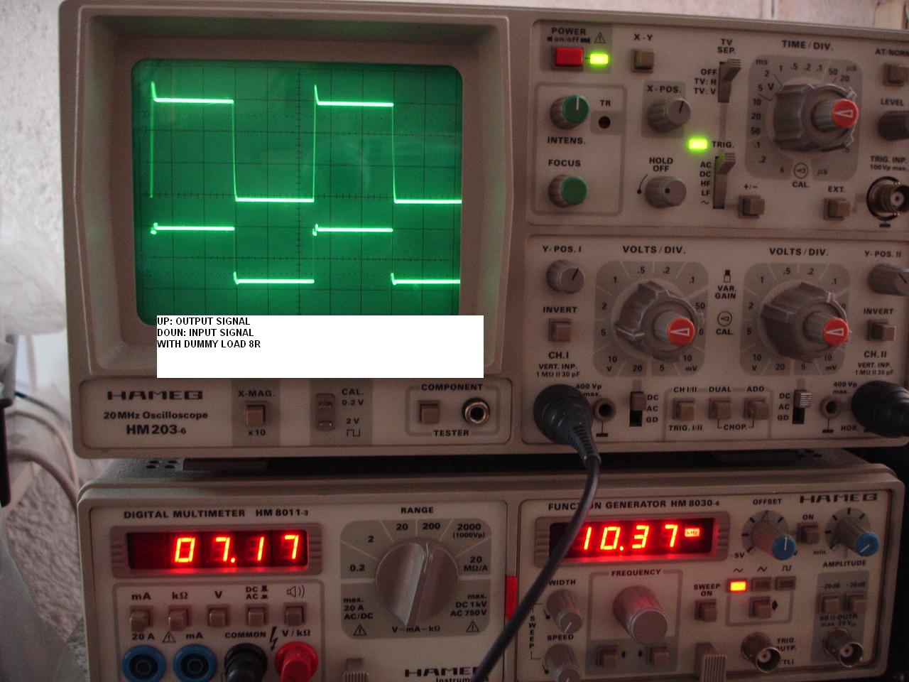

overshot is still here.
I can't upload photos.
I don't know why.

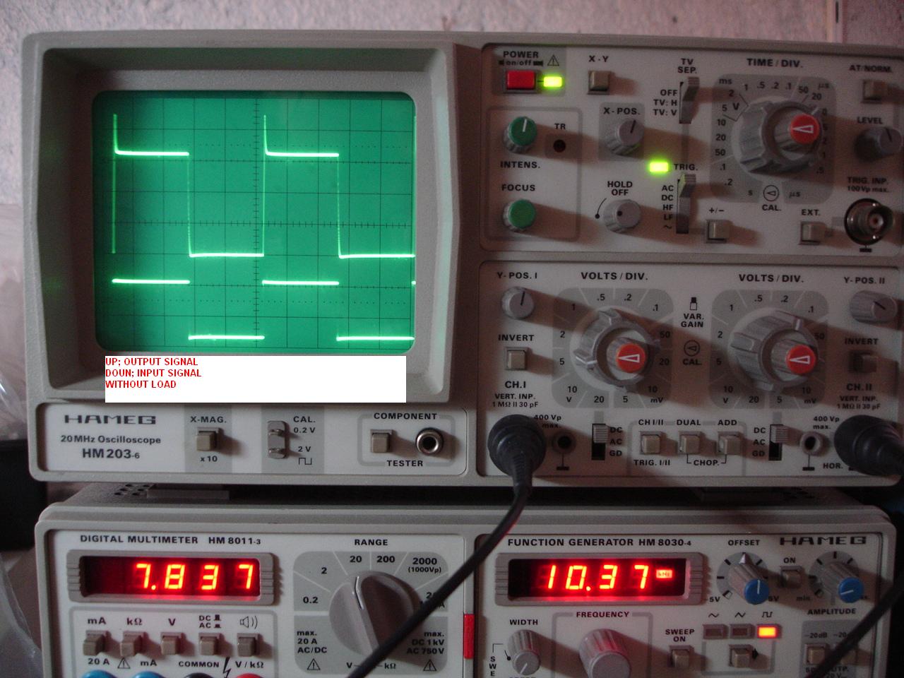

overshot is present on input and output signal if the dummy is connected
overshot is present only in out signal if no load is connected,in this case input signal is absolutely clear.

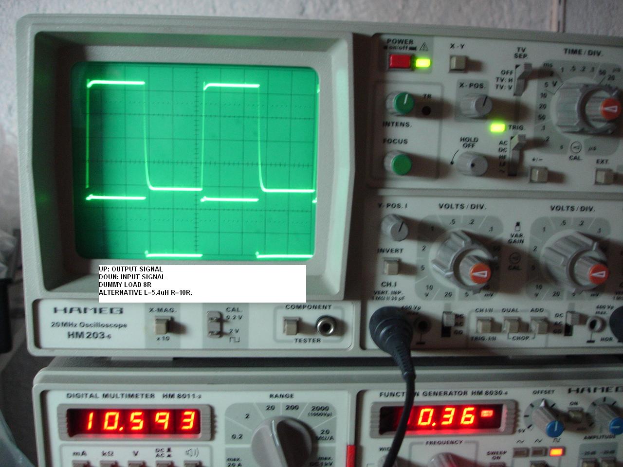

If other RL (about 5uH4)is used overshot is smaller.

Overshoot of the input squarewave is because the Source is expecting a correctly terminated transmission line as a load.
If your Source is a 50ohm BNC, it expects a 50ohm coax and the far end of the coax to be terminated with 50r. This becomes the input signal loading of the amplifier. 100k here is no good for squarewave testing.
Else the VHF portion of the squarewave sees an incorrect termination and reflects back to the source. This roughly doubles the VHF content relative to the LF (squarewave fundamental) level. You see overshoot on the leading edge.
I can't explain why the leading edge of the -ve half pulse does not show overshoot.

''overshot is present on input and output signal if the dummy is connected
Overhot is visible all over frequency width....from 5hz up to 180kz

Now it's time for test!
+/-22V
20mV Offset Without any macthing.
45mV Idle current.
8R Dummy load.
1(one) pair out transistors. 2sc5200 2sa 1943.
10KHz
20KHz
80KHz
100KHz
16KHz
There is a pulse peak as the last picture show.

here are pictures with and without load.
Overshot is present from 5Hz up to 180Khz and from 1W to max.
Now i must change emitters resistors in ltp from 39R to 10R and try again.
