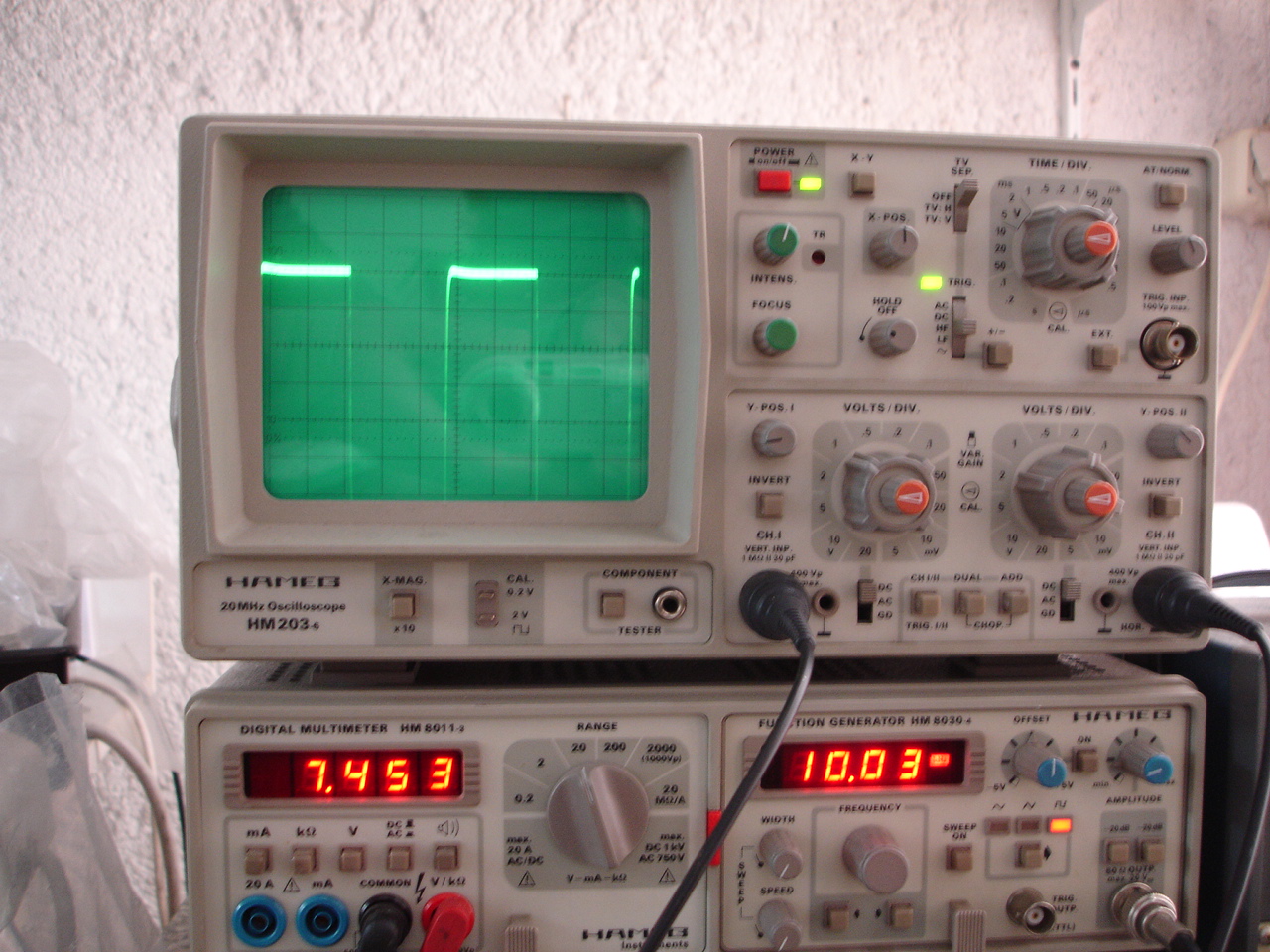

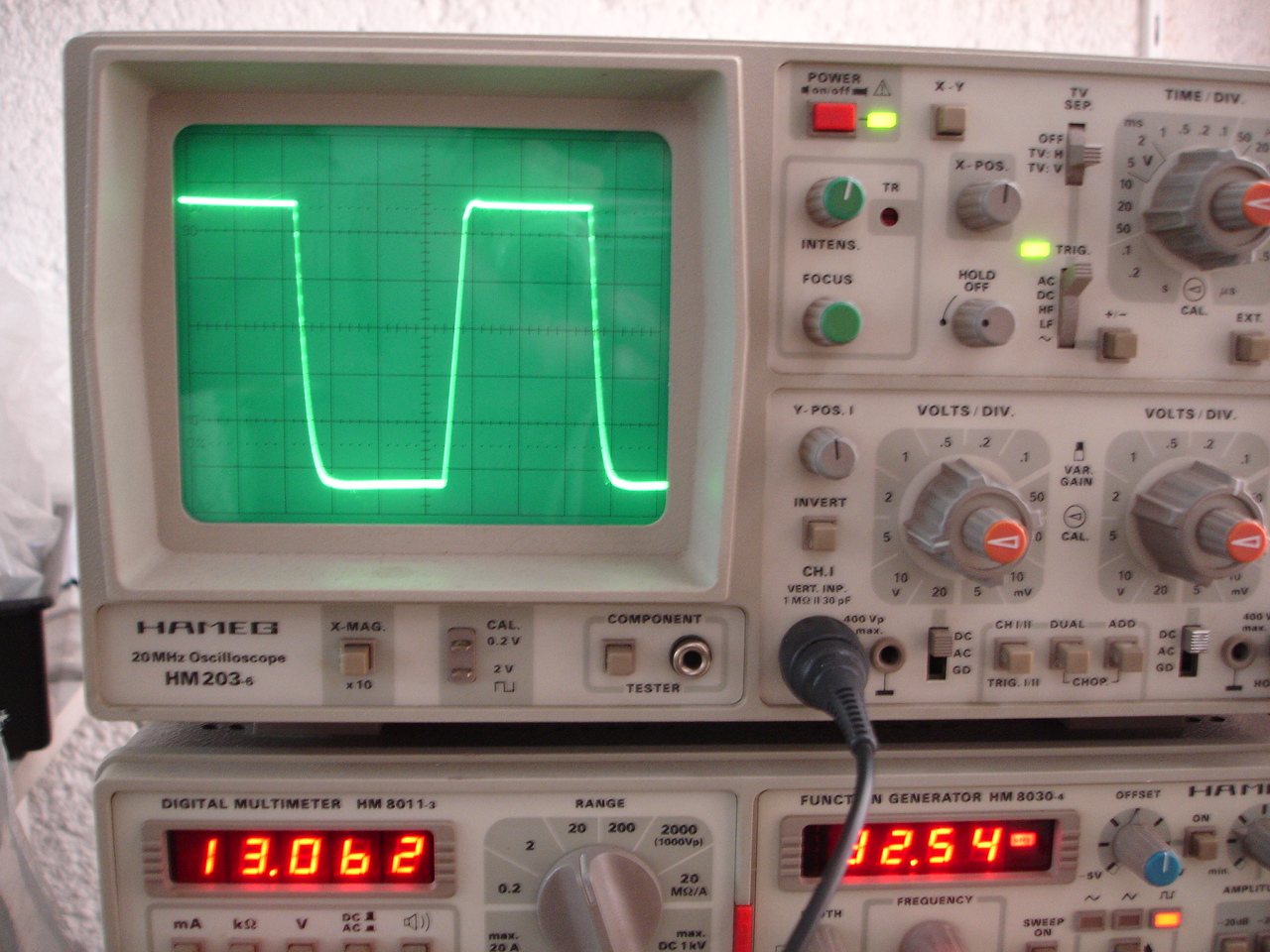

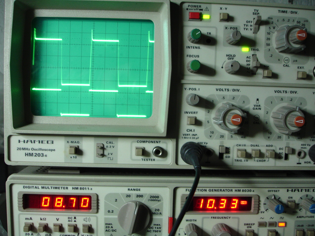

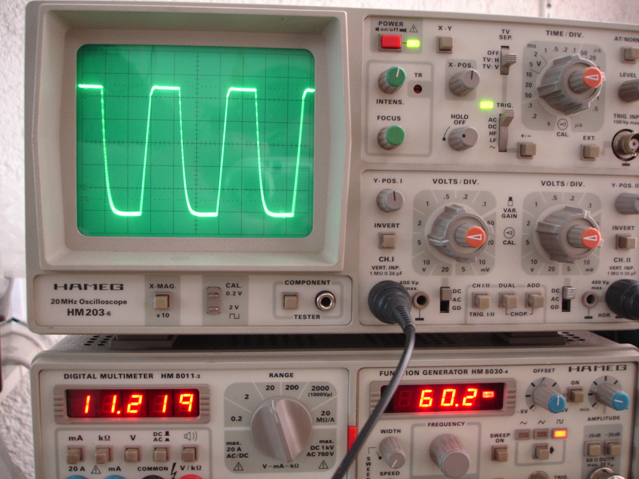

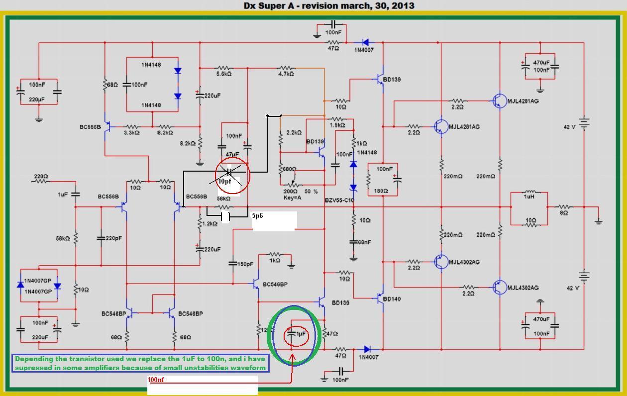

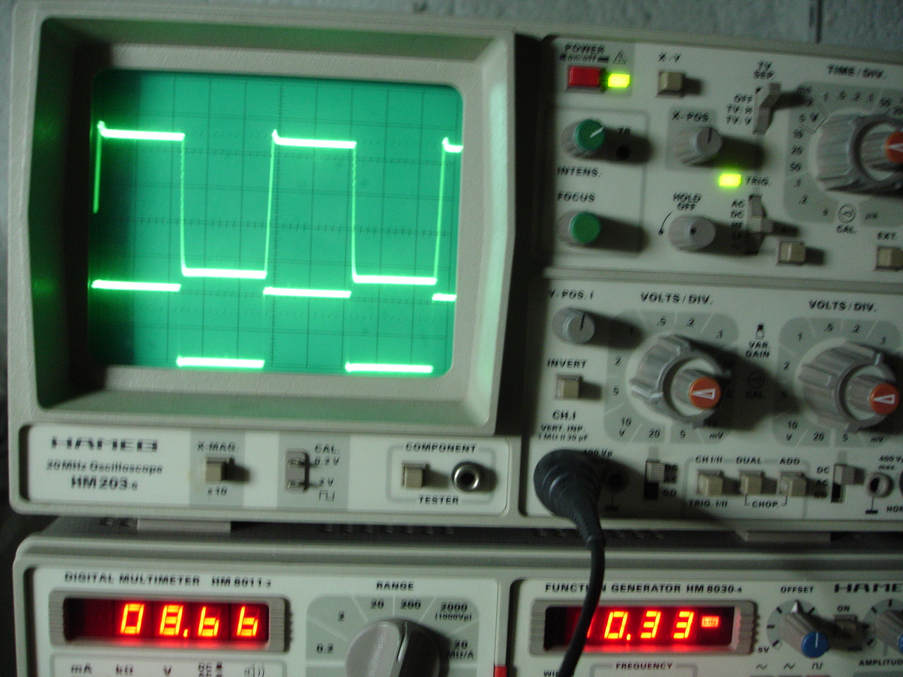

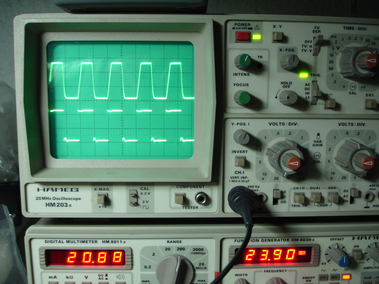

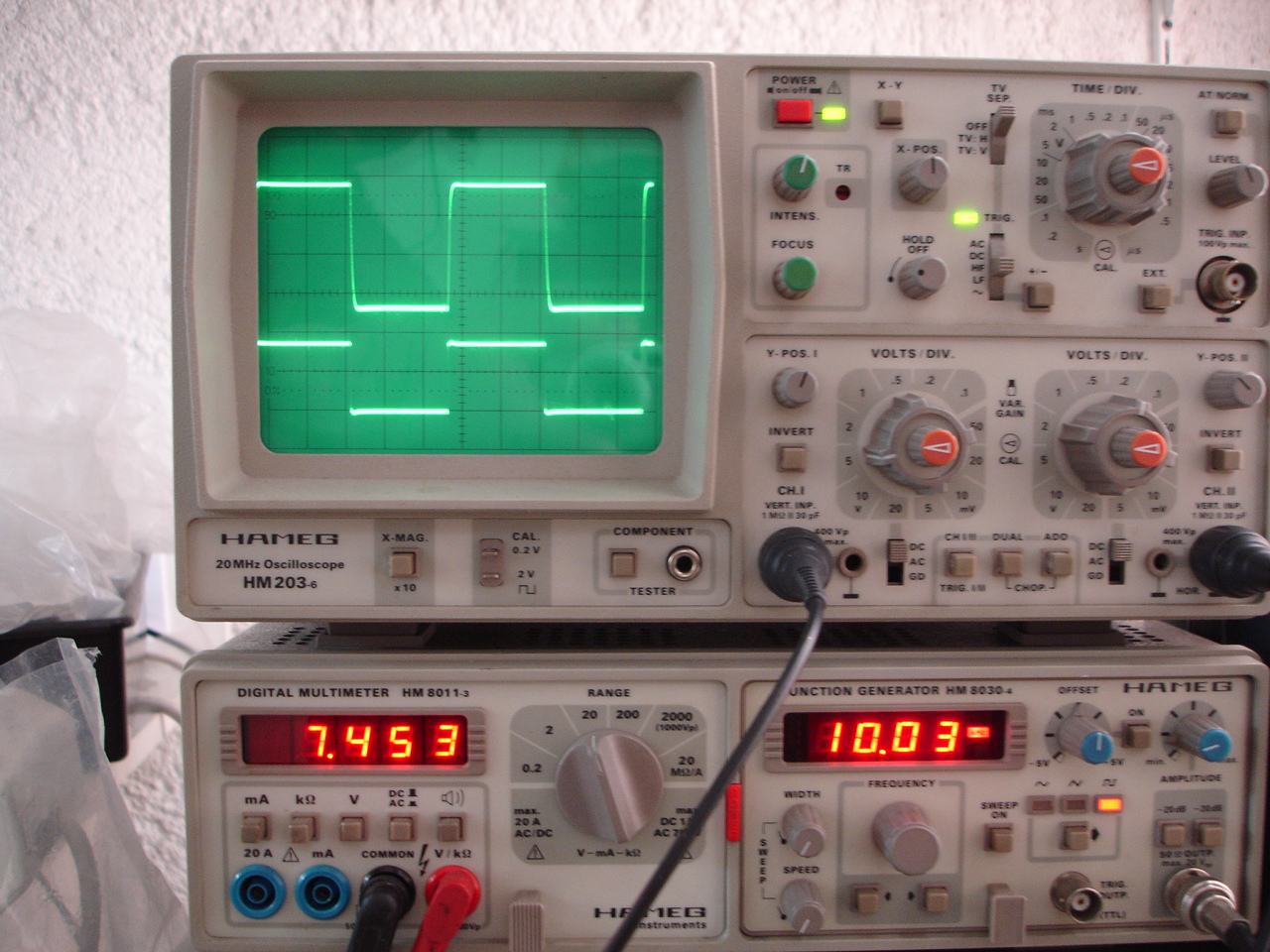

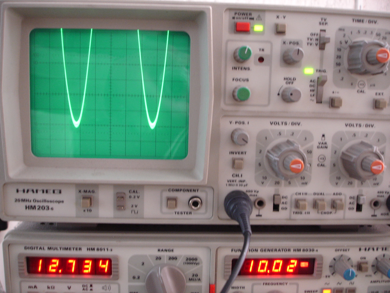

dx super A

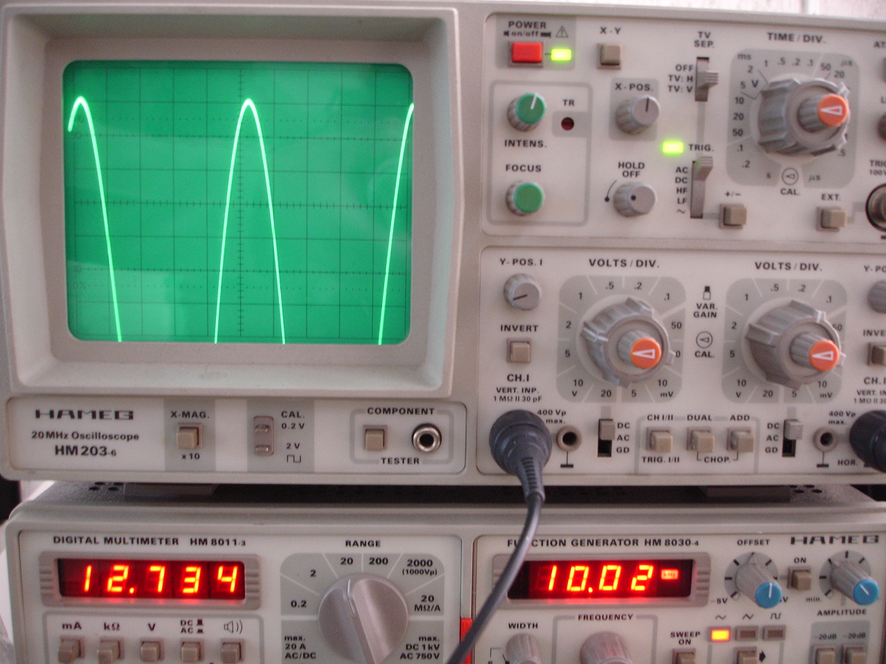

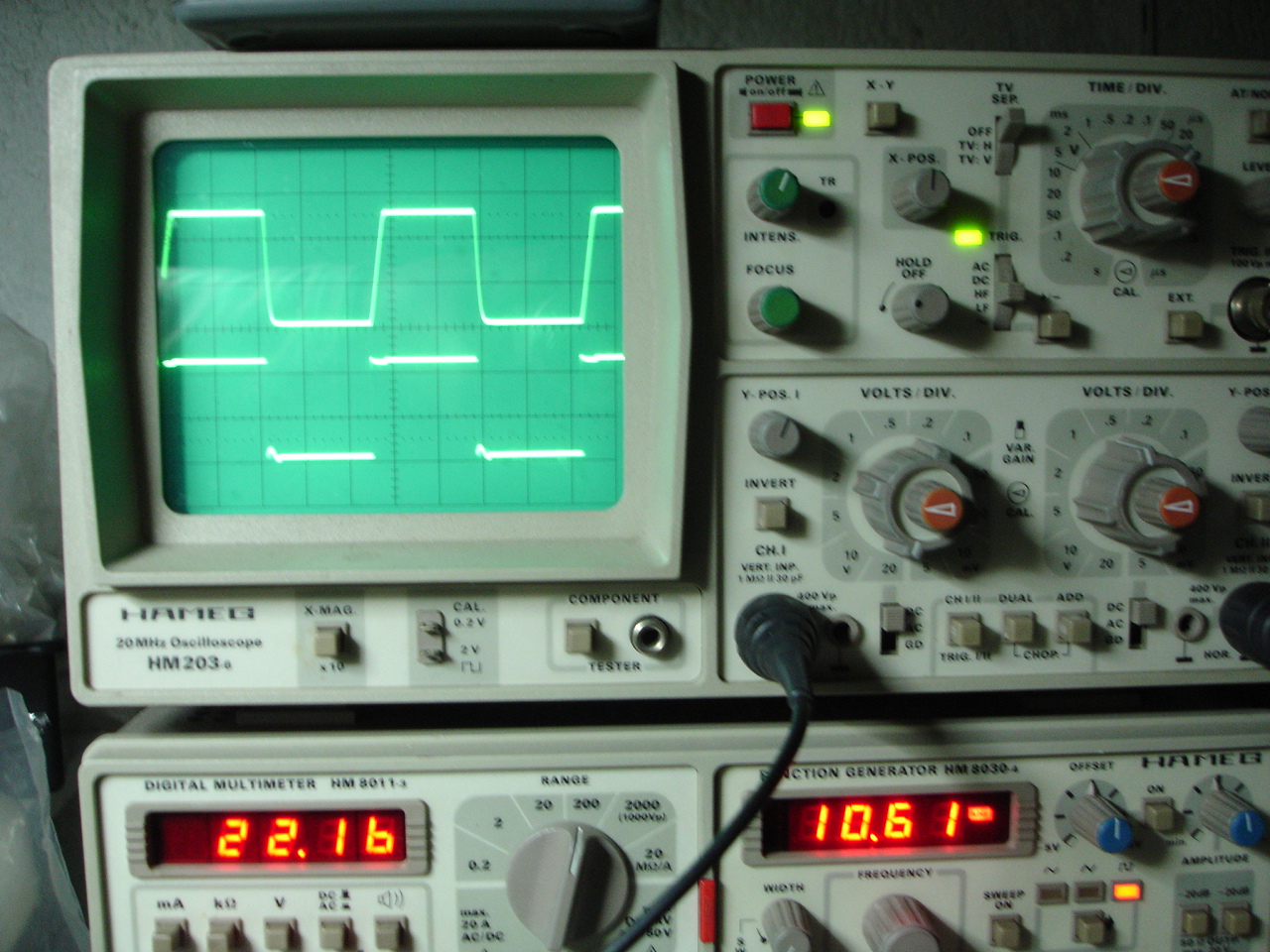

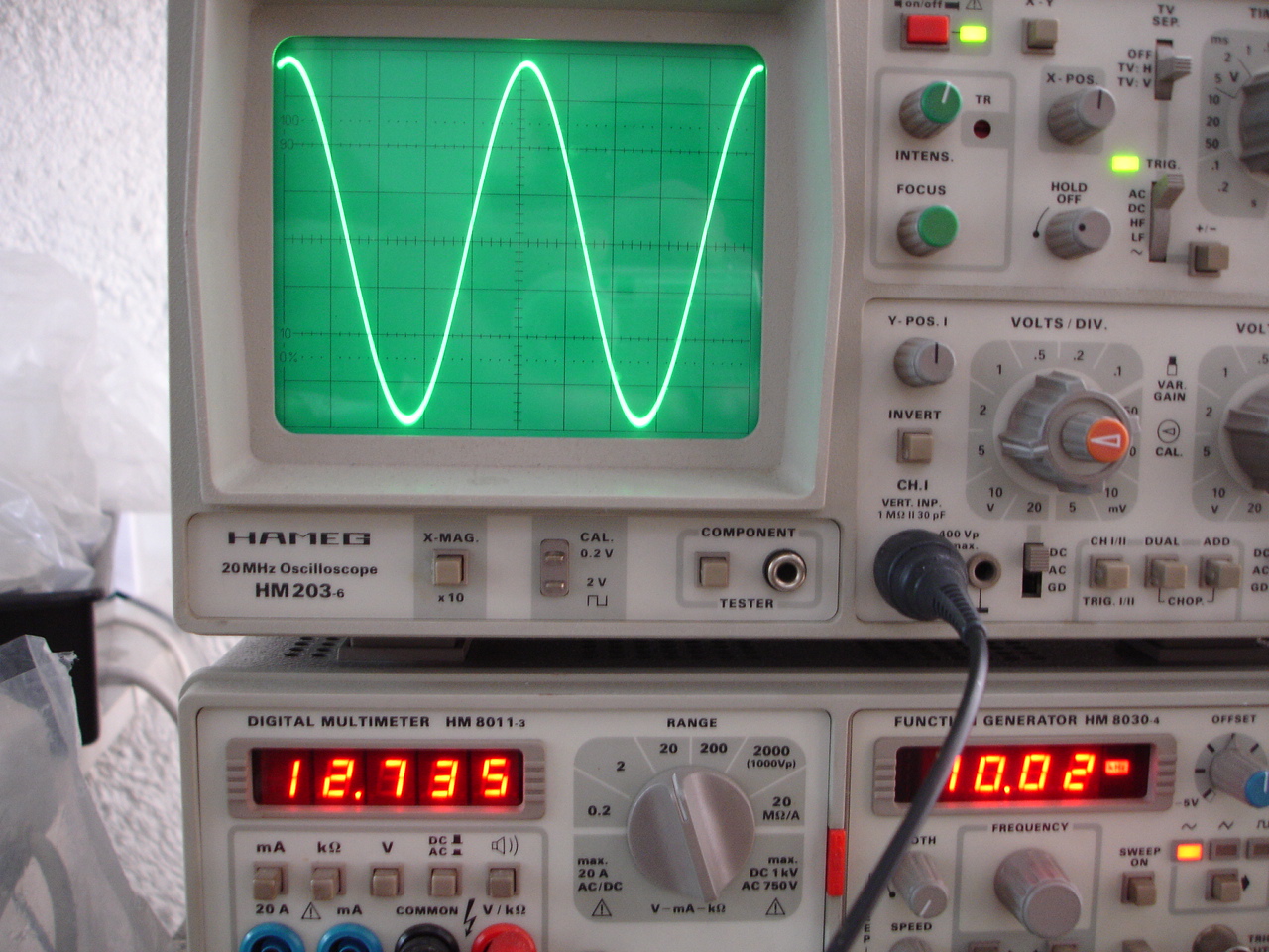

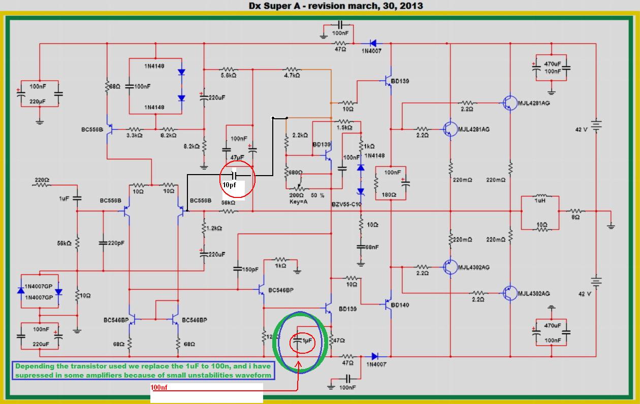

This time i have changed values according to this schematic and i have add a compensation capacitor 10pf as shown from collector of vbe multiplier to base of bc556. Results shown in photos.
First photo .Without compensation.
Second photo.With compensation.
Next 5 photos show some strange things .
I want your opinion about these.
last two photos 32KHz and 60KHz.

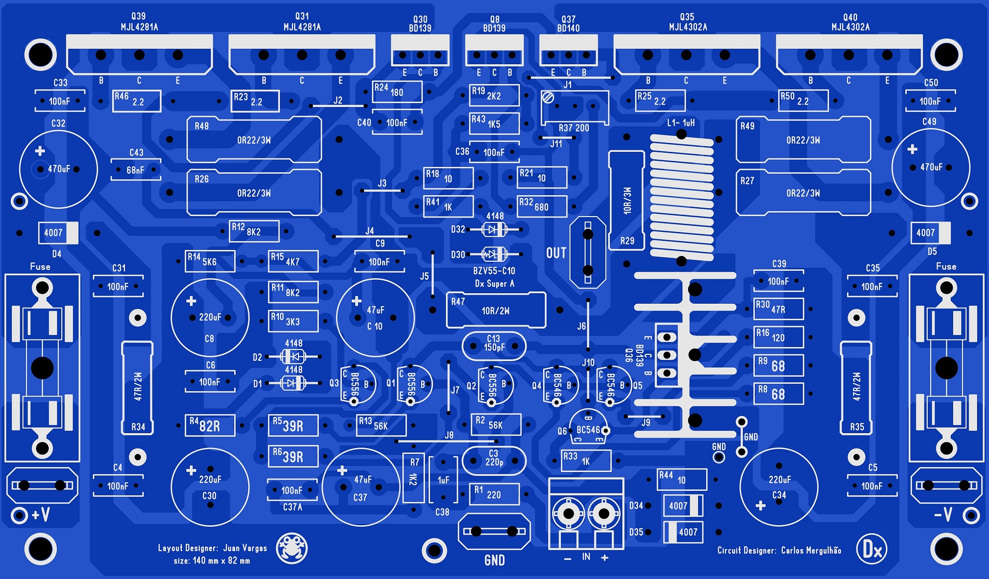

Thank you very much dear Thimios so from base of Q2 a 10pF cap to 2k2 input ? can you show and image where is located the connections? I might find and extra space for it, 🙂 "maybe"
well I'm do not know much about scopes but 32KHz and 60KHz for an audio amplifier is quite a big number maybe AndrewT can explain better, in my mind I will test with 1KHz and 20KHz is the "normal range of testing" but I guess you are a perfectionist guy and that is good 🙂, I simulated but with software just for curiosity Carlos did tested many times and all result are good I believe that the test is good in my personal opinion 60KHz is over kill I never try test and amplifier with those frequencies on my simulators but is all cool 😛

Oscillations. Try to increase 150pF on base BC546. (220pF?)

Compansation capacitor better to place underboard ,see photo BUT in my case 10pf is final value.
Oh no just now i see that compansation capacitor is in wrong plase.

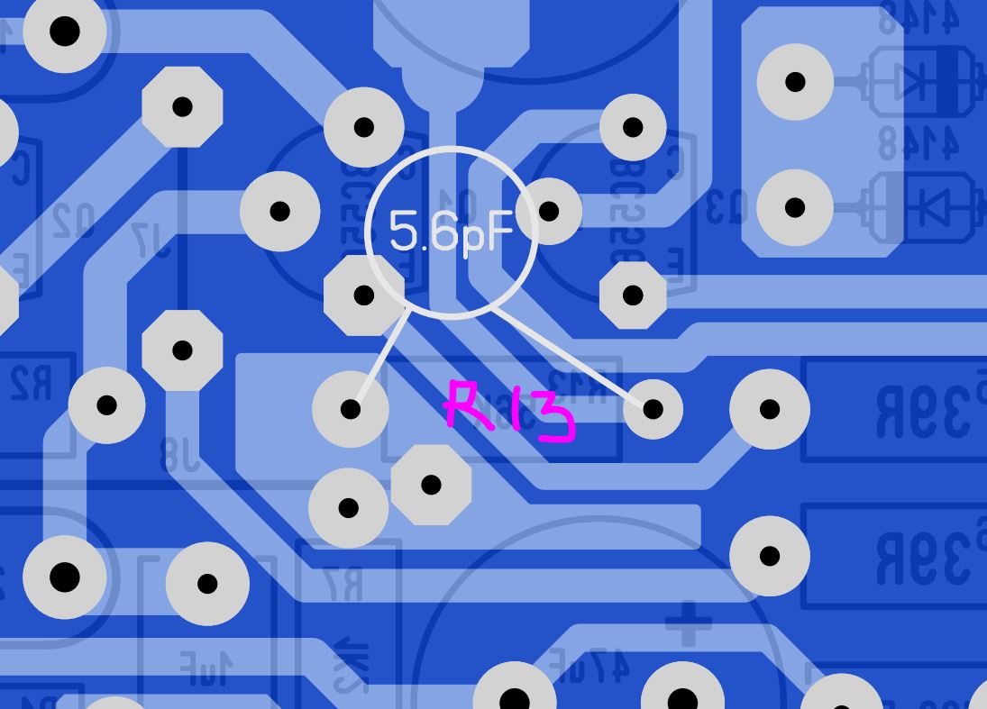

what frequencies you use? I will leave an image here so you can market
best regards
Juan

Ok dear thanks .Oscillations. Try to increase 150pF on base BC546. (220pF?)
I try it soon.

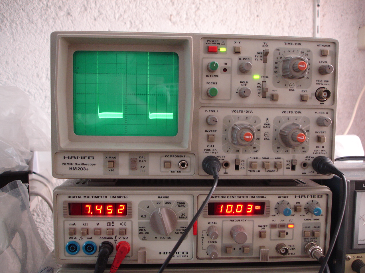

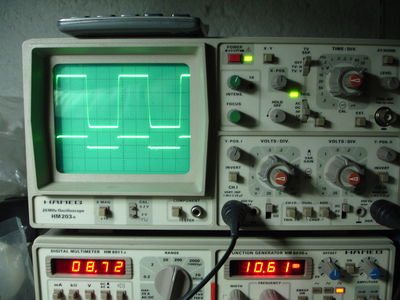

dx super A

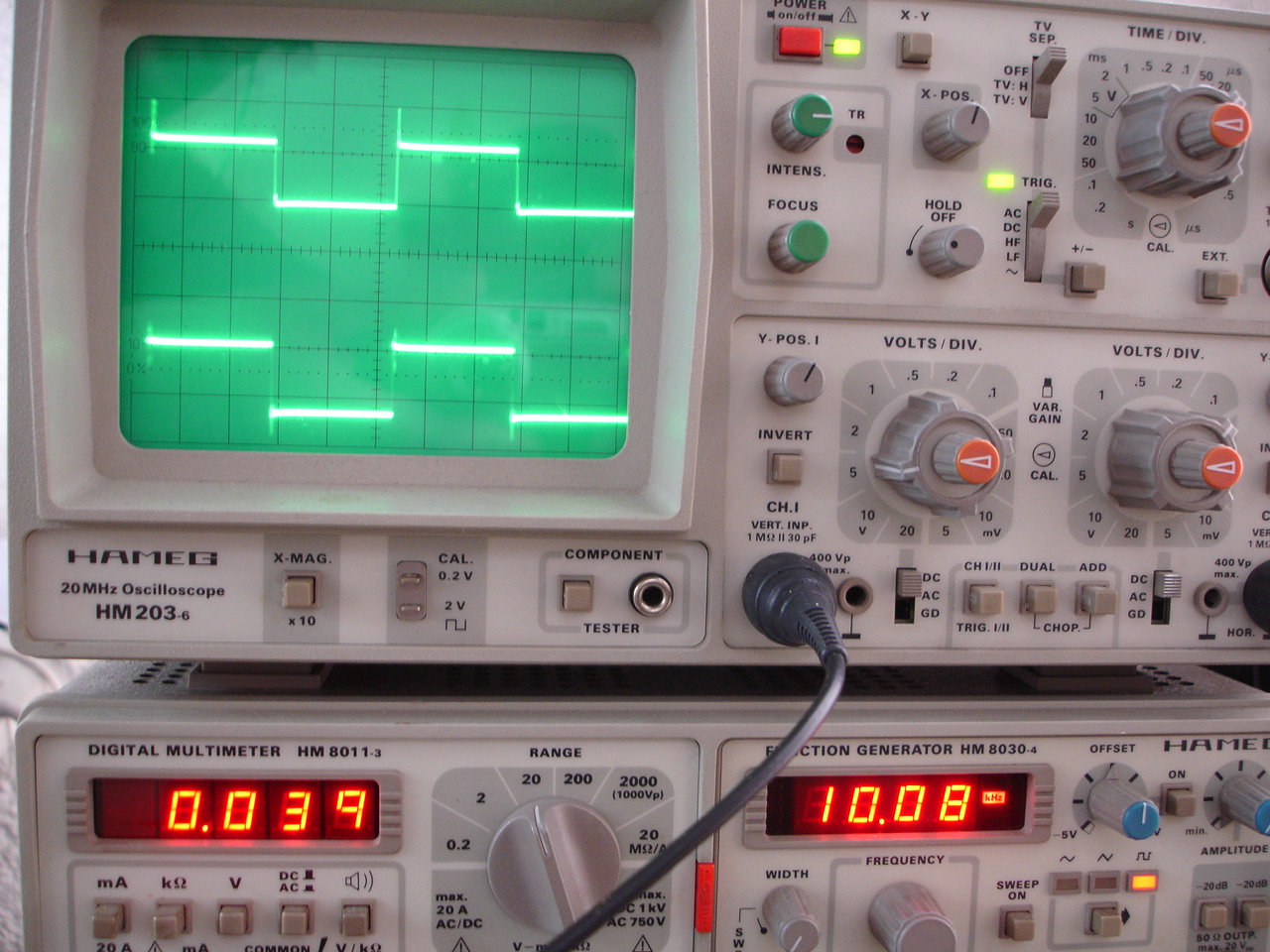

Now i have add a capacitor 5p6 // to 56K feedback resistor.
See photos.
1=Amlifier without any modification
2=5p6//56k feadback resistor.
3,4,5 amplifier WITH TWO(2) MODIFICATIONS. first mod. 5p6//56K, sec. alternative L =5.4uh WITHOUT PARALLEL RESISTOR
Opinions please.

When you increase inductor, is output loaded?
Yes of course ,dummy load 8R used in all these tests.When you increase inductor, is output loaded?

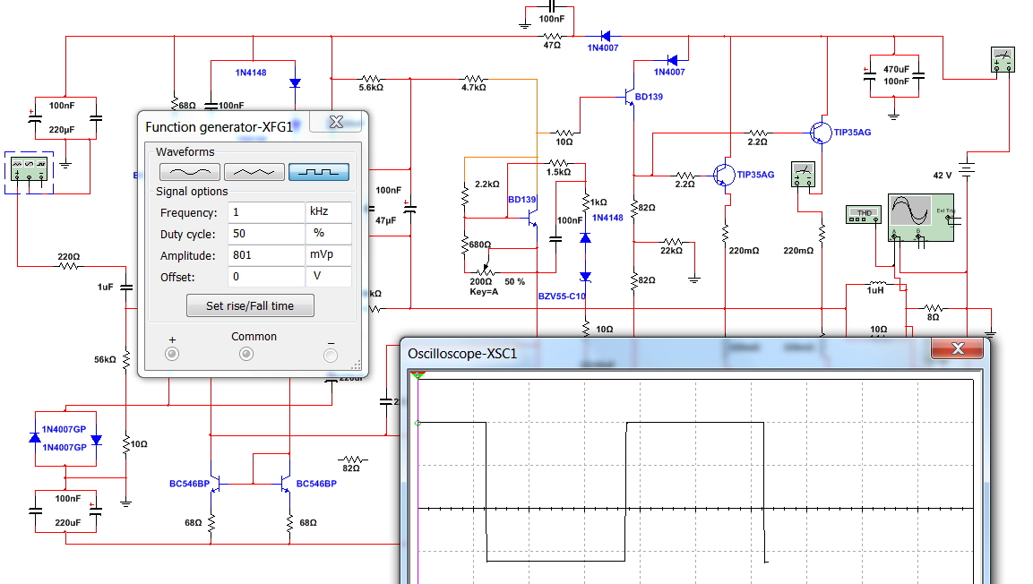

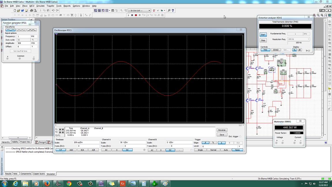

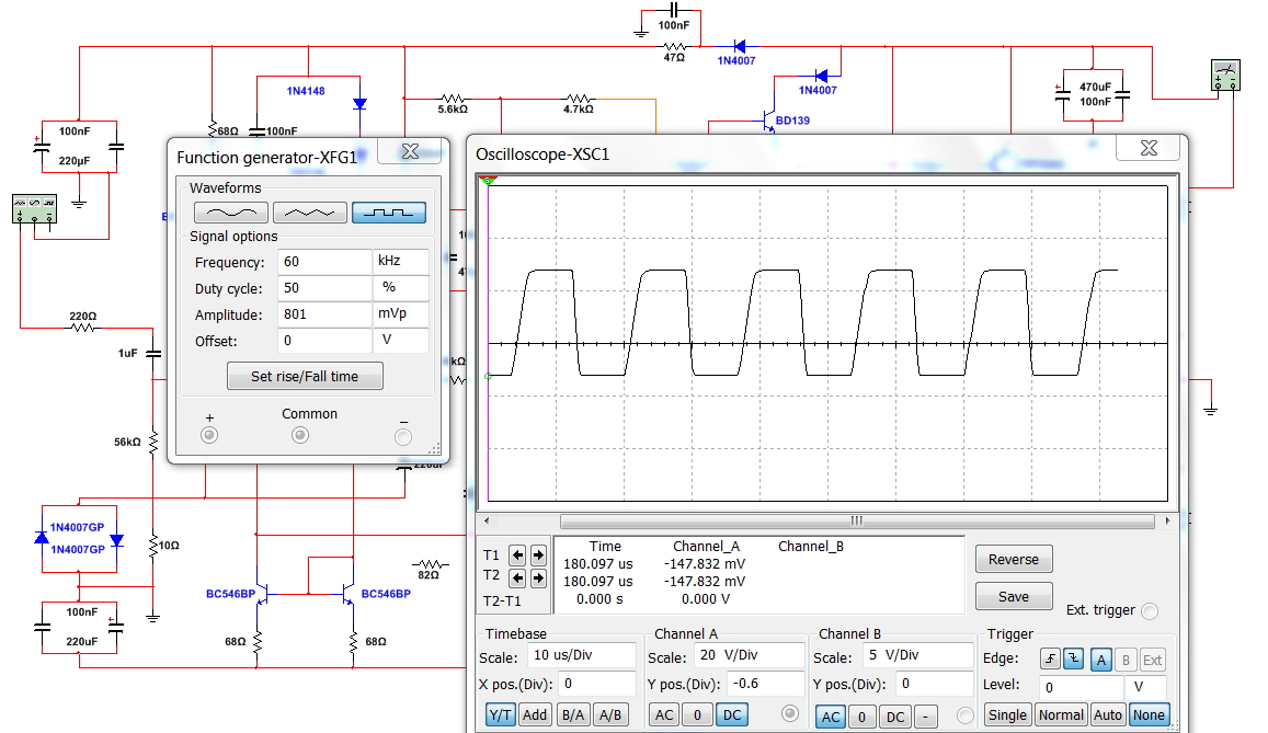

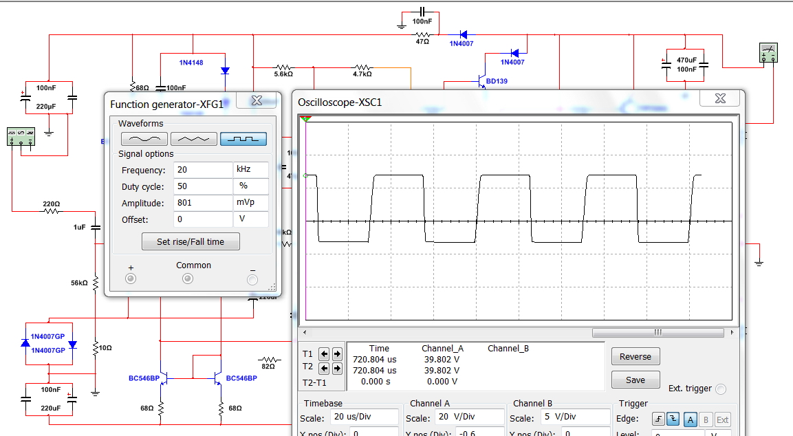

I got home tonight and hooked up my Super A to the scope. I thought I would take some pictures of what I see. I don't usually use square waves. I usually just use a sine wave and look for the point of clipping so I can see how it does. This amp begins to clip at 23VAC into an 8ohm dummy load. I hooked up my scope and at 50k square wave I see a similar shape as what was shown above. At 1K the wave is square. While I was trying to test I lost all output and worried that I had blown something in the amp. After further inspection I saw that the fuses had blown in my cap multiplier. I guess I pulled too many amps while using the square waves. Anyway, I said all that to say this. The amp "sounds" wonderful. I hooked it up today with my speaker switch and had my son, (who is a musician), come in and listen. I compared it to the Honey Badger, Symasym and Leach Superamp. He was unaware of which amp was which when I switched them and he picked the Super A each time. The closest was the Symasym.
Anyway, I'm not sure what the little peak is that shows up on the scope, but it doesn't seem to affect the sound. I did notice that Thimios used the Phillips BC556. I tried those when I first assembled this amp and couldn't get it to work. Once I replaced them with Fairchild BC556 it worked fine. I also installed a STMicroelectronics BD140 at the same time so I can't be sure which did the trick, I just know it worked perfectly after that. I said I wasn't going to do this but I highly recommend these boards. Juan did a great job.
Blessings, Terry
