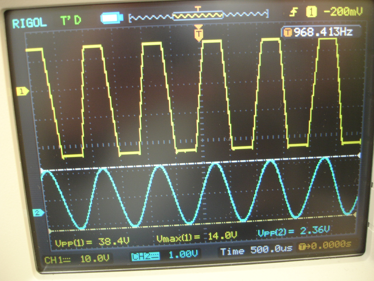

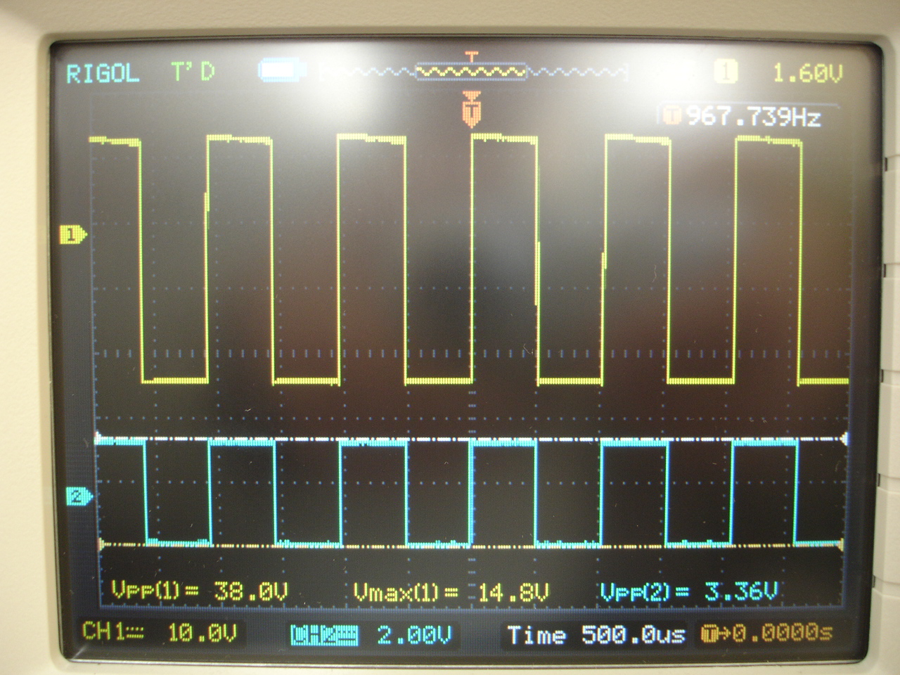

I am not talking about 1W/1khz sine, but about overshot at raising egde of square wave, about visible "steps" at falling edge, about visible unstabilty in negative halfwave, and about lot more ..It is to away from "blameless". Autor should fix it, not to deny any criticism as not friendly.But what can saturate on 1W 1kHz?
If such nice peak is present on 5Hz square than I expect sine 1kHz sine to reveal weaknesses. But, as I said, thimios should measure it. Uncle Charlie claim that amplifier is not technical but sonic tempered. Maybe there is secret of good sound? Well, maybe we shouldn't discuss it...
Bad presumtion, this behavior is dU/dT dependant (speed of voltage change)..If such nice peak is present on 5Hz square than I expect sine 1kHz sine to reveal weaknesses
If you call "sonic tempered" instabilty , sticking and overshoots, than yes, is really "tempered". But I call it weakness and mistakes, sorry.that amplifier is not technical but sonic tempered.
For dT = constant, it should look different if we change time domain.

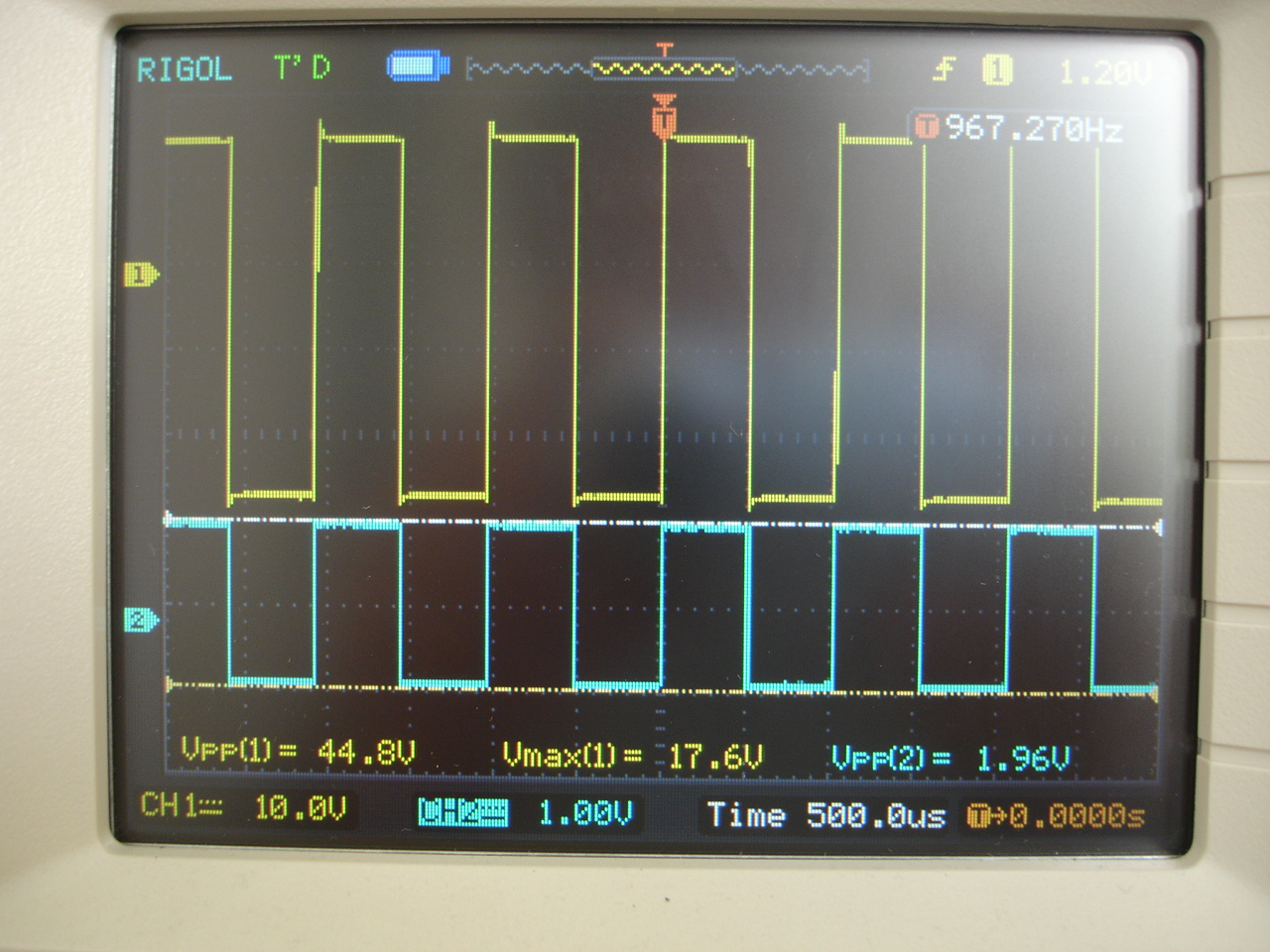

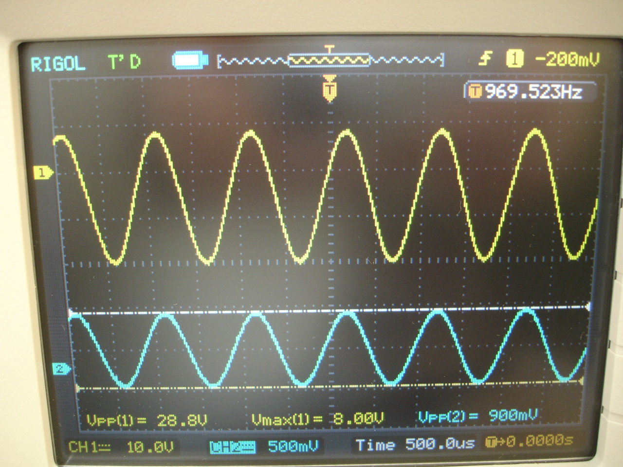

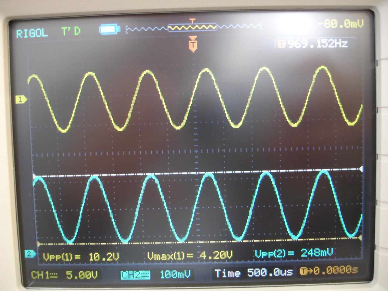

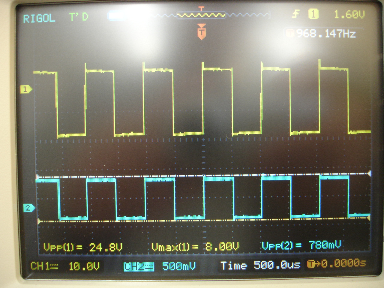

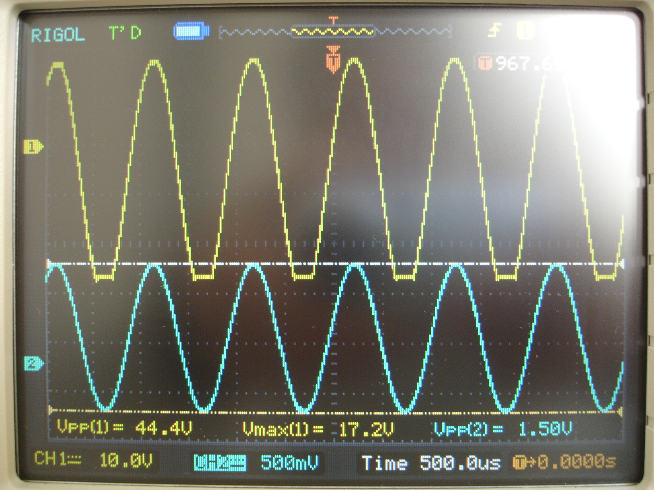

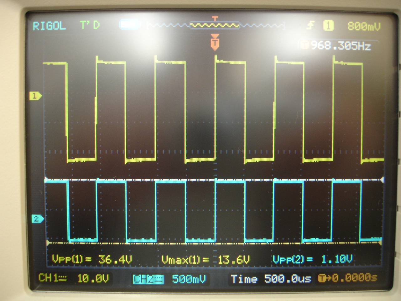

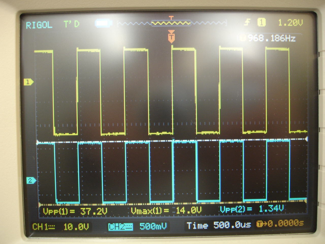

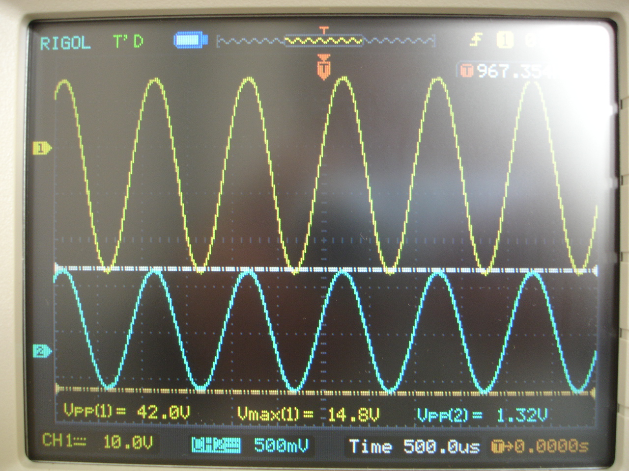

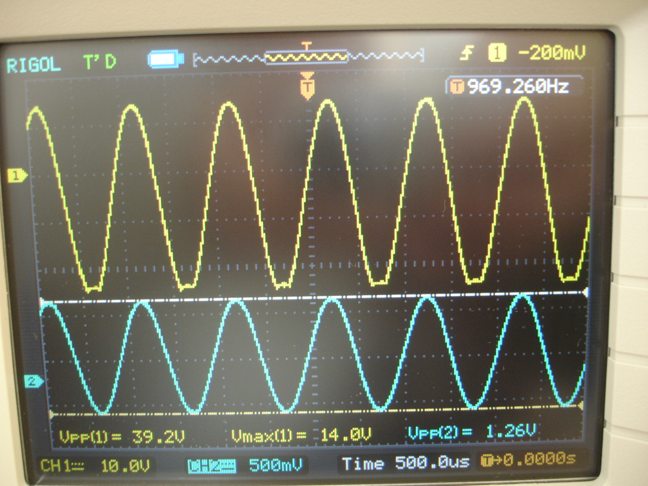

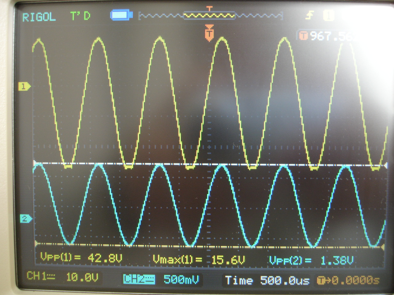

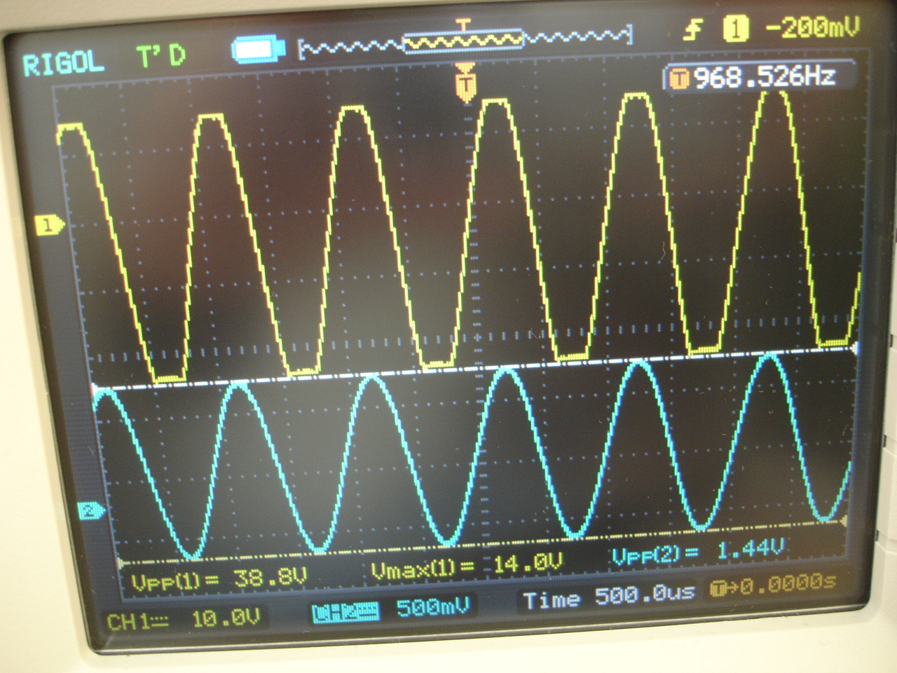

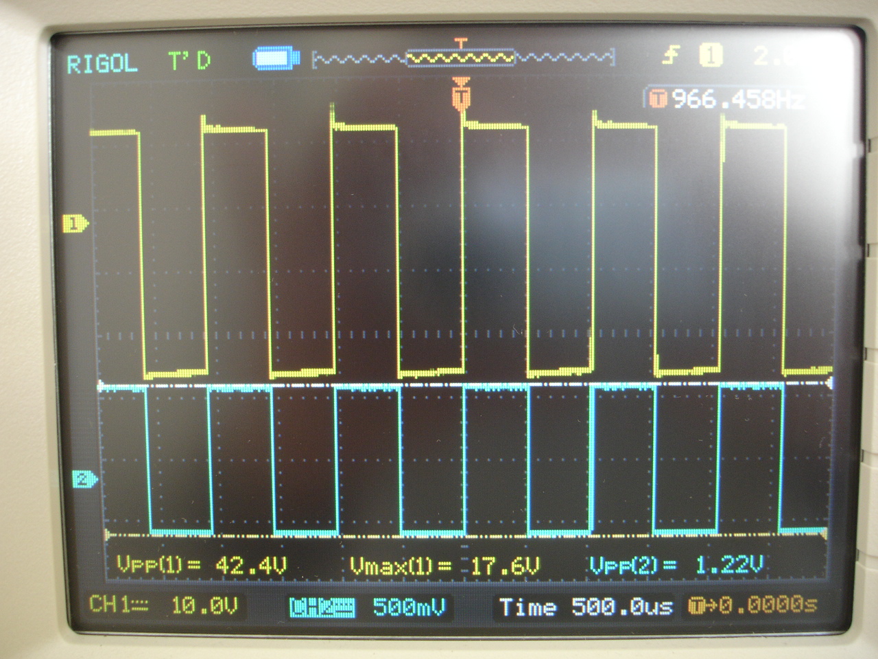

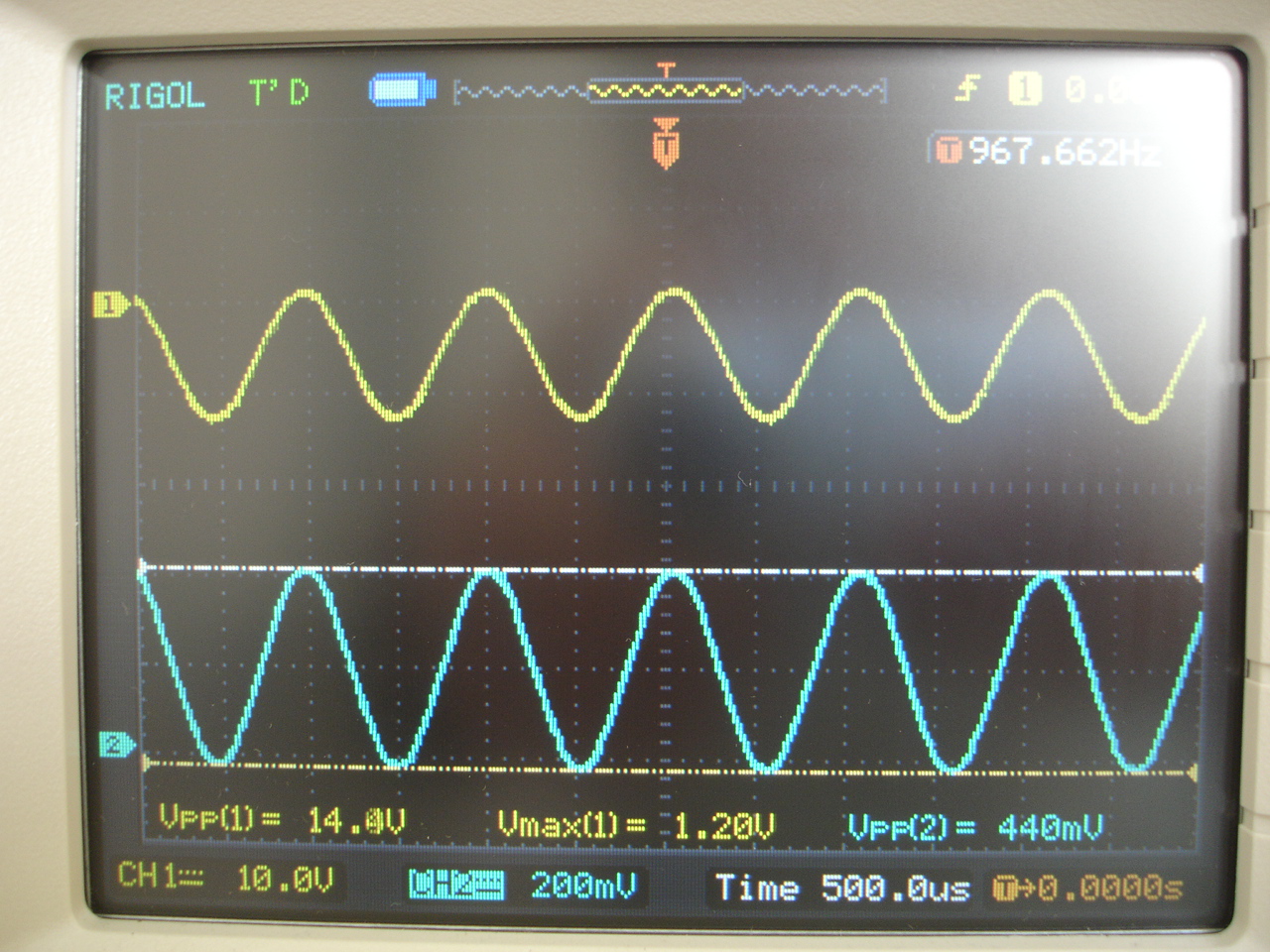

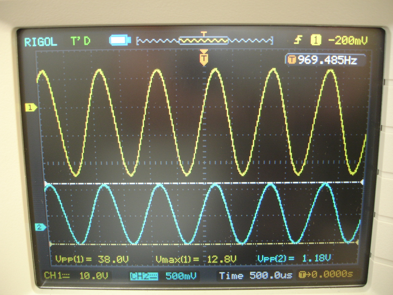

I have changed all BC556 transistors with BC560C original philips close matched.
this time offset is 12mV.
I have change out transistors with 2SC 3264 ,2SA1295
I have disable all other modifications .
+-/35v 45000uf / rail
idle current 25mA.
First group photos WITHOUT any load.
Second group photos WITH 8R dummy load.
Please see photos .....AND REMEMBER.THIS IS MINE BOARD NO DX SUPER A

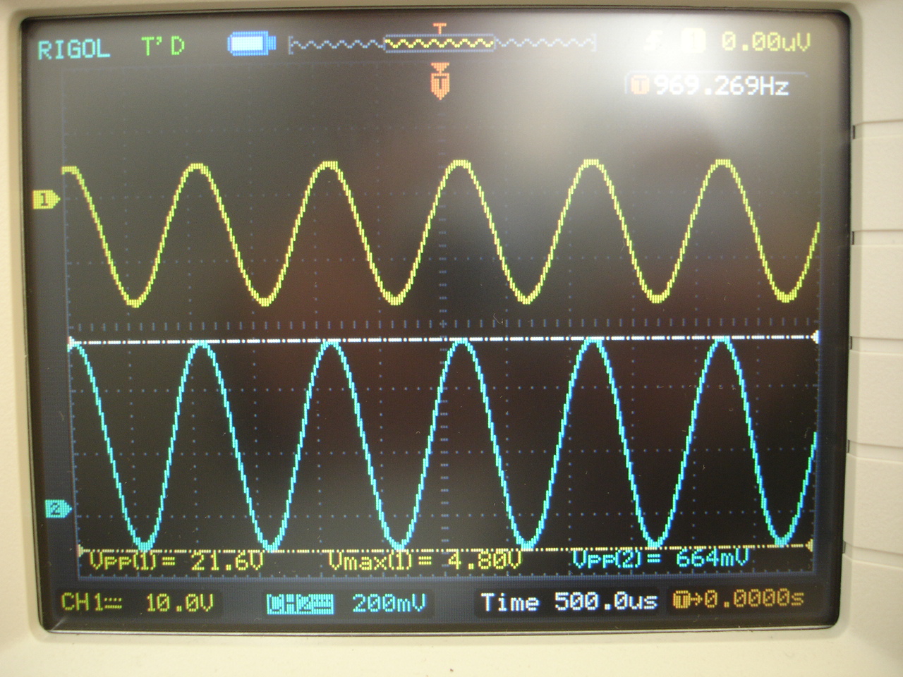

With this photos test WITHOUT LOAD.finished.

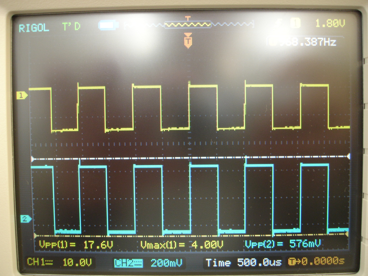

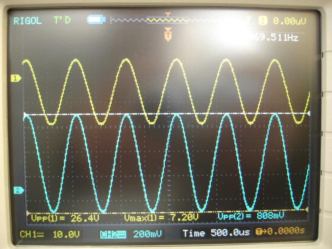

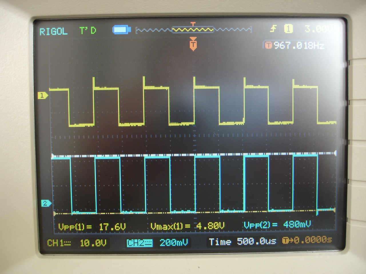

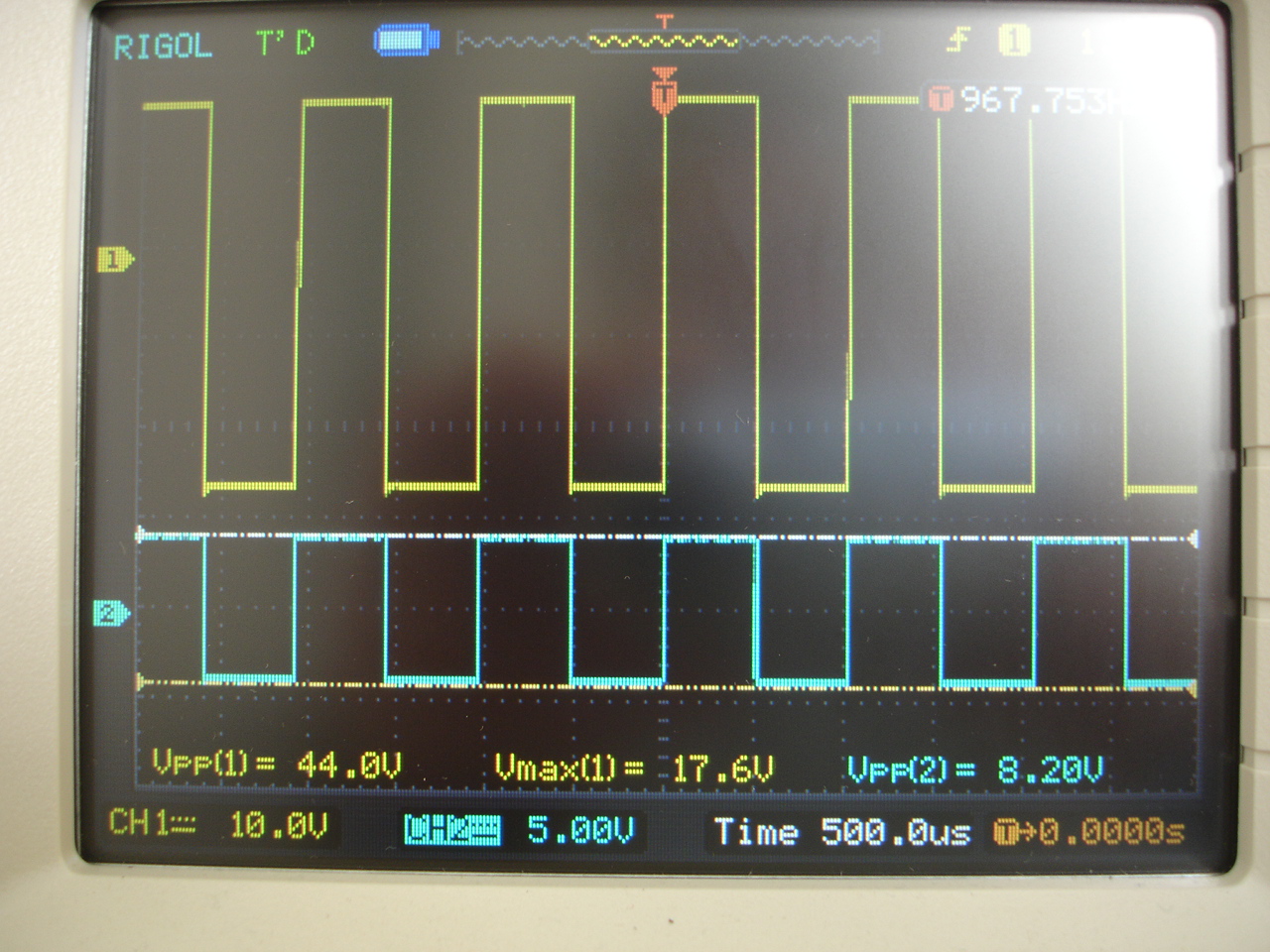

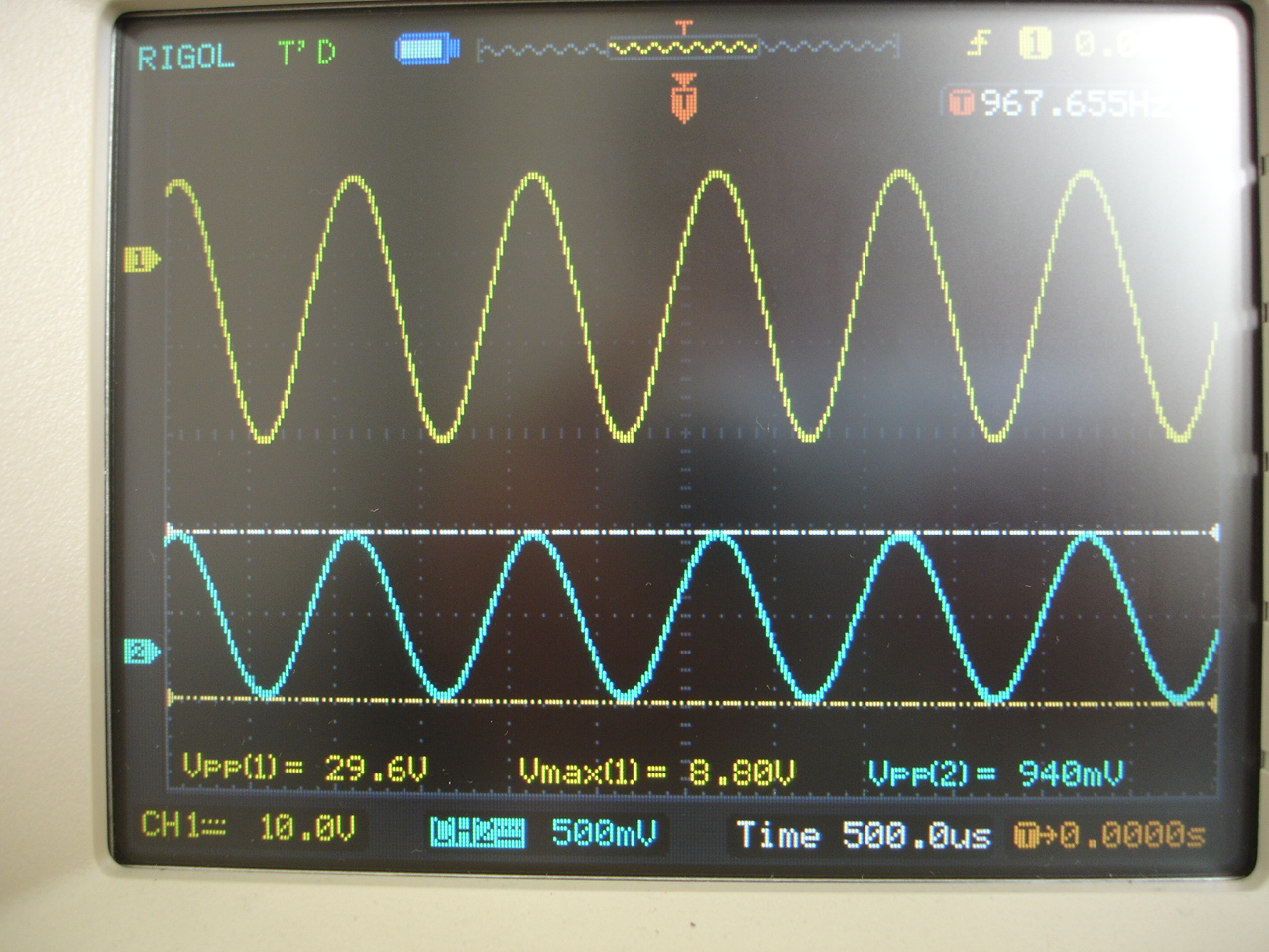

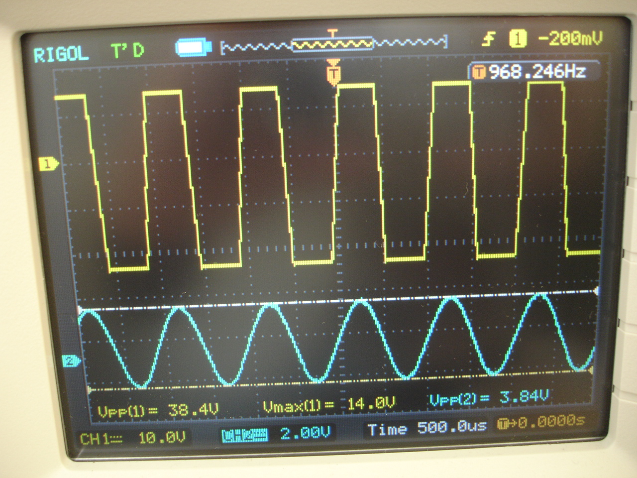

Now the test WITH 8R dummy load.

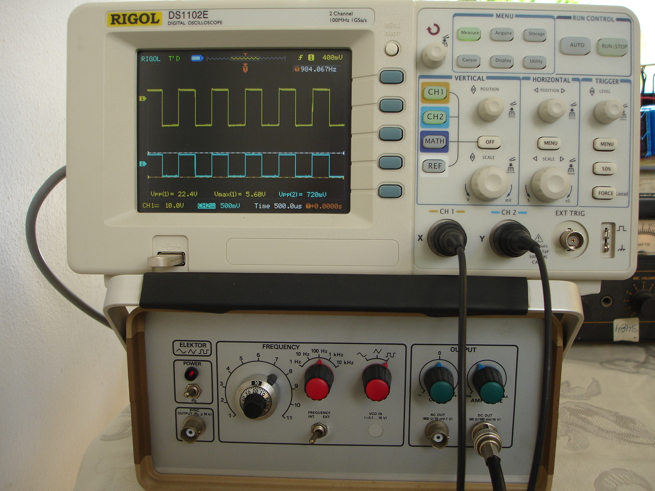

dx
and the rest.

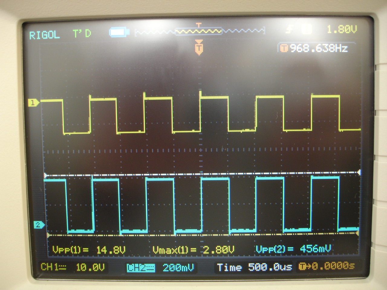

Last photo with 8R dummy and modificated L=4,7uH.
THIS IS A FULL FUNCTIONAL AMPLIFIER WITHOUT ANY ACOUSTIC PROBLEM
TESTED IN ACOUSTIC TEST FOR 3 HOURS CONTINUOUSLY.

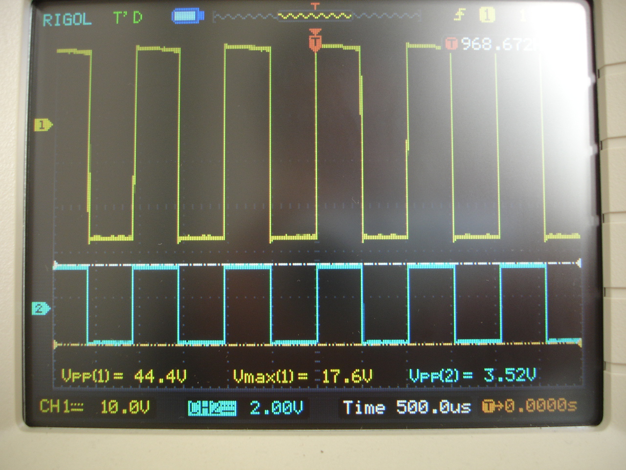

and the rest.

Ok, considering bv observations, try to remove capacitor that you decreased from 1u to 100n. It can cause saturation on transients, and uncle Charlie gives the note about it.
This capacitor you mentioned was not degreased by me.Ok, considering bv observations, try to remove capacitor that you decreased from 1u to 100n. It can cause saturation on transients, and uncle Charlie gives the note about it.
This value was printed on Juan pcb.
Do you mean that i should remove it completely?
Many times in my previous messages i have asked for final schematic but..........
Regards .
Thimios.
Regards .
Thimios.
Yes, just try without it.
