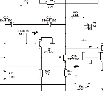

After some 4 years of pleasant use, both channels of my DX Blame ST sadly went off due to a overvoltage in the audio input. The "Q6" devil strikes again! (+V in the output, protection turned on).
Should I place only a resistor between power ground and Q6 collector? I am not in the mood of replacing all those parts for the 2015 updated version...
Yep...introduce the resistor into the colector
It will work fine this way.
You gonna be rid from "Q6 curse"
Another thing people do that is to install 2N5551 in place of BC transistor, but maybe you already have made that.
820 ohms or 1K will be fine

I replaced Q6 with the same part (BC546), and added a 680 ohms resistor to the collector pin. After the first attempt to have it fixed, nothing happened! Further inspection led to an open R22 (33 ohms). Maybe it faced a higher current, or even was a bad component.

Q7 saturated , causing Q6 to also conduct heavily. This blew your R22.
Adding the 680R at the Q6 collector will reduce the conduction a little.
Q6 at clip - no R = 200ma+
Q6 with 680R = 80ma .... still stressing the BC546 🙁 .
A diode from Q7 collector(cathode) to Q6 base (anode) = 3ma at full clipping !
A good diode with picoamp reverse leakage will "not be there" until it
clips. Q6 will never blow in 50 years.
All "blameless" type amps do this .... no way around it.
OS

(attached fragment of Ovation E-Amp circuit)

BAV21. You must make this decision and possibly research for a diode
with < pico amp leakage and a high reverse voltage.

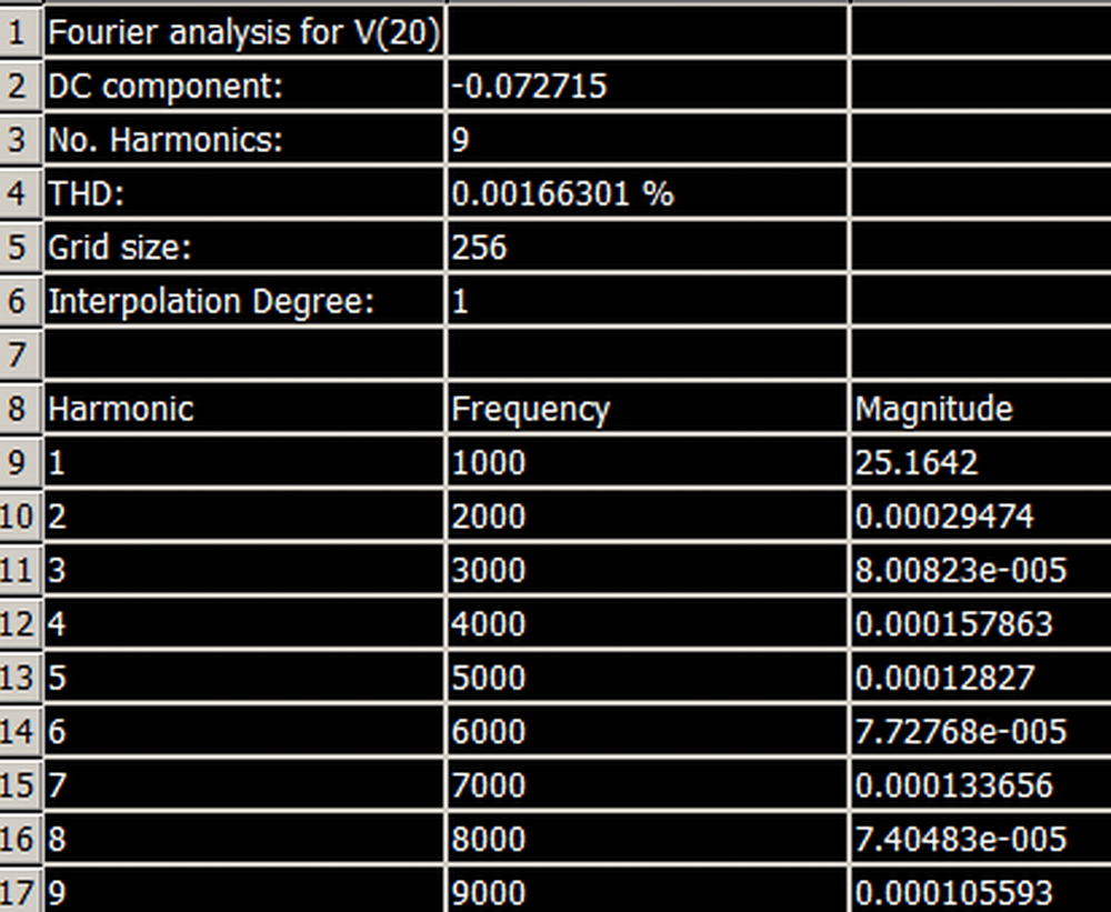

I have this song..was captured from a video... a nice guy from USA
That repairs automobile....i can send you this song....then you put it to play using your amplifier...you make digital camera recording and post.
I wanna see if can beat mine..... i am sure will not.... so.... that's the proposal i will make to everyone that try to "fix" my amplifiers...first beat it in performance..then i gonna listen your ideas to fix, to modify, to increase, to upgrade or to update...but not before..... just after you prove can match or beat.
Watch carefully the waveform...thick isnt?.... is that oscilation superimposed?.... wrong!...it is a high level secret... a resource to increase audio performance...it is not Class D, not modulated..it is Class AB, analogical amplifier.

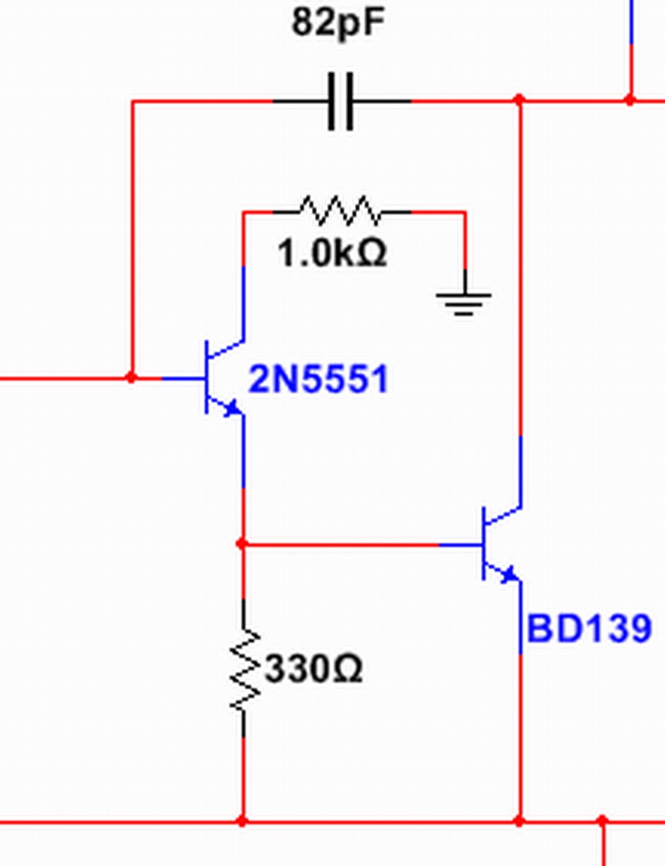

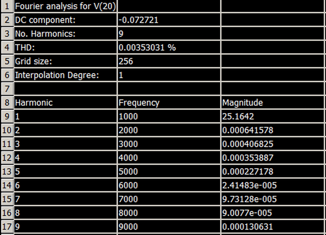

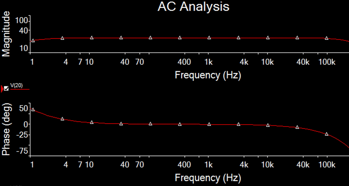

And this is nice..i have fun doing that.
This is the schematic i suggest, to Smart modification.
