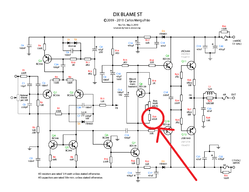

Tested all transistors. Everything is okay. Tryed to power on the amplifier, got a smoke on the BC546 Q6.
I'm completly lost on making this circuit works 🙁

Did you check Q10? That one could be shorted.

put a 1K resistor between collector and power ground of Q6 it will be protected for overload

I had the same prob with my Blame ST Q6 blew up placed the resistor never had problems again.That resistor doen't harm anything not even the sound but you've a protection instead
I got it HA HA!

The problem in the amplifier was 2 solder joints. It's things that is normal to happen when you make yourself pcb boards and drill them with a sewing needle from your grandma HAHAHAH. (In Brazil things are hard to get almost impossible to find a 1mm drill. Will try to buy it on internet to next time because I will build more 3 amplifiers to my 2.1)
And... I was getting 9v throught the resistor. Adjusted bias and tchram! Everything ok. Didn't tried yet to put sound on it because my bias voltage is increasing by the time, around 0.01v/10s. Is this normal or just heating up?

And... I forgot! While I was testing the transistors I got Q7 placed incorrectly 180º, so it was the thing that was making the burn of Q6.

Hi. I'm building a dx blame st amp and I've got a question.
I finished PSU for amplifier today. I measured DC voltage and it's 2x 31.2V. Is it enough to power it? I think it should work but I'm asking to be sure 😉.

Yes, it is enough
You may need to decrease the resistor that is in series with the bias trimpot to allow you to reach the correct adjustment....maybe...not sure about it... gonna depend on your transistors.

the ratio R19:R20 gives the "multiplier"
2k/470 +1 = 5.255 The output of the Vbe multiplier will be 5.255*Vbe
The minimum Vbias will be when the transistor has a low value of 570mVbe and thus the Vbias could be as low as 2.996V
That is shared between the 4 output devices and the two emitter resistors.
Allow 56mV (28mVre each) leaves 2.94V for the 4 Vbe. i.e ~735mVbe each.
You do not need to turn on the output devices to anywhere near 735mVbe
You do not need to change the 470r resistor in the lower leg of the multiplier.
You can also check that the minimum setting of the Vbe multiplier allows the output devices to be turned off using the same method.
The min Vbias is 2k/[470+500]+1 = 3.06 *Vbe But this time one must assume a Vbe at maximum tolerance, try using 650mVbe
The minimum Vbias is 3.06*650 = 1.99V
For the output devices to be OFF the Vbe must be zero.
This time the Two Driver Vbe must be approximately = or more than the min Vbias.
the driver bias will be ~ 550mVbe for the outputs to be off.
The min Vbias should be < 2*550 < 1.1V
But min Vbias is 1.99V.
You cannot turn the output bias OFF.
The VR selected @ 500r is too small. Use a 1k VR, or accept that at first switch on the output could be biased ON.
This is a decision you must make ! either change the VR or accept the output could be biased ON.

Just decrease if if you really need.
Increase it or decrease that resistor depending your needs.
First try with the original values that may fit.

I'll first try original values and if it not fit I will decrease r20. Thanks for help.

For now I'm happy to say that original values fits perfect😀! I adjusted it with this side Greg's Web Site to 5.17v. So it fits in norm. Strangely I have almost no off set? It ranges from 0,03 to 0,08mv?Be happy....this amplifier is great!...i am sure you gonna dance so happy you gonna be.
