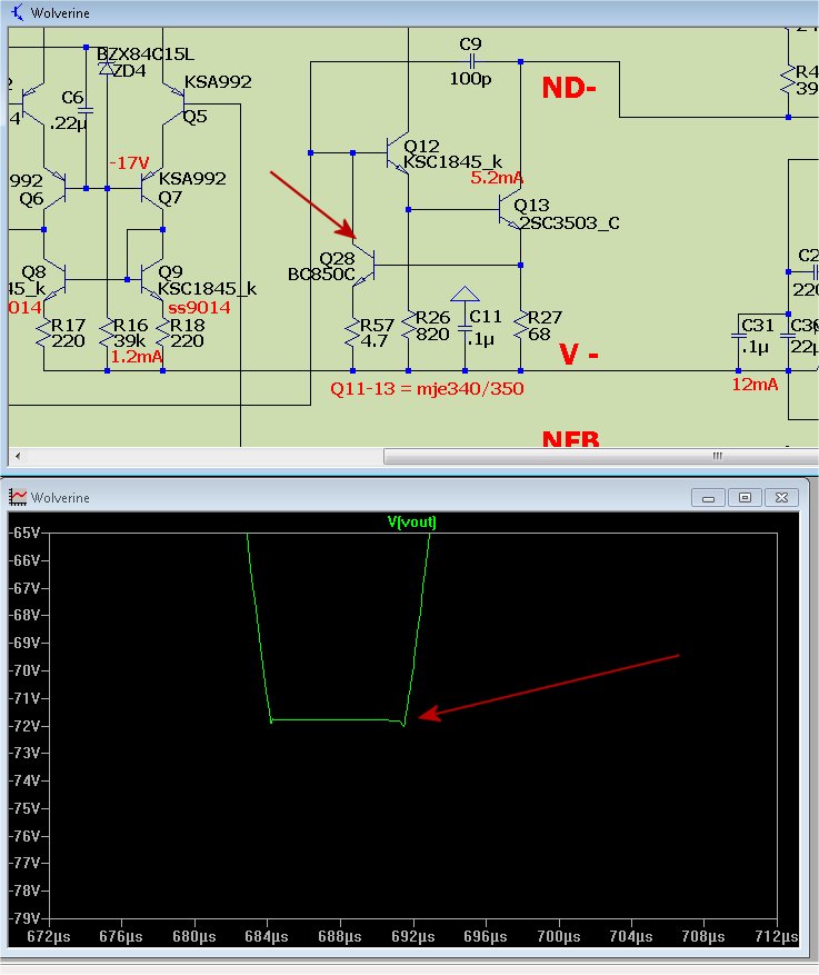

And this is nice..i have fun doing that.

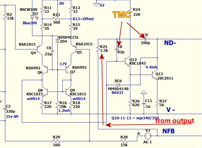

This is the schematic i suggest, to Smart modification.
regards,
Carlos
The 1K resistor ?
OS
It seems the 1K is there.
I do think so.
Maybe not....i am becoming very old...sometimes i miss something.
It is there to be in the safe side... in almost all modern DIY amplifiers....the new ones, not published are using a very different approach.
My own amplifier, home units, do not use the 1K in the VAS, i have used another trick...but it is not safe, my own stuff my own decisions.....DIY is another story, i have to produce safe units...even if this produces some small losses in sonics.
regards,
Carlos

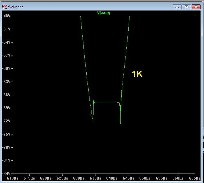

- Not too good (1K - below 1) , you might not burn the transistor ... but
your tweeters will hate you. 😀
Amp will actually become slighty unstable for the tiny time that the transistor
saturates (overloads).

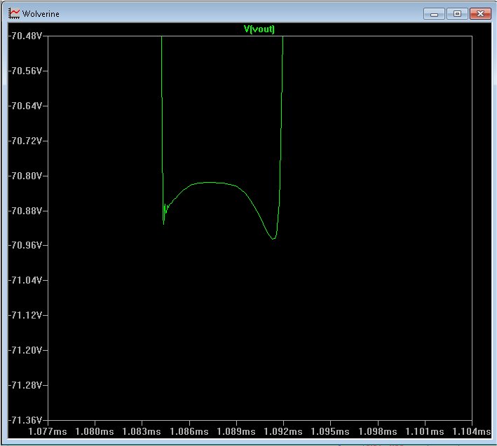

-better (and cheap - below 2) the reverse diode across the 100p capacitor.
Makes the problem MUCH better , but it is not perfect. If you do not
overload ... the diode will seem like it is not there (with a good diode).
This is on a lot of amps - tested at .0005% distortion.
- Self shows a transistor clamp ( a third transistor - below 3)
This works so well I use it on my biggest "blame" sub amp , approved
by Self - can't go wrong. My blame ... you can use the diode or the "clamp".
All this has been seen on real hard working BIG amps - really works !

Thank you, you suggestion was posted
Then people can decide if they want to use it or not.
I have tried this approach, a long time ago, in the Dx Precision 1...if i remember i told people to deactivate that transistor.
Here you have the Precision 1 amplifier.....this one was made a long time ago and i do think you have not watched...maybe you were a teenager on those old days.... i have said to people the circuit was safe, but sound was better without that transistor you mentioned...this is in Self Book since those old days.
regards,
Carlos

Until that transistor is turned on by a VAS overload , only it's leakage would
affect the amps "sound" or performance.
A real good BCxxx device would "not be there" until you overloaded.
Same as a real good diode (low leakage). Until they turn on , a good
one sits alone - does nothing.
Hot humid jungle air would have more effect on amp sound. Or "dirty power"
out of the wall.
Maybe 1 or 2 parts per million .... but only aliens could hear that. 😀

But two go beyond D. Self's teachings. "Bigger fish" figured out how to even
better Self. He himself was amazed by Edmond Stuarts "TMC" compensation.
Badger and wolverine have this "magic" (below).
Two caps , one from the output through a resistor (1.5K) , one a normal miller(from VAS).
390p + 82p is like a single 68p miller in series.
But , feedback from the output lowers the 10k -20K THD to 1/3.
Does a little "Super A" , as well ... crossover glitch is also fed back to VAS - cancels out bad harmonics.
A normal blame is really 10-15ppm (.0015%) , a TMC blame is 3-5ppm -.0003%
at 20K full power.
It works very well , Carlos - tested in the real world.
OS

Already tried Ostripper
Also from the VAS colector to Q5 base....i imagine i have tried almost all possibilities, as this is what i love to do.
Thank you anyway...very kind from you to try to help.
I already have circuits that goes down to 0.0002% THD in the simulator...we know that in real life things are a little bit different............
I have tried a lot of compensation ideas, from all books i have and from all possibilities we can imagine...i have used inductors, ferrite beads, series resistor, several small capacitors from VAS to almost all circuit points.....all that simulated and tried real life inspecting in the waveform monitor.
A variation from Hugh Dean style was the one worked the best and this is what i am using now...but this is top secret...sorry, this is not to share in public forum otherwise we gonna see in Ebay and Chinese manufacturers willl apply our ideas...totally for free and laughing about us, and some of them use to say:
- "If you face troubles, then search Carlos or Ostripper in the diyaudio forum"
So, despite i feel your good intentions, sensed here clearly, i will not feed such conversation..sorry Ostripper.
Pirates can read all books we have...they also can test in try and error basis...they can check in the scope display and they can listen...also to judge blind to A to B comparison...they can call people to help them to listen and evaluate....let them make the whole job instead to be stealing ideas from us... we have already pointed to them the best possible ideas and the best wide world ever made audio amplifier (Blameless concept)...this is enough.
This forum, the best we have in the planet, despite wonderful to cooperate to our comunitty, is also a DISPLAY, alike a shop, for them to copy our work, without say thanks or at least to send us one sample for us to check if they are doing it fine or messing with all our work with bad pcboard design, wrong placement of parts or mistaken selection of components.

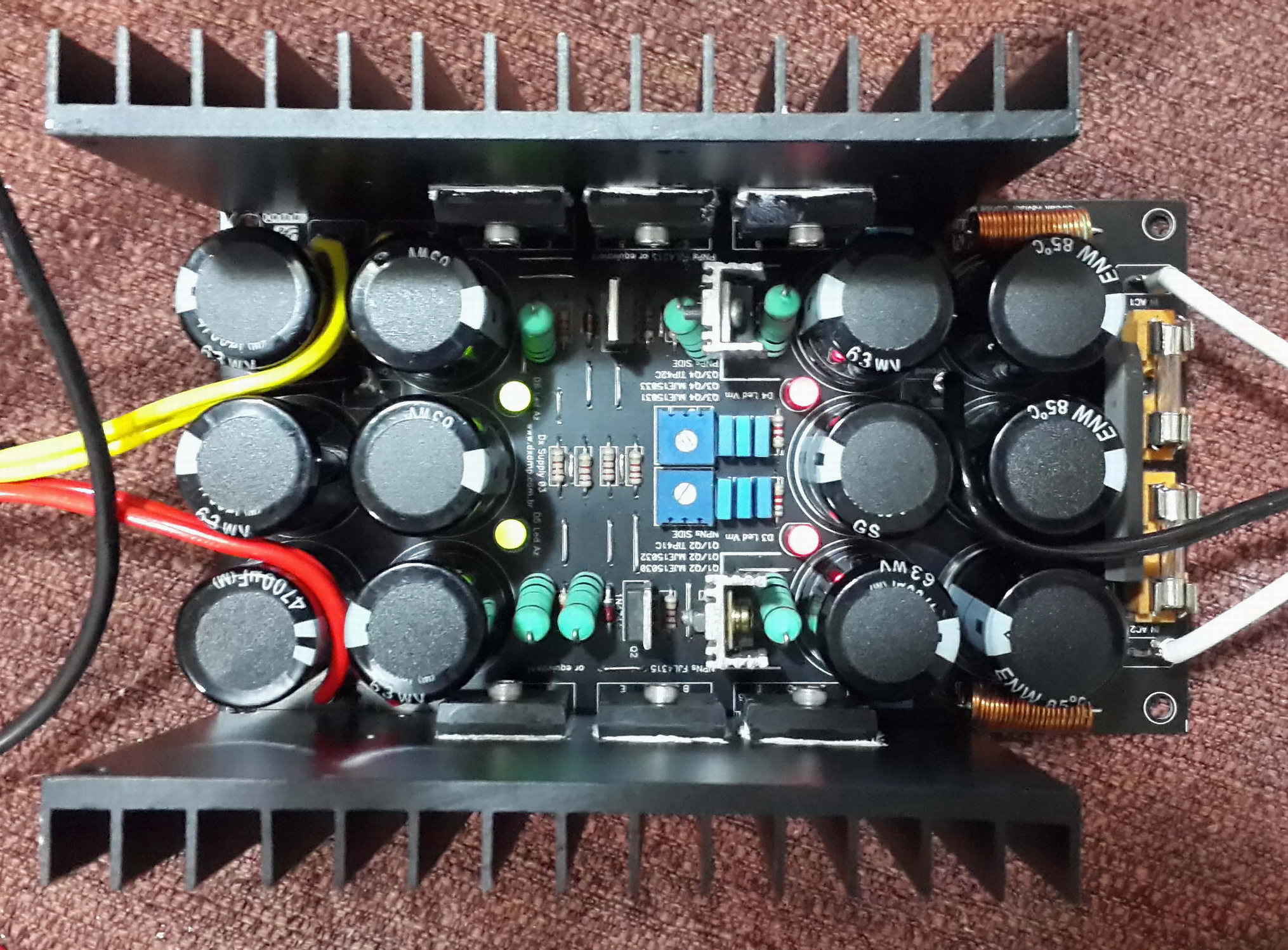

Help assemble Dx Super A e Supply DX
Hello
Carlos Mergulhao
William Domingues am here in Brazil.
I would like to help.
I assembled a board Dx Super A and DX Source and I'm having the following problems,
In DX source I not regular comsigo the positive intention in Trimpot, the voltage at the output of trimpot to regulate but not low on the positive side.
* In the source I am using Tip 36 / 35c and 41/42 Tip.
On board Super A, I can not regulate Off Set, raise the fuses and the upside of 42.5 mv and mv Another of 0:00 and also this rather heating transistors 2sc5200 and 2sa1943.
Another thing the audio output can go out type 26 volts?
because when I turn on the amplifier but the sound comes from one voltage drop at the source, the very warm 5200 and when I messo the output is giving 26volts.
Help me if you can.
thankful

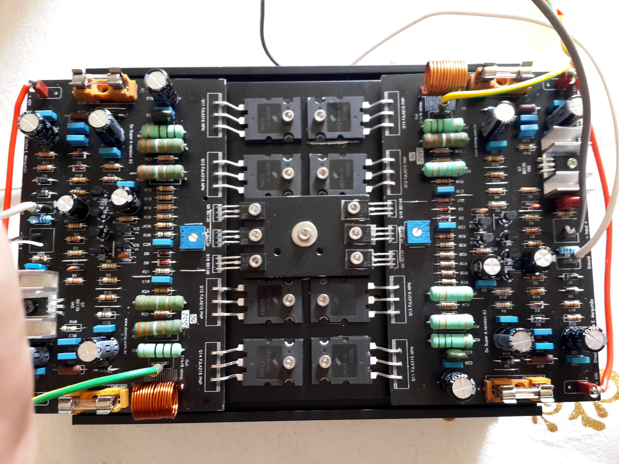

Dear Carlos,
My DX Blame ST is running for weeks now and it is totally stable even with a crappy small linear PS 🙂
Great sounding amp, very relaxed, detailed and extended.
A couple of small questions, for future builts, if you please:
1) "Boot-strap" cap is 47uF/100V. Can we use two (2) back-to-back, good quality 100uF/50V caps, to make a non-polar 50uF/100V capacitor?
2) Initially, I used 38mA as bias, then increased to 48mA...honestly, I did not detecte changes. What is the designer's recommendation about bias?
I hope you, or others, remember. 😀
