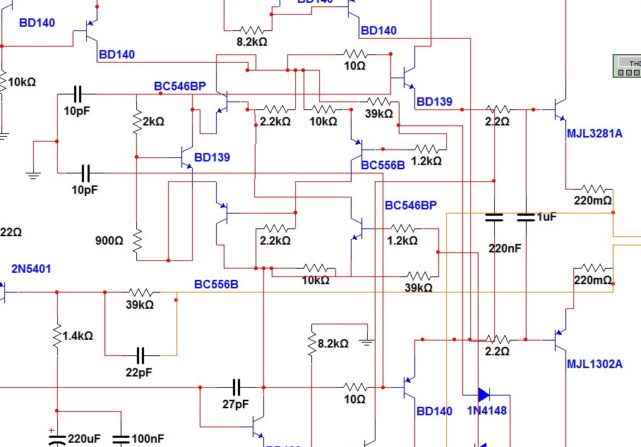

Here is a sample of the circuit, this one was made two year ago
to the Dx Evolution amplifier, a working prototype that i have not used because of my supply (was weak).
The circuit must be organized and cleaned.... and then i will adapt it to use together the Dx Blame ST.
This one operated fine, but some hum was heard in low volumes (750 mA each rail of stand by current) because of my supply...then i decided to make another amplifier instead of this evolution...it would need special supply....not the one i had...too much weak and simple the one i had.
A big mess the layout.....but it is operating.....750 mA each rail in stand by mode and 2.5 amperes at full power over 4 ohms loads.... adjusting properly it will be even better.
So, aproximatelly 50 watts is the iddle consumption and low power operation till the amplifier switches to class AB at higher power levels.... this 50 watts will provide you some good Class A watts till you crank the volume up.... i do imagine this is too much....better to reduce to 400 mA or something around it.

Super A for the Dx Blame St is the idea to be developed
Here you have the basic schematic explained:
