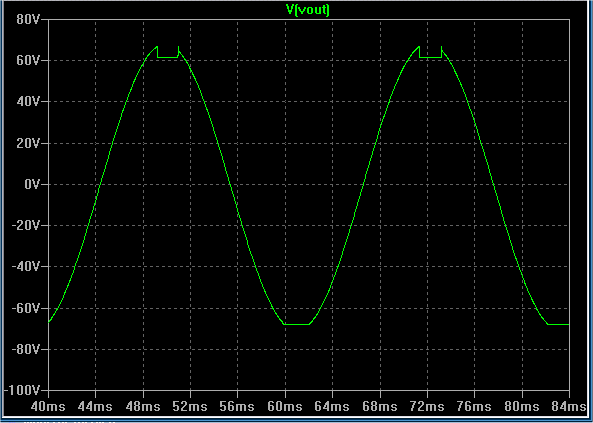

Here is a couple of oscillascope readings of my Blame ST at near clipping and also at clipping. Using 100w 7.5ohm resistor as a load. It had 21.7v ac rms just before clipping so therefore 63w at 7.5ohm load.
Regards
Niss_man
This amp has a gain of 26. So 21.7/26= 0.83v ac input. Supply rails are +/- 36V dc.
You can see the input as the blue colour. Supply rails as green and red (with little bit of ripple from max power usage) and output as yellow line. Supply and output at 10v per division and input at 2v per division. All the information is there.

Nice O-scope 😱 I can't clip mine , no load big enough or speaker big enough to handle it ... But your waveform shows the EXACT reverse of my simulated "ES like" amp (below 1 - 70V rails). This is expected as mine is reversed (bootstrap negative). This shows the simulator reproduces the saturation errata perfectly.
With my 75V rails, my CD/soundcard can not clip the amp even with a 38DB gain , I guess your picture is the only time I will ever see it.

I thank you for those , I really can not get to clip. I would not want to at that power level. Me and MJL21193 just limit total gain where any source input will not drive the amp to clipping (2v rms in = 77v rms out- way too much!!) I trim the input so my woofer won't "bottom out".
I was just curious to see if anything did blow at clipping , you did it and survived. 😎 BTW , carlo's amps are the champs with both the sound and for the number people. BX is my favorite sound- wise (ES/st based - below)

I used 2 x 15 ohm resistors rated at 50w. So 7.5ohm 100w resistor. Signal generator used for input. Total output of the amp was 62w. Nothing blew. output resistors got really hot though😀. May need a bigger test resistor heat sink rather than some scrap aluminium.

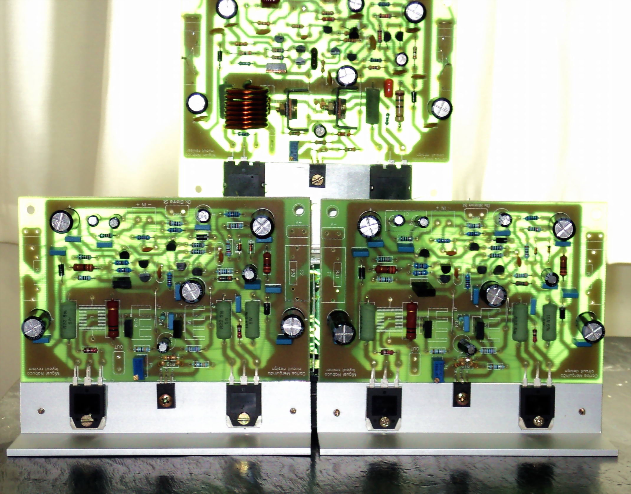

I've finished to build my 2 DX Blame, ST and ES. They work perfectly and the quality of the sound they produce is beyond all hope. I'm admiring: your amp is a masterpiece, Carlos. Many thanks to you, to Metal for his clever design and to Rudi for his enthousiasm and devotion to help and advise.
