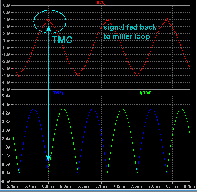

(Below 2) shows the correction signal which is fed back to the miller loop , it correlates to the crossover point. The remaining high order distortion (produced by the outputs) is also gone in an FFT.

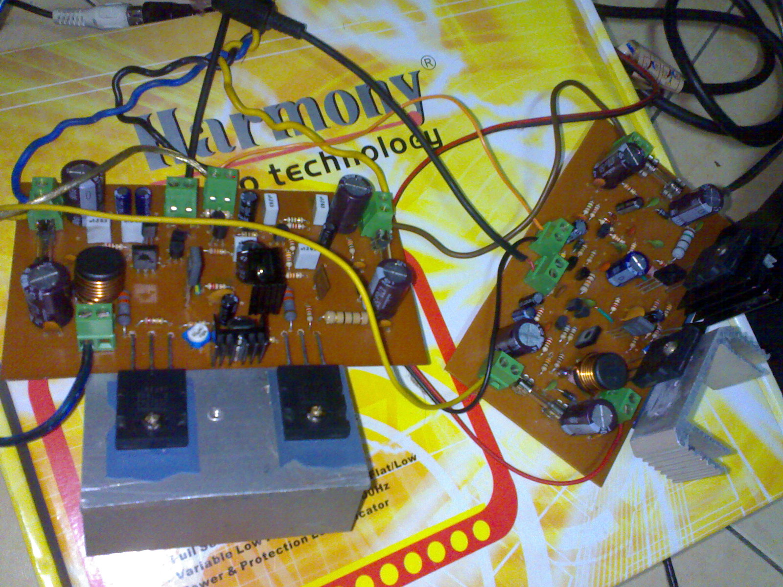

hello.i built dx blame st 1.5.my problem is when start up without play song it become very hot.if play the song more heat produce.i follow and use all recommended component in this thread.why this happen and solution to me?
Have you adjusted bias correctly? Removing rail fuses, maintaining series 100 ohm resistors, you should read something around 4.7VDC through their leads. Start with a high value for the trimmer (> 300 ohms), then lower it while adjusting.
you are right.when i remove the fuse , heatsink is cool while playing song.but when i increase volume sound bass more broken.this fuse using or not?or remove while setting bias?when multimeter parellal with resistor at fuse i get more than 6 volt.how to set bias?Have you adjusted bias correctly? Removing rail fuses, maintaining series 100 ohm resistors, you should read something around 4.7VDC through their leads. Start with a high value for the trimmer (> 300 ohms), then lower it while adjusting.
You shouldn't play music with the fuses removed! What smartx21 means is have no music playing. No inputs. Just measure across the 100ohm resistor (across fuse terminals). The basic setting is 4.7v. This means a standby current of 47mA. Still if you have 6v accross the fuse (without input) 60mA is still acceptable. You probably have issues elsewhere. Photos?

thanks smartx21.i get the solution.my trimmer install problem.now i can setting bias.sound good.bass smooth.i like it.heatsink cool.but why must 4.7 volt?this value depend on power supply voltage or speaker load or this standard value could i just follow?You shouldn't play music with the fuses removed! What smartx21 means is have no music playing. No inputs. Just measure across the 100ohm resistor (across fuse terminals). The basic setting is 4.7v. This means a standby current of 47mA. Still if you have 6v accross the fuse (without input) 60mA is still acceptable. You probably have issues elsewhere. Photos?

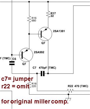

Blame ST + TMC
TMC elements I used are: )look at schematic OS presented in #1119)
C13=150p, C12=470p and R19=220R

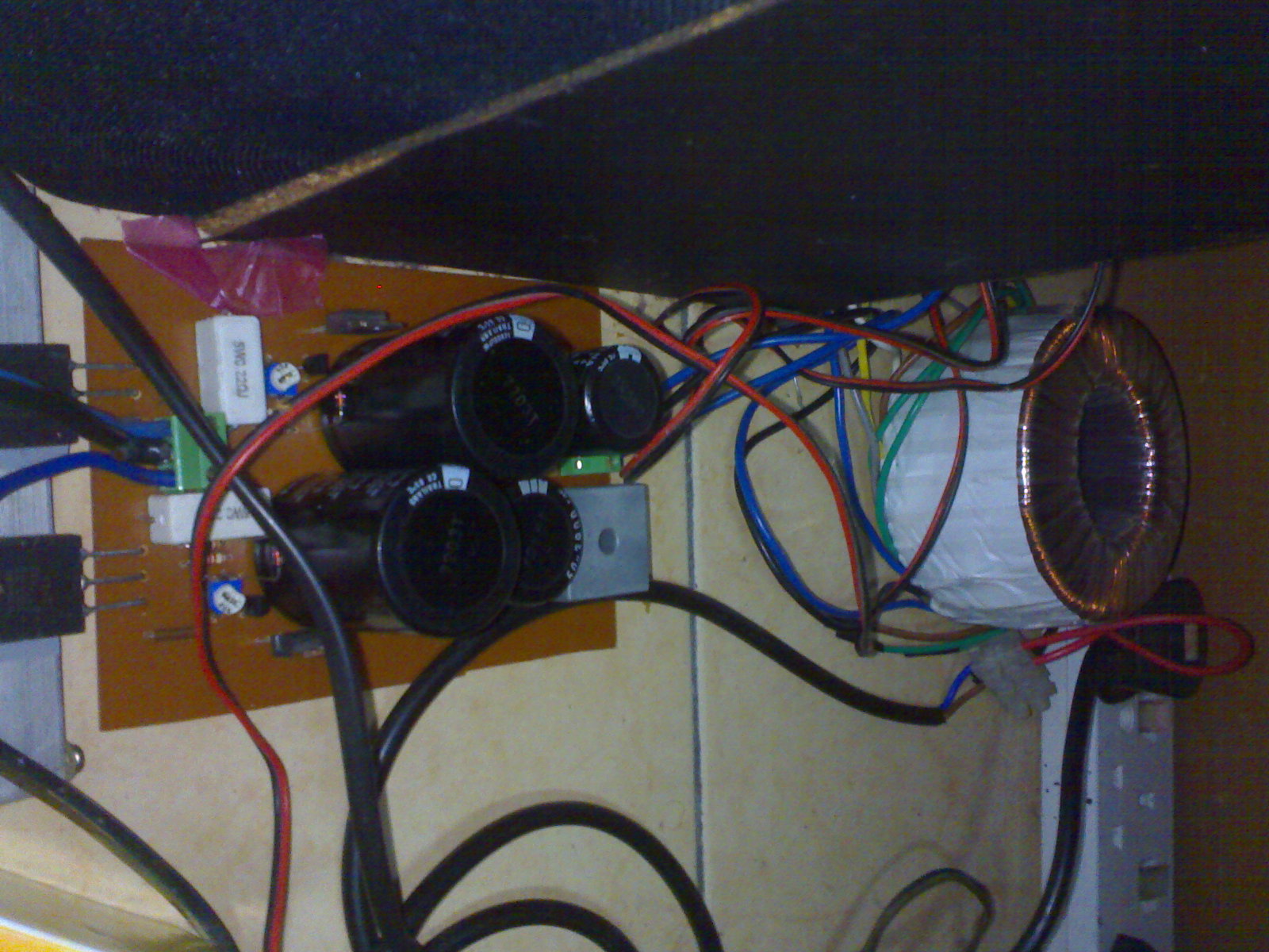

this my picture.stereo dx blame st amp and voltage regulator by apex design.You shouldn't play music with the fuses removed! What smartx21 means is have no music playing. No inputs. Just measure across the 100ohm resistor (across fuse terminals). The basic setting is 4.7v. This means a standby current of 47mA. Still if you have 6v accross the fuse (without input) 60mA is still acceptable. You probably have issues elsewhere. Photos?

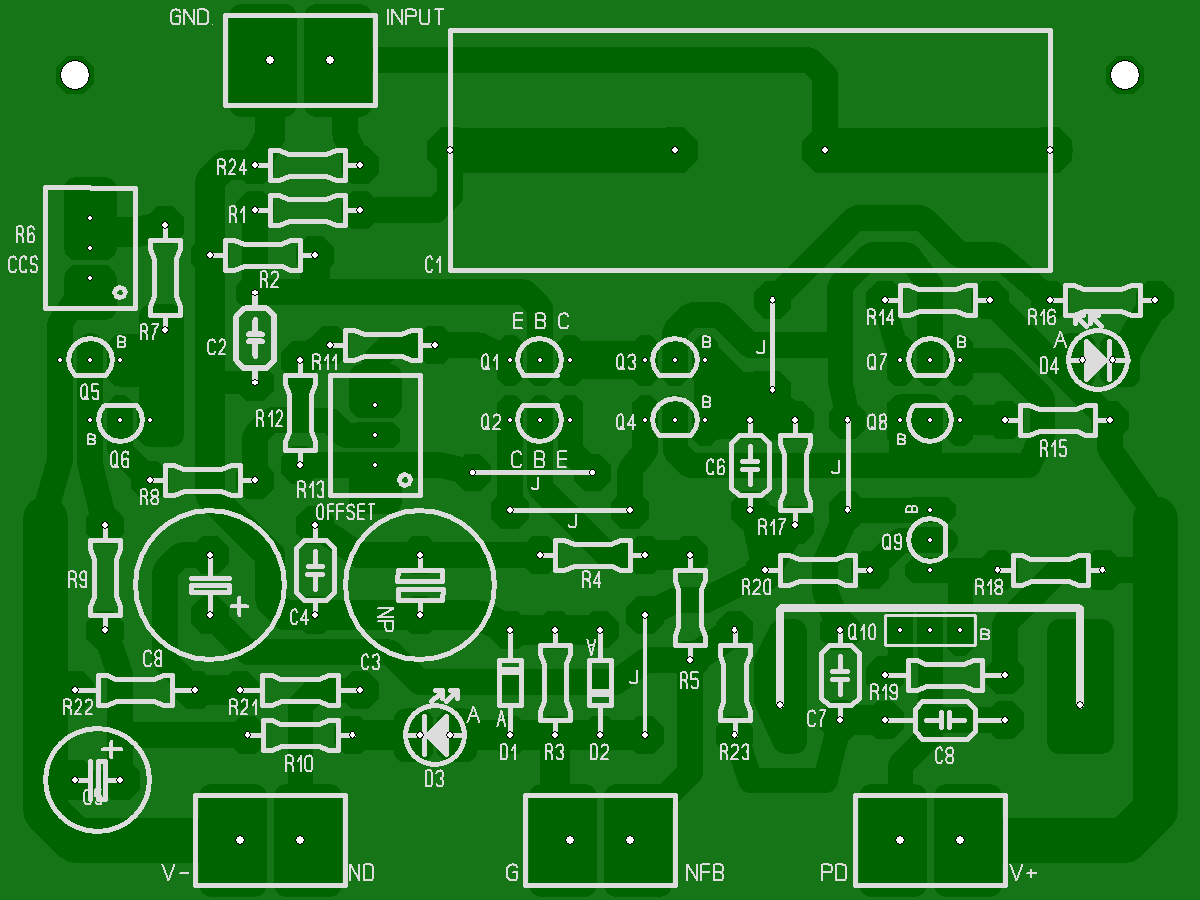

i interested with this amp.can anybody give way to add 3 pair or 4 pair of 2sc5200 to get more power output.
what different between this circuit with from ?Soon we gonna have all stuff at Greg Erskine home pages too.
Greg's Web Site
down this page, attached the schematic and layout...much more to come!

I finished Blame-ST but with the touch. After reading about TMC by Edmond Stuart I could not but try it. "http://www.diyaudio.com/forums/solid-state/94676-bob-cordell-interview-negative-feedback-304.html"
Good start was Blame ST and here it is, Blame-ST-TMC.
Voltage is +-40V a bit more and the feedback resistance a 22k/820 same ratio but higher input resistance. PCB hand made.
The loudspeakers are hand made Seas woofer and mid/high ribon by Newform Research.
I like the sound of the combination very much.
Here is schematic and LTSpice simulation.

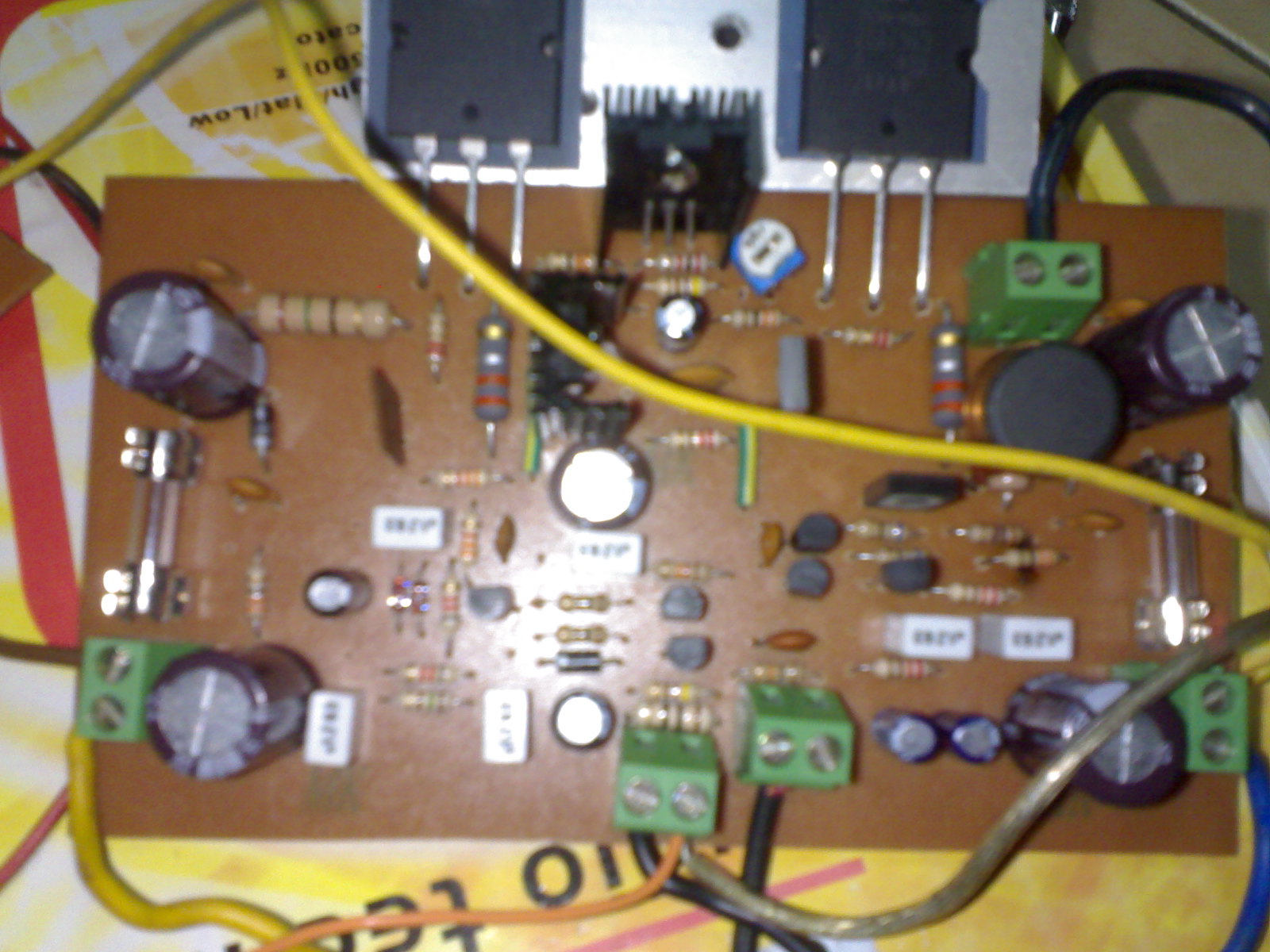

q8 must be in fixed in the main heatsink
