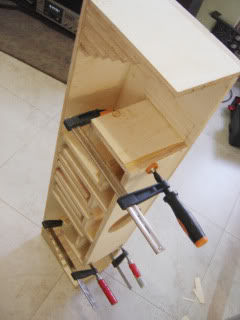

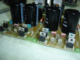

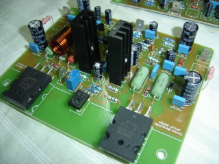

More Dx Blame ST builders
Here is another one.
Some pictures attached and a video too:
YouTube - back loaded horn
In this video he is not using the Blames....they are under construction..he is showing his speaker only....soon you gonna have Blame playing and then you will be able to compare... if recorded using same camera and same music it will be possible to compare.
regards,
Carlos

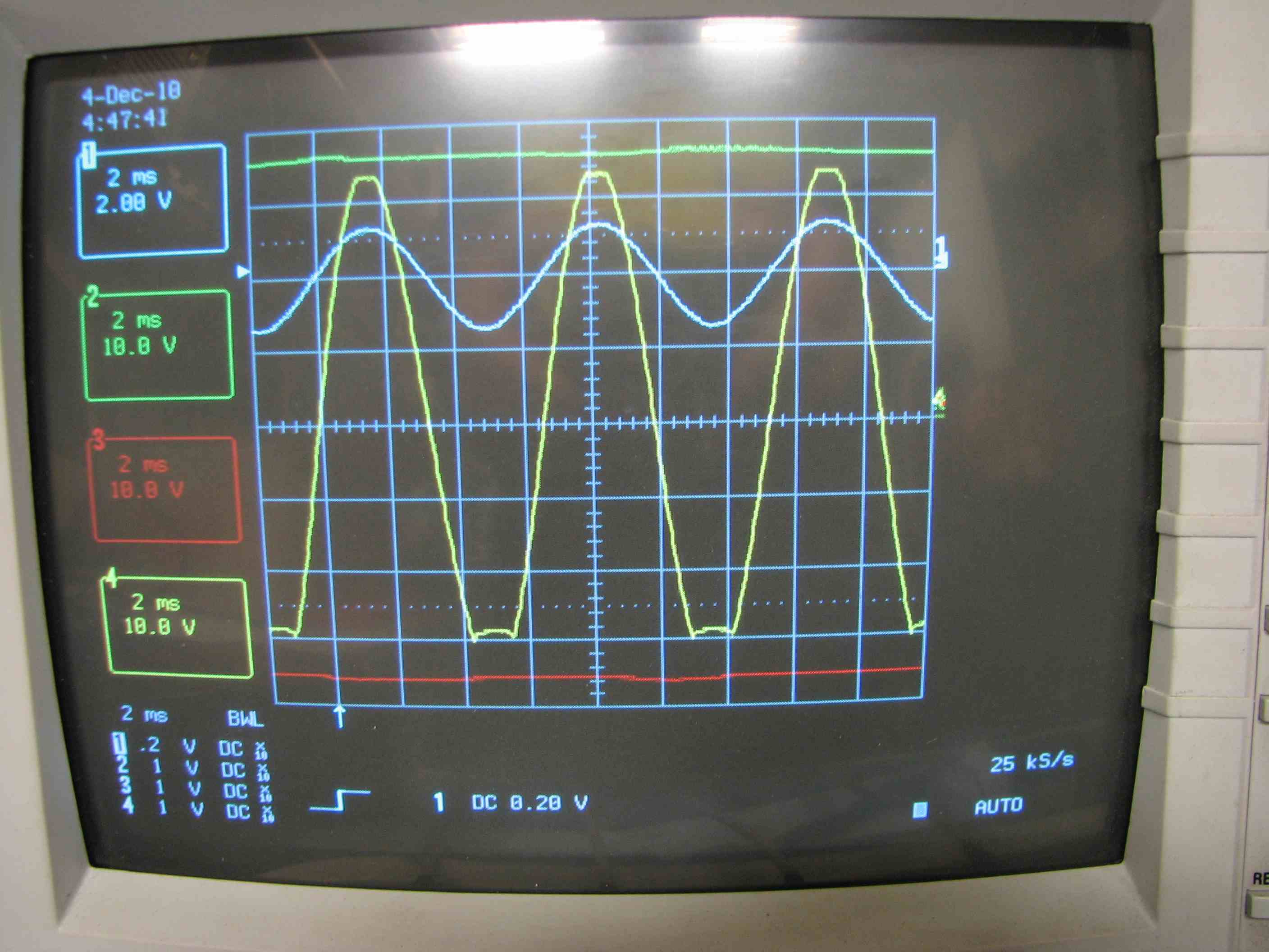

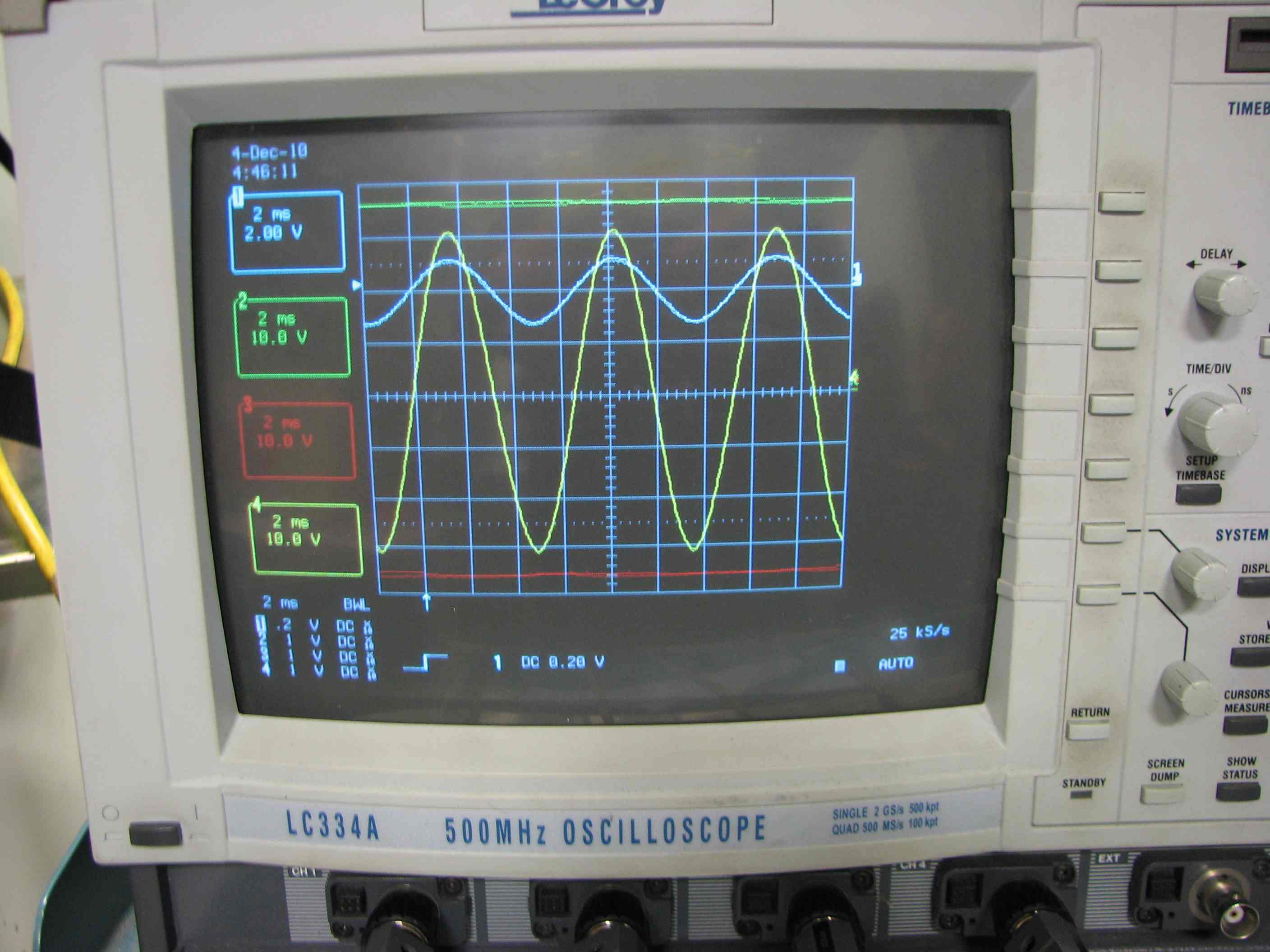

Here is a couple of oscillascope readings of my Blame ST at near clipping and also at clipping. Using 100w 7.5ohm resistor as a load. It had 21.7v ac rms just before clipping so therefore 63w at 7.5ohm load.
Regards
Niss_man

Thank you dear Niss-man...nice scope images
Adjusting rail resistances you can have a more symetrical clipping, but, as you know, some assymetrical clipping produces and interesting effect that some folks appreciates.
