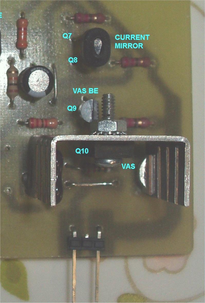

Heat scares me....when it i around 38...even 40 is acceptable
But when increases to 44 i few myself in panic.....well....this is me...i know that others do not mind about that....well, will try a tiny heatsink to this MJE15030 (second VAS):

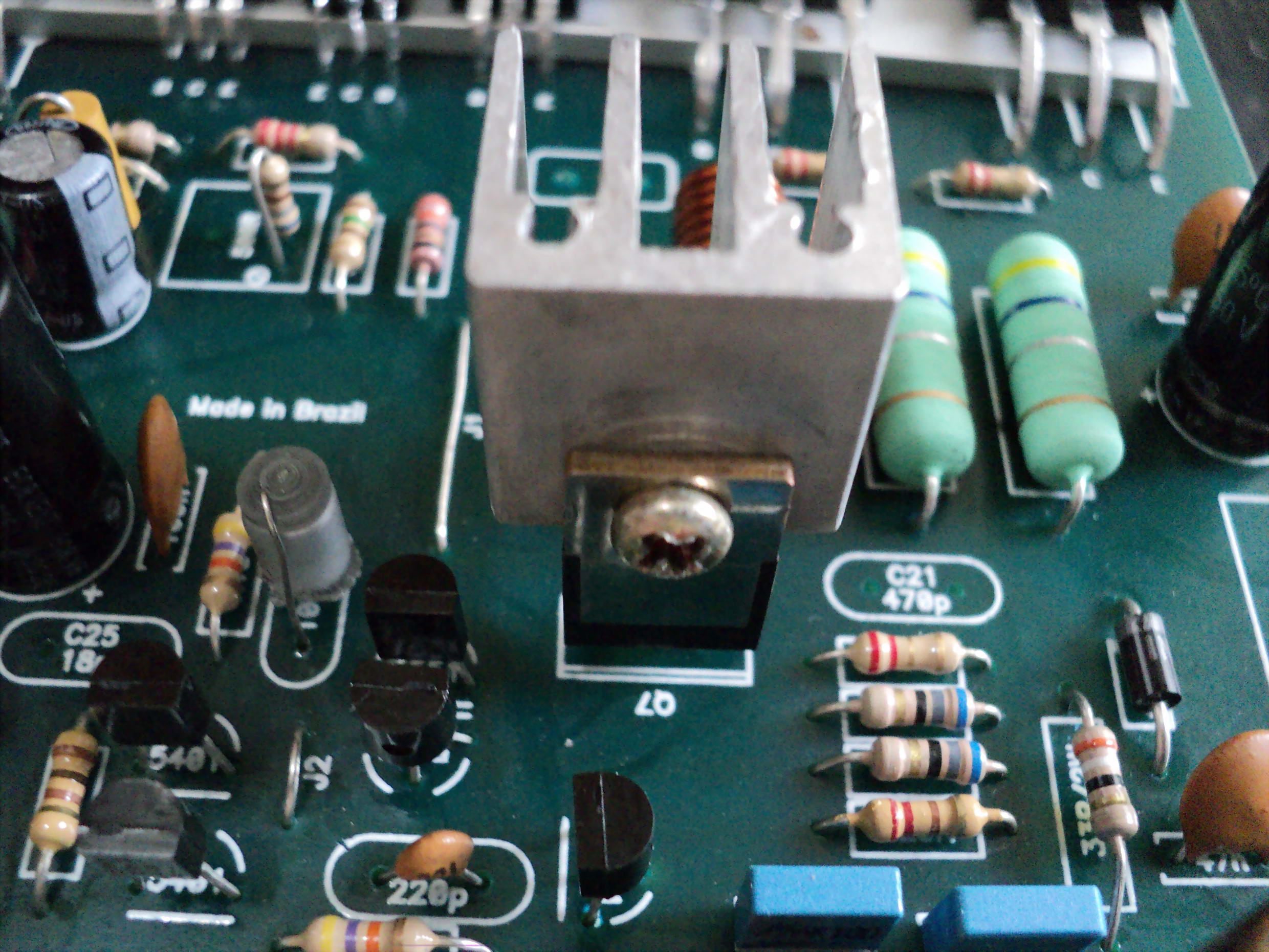

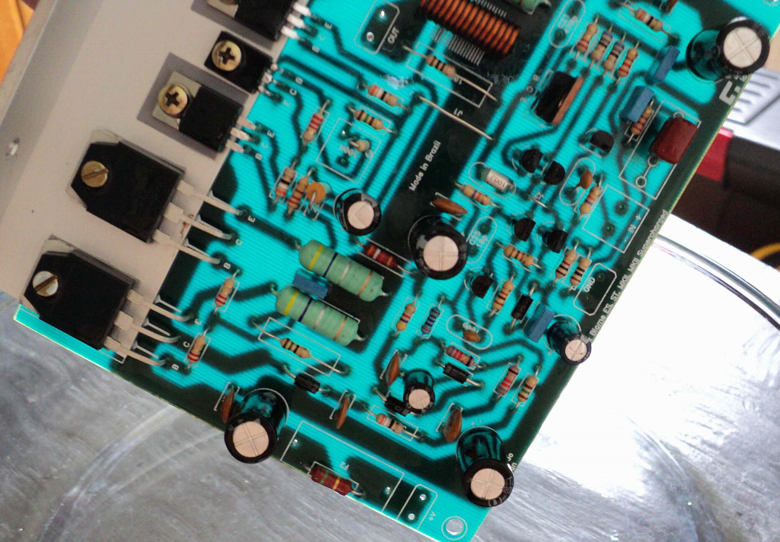

I can't understand why it would be that hot ? 😕 ES/ST VAS can't be more than 6-7ma. Without HS , 32C was max ... with PCB heatsink (below) , maybe 2-3C above the room temperature. I even use a little to-126 , still ... just a little heat.
OS
I also could not understand...well...if we do not know the causes of a
disease....at least we know the medicine to reduce temperature...i have installed a heatsink too...will try one alike yours.
Usually i am having 35 volts in the supply....so..maximum peak to peak is not so big...now i am having more than 55 volts.... this increased the heat....usually my amplifier does not use heatsinks to the VAS....i do think this one is needing...i will suggest folks to use a tiny aluminium blade.... a thin foil... these thin ones used by comercial amplifiers down the eigthies.... so...a rectangular piece of 6 by 2 centimeters, folded in U shape may work well too.
regards,
Carlos
regards,
Carlos
regards,
Carlos

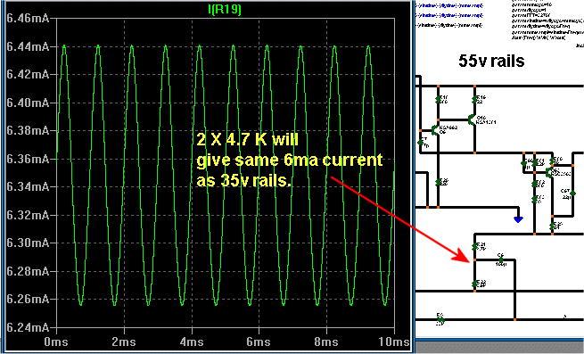

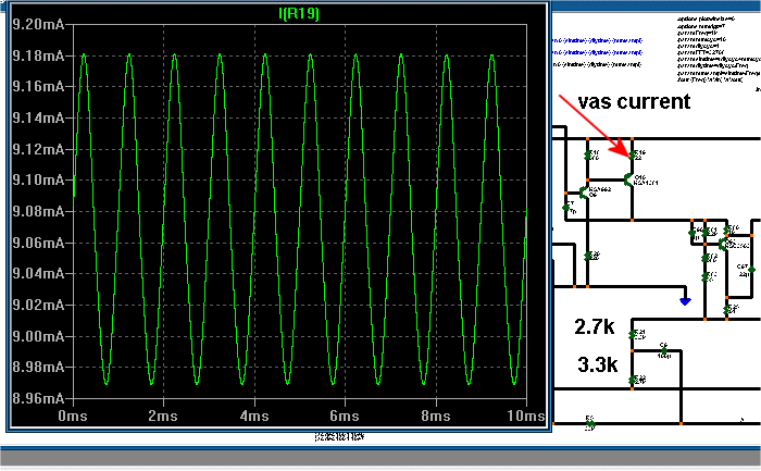

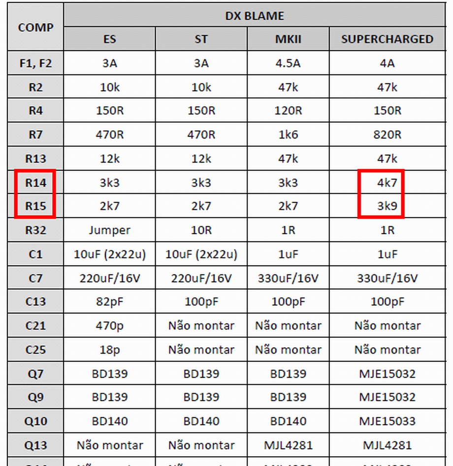

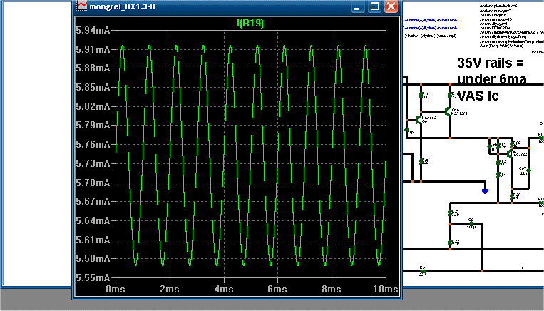

You are trying to cure the "fever" , not the disease....
When you raise rail voltage to 55 , VAS current increases .. throwing temperature and bias off.
(pix1) is ES/ST clone at your 3.3k/2.7k bootstrap network , 5.8-6.0ma @ 35v rails.
(pix2) , raise rails to 55v ... 9.1ma. This MIGHT heat up the VAS device with large voltage swings.
(pix3) is the "corrected" VAS , back down to 6.0--6.3ma with 4.7k/4.7k as the bootstrap resistors. I had to even increase these to 6.8k/4.7k for 75v rails to keep my 6ma.
PS . CCS VAS does not have this issue , non-bootstrap will stay 6.02mA all the way from 30-75v.
OS

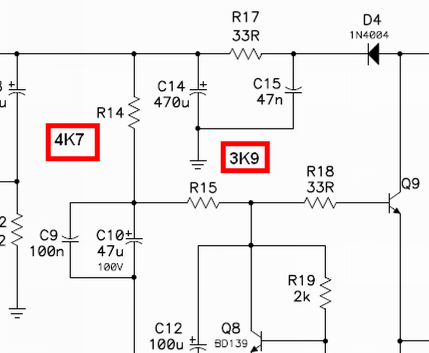

Attention.... VAS emitter resistance needs replacement in the Supercharged
here you have more details:
http://www.diyaudio.com/forums/soli...mkii-supercharged-release-37.html#post2429305
regards,
Carlos

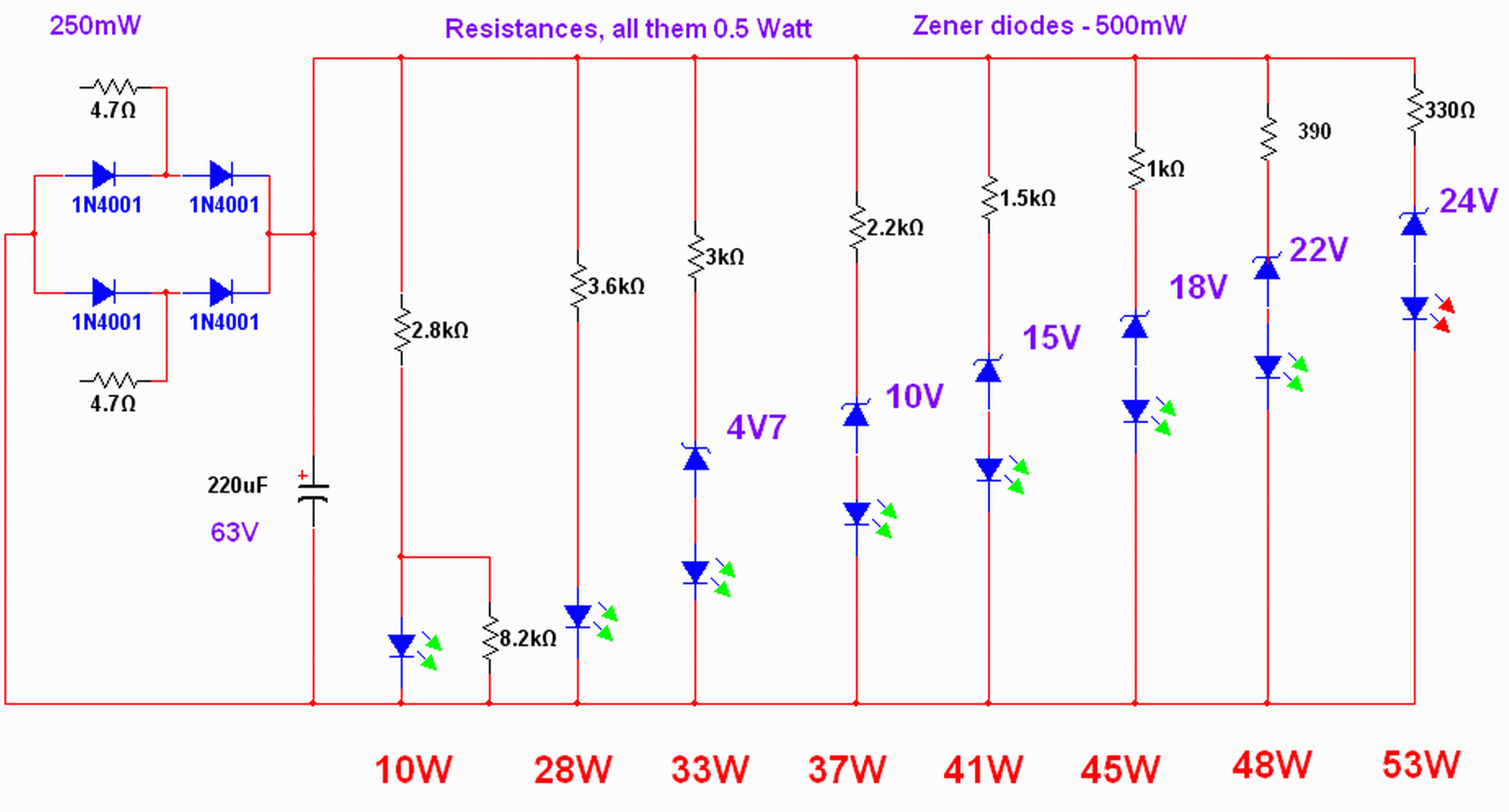

Dx power meter - untested 50 watts version
This was only simulated...for sure will need some resistance adjustment to match led brightness and to adjust the ligthing threshold point.
This is not a measurement instrument, it is just a gadget to you to have fun....led operates in a range of brigthness, so, you have one different value of indication when the brigth is dim or strong...current is around 6,5 miliamperes to full power input.
It can be used into speaker panels or inside power amplifier enclosure.....do not need supply....audio is rectified, filtered and, as consequence, converted to DC.... an audio feeded device that will drain around 56 miliamperes from your power amplifier output signal.... if you use 4 ohms, then multiply by two your power readings.
Consumption will depend on your output power...can go from a couple of miliamperes to around 60 millamperes...you can use other condenser value if you want... these input resistances are protection, alike fusistors.... it should burn if you experience a short into your bridge rectifier (this happens)...then use 1.4 watts resistances..they are there to burn easy and fast..also to provide a minimum load to the power amplifier if you have your rectifier bridge or diodes shorted..then they will burn and circuit will be opened to the power amplifier output... fuses are welcome..but small resistances will do the job too.
I have tested the 100 watts version and i do not have any fear about the circuit...led brigthness should be retouched if you decide to use other colours...not only the ligthing threshold but also the brigthness may need resistance tweaking.
The Corporation accept, gladly, suggestions to improve...but using simple discrete components....we do not want CCS, or fets, or chips, or complicated stuff....this is a toy and should continue to be DIY, a gadget, for free and for fun and directed to uncle charlie diy friends.
Internet has a lot of circuits with dedicated chips....so....there you may find something more serious if you need.....this one is nice because simple, easy to be made and will work without troubles if you are not too much demanding about precision.....a gadget fellows!

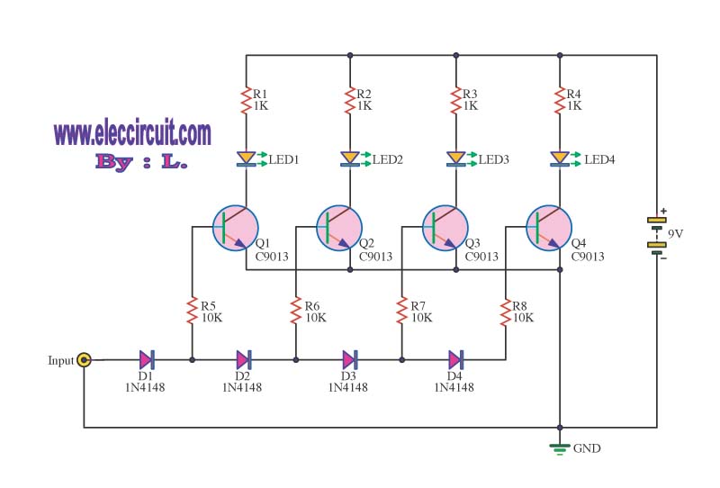

If I were to make one , (below) would be where I would start. Divide the input down with a few resistors to scale the readout to the amp ... done. To slow (average) the response time , add a cap to make the input divider have a R/C constant.
I would add a 470k pull down resistor from each base to ground for more reliable led switching. 🙂
