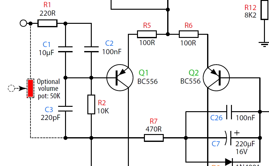

Dear Carlos, on gregs website for DX Blame ST, when you read the BOM there are a few errors in it, like it only Mentions 2x220R resistors when you actually need three of them, and the BOM has C18 as 2.2uf but the layout has C18 as 220nf, these are small errors I have found thought some one had noticed them.
R1,R16,R24 = 220R (only mentions R1 and R16 on the BOM)
C18 = 220nf (its 2.2uf on the BOM)
Have a nice day

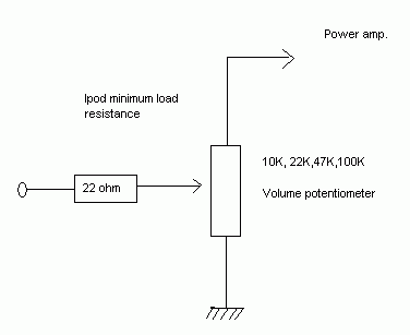

Now i understand your worries dear Simon... you will use an Ipod!
You intend to use a power amplifier output to generate audio to the Dx Blame...and Ipod as audio source!
Poor Dx Blame.... may kill itself because of sadness receiving such kind of audio source... these units are prepared to earphones or headphones....low impedance and equalized to match these transducers.
Ipod earphone jack is low impedance, and really when the wiper short to the ground you will offer a very low impedance to your Ipod....better to use line out jack.
Installing a series resistance to the potentiometer wiper, then you will offer the best load for your Ipod, exactly with the wiper shorted to ground...the input series resistance will be optimal load for it.
Also for some audio sources, line output levels, may be happy having such kind of loads too...to line increase it to 4K7 and they will work happy too.
Both ways work...the priority to the audio source or audio amplifier input is what changes the way you will connect...hundreds connect my way...i use to give priority to the power amplifier...and no builder have ever complained.... and you may be the second to plug an Ipod to it... i think i made it first but i really have not appreciated the sonics.

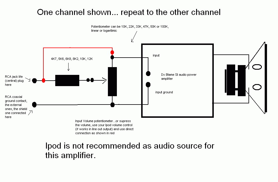

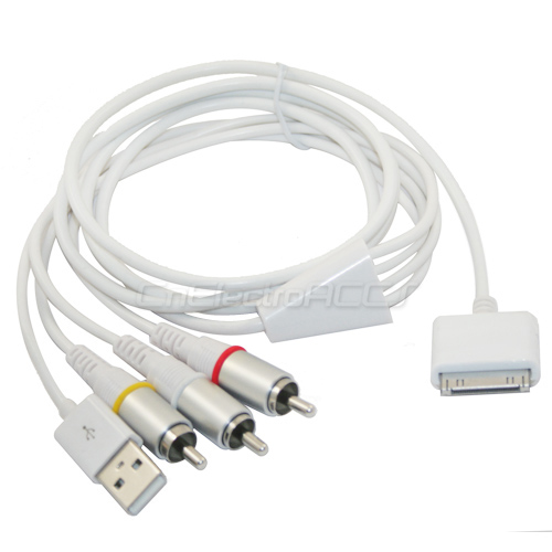

I am not expert in Ipod....i do not have them...so...i have only basic
informations about.
I think so, as you have a line out connection and this is standard in level and impedance.
To go to the safest side, my dear, install in series with your volume pot input (wipe) a 4K7 resistance and be happy.
regards,
Carlos
informations about.
regards,
Carlos
OK. Will do. Might do tests with and without when amp is finally built. Been waiting what seems eternity for more parts to arrive to finish building. Seems longer as I am eager to build 🙂
Good idea...make your testings and realise these things by yourself
This gonna be an excelent experience for ya

informations about.
http://www.diyaudio.com/forums/atta...res-reviews-comments-here-please-niss-man.gif
That way is not the usual way to connect potentiometer in audio lines.
Usually the output is taken from wiper. On the amp side.
As other have pointed out, too.
I am not saying that way in figure will not work.
It will work. If Carlos say so.
Even if it looks strange to me.
Regarding Ipod.
The amplifier will not know there is one Ipod or whatever connected.
The amplifier will do its (good) job no matter what you connect!
It does work either way, and rather than just say "carlos's way is wrong", I would explain it like this - the reason to use the wiper as the "out" is so that the source sees the constant resistance of the pot as it's load, and not a varying load which may affect it's drive capability, and therefore the sound quality.

Lineup and Jaycee, be careful of what you saying here, it is not on shorting the outputs of a preamp or cdplayer or ipod or any other source you may whish to use. Read the instructions manuals of these sources and youll most probably find warnings not to do it, now you guys are saying its ok, yes there is most probably a resistor on the outputs of these sources, especially these cheap type sources but those are to make them idiot proof to some extent (note also for stability issues), the designers started to use them to eas warranty claims which are problematic and not so you can deliberetly short them and then push your luck when you make a warranty claim against damaged products.
I agree with Andrew, this kind of schemes should be prohibited from this forum, not only because its against the manufacturers instructions, against basic design principles but also theres newbies here reading and they should not be learning how to use volume pots this way which is totally incorrect.
Secondly youre not thinking of the degradation caused to the sound quality of the source when at low volumes the pot would have low impedance causing the source to double, triple or maybe even more its THD (if it was made to be idiot proof so it wouldnt cause failure in case of short circuit or too heavy a load), now you end up with a good sounding amp with a terrible sounding source.
Any reasonable well designed amp will not deteriorate that much from having a variable impedance at its input, if it does then rather redesign it.
At least I see Carlos went back on what he said and recommends using a resistor in series with the wiper if this is the way you want to use your pot. Apple in Brasil or any other audio manufacturer would have a field day rejecting warranty claims and would not be very happy if they read what is recommended as use of a volume control in this thread. I actualy think you could get in some trouble with them if they saw what was suggested here, it could cause them and their costumers to lose a lot of money. Guess thats why theres a not recommended for ipod sentence in that drawing. I wouldnt recommend it for any other products just as well. 😀😀😀😀
