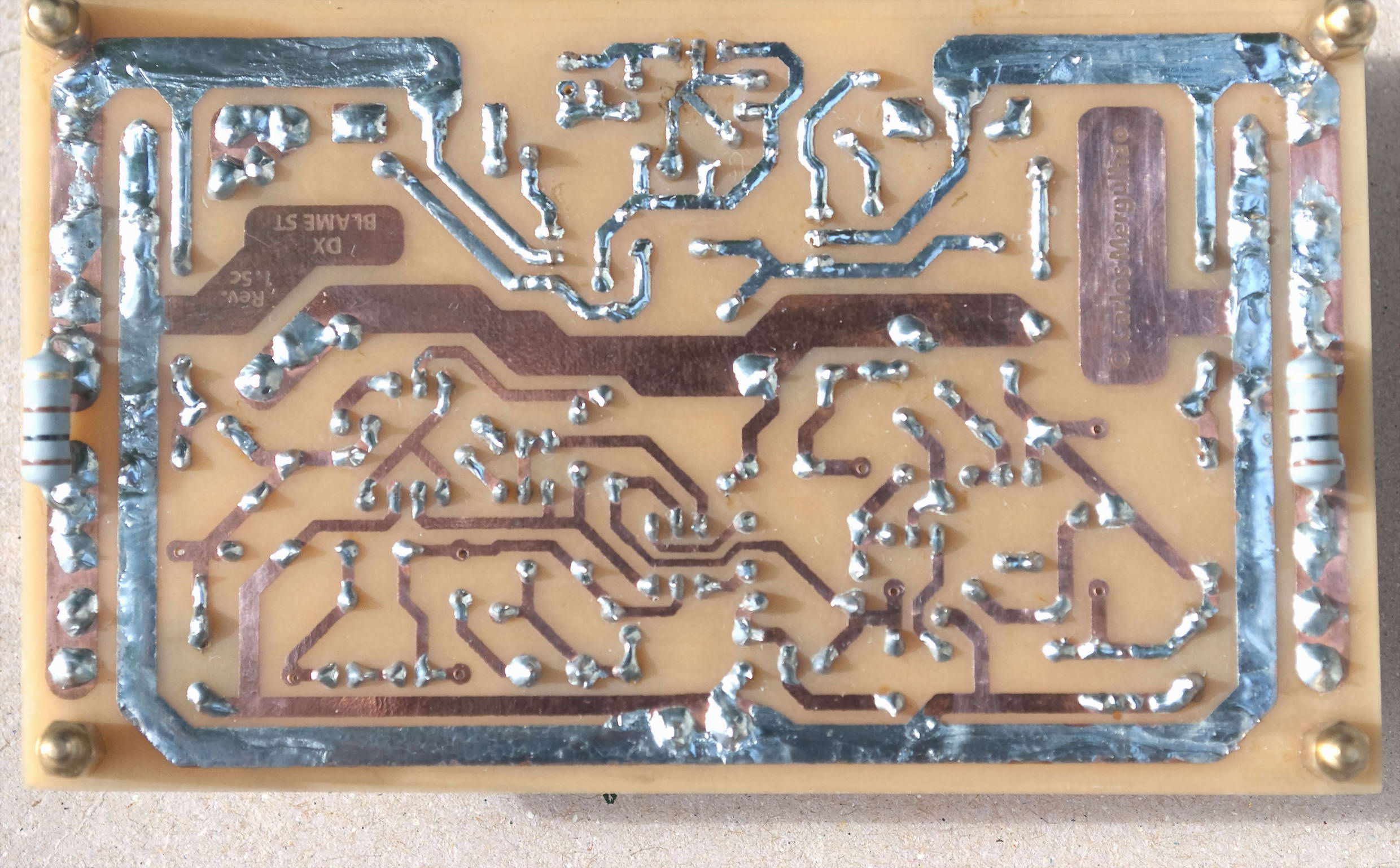

Hello Carlos and All,
so it seems that cleaning all the solder flux is Very very Important (As pointed by Carlos to me), the problem I had with the 100R resistance getting really hot on the negative rail completely vanished after I thoroughly cleaned the board using a contact cleaner, thanks for all the help Carlos my friend, I will build the other amp now, hope you got the images I sent you,

I have just found your images..many thanks my dear...good ones!
I am happy you are happy..that you've found the trouble ...yep...board cleaning is important... create problems after cleaning to solder once again.... no flux no good solder and you have easy shorts..the solution is to spray WD40 into the board to solder...and when finished, remove with alcohol or Kerozene (aviation fuel)

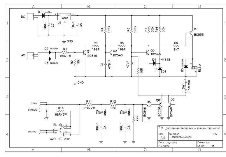

I have not found the protection board layout.
Here you have the link to the Brazilian group buy...now closed to receive orders..and will not accept orders from strangers.... i will check this stuff with forum management...what they think about, and then i may take different directions and different decisions about.
DiyAudio.com.br: DX Blame ST
Protection schematic is attached below...it is a circuit used in some professional amplifiers Made in Brazil... this one adapted, modified by Nabuco, also assembled and tested.

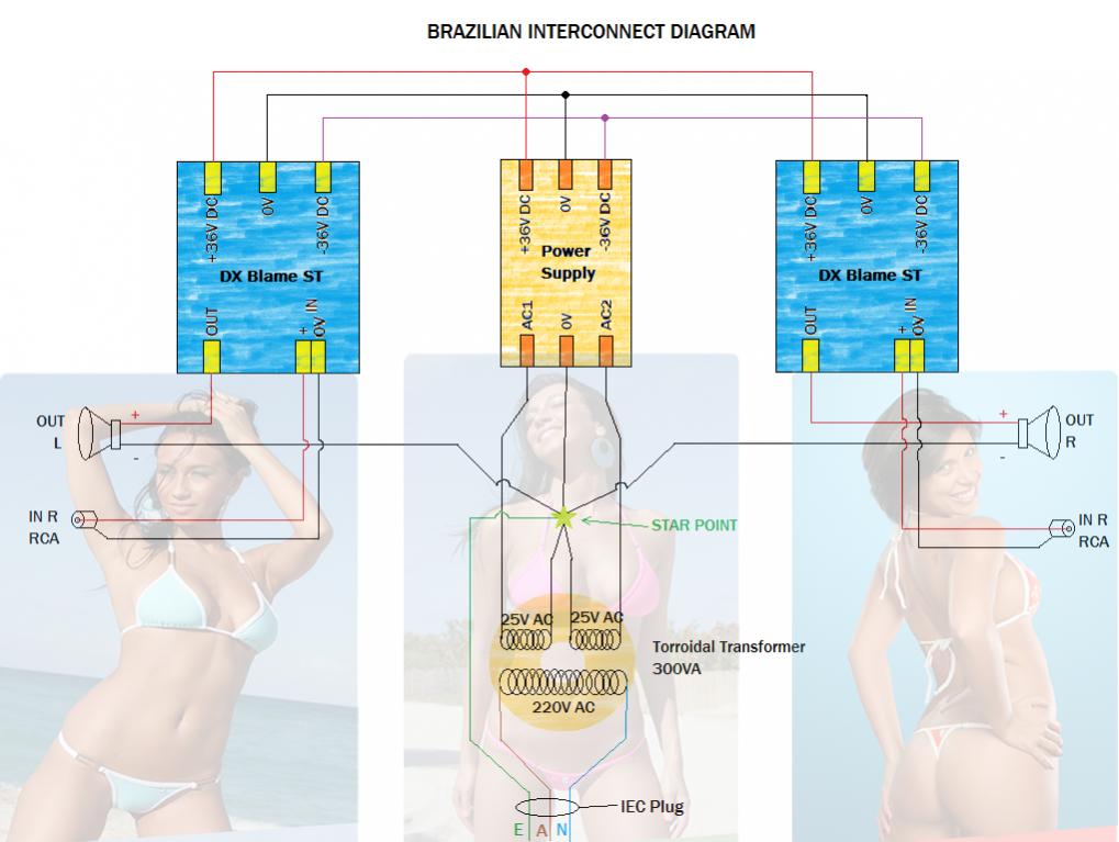

Brazilian Interconnect Diagram
Hi Carlos. Can you check if this is ok. I have been reading up on how to connect the amplifier together. I will be using a single 300va torroid and a powersupply with 40000uf capacity. Is this the correct method to connect amplifier together?
Regards
Simon
Regards
Simon
Yes Simon...of course i can...will take a look
