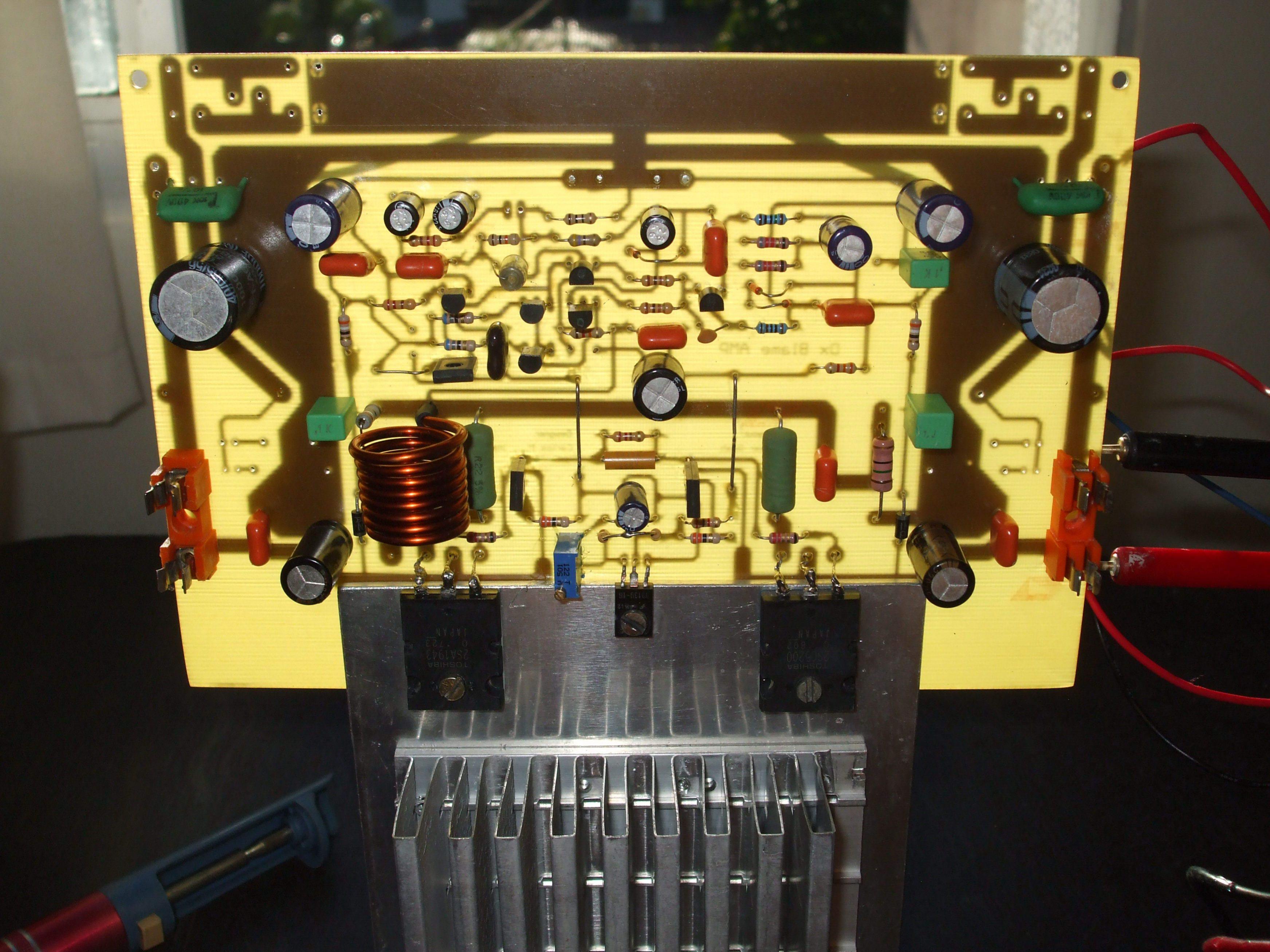

Dear Carlos, I have finished one DX Blame ST amp, I used the PCB layout on the gregs site, and created my own PCB, when I power the amp using 100 ohm series resistance, one on the Negative rail gets really hot and voltage across the resistance read close to 10V, positive side dont get hot, Can you tell me what I did wrong, I used +-25V DC
Thank you so much.
Thank you so much.
It is difficult to point you the cause.... the error...the mistake
for sure there are errors....maybe only one...maybe several.
You should check all your job, transistors position, if NPN is not in the PNP's placa, the resistance values, the solder joints, the condenser polarities...inspecting your board against strong ligth to observe in the transparency mode.
Now is hard job man.....and really only you will be able to find the mistake..i can just give you some courage and enthusiasm to go ahead...to keep you calm saying that soon you will find the mistake.
We use to do mistakes..this is very common.
The VAS transistor, the BD139 inverted can do that... sometimes it burns when inverted ..... but other hundred things can result in that defect, that causes this effect of huge current into the negative rail.
First check if transistors are the correct ones, and positioned correctly in place...watch the board image and see (enhanced image) that you have one small transistor that is mounted facing the other (flat surface facing another flat surface).... also the metal part exposed in some BD139 must face the board input side...the ground track side...... check your drivers and your power....see if you have NPN in the correct NPN place.
If you can, then produce a high resolution picture, using macro mode in your digital camera...natural light... try to avoid shadows adjusting the board considering the sun position....a good focused image can help ...this way i can check with you...do it both sides..and send the full image (do not reduce) to:
carlos.eugênio1951@yahoo.com.
In our forum the limit is 1 Megabyte.... this is not enougth to zoom in and observe details.
Do not use cell phone...pictures from Cell phone serves for nothing in electronics..even the 12 Megapixels ones produce awfull blurred pictures.
regards,
Carlos
Thanks so much for the reply Dear Carlos
Yes I know carlos sorry for the late reply power problems where I live, I will check all the solder joints and Transistors, I will mention some changes in the components I used, because I couldn't find the exact same ones, I'm not sure if they will cause any problems.
for 3K resistors I used 3.01K Metal film ones
for 1N4001 Diodes I used 1N4002
For the Trimpot I used a Multi turn 500R one
I will take a Macro of the PCB and send it to you carlos, thanks for all the help, it would suck if this wont work, I was so waiting to hear DX sound..
Have a good day carlos.

No problems Zeraphine.... this happens with me daily.... in a normal basis
Mistakes is what happens here.... i do not feel impressed you made one....i have made thousands in my life.
Solder...sometimes solder is the problem..... some guys knows how to solder...and others do not know
Shorts caused by solder.... they happens, and sometimes are hard to be seen...clean the board using a brush dampened in Alcohol...it dissolves the solder flux, that brown thing that looks dirty.... we should remove to inspect using magnified lenses.
Board should be inspected against strong light, in a transparency way.... to see if we have interrupted copper lines, or shorts... sometimes missed lines because the heat transference method use to have detached lines that are missed...these lines goes attached to the paper using as base to transfer the image... usually we perceive while soldering...because you gonna solder and no "island" of copper to solder the terminal.
Invert transistors, to assemble wrong way happens a lot.... also the mistake installing NPN in the place we must have a PNP.
Electrolitic condenser invertion happens too...some of them have leakage or inflate, or explode after overheat and acumulate gazes inside.
Wrong resistances also happens.... colour code reading mistakes.
Power supply voltage invertions... this happens a lot too....because of that i use red wire for positive, blue wire for negative and black wire for ground...but even this way you can solder (in the supply) the red wire in the negative side (ahahahahaah!)
Once i have installed 10 ohms in the positive side and 100 ohms in the negative side as protective resistances.... that way i had bigger reading in the negative side.
Have to check.... how to check?
Make a copy from your schematic in your printer...or draw it in a sheet of papper manually.
Then go checking each line of connection and painting red over the papper....red will be checked lines..the present lines...observe the pcboard watching it against the light.... do it looking at the component side... when finished take a look if all lines are red in your schematic....if they are..the board is fine.
Now start to paint red transistors..check them, the model number and the position...check if base is in the right place...if emitter is in the rigth place...as a consequence colector will be in the correct place..the last one does not need to check.
It is time to check each resistance...do not believe in colours and codes....measure the resistance with a multimeter.... you will measure strange values as resistances soldered in the circuit measure less because the circuit....but you may have informations...you can measure much less..but you cannot measure bigger resistance than the expected value....if you have suspection you should lift one side and measure once again....paint resistances checked in the paper
Do the same for diodes and capacitors and condensers..check position, polarity and value.
Your paper will never be all red..because you will find something wrong..will fix and your amplifier will work fine without the need to go on with the red painting method (can be blue or other colour too..ahahahahaah!)
It is just hard work...but the method is safe, the amplifier is not powered,so, no reason to be stressed... calm down, control the frustration, be sure it works because several folks assembled and it really works..be prepared to hard work, sit in you workbench saying to yourself....
-" I will not leave this workbench till i found the mistake"
Switch cell phone off, ask family not to bother you, shut the door, play a soft music to relax and go ahead.
regards,
Carlos
