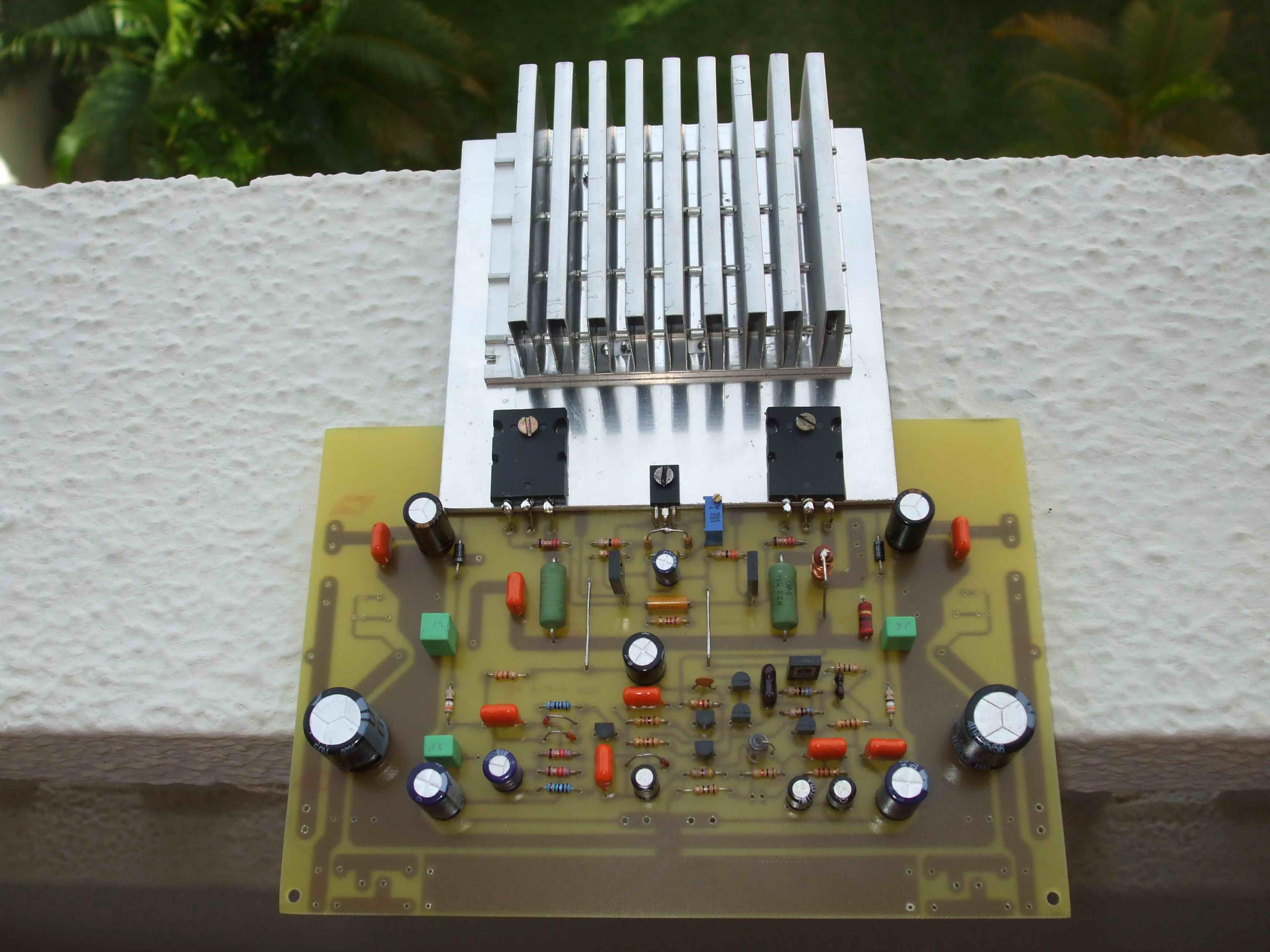

Dx Blame ST, a top performance amplifier..do not believe me
... do not trust me...go to check.... i want you to check...build one and return here with complains.
I want you with envy and anger.... crazy to smash my amplifier....i want you to build to check. i am sure you can do that (it is not that good) only saying lies here.
I want you to have doubts... may i be not telling the truth?.... is that a simple sound amplifier alike it looks in the schematic?.... check that!
Wanna to show whole world i am a lier?.... then build it!
I will see you here, returning, to say thanks!
The answer to your thanks i can give you in advance:
- "You are welcome!"
Boys!... uncle Charlie is a fanatic for audio amplifiers.... i have 59 years old...since 9 years old building amplifiers... average was 2 amplifier in 3 days..... calculate 50 years with this statistics.... but i think was around 500 only...i lost the account about.... all them dismounted to use parts to assemble others...also i have bougth hundreds to listen, to inspect, to study schematic.
THIS ONE IS THE BEST AUDIO AMPLIFIER I HAVE EVER LISTENED TO.
What are you waiting for?

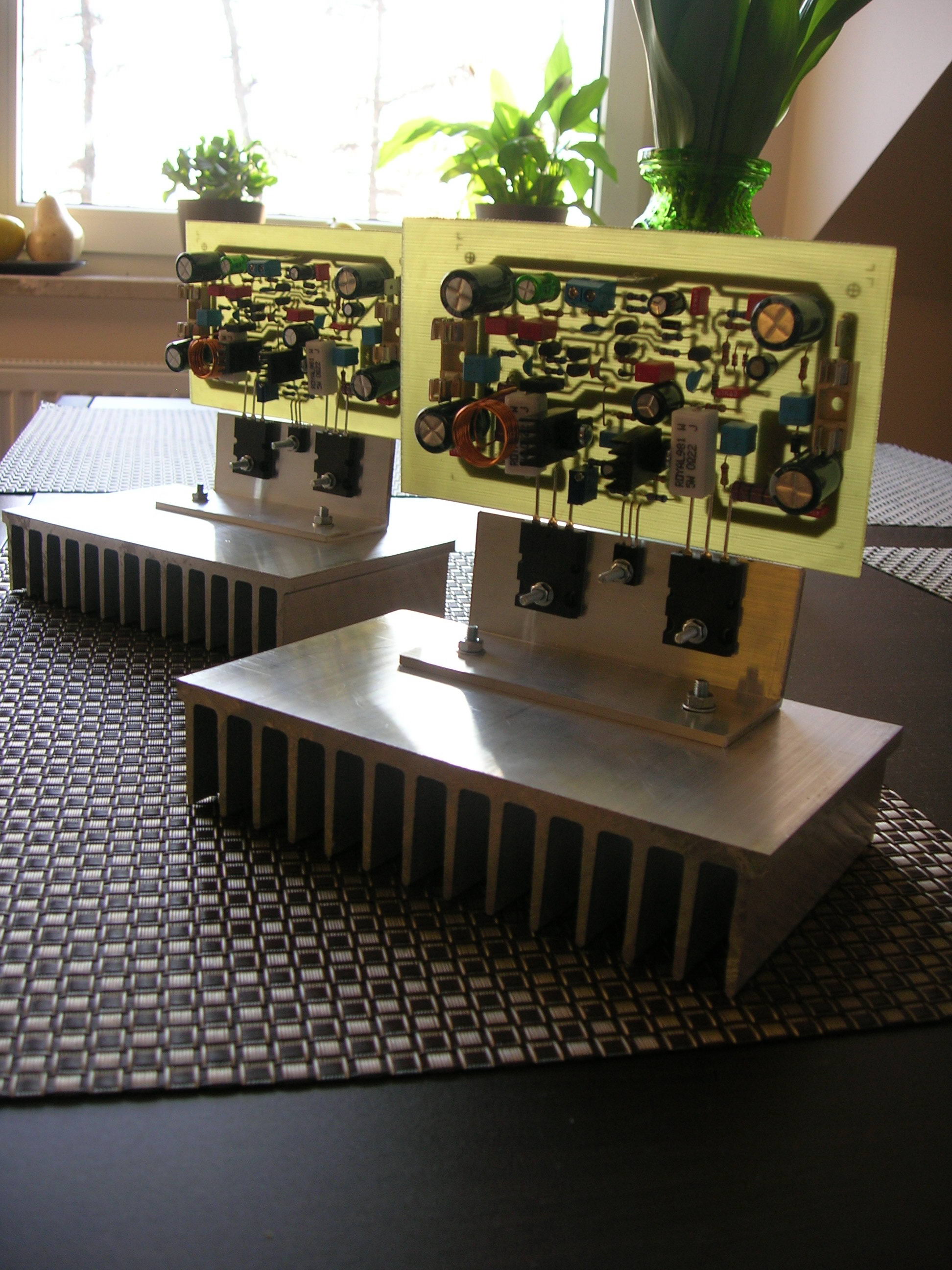

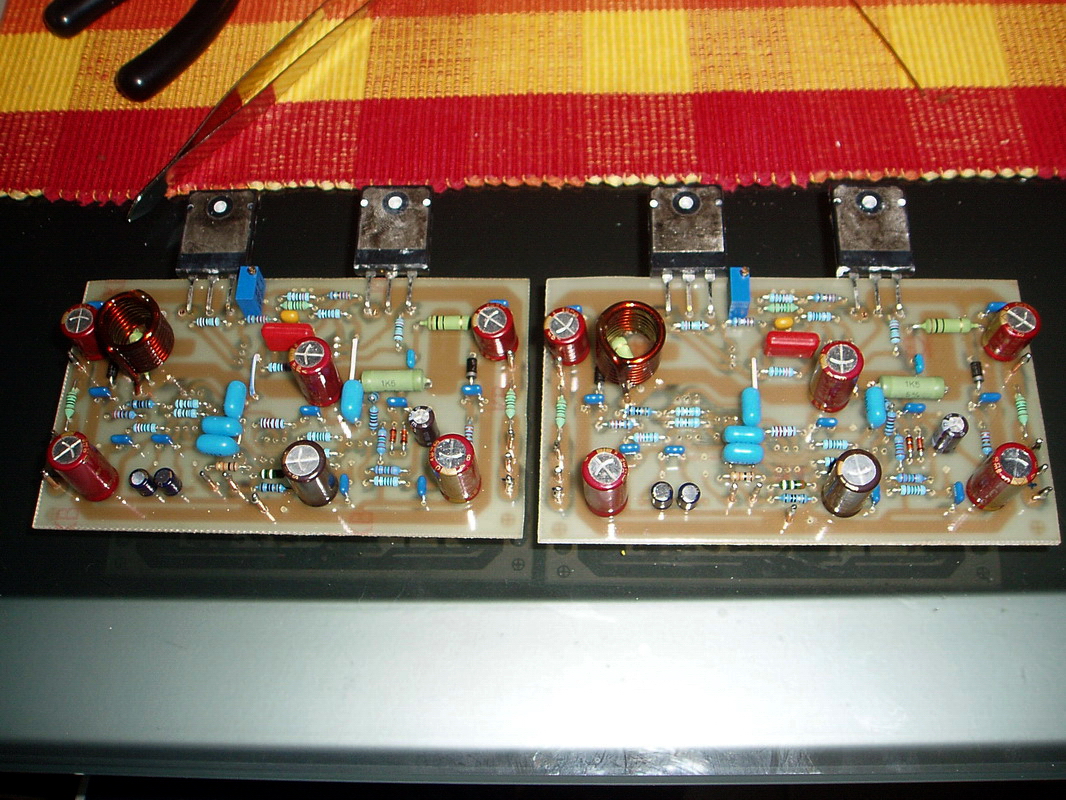

Daniel from Croatia made lovely Dx boards...also Luka from Polland did
I hope Brazilians, as they are more than hundred building, will be able to do such good looking amplifiers too.
I am there, in the Brazilian forum helping my people too.
I am not having spare time anymore.... thank you Daniel from Croatia and Luka from Polland.
