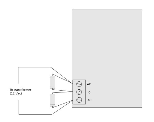

This image shows the wiring...
It should allow you to use your original 12VA transformer 🙂

My pleasure. While you're waiting for that email, please try the diodes (if you have any).
As I see it, your options are:
a) Fit the extra two diodes and possibly increase the values of C1 & C2 to 470uF/25V each, or
b) Use a 12-0-12 transformer, connecting it to all three board terminals.
With half-wave rectification and the relatively low-value smoothing capacitors (2 x 100uF), you're just not getting enough current into the regulator.

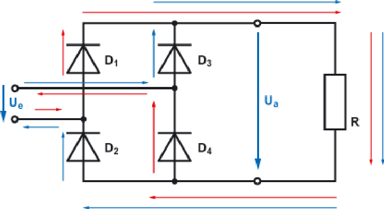

Using option a) will cost less than 1 euro for two diodes and achieve exactly the same result. You would only need to install two diodes on one board and then connect the three power terminals of each board in parallel. This makes the most sense when you have a perfectly good transformer 😉
Rudy,
with your current implementation (you have the 2 upper diodes, D1 and D3 installed), the current does not know where to flow back.
Get the 2 diodes that CURRENTFLOW told you, solder them correctly - and you are done.
Best regards - Rudi

This is because before you added the two extra diodes, you had a half-wave rectifier. Capacitors C1 and C2 (both 100uF) only became charged on the positive peaks of the AC input cycle, while the negative peaks were being unused. Their values were too low to maintain the voltage in this way and were discharging faster than they were being charged.
Adding the two extra diodes causes these capacitors to charge on the negative half of the cycle as well as the positive. Therefore the capacitors are now being charged twice as often as before and you now have full-wave rectification. Increasing C1 and C2 to 470uF (25V) would improve the situation even further under load when the relays are on. I hope that makes sense.

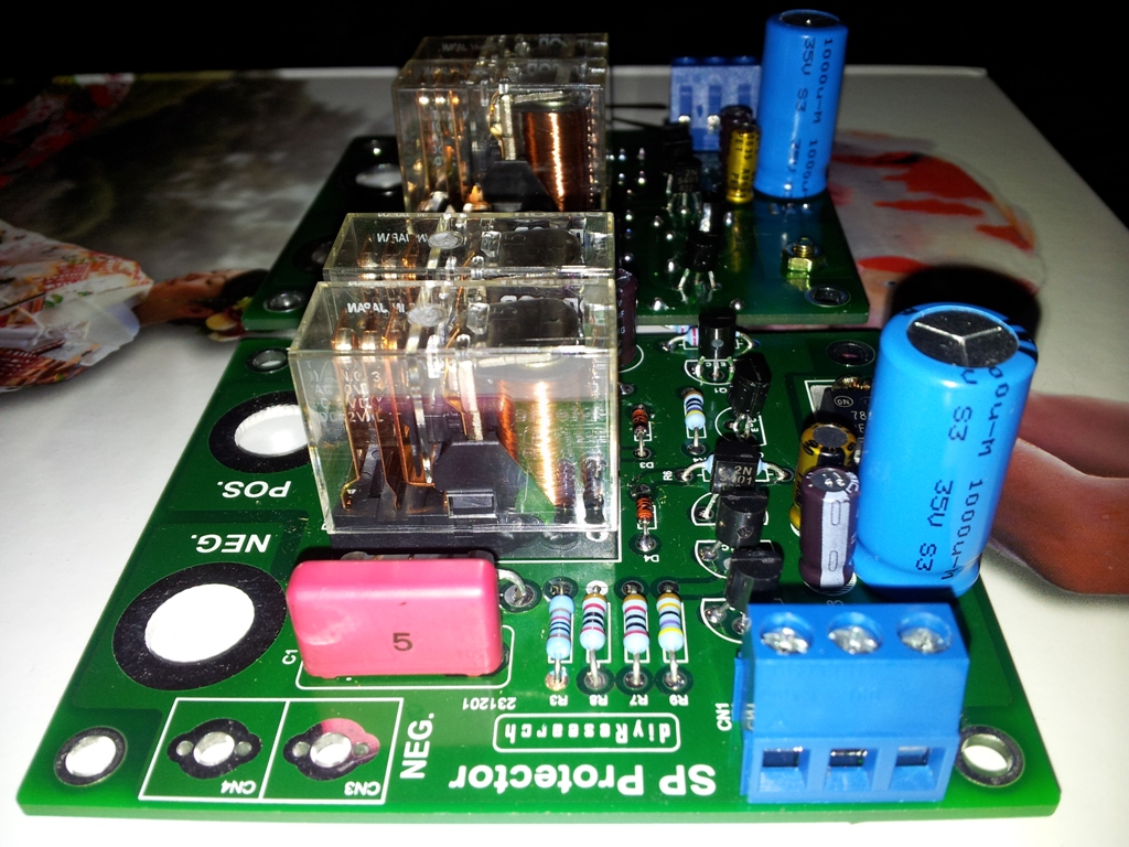

Hello currentflow,
Thanks for your help, I now have a 1000uF capacitor soldered in there, and the speaker protection module is now stable.
Thanks vintage audio lab for a "good and stable speaker protection module you send me" 😕 🙄
We on this forum do the research to make this a good and stable working speaker protection module
Rudy

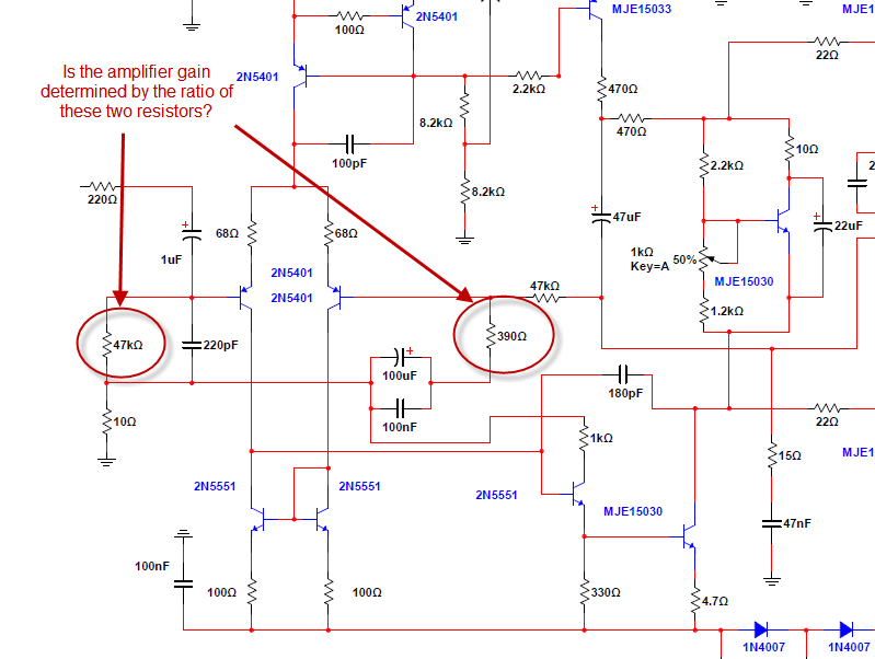

Question on gain
Hi everyone, quick question here...
The gain of the Hx amp seems very high compared to "consumer" power amps. Basically, a consumer amp rated at 200W RMS into 8 Ohms will show a gain averaging at around 28x.
Now when I look back at the schematics of the Hx, the gain seems to be around 120x. Am I missing something?
I think Carlos determined that 390Ohm resistor for direct connection to portable devices, hence the huge gain ratio.
Picture showing the two resistors used for calculating the gain:
I had similar question in the past and Carlos answered me that I can change the value of the 390R resistor to adjust the gain of the amp.
Also I think that gain is determent by the two resistors in the NFB and not by this in the input to the GND. In this case you are right because they have the same value but keep it in mind.
