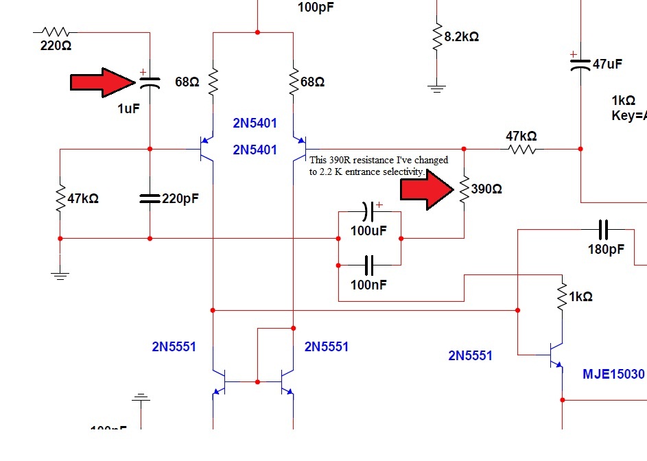

Don't be fooled, no official list or "BOM" has been posted. Everyone builds its own from the schematics.
I've changed 390R resistance to a 2.2 K resistor.
Now regulates my Fettle Preamp better, it was 4 steps on listening quality with the 41-step series attenuator of Acoustic Dimension.
Now it take 10 steps, much nicer listening with the with the 41-step series attenuator.
Have now ordered 2 pieces Charcroft Z-Foil Resistors 2K2 0.4 W.
For replacement of the 2.2 K TAKMAN Audio Metal Film Resistors.
Wonder what the differences will be.
I have told you all before:
Also I have the bridged with a wire (Silver/Gold) the 1uF capacitor and this sounds much better, sounding instruments now much looser/opener.
I will replace these 1 uF (MKT1813 1, 0uF Roederstein 100V) one more time and replaced by a 1uF Mundorf silver/gold/oil I still have lying around here.
I hereby wish like some help and suggestions from fellow forum members what a good capacitor is for this place in the signal path.
The rule is NO capacitor "sounds better" than a capacitor.
I ask this because I want to listen one more time to the passive Inductive Volume Control of TRIBUTE Audio again with “the best cap” on this place.
NOTE:
The bridged wire (Silver/Gold) with the 1uF, can only if you used a preamplifier and no passive volume control.
Then you have the chance you'll hear steps of the passive volume control.
Then you hear a bit of DC voltage with your passive volume control.
Most Preamps (99%) have an output capacitor that the DC stop.
You will be thinking how these Dx Blame MKIII-Hx sounds?
I do first some modifications to this amplifier, changed with some salt and pepper but I can say this amplifier sound good ... 😉
