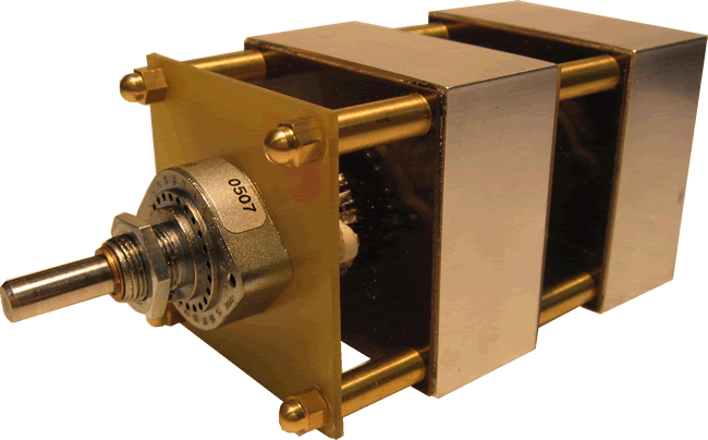

My passive volume control (41-step series attenuator from Acoustic Dimension) sounds better than my active Fettle preamp, with the 1uF cap. (
Can you still follow?)
BUT only without this 1uF cap my active Fettle preamp sounds better with the 41-step series attenuator from Acoustic Dimension.

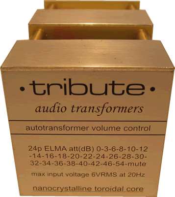

Today I also listened music with an passive Inductive Volume Control from TRIBUTE and these one is the best from all "in my set".
And if you you use passive volume control, you take a very good 1uF cap because this cap sits in the signal path.

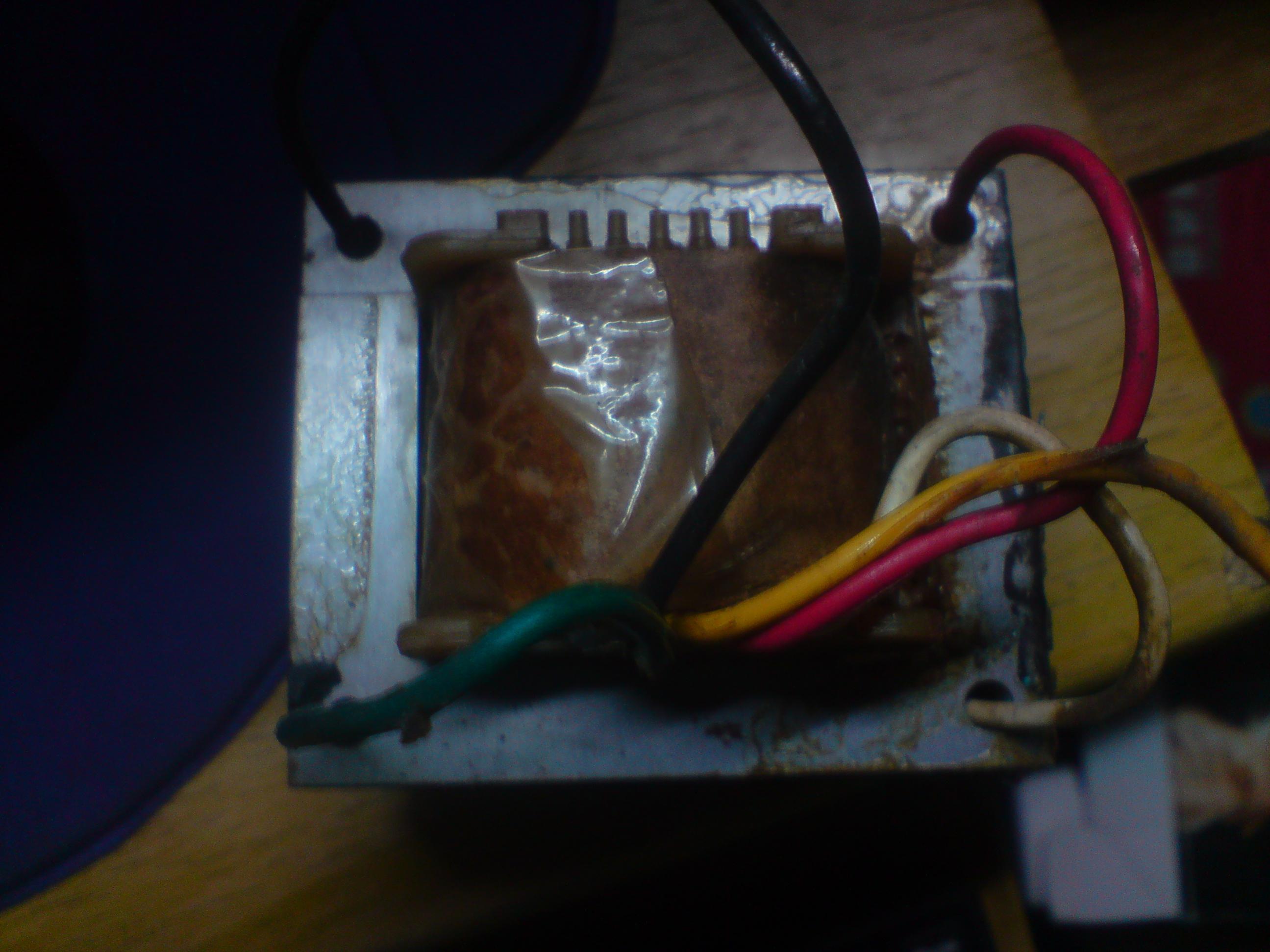

i have 29-0-29 volts transformer. i'm from philippines. our voltage from outlet is 220v, but i have this large transformer with 100v labeled in the primary. can i use 110 to 220v converter?
one more question. i have this another transformer with black, green, yellow, white and red color leads. can you tell me what this color codes stand for?

you cannot easily convert a 100Vac transformer to run from 220Vac mains supply.i have 29-0-29 volts transformer. i'm from philippines. our voltage from outlet is 220v, but i have this large transformer with 100v labeled in the primary. can i use 110 to 220v converter?
You can buy a 220Vac to 100Vac transformer that will feed the correct voltage to the 100Vac transformer.
Buy the correct transformer for your 220Vac mains supply.
show us some or a lot of details. Pics of the transformer. pics of the labelling, pics showing the diameter of the coloured leads copper cores.one more question. i have this another transformer with black, green, yellow, white and red color leads. can you tell me what this color codes stand for?
here is the link.
http://www.diyaudio.com/forums/power-supplies/206018-question-about-transformers.html

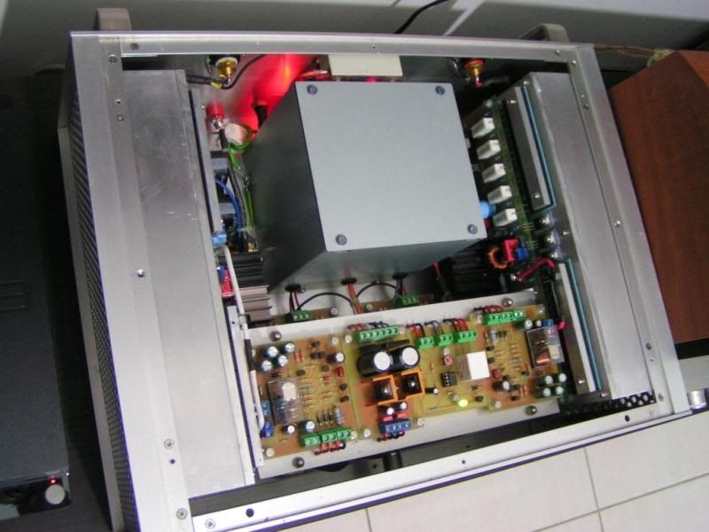

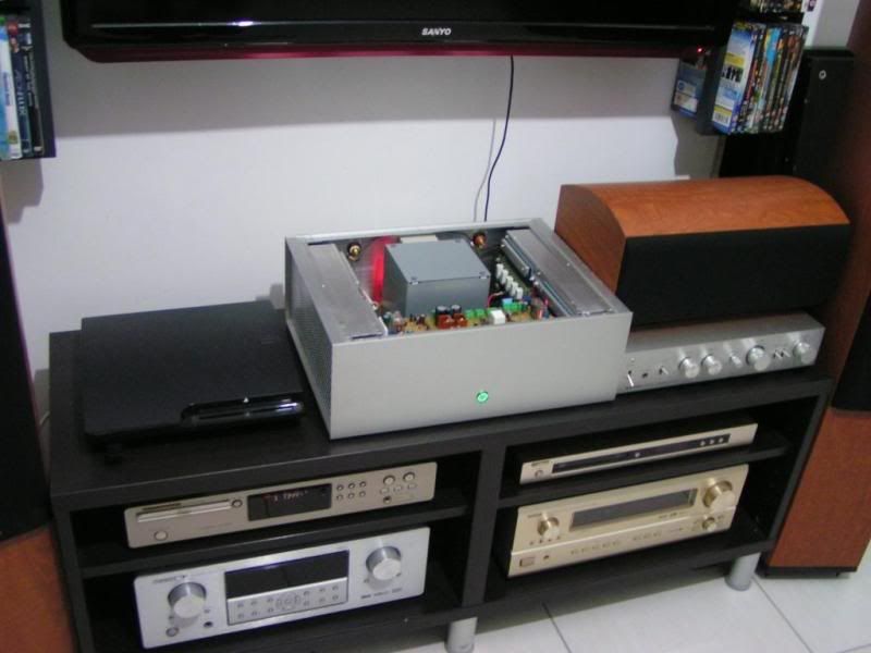

On this forum I have all photos of the construction of my amplifier:
http://www.htforum.nl/yabbse/index.php?topic=120317.msg2118137
And now I enjoy listening and thinking about a nice Cabinet for this nice sounding amplifier 😉

I can't see any detail in that enormous over exposed pic.
Pics look great! Thx !!!
Thanks for taking the time to take the pics and share them. I'm always curious to see how everyone goes about building. They look great. .... I've never seen heatsinks like that. I would guess heat won't be a problem.... This is a popular project that got raved reviews... You must be very happy!

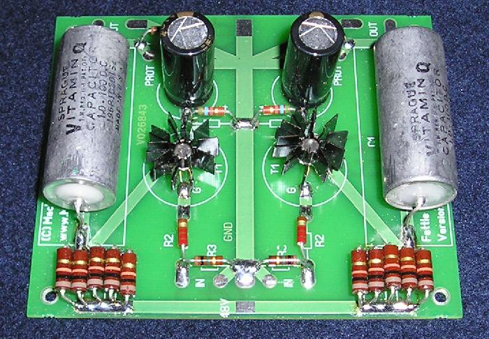

or use a Higher value maybe, 10uF is not bad or higher.
Take a look in my preamp, you see 10uF Sprague Vitamin Q Paper in Oil Capacitors in the output.
Little more info from Machmat website:
Machmat FETTLE Pre amplifier
The MachMat FETTLE pre amplifier is a class A single ended pre amplifier designed around a JFET transistor.
Because of the simplicity (only a few parts in the signal), battery power supply, zero feedback and the special selected parts used, it will beat most tube based pre amplifiers in sound and specs.
This amp has very great detail, very good placement and very smooth, easy and precise sound.
A very nice amp for purists.
And cheap! Because of its simple and small design it can easily be used in 6 channel design or modifications.
Rudy
