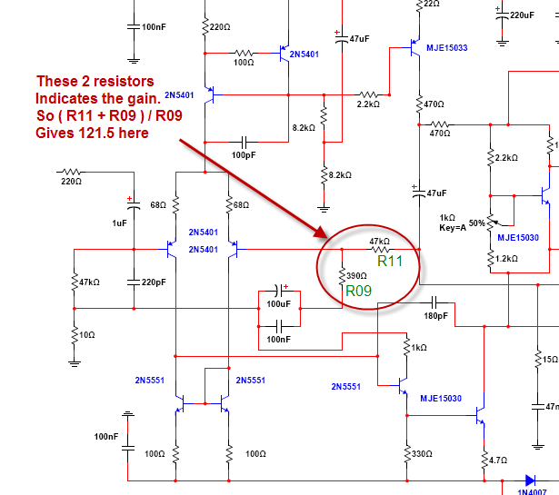

I've changed 390R resistance to a 2.2 K resistor.
Now regulates my Fettle Preamp better, it was 4 steps on listening quality with the 41-step series attenuator of Acoustic Dimension.
Now it take 10 steps, much nicer listening with the with the 41-step series attenuator.
Have now ordered 2 pieces Charcroft Z-Foil Resistors 2K2 0.4 W.
For replacement of the 2.2 K TAKMAN Audio Metal Film Resistors.
Wonder what the differences will be.

You are correct Gain =r2+r3\r2===121.5 Evette

You're right Astankov, I was pointing to the wrong resistor. The picture below is corrected.
Well, to emulate the gain of a 200W RMS /8 Ohm consumer power-amp, the values should be around 47K for R11 and 1.8K or 1.6K for R09, which would give a gain of around 27-30.
So an input of 1.4v RMS would give about 200W RMS into 8 ohm.
Please always correct me when I'm wrong 😉 hahaha.
Martin.

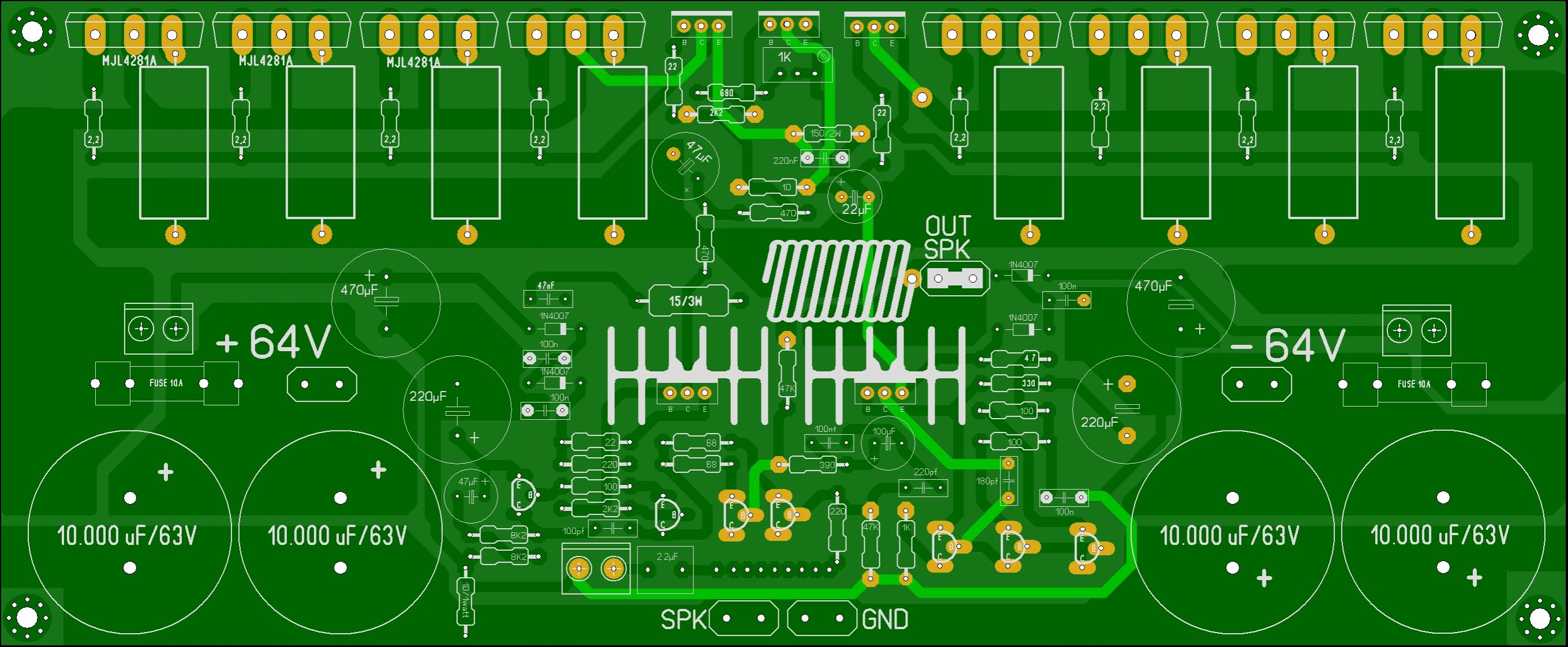

If we create a better amplifier this way, why than a new board with 4 trannies?
Patrick is it not better to create a new structure like Evette defines?
I'm going to build a new Dx Blame MKIII-Hx only if I definitely know that it gives an improvement.
Rudy
