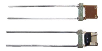

I am now ready I have listen to the Charcroft Z-Foil Resistors 2K2 0.4 w, for replacement of the 2.2 K TAKMAN Audio Metal Film Resistors.
I tell you all last week, wonder what the differences will be?
Now I can tell you the Charcroft Z-Foil Resistors 2K2 0.4 w are much better.
Especially with classical music let these resistors hear well the differences, it all sounds much more detail, the soundstage is wider and deeper.
Please do not tell me anymore, there are NO difference in resistors ...
I am not going to debate it, everyone should know himself what resistors to use he wants.

Mr. Rudy Sir, I have some transistors power for exsample 2n3055 which are good in its day. And I Also have a few miltary transistors that cost me quite a few thousands of dollars a piece. Now if I used they 2 different transistors in a series shunt power suppy would I hear a difference? the answer is no. Why not? Answer is simple, if the element is not in the direct signal path I,m not going to hear it. So your very expensive resistor which is going to ground in your fb network is not in the direct signal path explain to me how can you hear such a big difference? I would really like to learn.

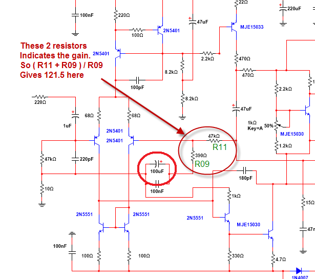

I've changed 390R resistance to a 2.2 K resistor.
Now regulates my Fettle Preamp better, it was 4 steps on listening quality with the 41-step series attenuator of Acoustic Dimension.
Now it take 10 steps, much nicer listening with the with the 41-step series attenuator.
Have now ordered 2 pieces Charcroft Z-Foil Resistors 2K2 0.4 W.
For replacement of the 2.2 K TAKMAN Audio Metal Film Resistors.
Wonder what the differences will be.

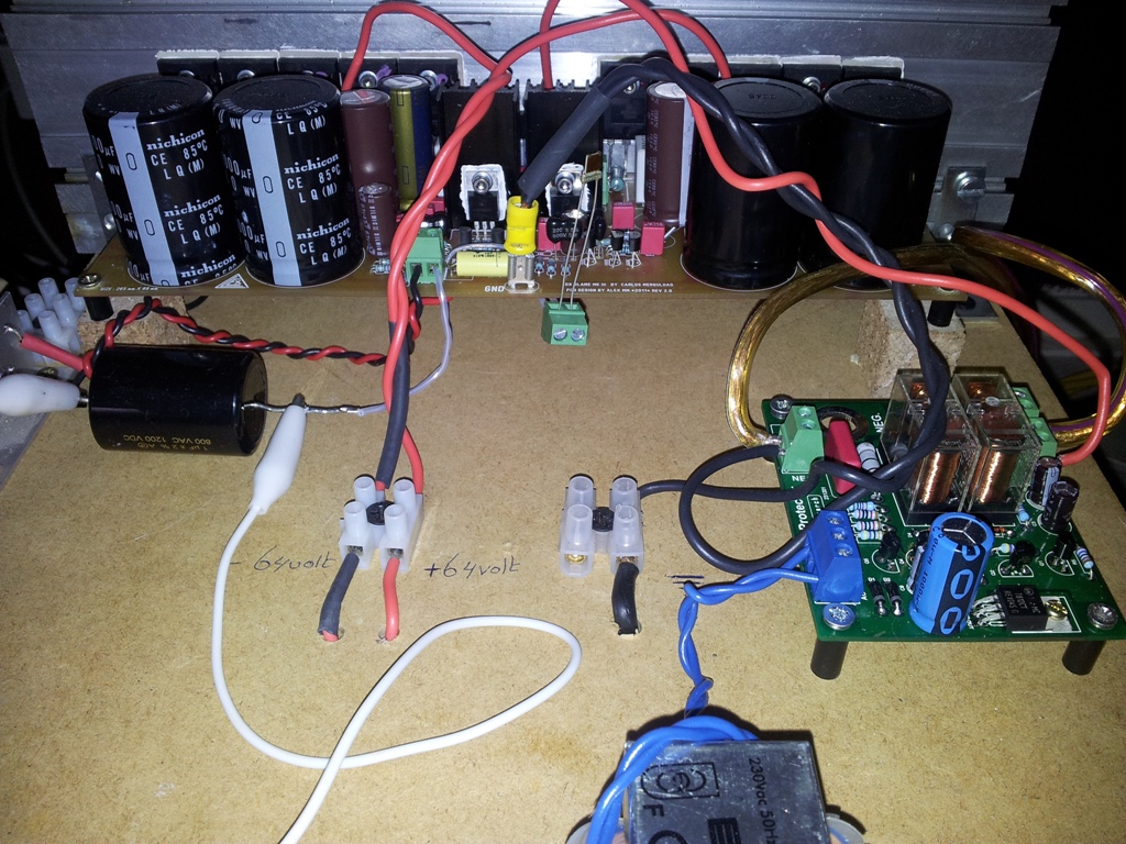

I am not good in electronics, i said it earlier. I just finished the amp circuit. I used dotted Board to make this pcb (not line dotted). all are hand made, soon i will assemble it.
I played two days using 60V and no problem at all. sound great to "My Ear". high freq not distorted and no hum. I didn't use 10000uf caps, it is too costly here also too big in size so I used 3300uf 80V caps. I also used only 4 pair of transistors due to pcb board and my Tranformer amp. should it be ok?
Here is the final Board.

it looks nice, I would use some kind of support in the middle of the board, that way it will not bend badly.Hello,
