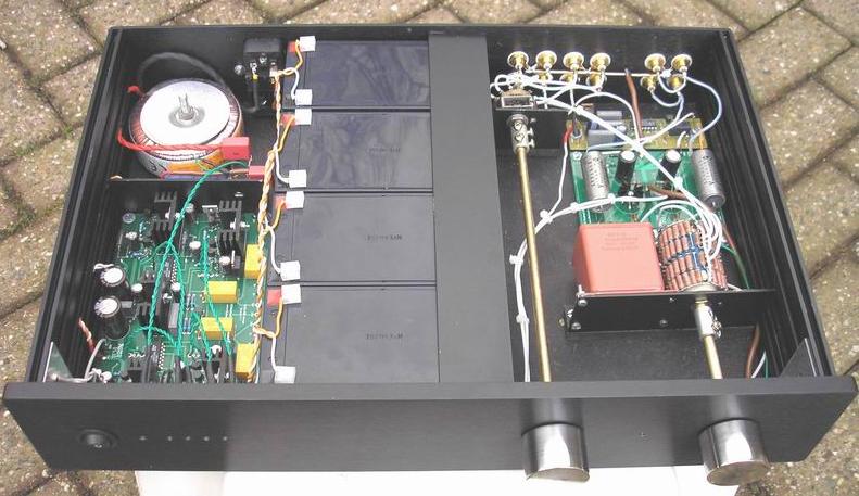

@ Evette and a.wayne, here is no distortion I had the volume too high, the microphone of the camera makes the distortion 😉
The preamp is Fettle (Pinkfaun) I think also high output preamp.
Tomorrow I am solder the 10R resistance and test again.
If sounds better than I connect the other speakers.

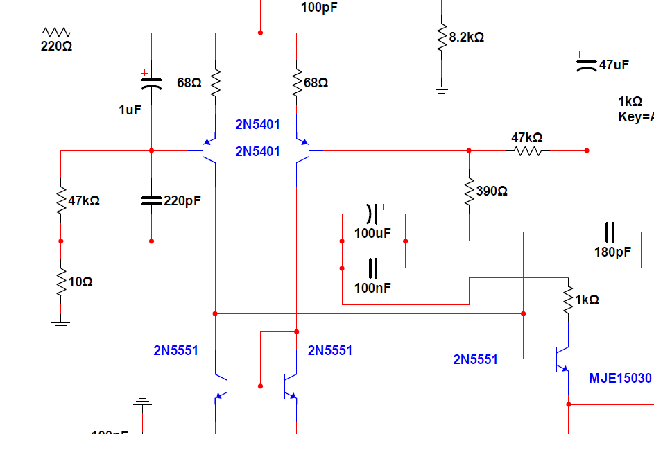

Which resistance is responsible for the input sensitivity of the Dx Blame MKIII-Hx?

Am I right that the 390 ohm resistor responsible for the input sensitivity of the Dx debt MKIII-Hx ?
Can I use a 10K resistor, so I can use my Preamp ?

You are right with the 390R resistor, Rudy.
Very slightly (!) increase it (f.e. 500 Ohm).
A 1K trim resistor should do.

The input impedance of your power amp is set by a resistor.
The input sensitivity of your power amplifier is set by a ratio of two resistors, neither of them are that first impedance setting resistor.
I don't have a schematic to hand, otherwise I would give you references.

the components are not labeled !!!!
Rudi, I can't open your off Forum postings.
Will you stop that practice?

I have only one clue to what you are proposing.I have here a 8K2 resistance to soldering in from the other board and not a trimpot 😉
Edit: 10K change to 8K2
I see one resistor with an 8k2 value, but that resistor has nothing to do with input impedance nor input sensitivity.
Label the components and then we can explain what you need to know.
Sorry, this is all back to front.
You should know basic operation of your amplifier before you delve into changing anything.
Andrew look @ the picture I uploaded.
The 8K2 I have is from the other board to use in place off the 390R.
Can someone calculate the correct value for me for the 390R, that is also used if you are buying a power amplifier in the store?
So that I can order the correct value resistors.
Rudy

MKIII Hx input volume control connection, start video at 1.15 min:
MKIII Hx input volume control connection - YouTube
So, is the 8K2 resistor, good to solder in?
It's nice I have a little sense of electronics but it is my hobby.
And the amplifier plays with help of forum members, otherwise this amplifier has never playing.
I have almost all components, self created via schematic with help from forummembers
Speakers
Battery Preamp
Power Amplifier
CD Transport.
DDDAC
All the power supply
Thank you all,
Rudy
I don't have the knowledge to do that, that is why I question.Label the schematic, so we can see what you are referring to.

The 8K2 resistor, is not good, the amplifier playing now direct from DAC out but to soft, with the CD Dire straits.
The 8K2 is not a succes hopefully somebody helps me with the good value.
And with my preamp I have still to much wite noise, when the volume going up the white noise get lower 😕
My preamp has a volume control with steps, each step still give a crack on the speaker.
Rudy
