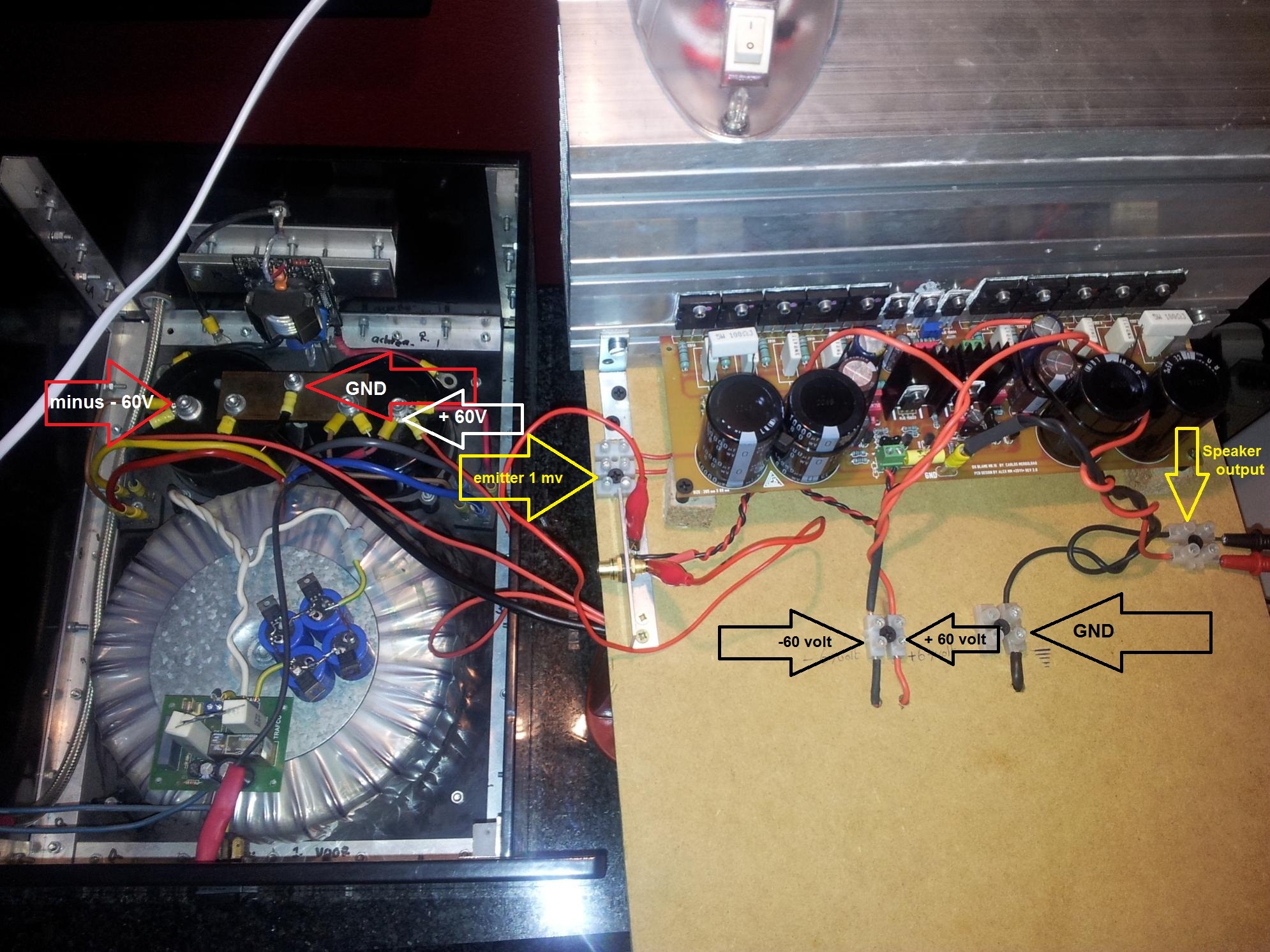

The measurement is done and had the same values.
Am now as far as I have a cheap speaker connected with a preamp.
I get to hear a hum and receive music in the background.
If I touch the large heat sink changed the hum also with the small heat sink.
The output connector of the preamp is isolated the entrance connector of the power amplifier is also isolated.
Please tell me what is wrong, maybe the isolated input connector?

The Main Audio Ground is the reference point for a whole series of other circuits.
Signal Return
Speaker Return
PSU Zero Volts
Chassis
PCB Power Ground
Disconnecting Network, if fitted
You stated earlier that you had located your Main Audio Ground on the Speaker Return Terminal.
That means you must bring all the other reference connections to that same Terminal.
But, which Speaker Return Terminal do you use? Left or Right?

In the pictures, I didn't see any evidence that the center-tap of your main transformer was conencted to the reference ground, this may induce big offset...

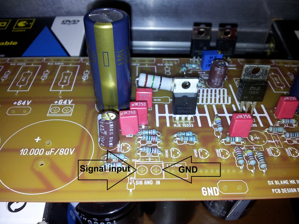

This Is the good connection?
Nope, based on photo left side is GND-Signal ground and right side is IN.
He is playing, without hum that is good, but have a lot of white noise.
My preamp has a volume control with steps, each step give a crack on the speaker.
