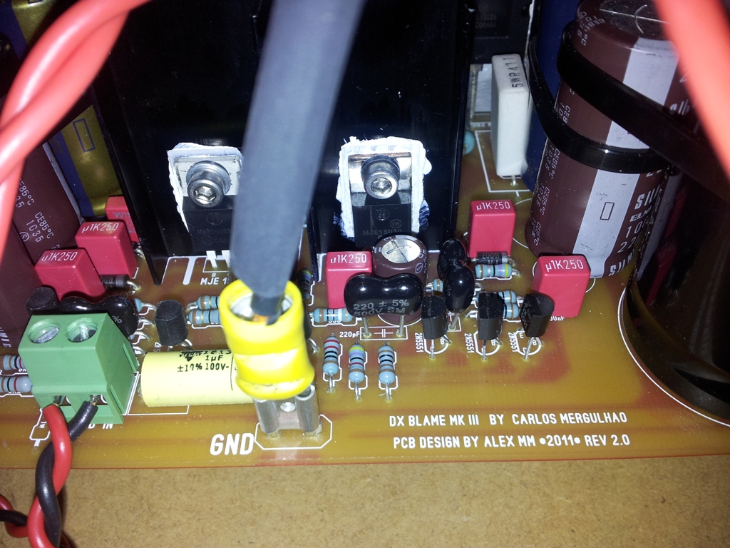

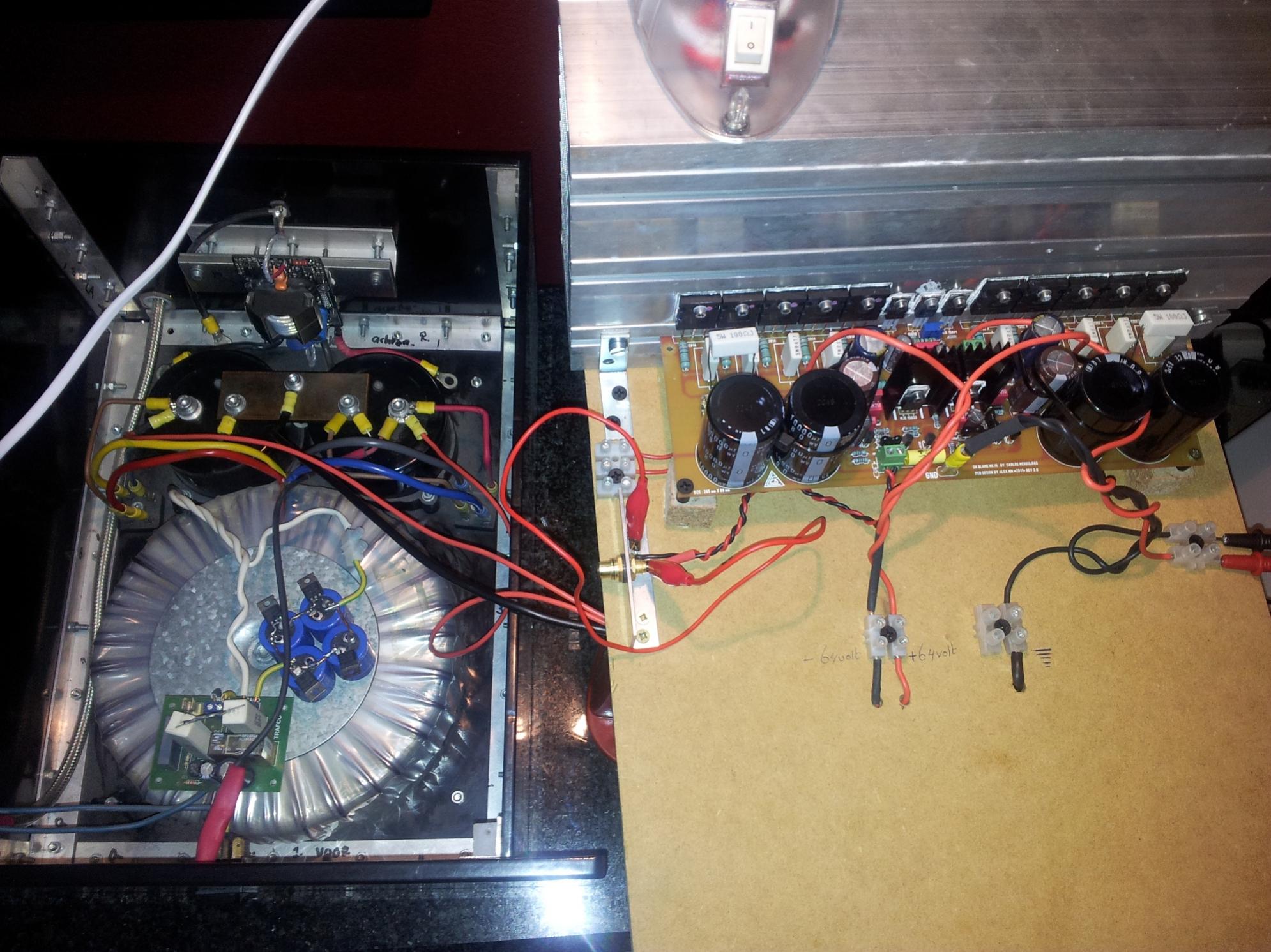

We can't see what you have not photographed.
I and I suspect we, need an overall view.
Two red insulated cables/cords for both +ve and -ve supply.
Two blk insulated cables/cords connected to PCB Power Ground and going off pic, in different directions.
Rudy, the small black "isolation bushes" (Vigier called them this way) have a tendency to "break", when you fix them. I use Polyamid screws for the TO-220 and TO-126 transistors.
Please measure the resistance between the small transistors' legs and the heatsink.
Rudi
The collectors of those 3 MJE seem to be hardly connected to the heatsink! Or is there a small isolator (dark ring)?
No there is a mica isolator.
They are going to the 47000uF elco's
The min -60v is a black shrink hose over it so that I can see that is the min -60v
1 black kabel is going to the speaker terminal and the other one is going to the GND copper plate between the elco's.
Rudy
No Rudy, a resistor (10 Ohm) or wire is necessary at this location (has to do with lifting up the AMP's GND-plane in correspondence
with SIGNAL GND).
I remember that there was a discussion in the very 1st posts what to use.
I did not follow this discussion to the end, but this resistor may not be left open!
Try a 10 Ohm resistor and measure again!
Rudi
The Main Audio Ground is the reference point for a whole series of other circuits.
Signal Return
Speaker Return
PSU Zero Volts
Chassis
PCB Power Ground
Disconnecting Network, if fitted
You stated earlier that you had located your Main Audio Ground on the Speaker Return Terminal.
That means you must bring all the other reference connections to that same Terminal.
But, which Speaker Return Terminal do you use? Left or Right?
