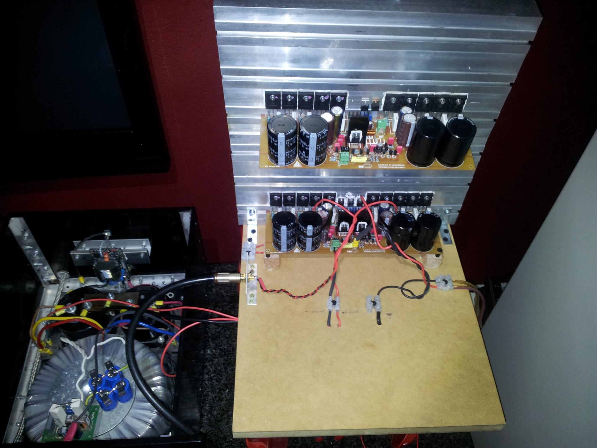

Yes Bimmer, it's a stereo unit. Since I was building a dual-mono amp, I was worried about the share of this component by the two channels. The cross-channel talk due to this component is negligible.
A.Wayne, my Hx amp has a power-on thump. It also has a power-off delay due to the DC voltage that depletes progressively as the caps discharge. When the speakers are directly connected to the boards, I can have music for as long as 30 seconds after disconnecting the unit, just because of the voltage reservoirs, or just a few seconds when it's playing louder...
Many high-ends or high-power power-amps have this kind of circuitry, either with electro-mechanical components (relays) or by other solid-state means.
This circuit may have saved my speakers already, I explain: I was connecting / disconnecting my speakers while music was playing (rather loud), and guess what? I briefly shorted the amp output without noticing. It blew only ONE of the on-board fuses, thus only throwing the negative portion of the sine-wave to the speaker. This protection crcuit instantly disconnected both speaker outputs, preventing any damage to the speakers themselves. After replacing the blown fuse, everything was back to normal.
My DX Blame does the same thing. A power-on thump, and a "burp" after a long delay after power-off. Maybe I should get me one of those protection circuits too.
Power on thump may be normal in most amps , not so on turn off..
I have /had many amps over the years and most not all exhibited some kind of on thump, all barely obtrusive, never had one make noise on turn off and non had speaker relays.

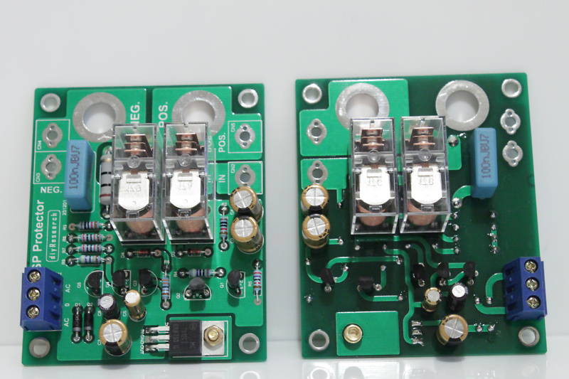

What do you all think of these Speaker Protection Modules?
Because I have mono-blocks this seems to me a good solution.
2x Mono Speaker Protection Module - each for on Channel:
2x Mono Speaker Protection Module - each for on Channel | eBay

you only need speaker protection modules AFTER you have completed all your testing.
Then they can be a very good idea.
Yes that was also my intention, but is there difference in these modules and where do I need special attention.

I only wanted to know is this a good design.
If you guys give me the green light I go for this one and order these speaker protection modules.

get them they can only protect your speakers. 1 onuce of prevention is worth more than a pound of cure. evette
My understanding such devices hurt sonics , no..? if so I prefer smoke to bad sonics ....😛
