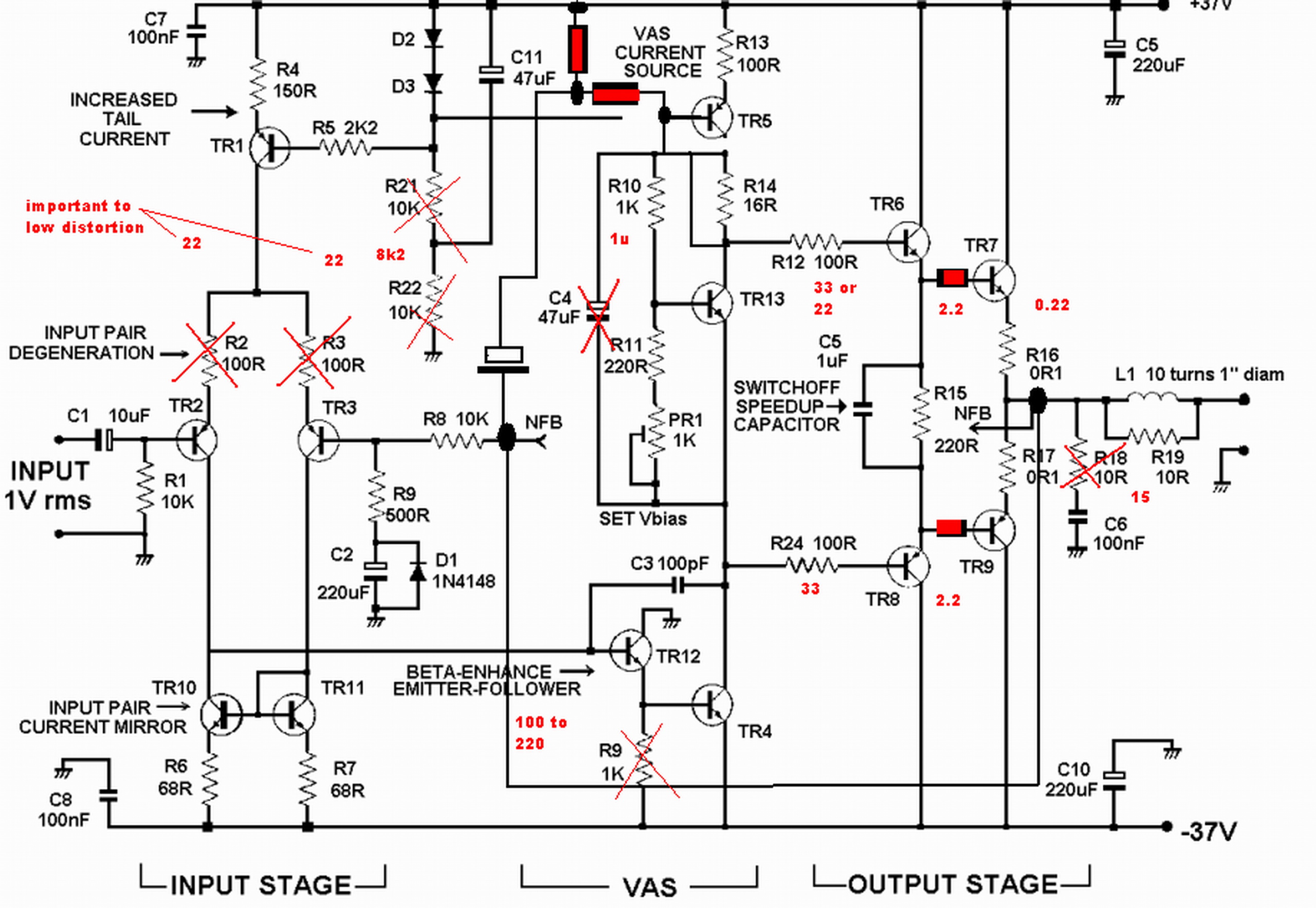

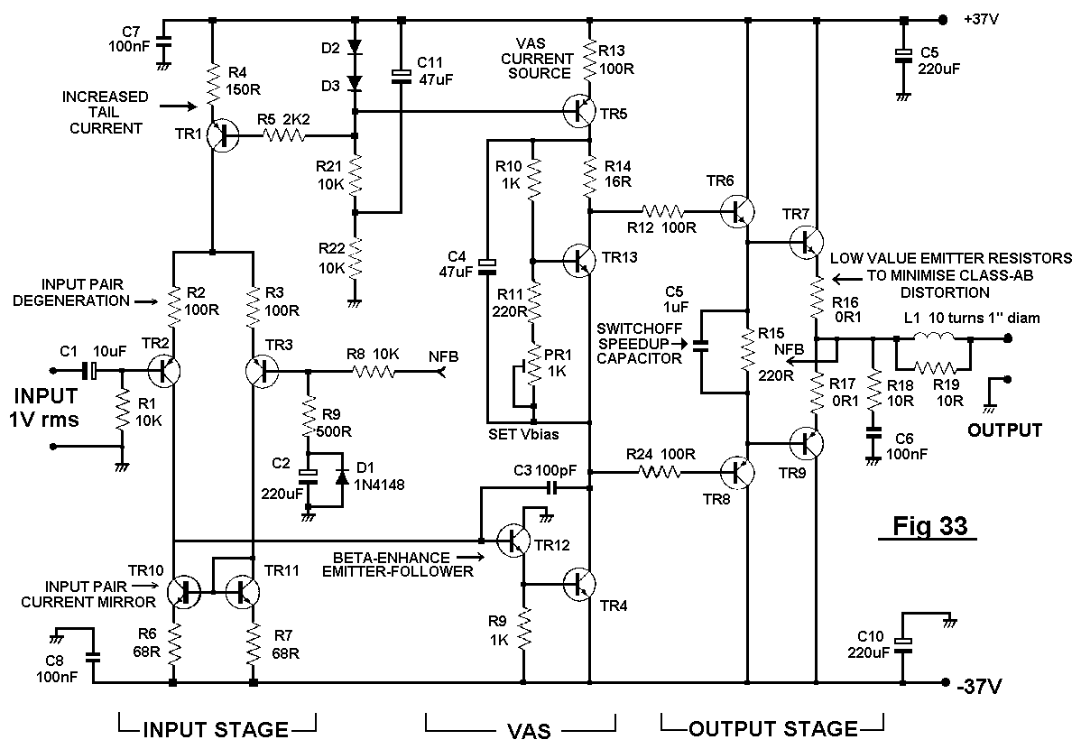

I am glad we agree on that....it kills others...this is reality
I am very proud i have superated my stubborn, my resistance against Blameless... i have assembled several years ago and i found it just awfull!.....something wrong i have made..for sure!
It is copy, a clone of the Doctor Self Blameless..the input is almost the same...i had worse sonics and unstabilities with the VAS feeded by the CCS, reason why i have returned to the bootstrap i love.
The output, is from the Dx amplifier...of if you prefere, from Aksa 55 without the secrets...so... a Frankenstein.... one part from my own amplifiers (Aksa 55 was made before mine...and my main source of inspiration) and the whole input, almost all parts the same. even resistance values, an unshamed and declared copy!..... the 100 ohms resistance was increased to avoid failures...but killed the sonics a little i must confess...the ancient, the first amplifier (the one Volker has) is the best one in sonics..others are almost the same..but loose the "magic"... the defined tones.....
The opposition, the critics, use to say i may love distortions.... maybe they are rigth...in this case, i have found a lot that loves distortions..and this proves, their measurements serves for nothing or almost nothing, as they are representant of numbers..and these numbers are excelent at the Dx Blame ES/ST...this means....there's not distortions they can measure..but they say there are distortions and that i love distortions because they want that....to twist the reality to acomplish their own desires and targets.
Build this amplifier..... please Greg, do it too...it is very special...i guaranteed that i will eat your board if you find one that can beat this one Greg..including your neighboors..the super ballanced, same current, differential platoon.
Man... the superb high technology, crowdy circuit, filled with a lot of CCS, current sinks and so on...the Fokker and the Troyan, cannot polish the Dx Blame ES shoes..... the ones has power...not more than power, huge power...but quality.... compared.... a shame to Troyan and Fokker...absolutelly no chance to be compared... loose...by big distance.... eating the dust of the Dx Blame ES that acelerated turning the whole earth one turn and finally beat the others second time (second lap) and cross the final line in first place.
I had this in my idea in advance to make Troyan and Fokker.... that i would make all i can without succeed to equal the Dx Blame ES performance... and tried and still trying, my best..and i could not... this serves, also, to show you, to prove you, that crowdy, complicated, overcomplicated, too much dense circuits are more for exibitionists, show up guys that to audiophile..because usually, very often, almost always, sounds worse than simple ones.
A friend wil build Symassym.... well...i have worked together Bittner in the early days... i have evaluated the recordings he made together John Mateus (USA)... i know it is a super amplifiers...having very good sonics...heheheheheh.... sorry.... wait their evaluation about after comparison with the Dx Blame ES... Symassym will beat in Bass, will beat in dinamica and will not have the focus and details, worse treble to symassym, and the rich of details of multiple instruments playing without mix one each other will be lost... despite symassym is excelent, in advance i will inform you the future results of their evaluation... so sure i am about that.
Remove you hat in respect of Doctor Douglas Self and Hugh Dean.
I said will eat the board Greg...if you find one to beat the first Dx Blame ES

What i have made?.... a copy...watch the schematic and you will see
all modifications i have made over the blameless design.
A copy... a clone... a brazen, shameless copy!
More than i am able to do...doing more than what i am
Prepared to do... copying!
have you watched the movie (picture)...i am the Bandit.... beat me if you can!
Uploaded with ImageShack.us

But I left the rail resistances at their values of 56 Ohms.
Their affect on the sonics is to prevent the BlameES from clipping too early and stealing some of its power.
So - not to change even contributes to the sonics of the BlameES.
I also left the 1.st VAS - emitter resistance (R16) at its value of 220 Ohms.
I remember the change of this resistance from originally 100 Ohm to 200 Ohm was Carlos' first step to "stabilize" the BlameES.
I will check tomorrow (I will solder another 220 Ohm on top of it) if the value of this resistor has any influence on the sonics.
It has no affect on stable operation as Volker proved in the last 3 month, but to keep Carlos well-disposed ...
Best regards - Rudi_Ratlos
Simply count the MICA caps (the yellow ones) on the PCB: 5 in Version 1.3, 4 in Version 1.4 and 3 in Version 5.
