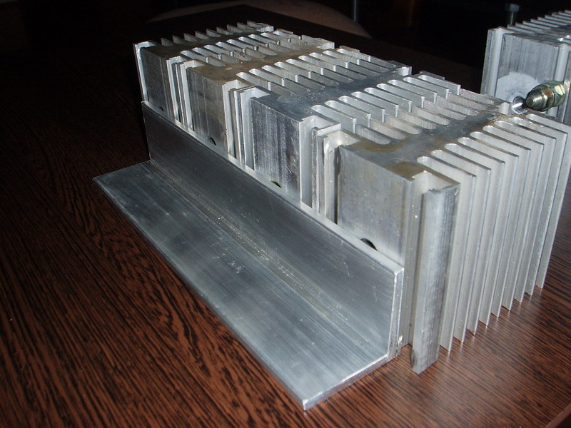

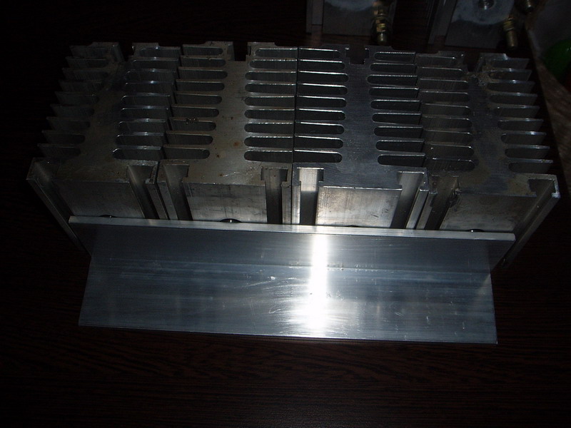

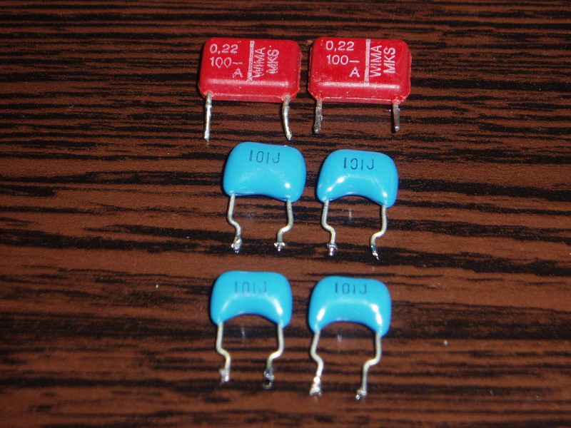

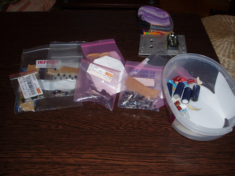

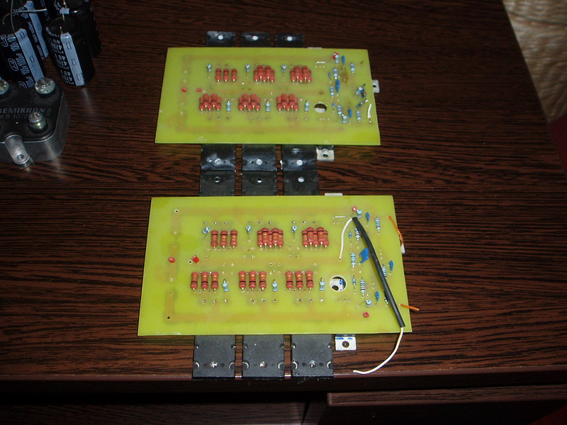

Dx Blame ES .... based into the Blameless, i am trying a new amplifier
Daniel, my dear Croatian friend (5 years of good internet friendship)
Is preparing material to build a Class A Dx Blame ST.
This man evaluation interests me a lot.
regards,
Carlos

The preparation, the construction project, the study made, this is lovely
This young man has expertise..he is very good...more than good.
You gonna see his work quality.
Prepare yourself to see a Master of amplifier construction working.
regards,
Carlos

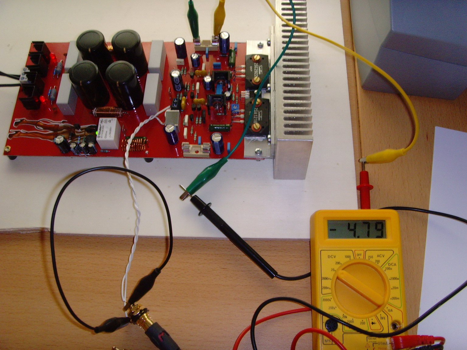

Adjust the stand by current is an easy task to be made in the Dx Blame ST
easy adjustment using multiturn trimpot, also normal ones works fine..you can adjust in 10 milivolt steps without any trouble or overflow or unstabilities..once adjusted..if keept cool, the current will remain stable.
See the lovely picture made by Dx Germany.
regards,
Carlos

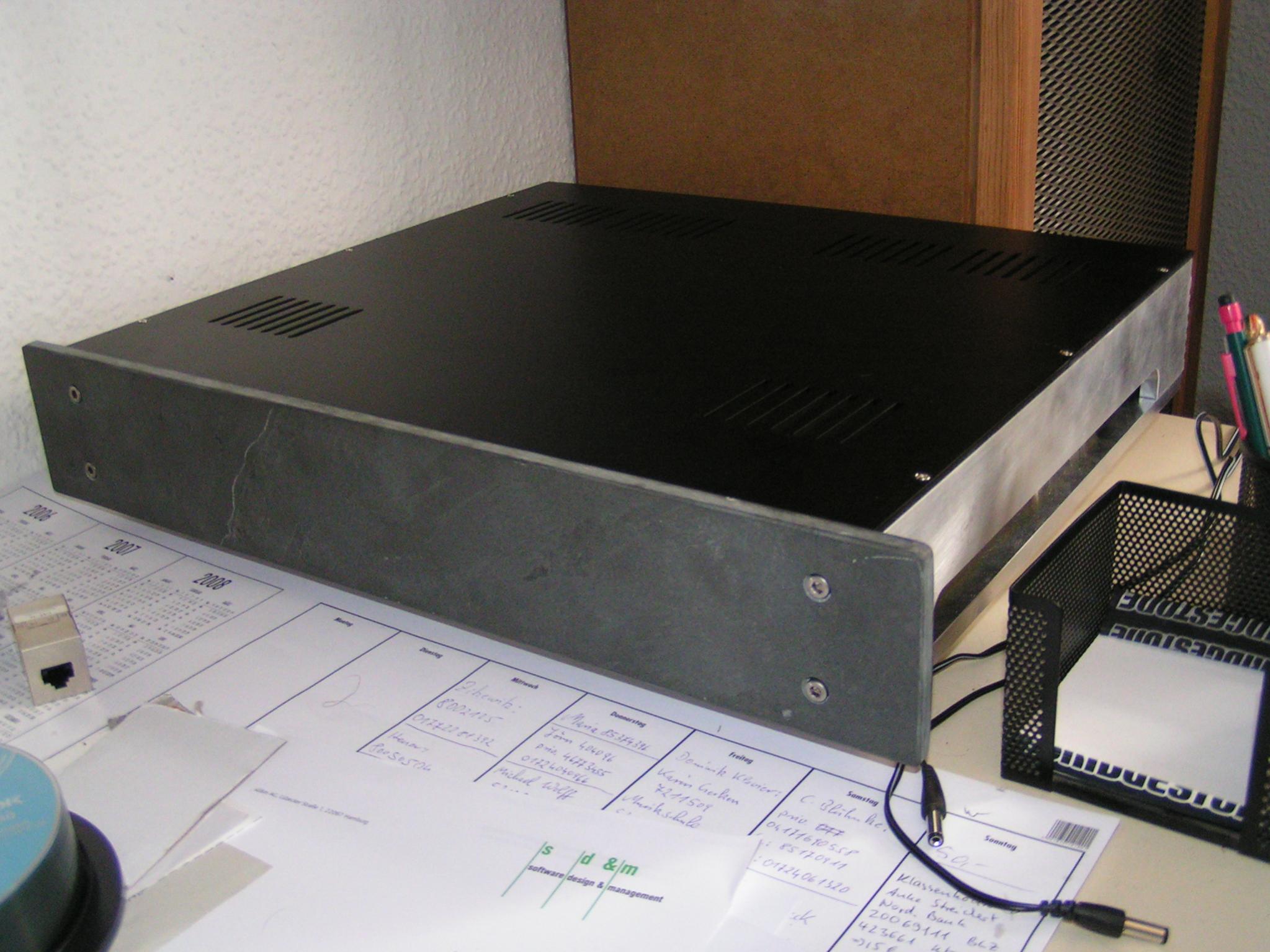

So: there is another one beginning to assemble the BlameES (Version 1.4):
Lucasz from Poland
Welcome in the club, Lucasz!
Enjoy its amazing sound!
I hope you will publish some pictures showing your progress!
But please: use small ones, not as big as my ones.
The moderators are unhappy with big images!
Best regards - Rudi_Ratlos

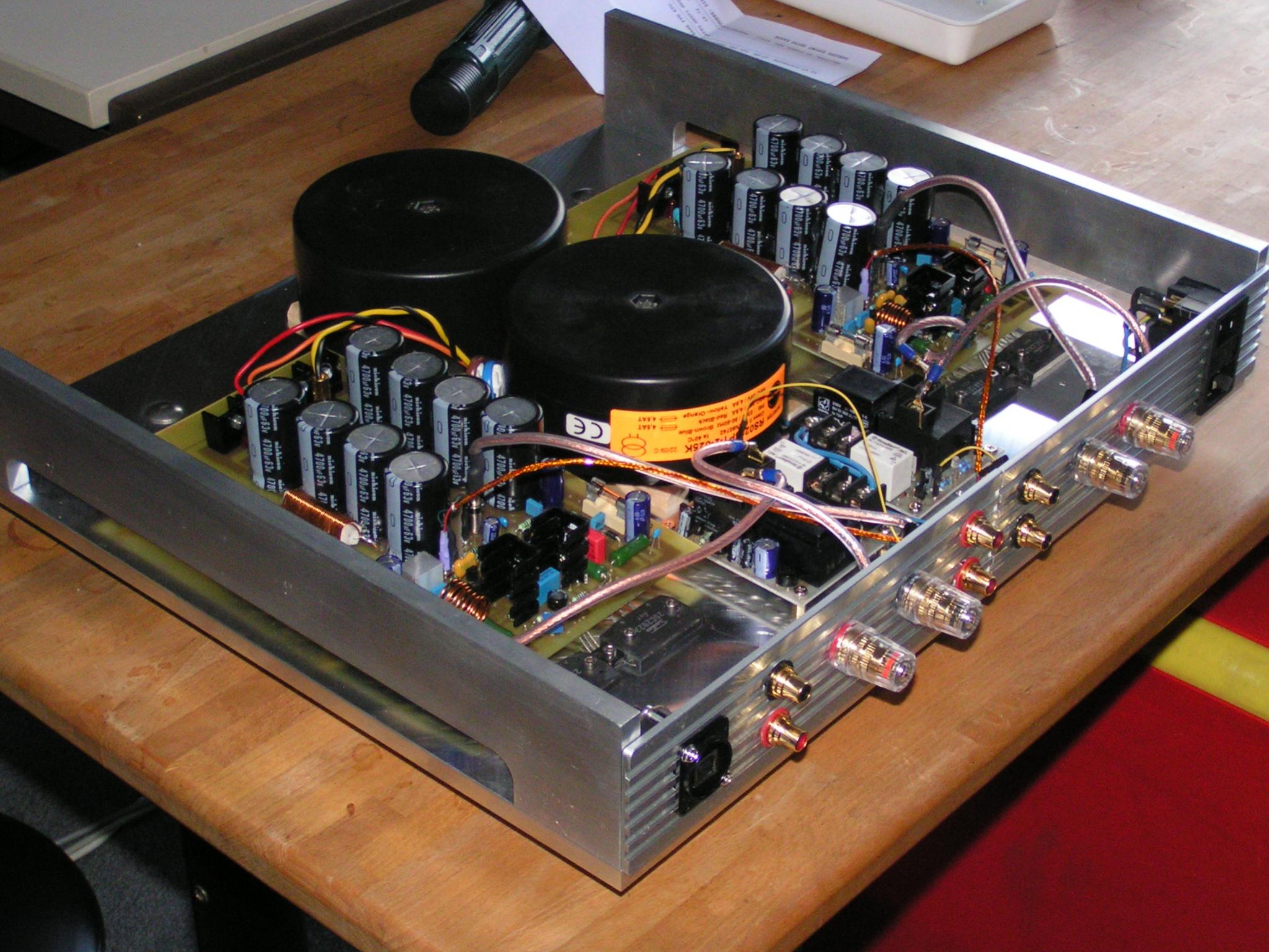

Ok, i have build version ES 1.4c with PCB layout by Rudi, this is playing stable and very nice day by day. Now, just at this time, i´m building a second pair of pcbs with same version but original layout.I will not change anything except the outputcoil, this will be installed orthogonal this time ;-)

Thank you Volker..... if you like it, then keep your version
the main modification is the first VAS emitter resistance, increased from 100 to 220 ohms..and the insertion of a resistance in the second VAS emitter..... as i have informed, i had a strange supply that created me problems... all these versions are working stable as i have all them at my home assembled and playing...including the last version too.
I do like the first one.... the one you have is the one i like the most.
As you have assembled, and long time listening, maybe your evaluation about the amplifier have changed as times passes by...i will be happy to know what you think about this amplifier today, as you had chance to listen it carefully for a long time and to detect qualities and defects in the sonics..also you had chance to compare, to readjust bias...so....you have the kind of know how very much interests me.... the ones that really can make a review, and will be more precise.
You know..first moments have a lot of emotion...second day we use to find something not perfect....and this is what interests me to know.
Thank you by the pictures, Rudi is inside a train to Hamburg and i will be waiting his return as i would like to have a review from Rudi too.
Make that in separate please, not to have influences between friends..one influencing the other ..... and try the amplifier without pré amplifier, as this can helps, but can also reduce the audio quality.
