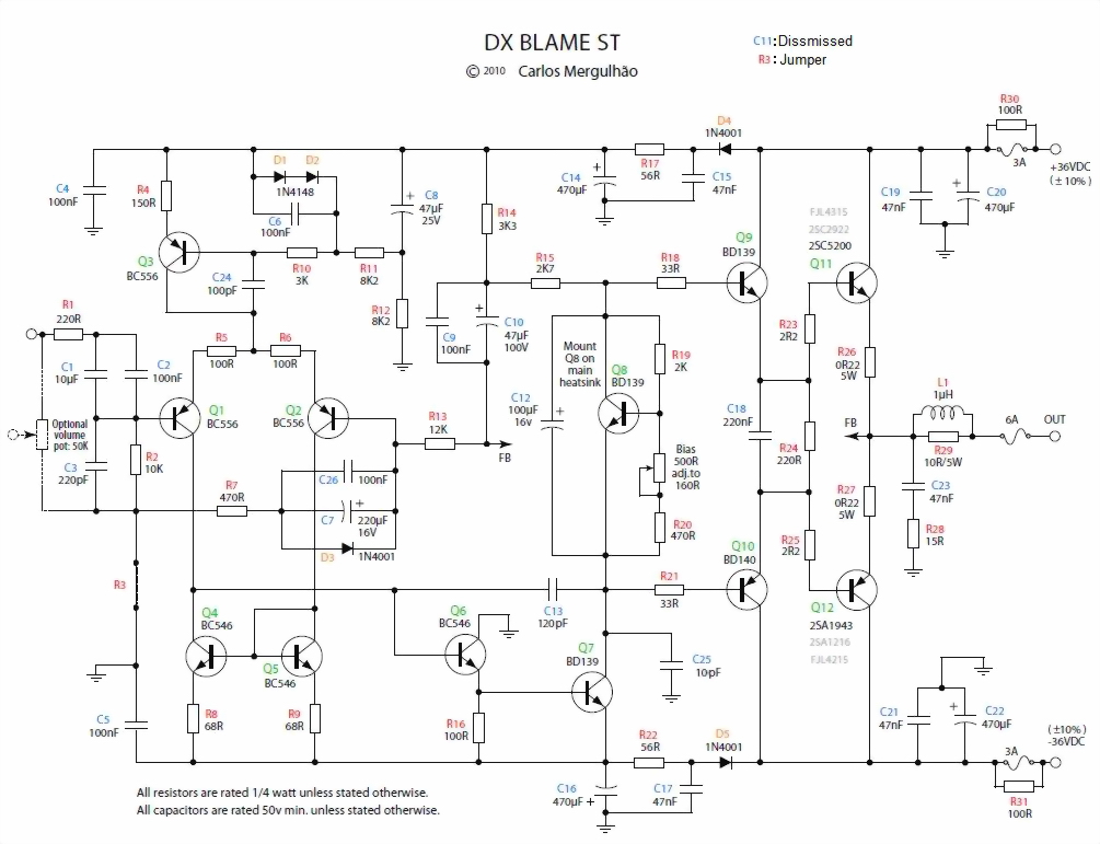

I started gathering parts, and found some mistakes in part list, C18 is said to be 2.2uF, and schematic shows 220nF in this place, ten times smaller. I guess 220nF is correct? Also, theres 'u'(micro) prefix missing in value description of C12(part list pdf).
regards
Lucas
.i can do that by myself.... to ask myself to try possibilities.
So why You did not? And still posting unreliable schematics with trivial erors!

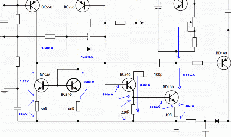

.. alike everybody.... was consequence of the choices made during the listening tests...the bootstrap to the VAS, the current used in the differential, the current in the first VAS (the load resistance value) and the current used for the VAS.
Here you have a simplified schematic, showing these parts, some voltages and currents.

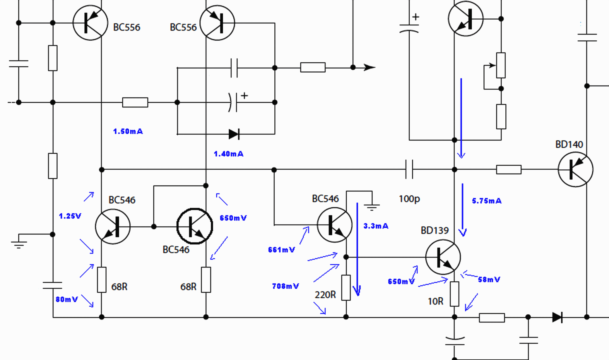

Picture ( voltages and currents) are measured without signal, in steady state. Try to think about conditions if limiting negative halfwave. Overdrive in signal peaks.
Something like car without brakes. Everything seems OK, till You do not need to stop. But then...
