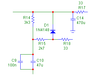

🙂,better try to think, what is purpose of diode D1 in attached picture.. OR try it in real amplifier, with overdriven amplifier. Something for bootstrap lover.

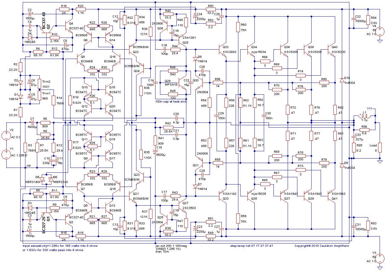

I don't follow the DYI pages very often, as most of the posts do not include a schematic diagram of the purported item of wonder. I believe Amplifier design and amplifier opinion are completely different levels of "art" so perhaps excuse those who confuse the issue...
I keep seeing references to Douglas Self and the blameless amplifier. Though I respect Mr. Self and have studied his work closely, if a person builds and simulates his 'blameless" design- it really ain't much.
This is a design of a mirrored front end, with proper current sources, and a competent output configuration. If you, or other DYI members are interested in this implimentation, and use LT spice for circuit simulation, I'd be happy to oblige a working simulation.
Paul Vonharnish
